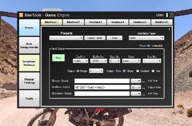

    Hello, I have tried to communicate my old AMC 1.5 board with simtools without success, the interface configuration is this, maybe I am doing something wrong ... I think you can help me
    Regards
    21,669
    151,668Coins
    +11,045 / 56 / -2
    For SimTools 2 it is Axis1a and Axis2a

    Hello Noorbeast ... great, with this configuration AB<255><Axis1a><Axis2a> I have managed to communicate with my AMC !!! thank you very much for your help (Sorry for my english, I use traslator)
