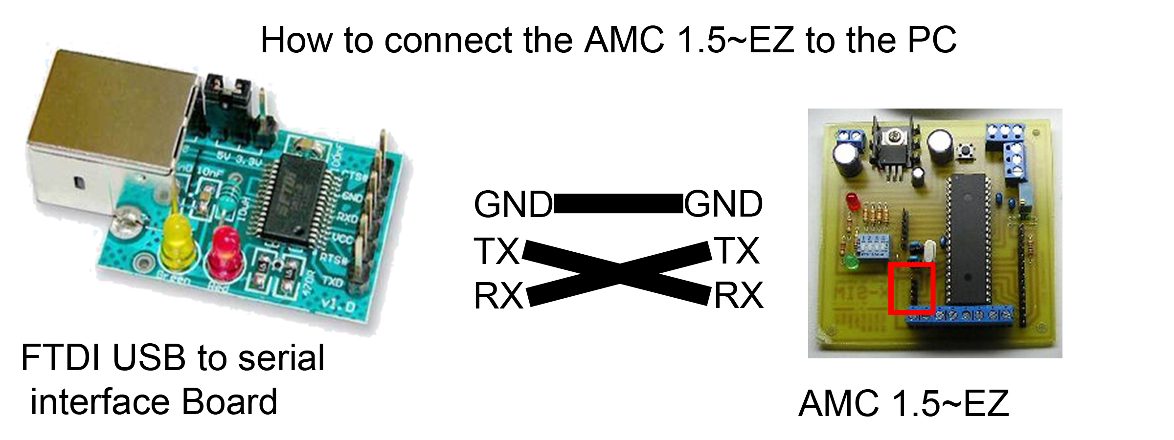

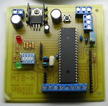

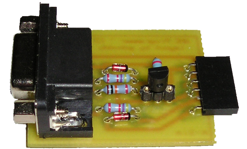

    Just thought I would show a quick pic on how the programmer connects to the AMC 1.5~EZ. :hi:
    Plug and Program!

    Just for Fun, Side by Side Pic! 8)
  4. bsft
    now thats more like it! I will definately have to put one together.

    You have done a fine job. Well done.
    I think great that you have added to the development of the AMC from the pioneering work of Thanos.
    His ground breaking work has enabled the enthusiast to make something that equalled or bettered comercially available systems.
    Your latest version now enhances this concept and makes it even more accessable to the hobbyist.
    I will certainly build one after I finish the Amc1.5b I am half way through :cheers:

    I wish i could soldier properly..My Amc 1.5b has died from my soldiering attempts.This maybe a easier solution for me.Or pay someone to do it. :sos:

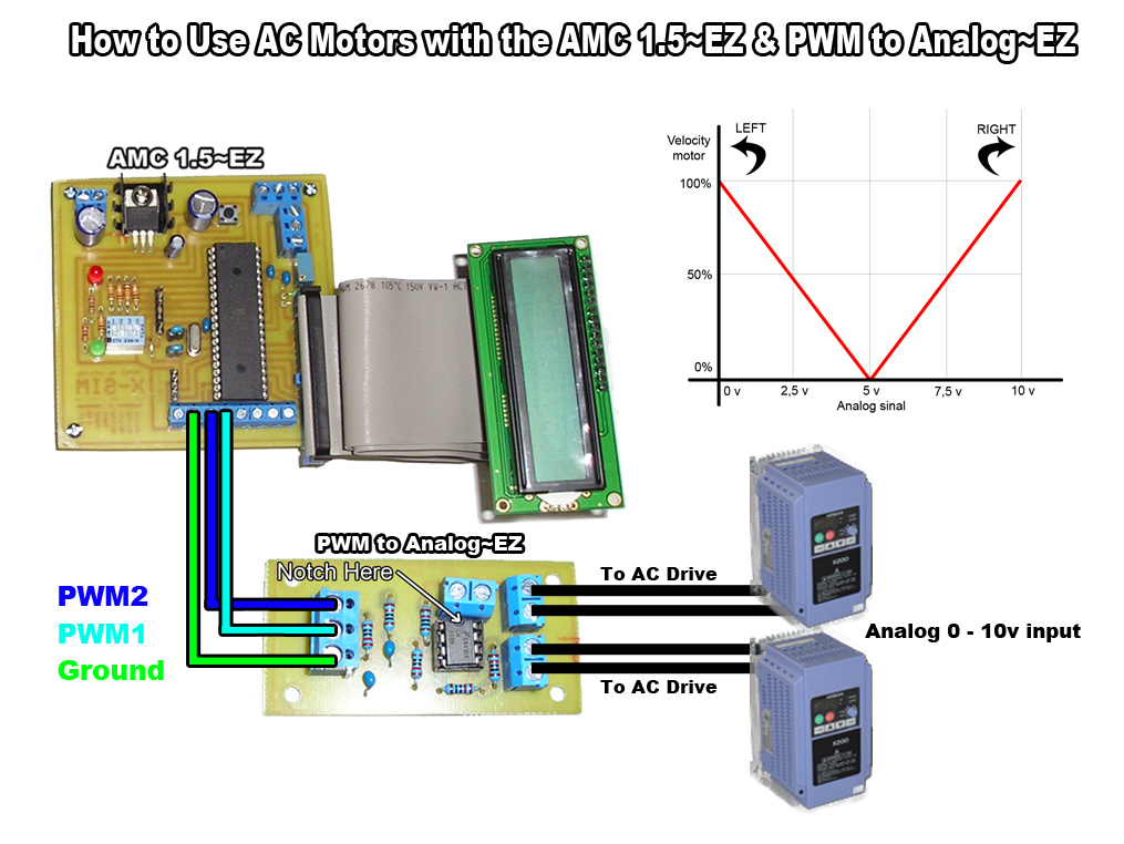

    Ac Motor Wiring Diagram:
    :thbup:

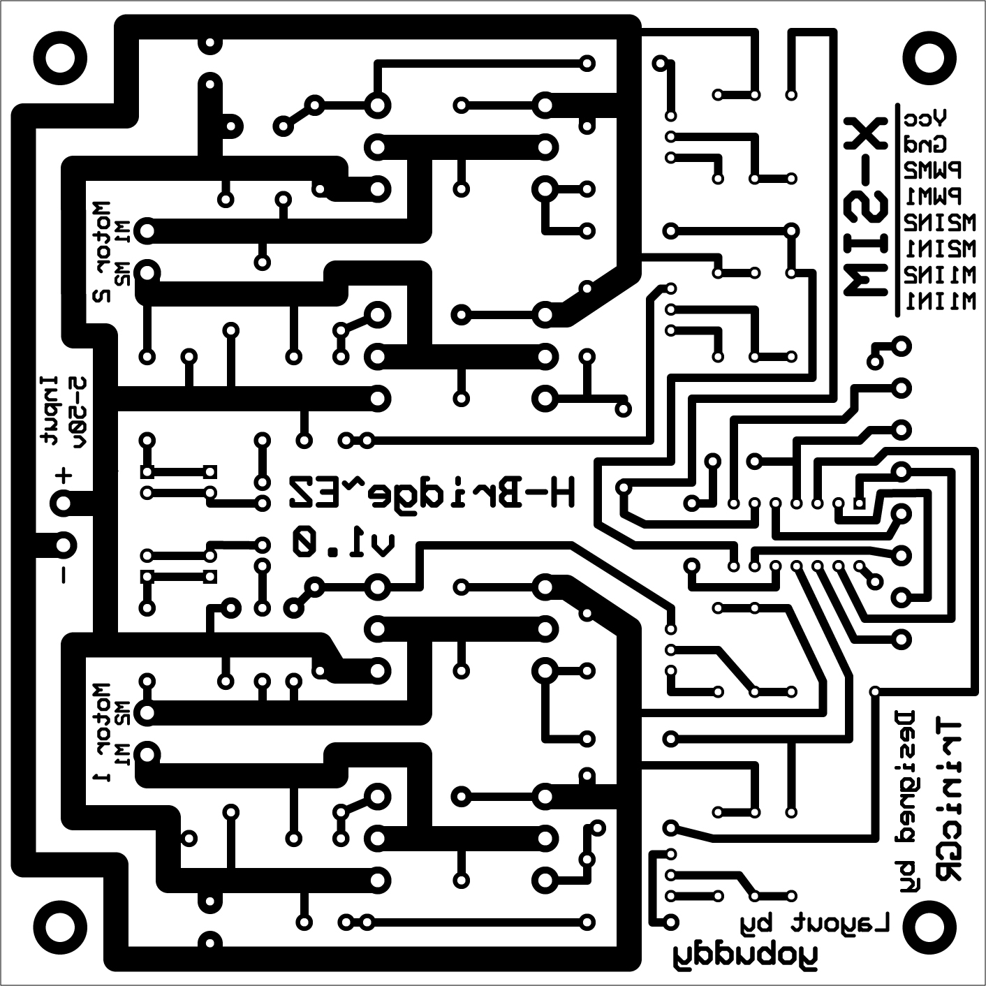

    Hi Everyone, :hi:
    I have completed an EZ version of Tronic’s H-Bridge.
    Since I do not need to build another H-Bridge, Or can afford it after all the stuff I built last week - lol, I would like to leave the beta testing and Manuel writing up to someone else.
    If you are willing to help the community out by beta building and testing the H-Bridge~EZ, and taking some pictures along the way, send me a PM for the PDF layout file.
    List of upgrades:
    -Oversize Traces for easy PCB etching and soldering!
    -Uses a 120mm fan for a more even heat dispersal (covers the whole PCB), instead of the original 80mm fan!
    -Mosfet’s are placed closer together so no spacer’s are needed between the Heat Sync’s!
    -Uses all screw terminals so there are no cables to make!
    -Has a single power input, instead of having to splice wires too 2 different inputs!
    -I was able to remove some of the Jumper Wires for less overall soldering!
    -PCB is only 4.7 x 4.7 inches!
    Here is a preview. :cheers:

    I just wanted to let everyone know that eaorobbie has accepted the challenge of constructing the first H-Bridge~EZ! :cheers:
    He will be taking pictures along the way for me to make a Pictorial Guide on how to put the H-Bridge~EZ together. This is a great step for the community!
    If you see eaorobbie on the forums, shoot him big thanks!
    He deserves it!
    A great community is only as strong as the people who are willing to help others! :thbup:
    Thanks again buddy! :thx:

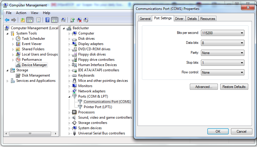

    Hello Yobuddy!

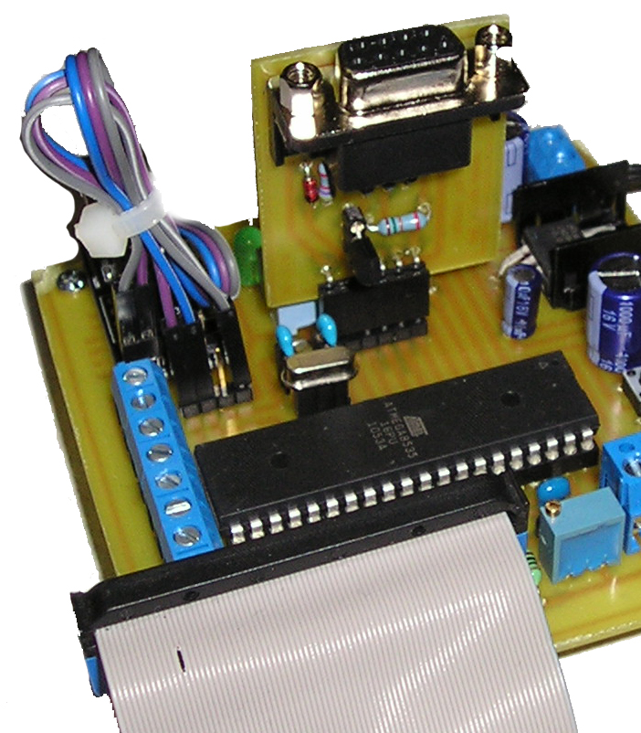

    First of all, I must say that you compact AMC board is great - less parts -less problems :) !
    I have one question about connecting you compact board to PC.
    In first post you advice to use a USB to serial interface to connect AMC board with PC, and you have
    on your AMC board 3 pins with GND, RX and TX.
    Because you dont have MAX232 chip, is it possible to connect that 3 pins (GND, RX and TX) direct
    with 3 wires on pins of COM port on motherboard (and avoid Usb to serial interface)?
    I asking you that, because I dont use a serial cable to connect orginal Thanos AMC board and PC , I use only 3 wires
    from AMC ( pins 5-GND, 2-RX and 3-TX) to motherboard internal COM port connector.
    Regards
    Igor

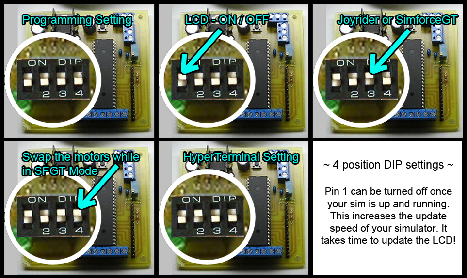

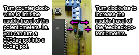

    Verbinden met een computer
    Instellingen dipswitches
    Potmeters aansluiten

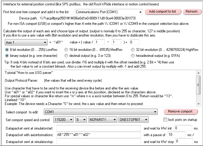

    Profiler2 instellingen (USO)

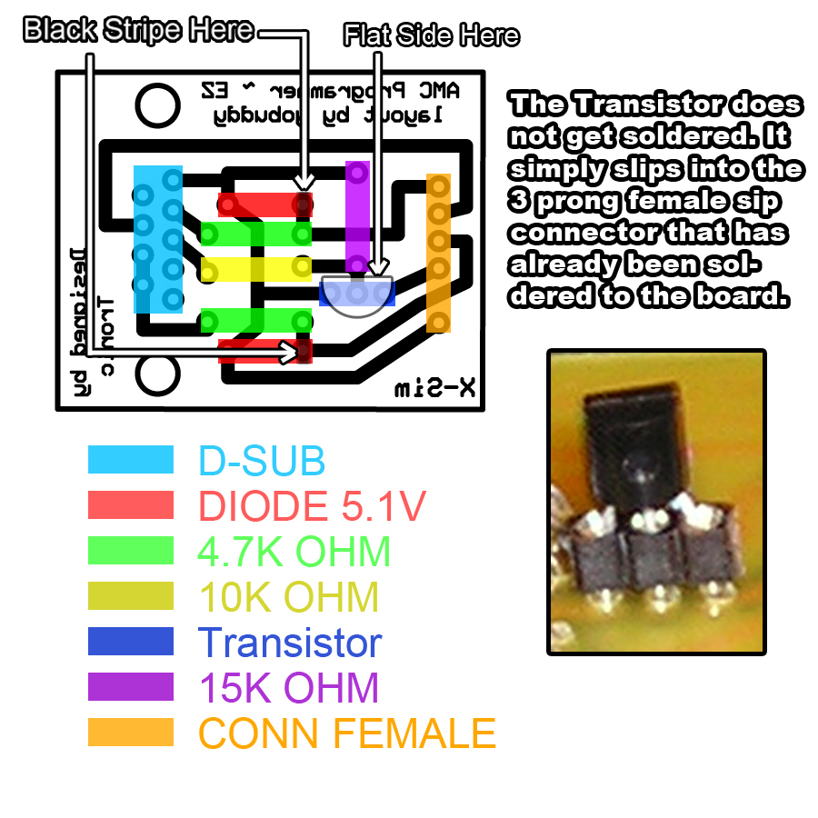

    AMC Programmeer Module~EZ
    Header voorbereiding
    Bouwschema

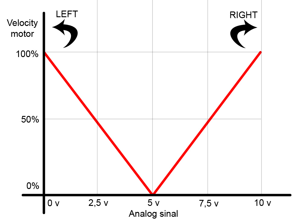

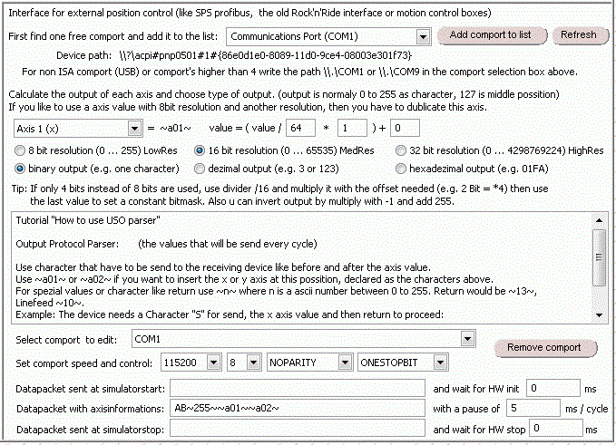

    PWM naar Analoog~EZ
    Bouwschema
    Geproduceerde output
