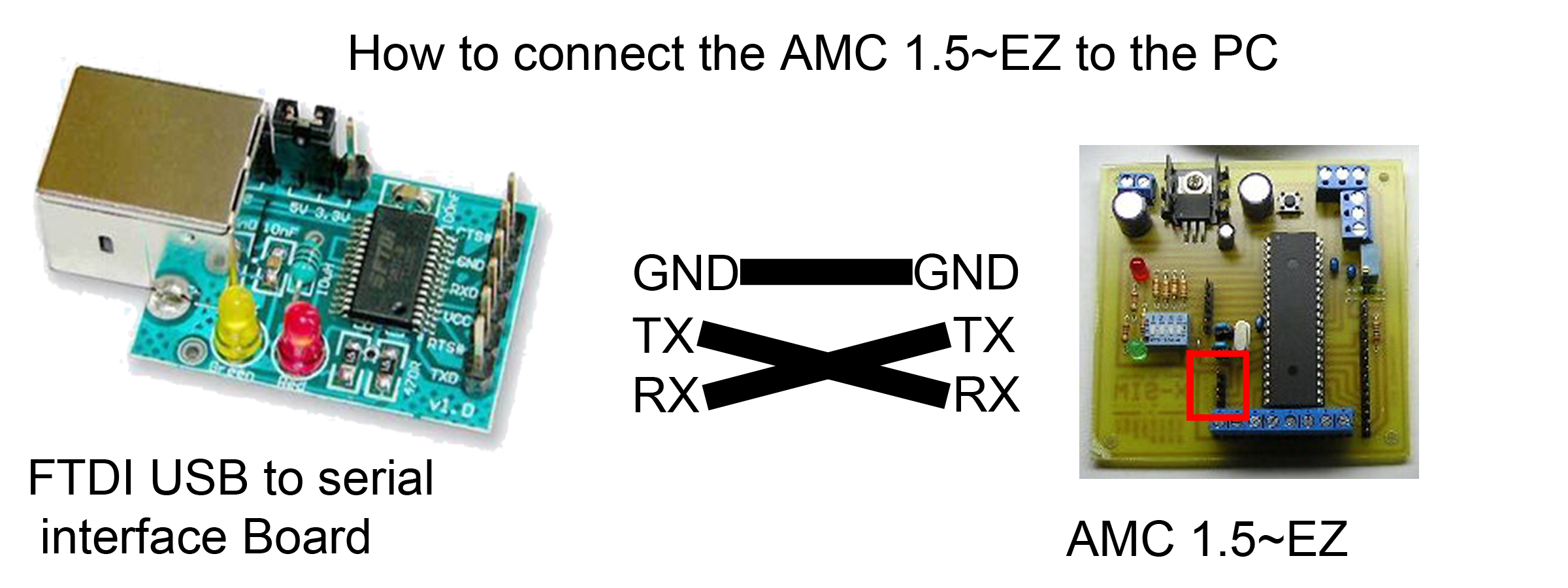

    Advantages over the original AMC 1.5:
    - All unused pins removed (nearly half the soldering has been eliminated).
    - Oversized traces and solder pads for easy etching and soldering.
    - Serial circuit replaced with USB connection.
    - Separate Programmer that’s “Plug and Program”.
    - No cables to make!!! Uses all screw terminals! (I really hate making cables! - lol)
    - The small parallel LCD PCB has been integrated; LCD is now “Plug and Play”.
    - 100% compatible with the original AMC HEX’s!
    - PCB is only 3.5 inches x 3.5 inches.
    - Pictorial, Step by Step, build guide!

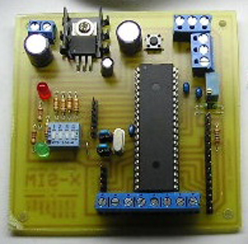

    AMC 1.5~EZ

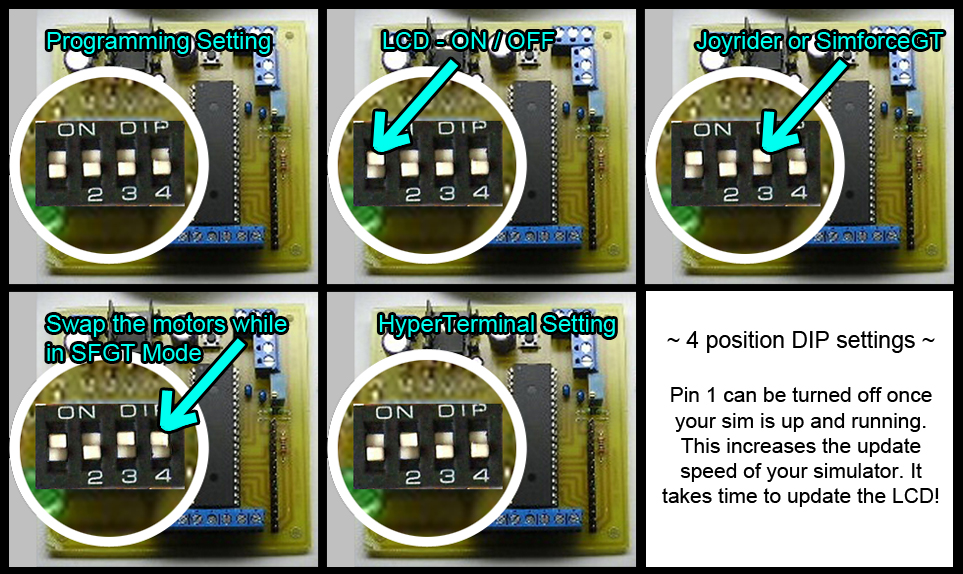

    Connect to a computer
    Switch settings

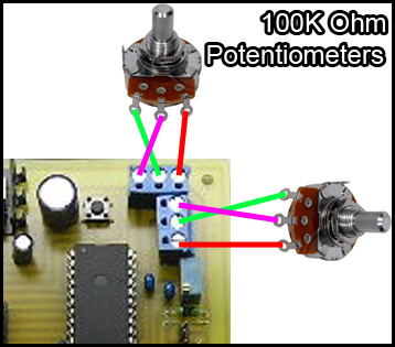

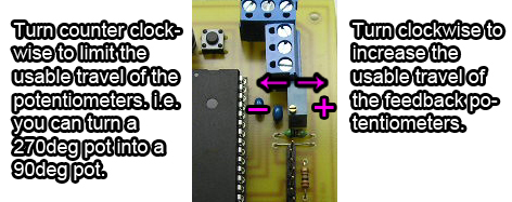

    How to attach pot's
    Calibrating the potentiometers

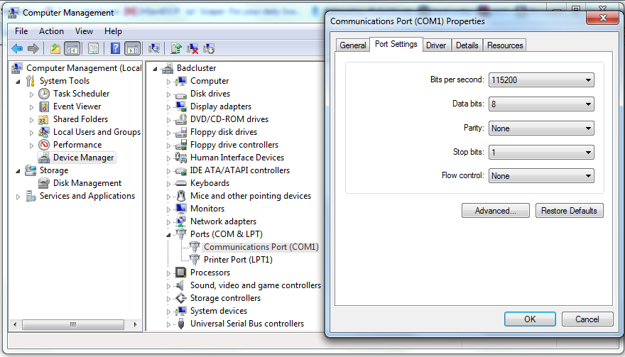

    COM port settings

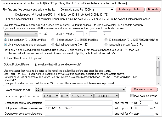

    Profiler2 settings (USO)

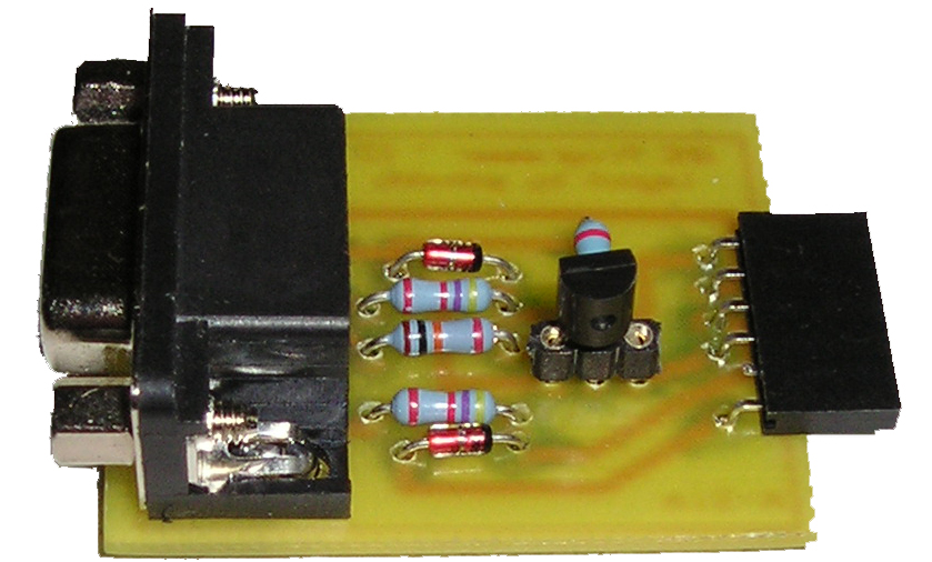

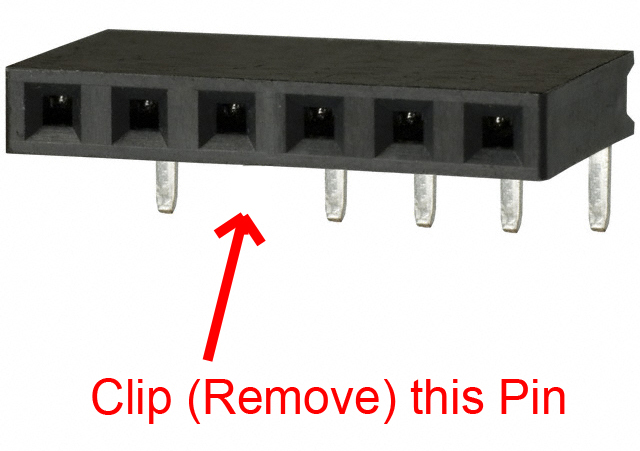

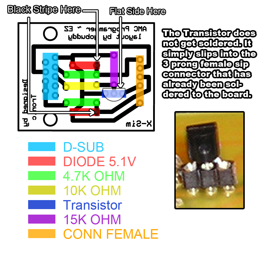

    AMC Programmer~EZ
    Header preparation
    Build diagram
    -PCB Layout AMC Programmer~EZ_Layout.pdf
    -Parts list (Digikey) AMC Programmer~EZ - BOM.csv

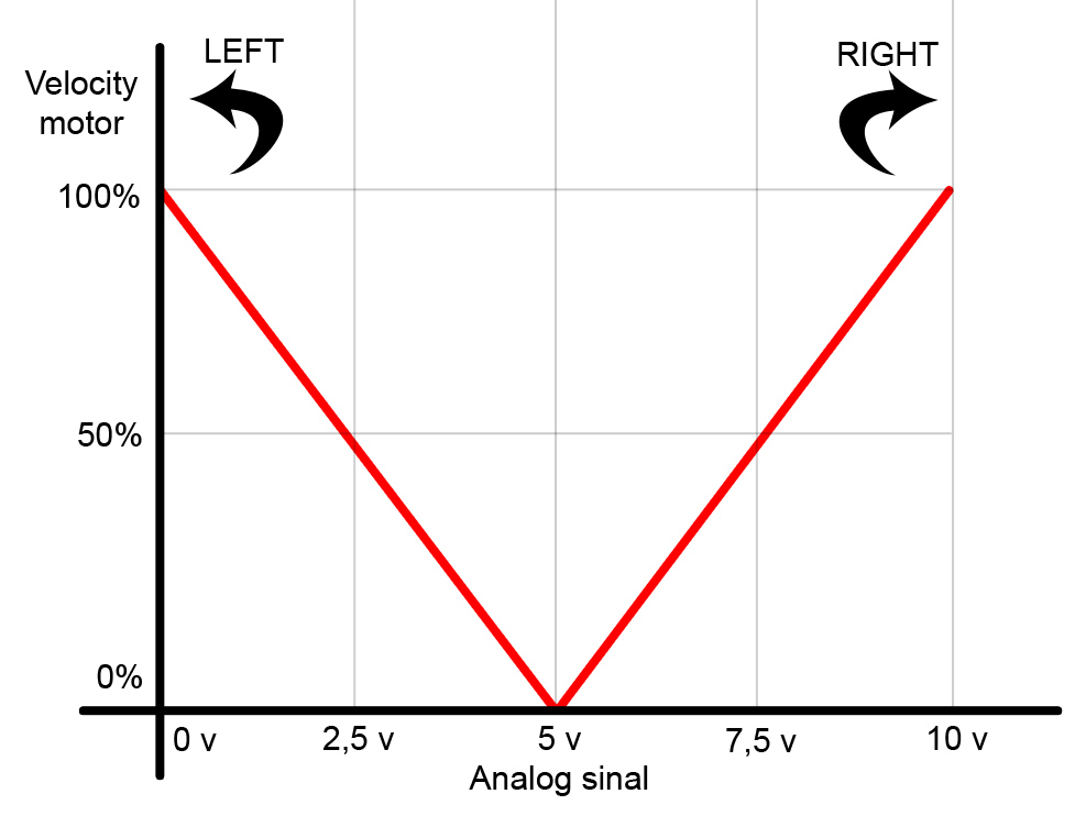

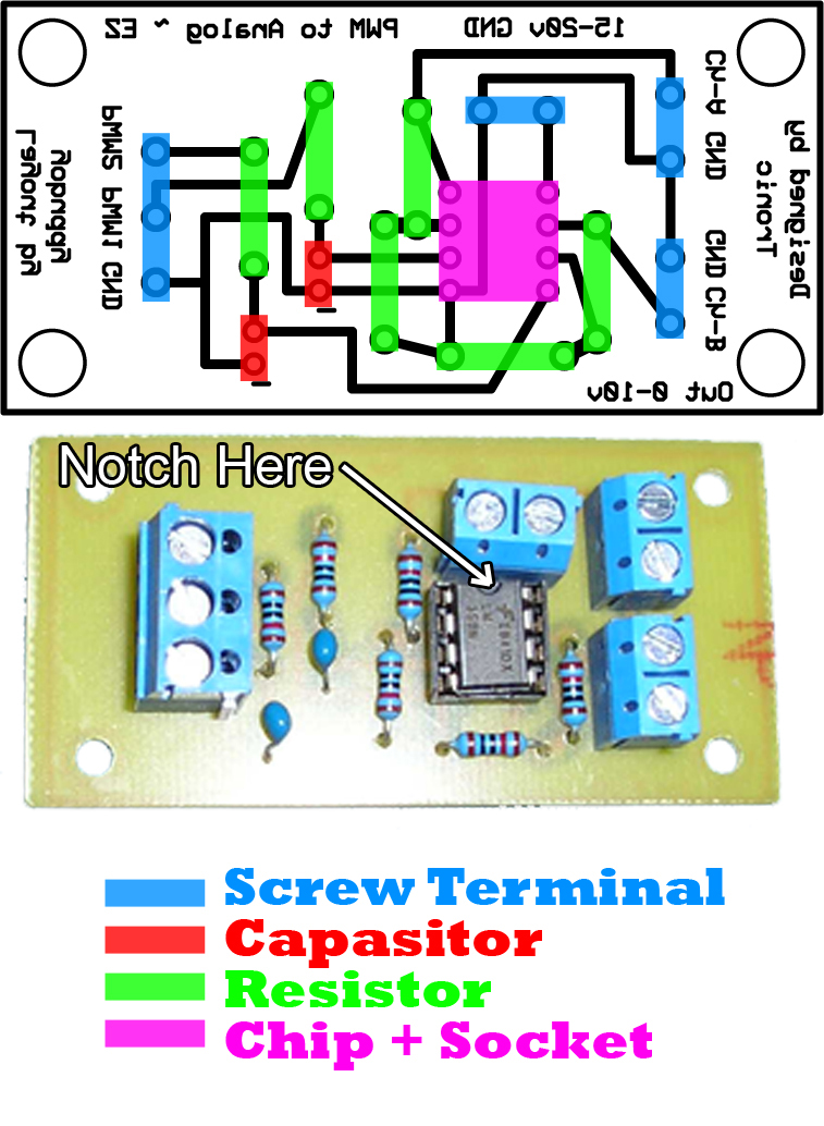

    PWM to Analog~EZ
    Build diagram
    Output produced

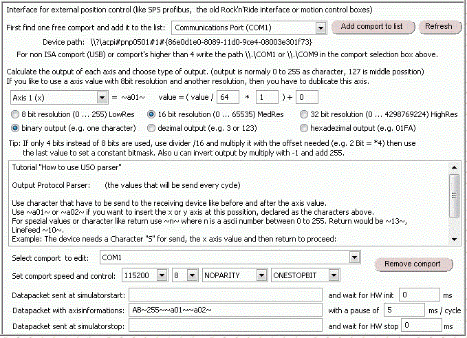

  2. bsft
    Hey , that looks great! I take it that it actually works?
    I may have to dust off the soldering iron.
    Thanks for the efforts!
  3. yobuddy

    Everything has been tested working, and I have even used the Digikey parts lists! :cheers:
