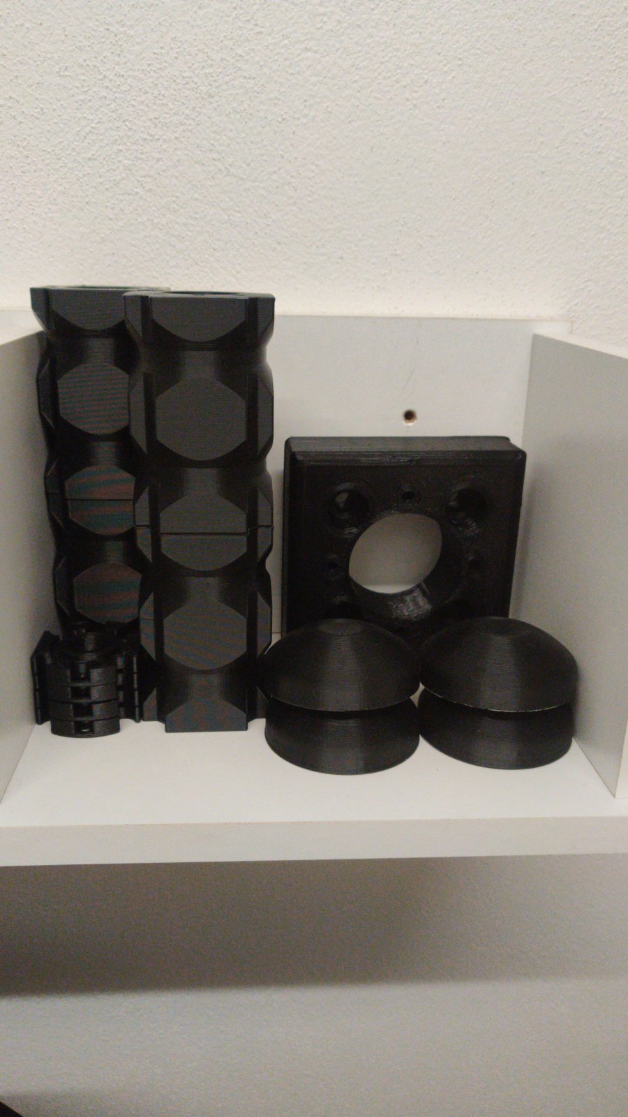

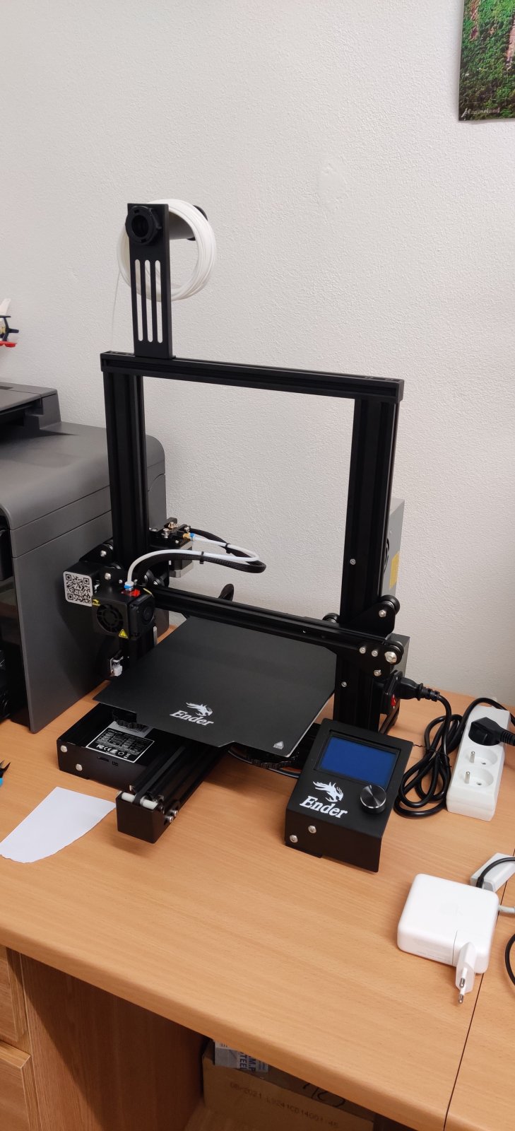

    Last part of orders were dedicated to SFX100 motors and I used german sites listed in shopping section on the official site. But most important was to get 3d printer as this on itself was exciting and new thing to play with until my orders arrive.
    I went for Ender 3 Pro printer which is reasonable priced and offer very good out of the box quality. I didn't used Simplify 3D as Prusa Slicer (free) have original profile for this printer and it offers all requested features for printing the parts. Once again I got to perfect hints for faster printing of some of the parts here:
    https://www.xsimulator.net/community/threads/diablo2112s-4-axis-sfx-100-build.13571/page-3
    Printing of the parts taken little more then one week with all the setup for both 0.4 nozzle and 0.6 used for some parts.

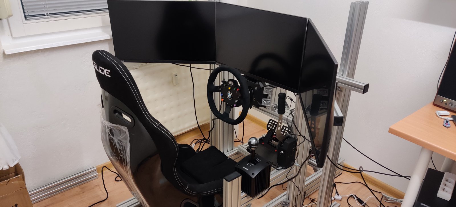

    Phase 2 - Static rig
    When I received all aluminium parts and wheel I started with static rig assembly. Again it was very fun experience as I like this kind of manual work after long day behind PC. Profiles are amazing as they are easy to connect together and offers adjustability in many directions. The assembly didnt took too long and I was able to play, test wheel and enter completely another dimension in terms of precision, sturdiness and immersion as 3 x 27 inch monitors as close as they can be are huge step up from my single 24 inch monitor very far away with my previous setup. I can recommend this site for setting up FOV and angles of them as this is very important to have exact to mimic real world:
    https://forum.reizastudios.com/threads/tutorial-fov-triple-screens-immersion.4009/

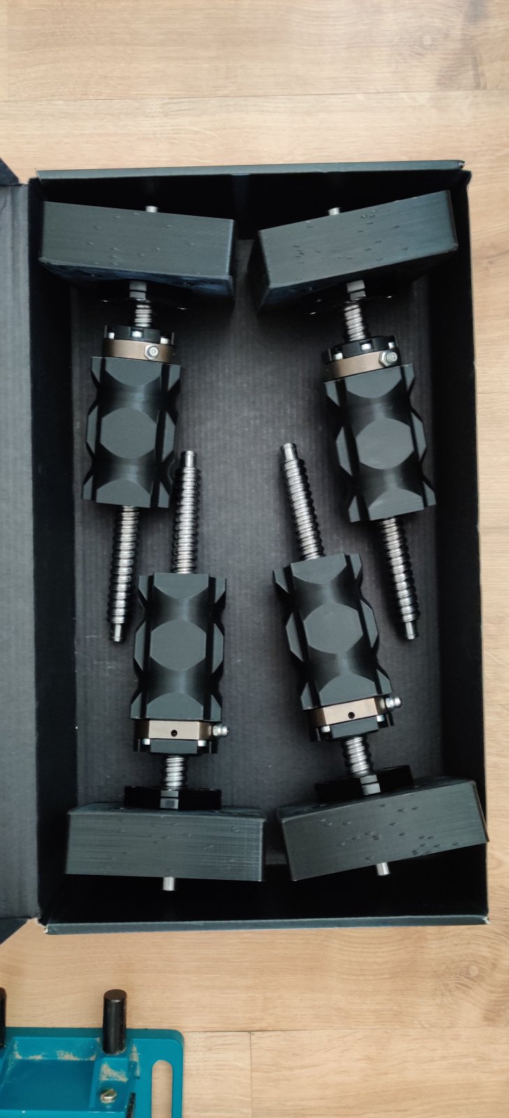

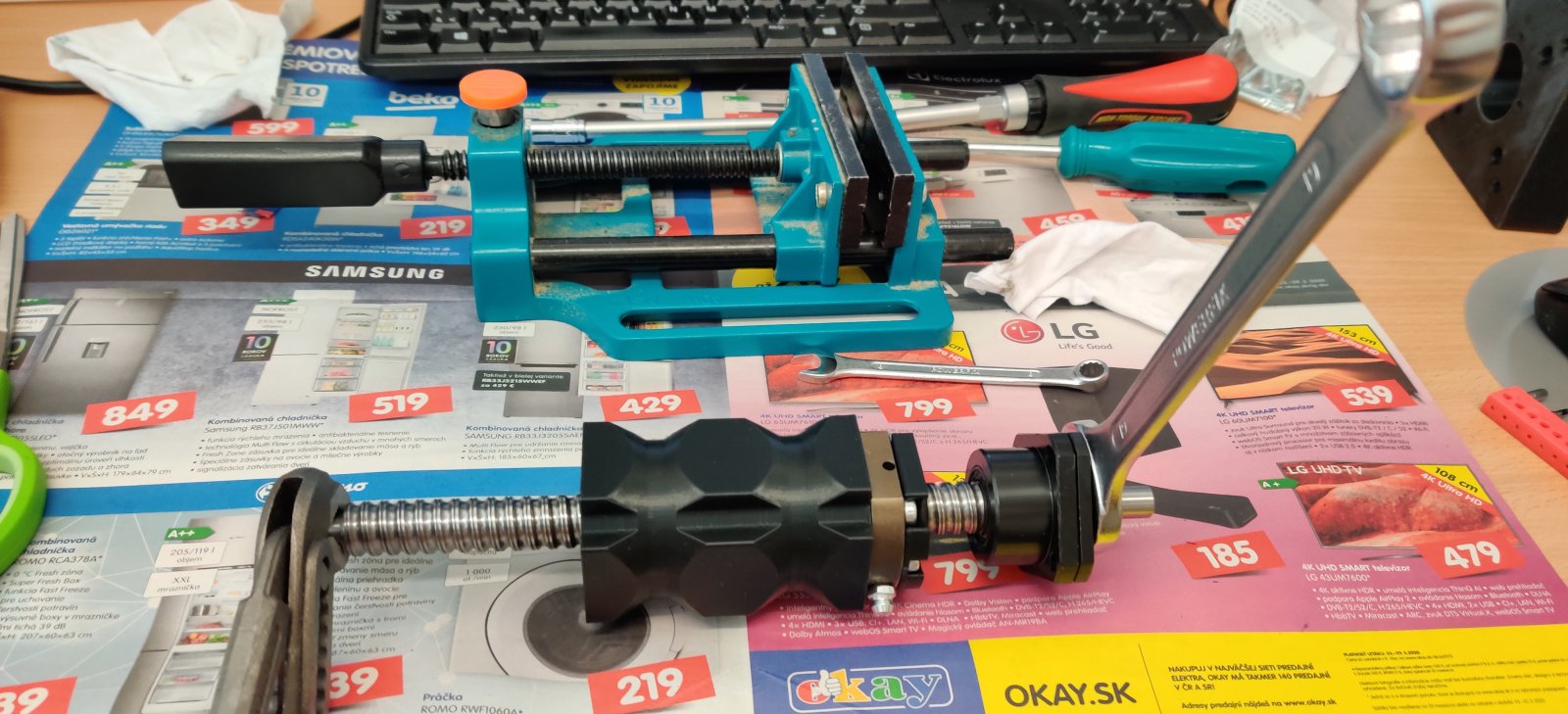

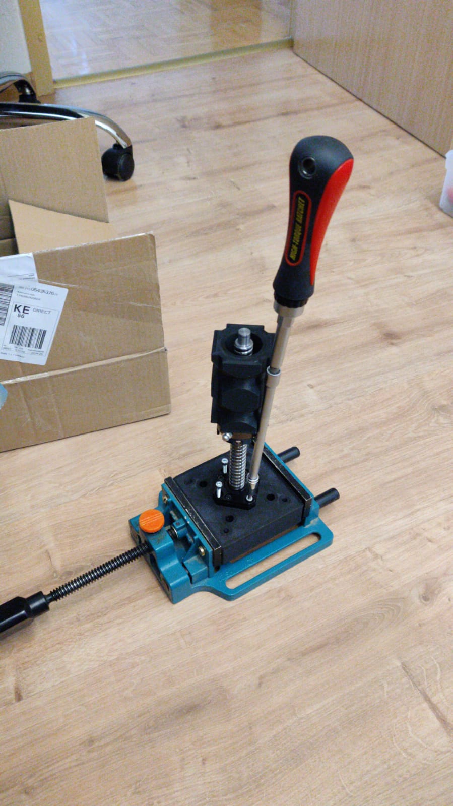

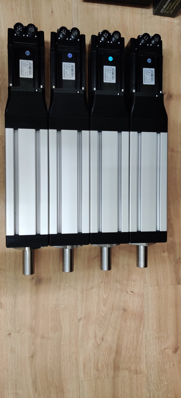

    I started to assemble the actuators and actually I can link few posts that helped me a lot:
    http://www.bogdanberg.com/2020/02/08/diy-motion-simulator-part-1-intro-photos-shopping-list/
    and of course official documentation
    There is few things I would like to highlight as I did them wrong and they slowed me down:
    1. Make sure you have bearings oriented the right way before you tight anything. It happened to me that I tight fixed bearing screw and then I realized it's upside down. It's not really fun to disassemble it if you used a lot of force to tight it :D

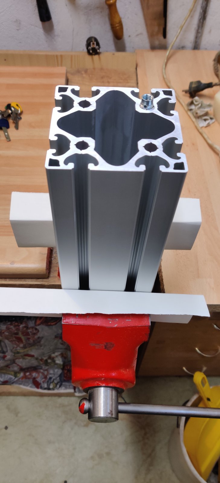

    2. Make sure you orient thread insert with the part that dont have threads first into aluminum. It makes them perpendicular almost automatically. It is mentioned in official guide but apparently not enough as I started exactly opposite and had to use a LOT of force and some of the holes were not straight. But at the end I was able to assemble the motors anyway. I fixed the orientation in the middle of threading.
    3. I bought grease gun but it was such a mess. The grease is coming out every other place just not into the bearing nut. I end up not using the gun and applying the grease directly into the ball screw. I think it will not have any effect. Also there is a lack of info about which grease to buy but I found out it should be Lithium grease (maybe others as well) and you probably find it in your local hardware store without problem.

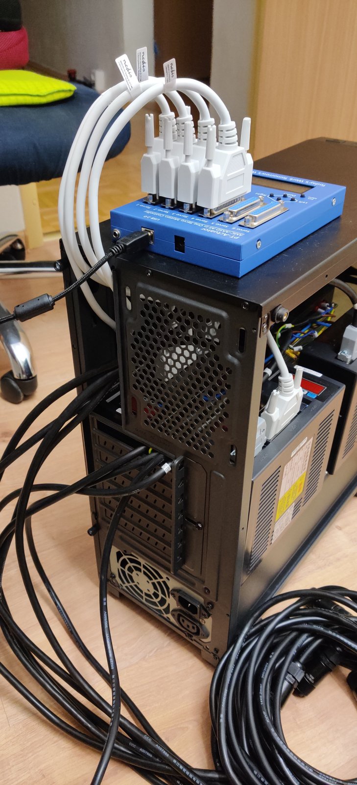

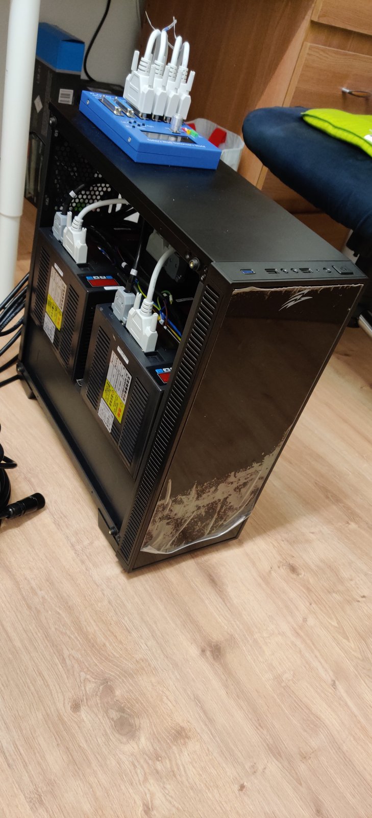

    Last thing I want to mention is that from the start I was thinking that maybe I want to have Traction loss added in future and found out that there is out of the box controller that supports this. Its called Thanos and its amazing as you dont need to assemble electronic parts of SFX100 and it offers connection to SimTools and Max of 7 Axes movement. So future upgrades for Traction loss is very easy.
    https://www.tindie.com/products/tronicgr/amc-aasd15a-servo-motion-controller/
    or
    http://www.pt-actuator.com/a/products/p5/45.html

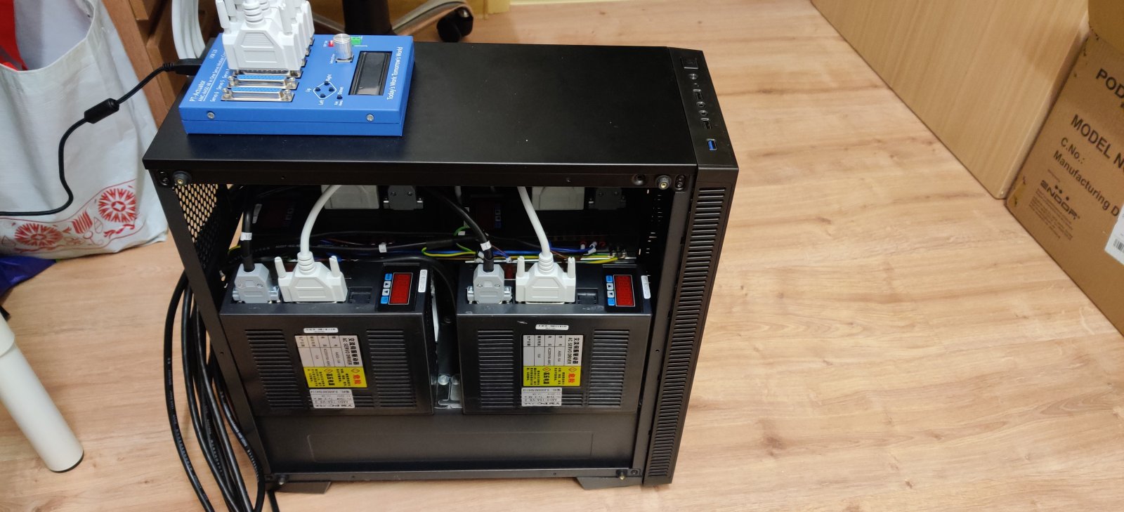

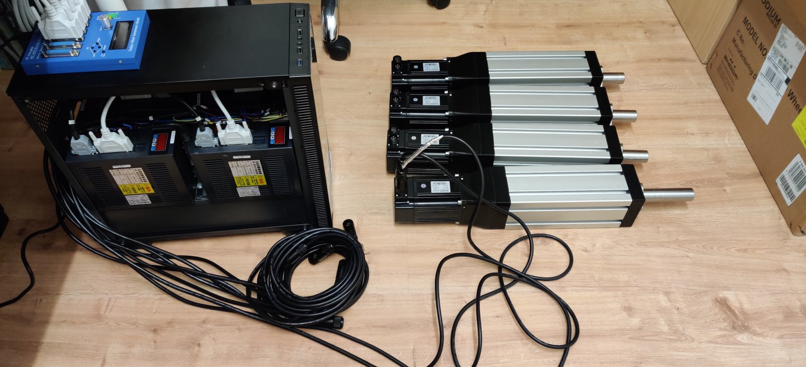

    During reading through the different blogs for assembly I noticed that the power controllers of motors are mostly put into RAC cases that are pretty big and maybe not necessary. I did measure the controllers and started to find PC case that fits and I was able to find this one:
    https://www.evolveo.com/sk/caer2
    It have glass side so I will see parameters of controllers if I need to and I mounted Thanos at the top of of it for quick access. I think it looks better and it's more compact. Not sure if there will be problem with no cooling but I will add there one or 2 fans in that case.
