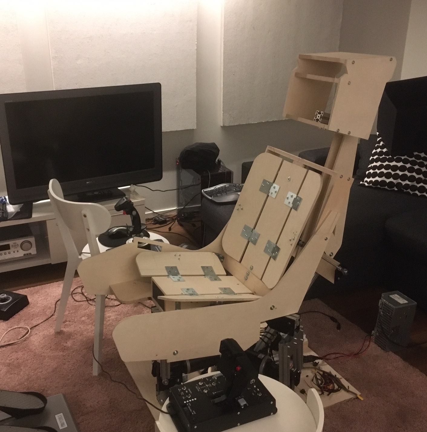

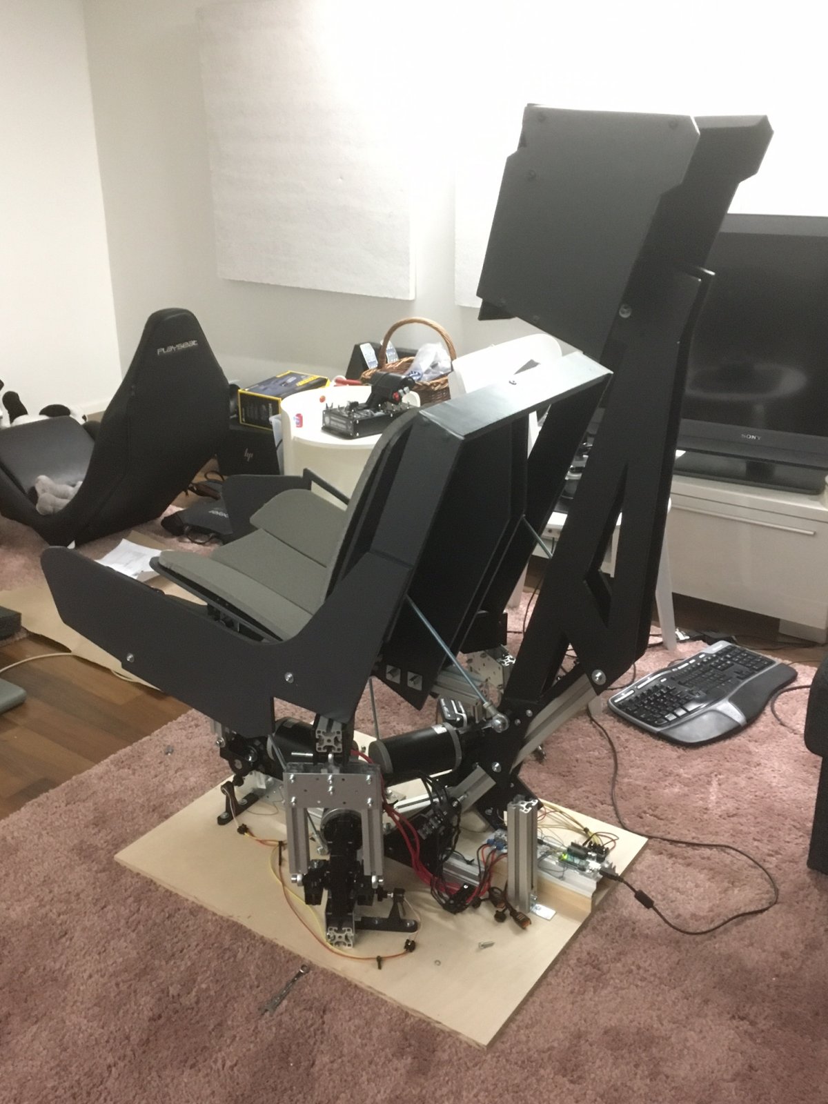

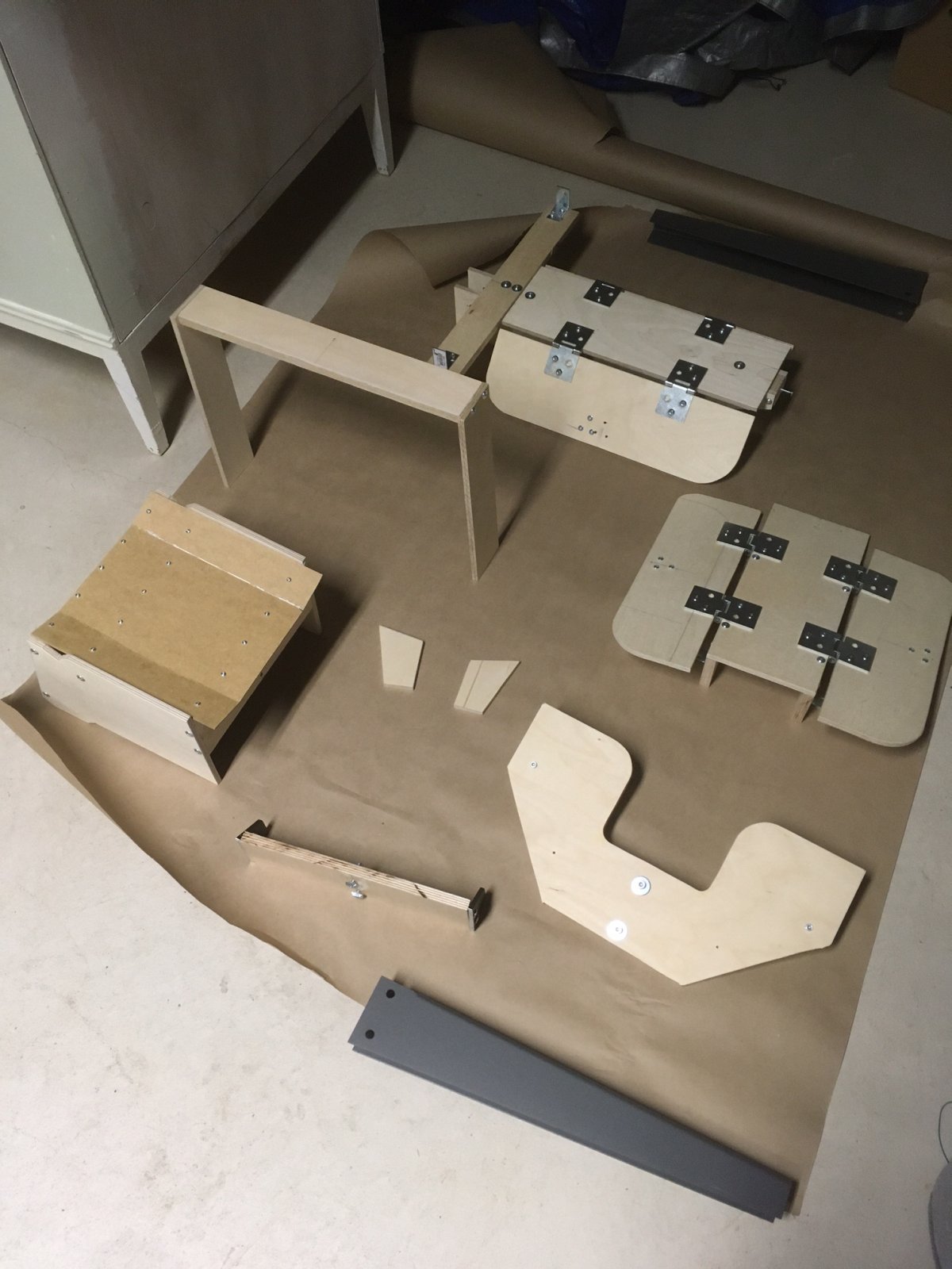

    Some (slow) progress over the week;
    Finished the woodwork for the seat: side panels and headrest, including support.
    Painted the wood parts.
    Cut some pieces of foam for the first layer of cushioning.
    Put the thing back together.
    Next I'll add another layer of softer foam and try to make the textile finish. 4-point seatbelt has also arrived so hopefully that will be included as well in a few days.

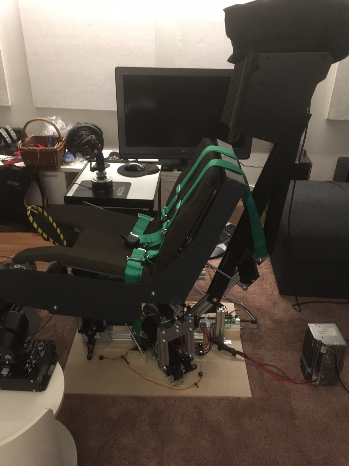

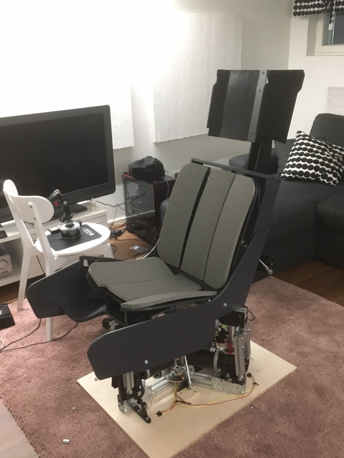

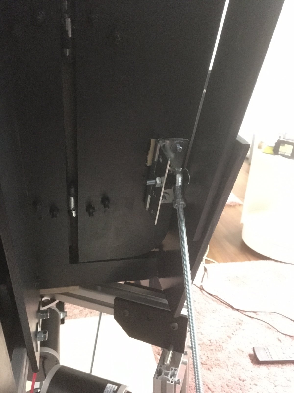

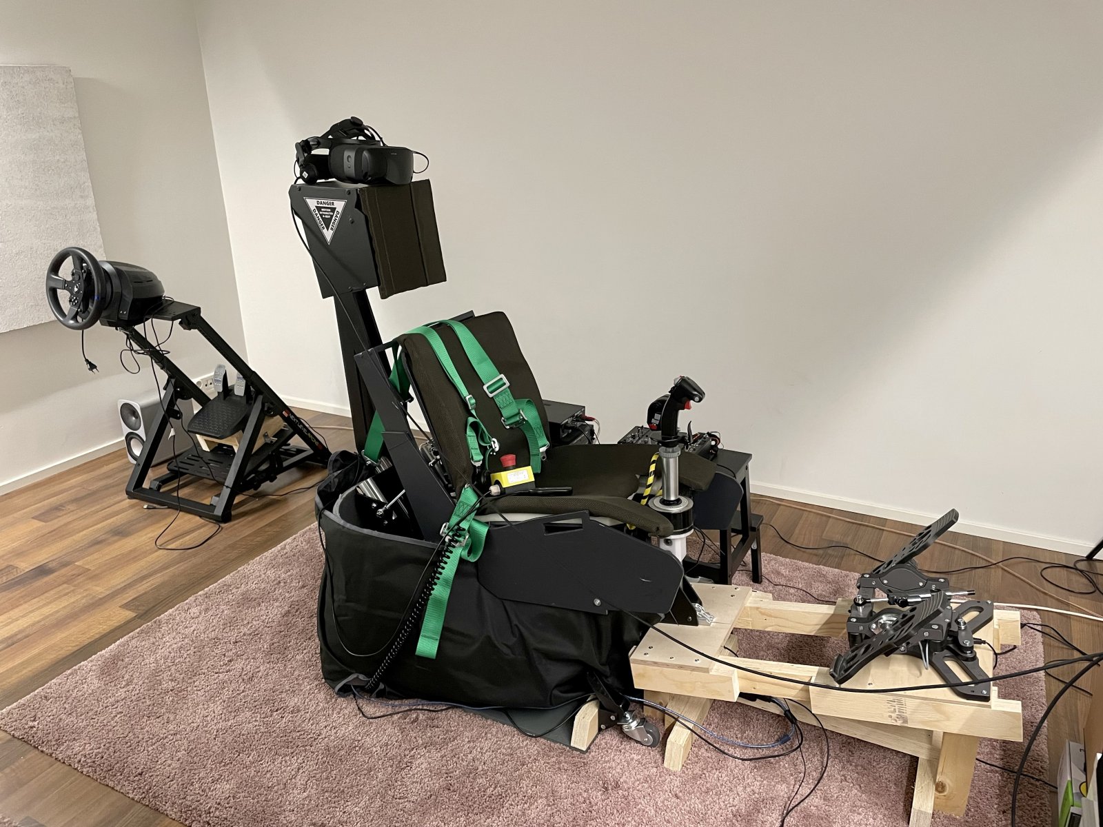

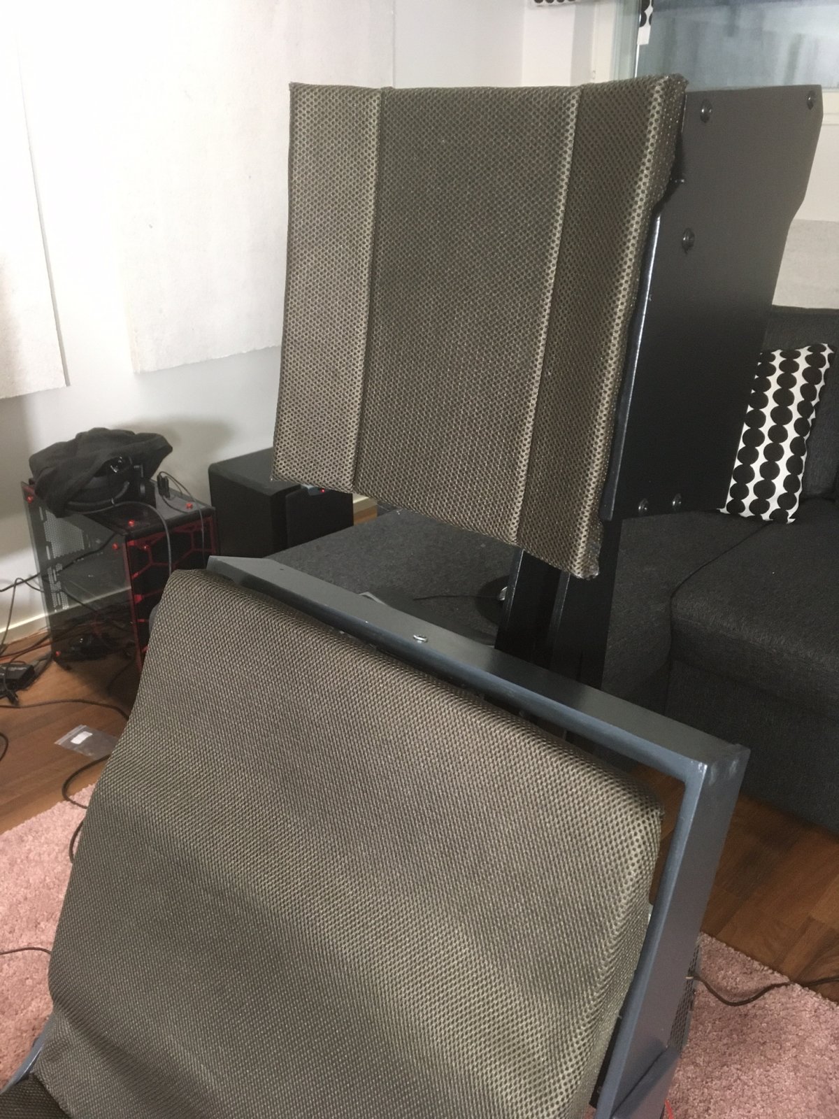

    And thanks also for the tip about glueing the fabric for the cushioning. I went ahead and did that. I used some mounting glue that doesn't dry instantly for the large surfaces, and then hot glue for the sides.

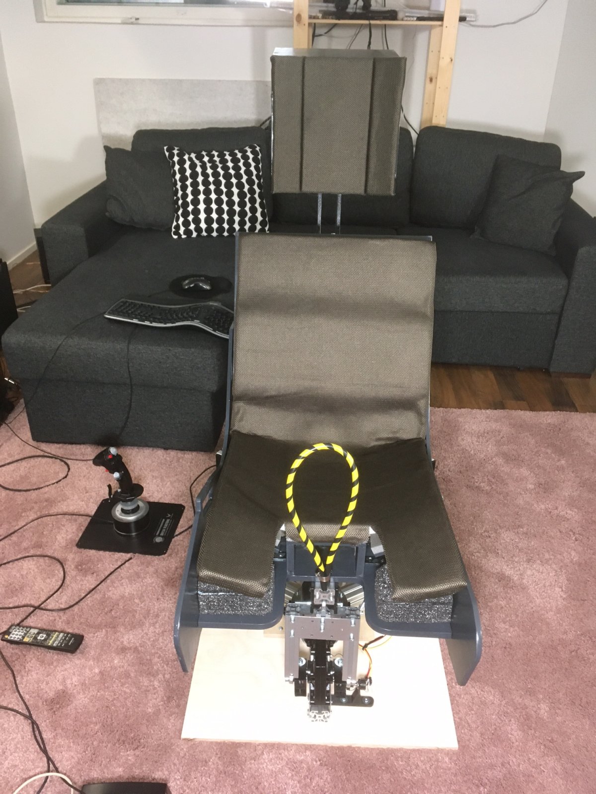

    So here she is ! Some photos attached.
    The fabric I chose is two-layer polyester mesh; it was available in dark olive color and I figured it could work here.
    The ejection handle is still not connected to anything. I'm thinking of adding another Arduino to work as a HID keyboard or joystick to operate it. It'll also need some kind of lever mechanism to operate a push button when you pull the handle.
    During testing I also noticed that the ball joints of the backrest g-flaps didn't allow enough movement. That caused stress on the seat when motors were trying to force it. I realized that I needed to change the solid L brackets to hinges. Now the flaps can move freely to almost any angle and, as a bonus, became also more silent. (Update 2023: I built a better solution; both ends of the rods moving the back flaps are connected to 3030 alu profile)
    Stuff to be done:
    - Testing and fine tuning motors and DCS game profile.
    - Seat belt.
    - Probably some mechanical tweaks.
    - E-stop.
    - Casing/walls around the cranks and other moving parts to protect fingers / toes.

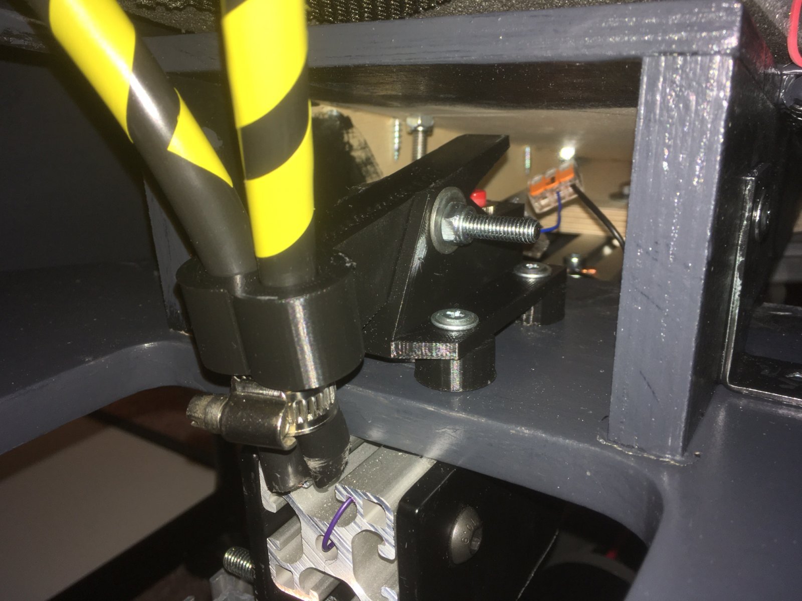

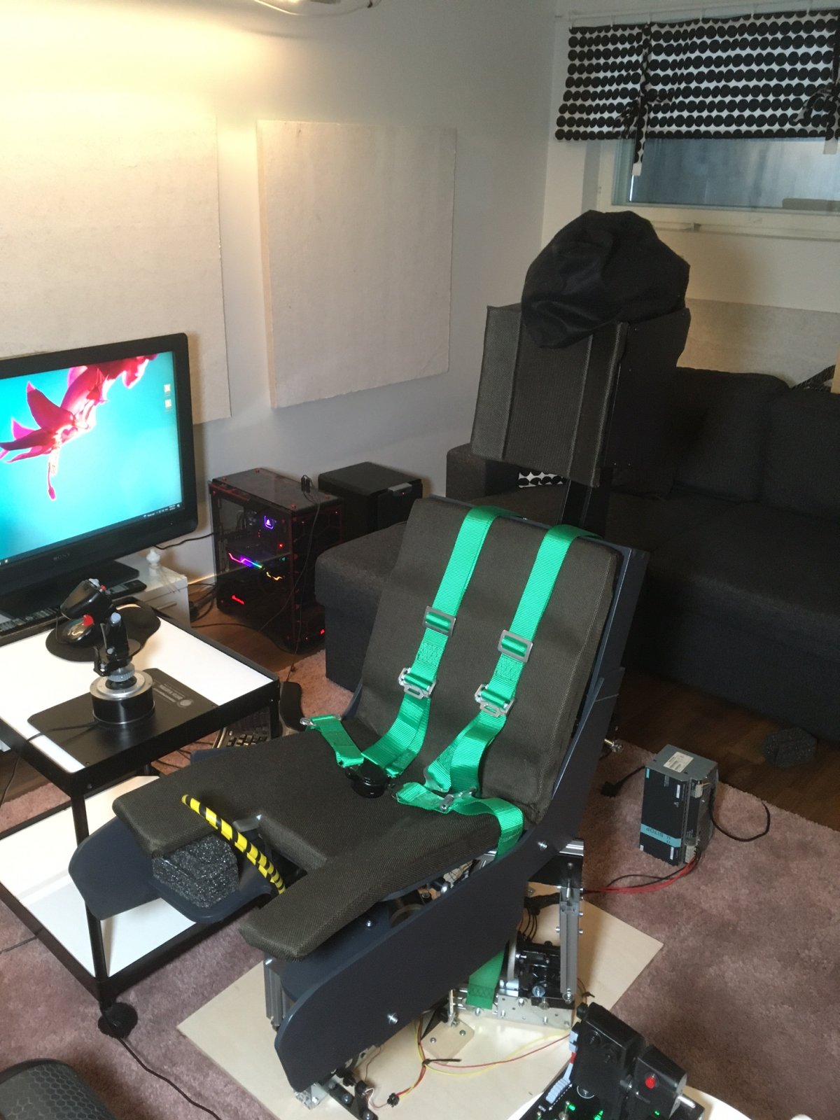

    Few photos of new advancements - getting close to finishing the seat:
    1 & 4) The ejection handle turned out nice:
    - 3d printed a simple lever that operates a small red push button
    - used Unojoy (https://github.com/AlanChatham/UnoJoy) to turn my spare Arduino Uno into a USB game controller
    - wired the button between one of the Arduino digital pins and ground
    - plugged in Arduino via USB
    - set the button to trigger ejection in DCS controls setup
    - all done and it works !
    2 & 3) Seat belt installed
    - my apologies to the community for the bright green color ! (it appeared dark green in ebay photos..)
    - I didn't think too much about the mounting points and just put them there; will have to test more to find the best position. The seatbelt also makes it a lot more difficult to check six, so you have to have them quite loose at the top.
    Btw, just the headrest gives an unexpected extra feeling of immersion in VR: In DCS, when I lean forward and look over my shoulder, I can see the virtual seat's headrest. If I then move my head closer, I can physically bump my head against the headrest exactly where it is in the simulation. A small cue that tricks the brain to forget that you are watching a simulation - at least for a moment !

    Here's one :p. Cushioning is removed so you can see the g-flaps moving. The camera loses focus for a moment a few times, probably because of the telly.
    New stuff since last post:
    - put some protective walls around the base, made of bent steel mesh at the sides and polycarbonate at the back, held in place with just tape atm..
    - installed the new gearbox; unfortunately it didn't help, but moving the faulty motor to the front removed the clicking nearly completely.
    - PC upgrades (after replacing mobo and CPU, I had to wipe out the old Windows and had to install everything from scratch, so it took me a while to get to shoot some video)

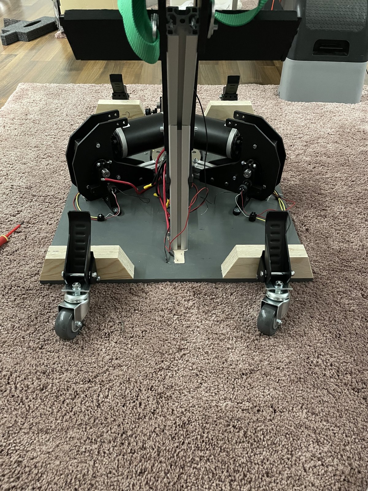

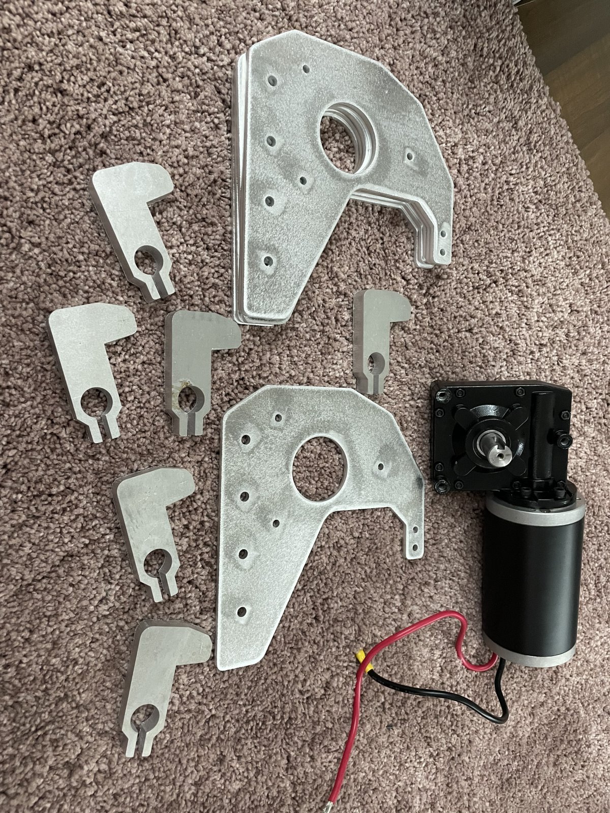

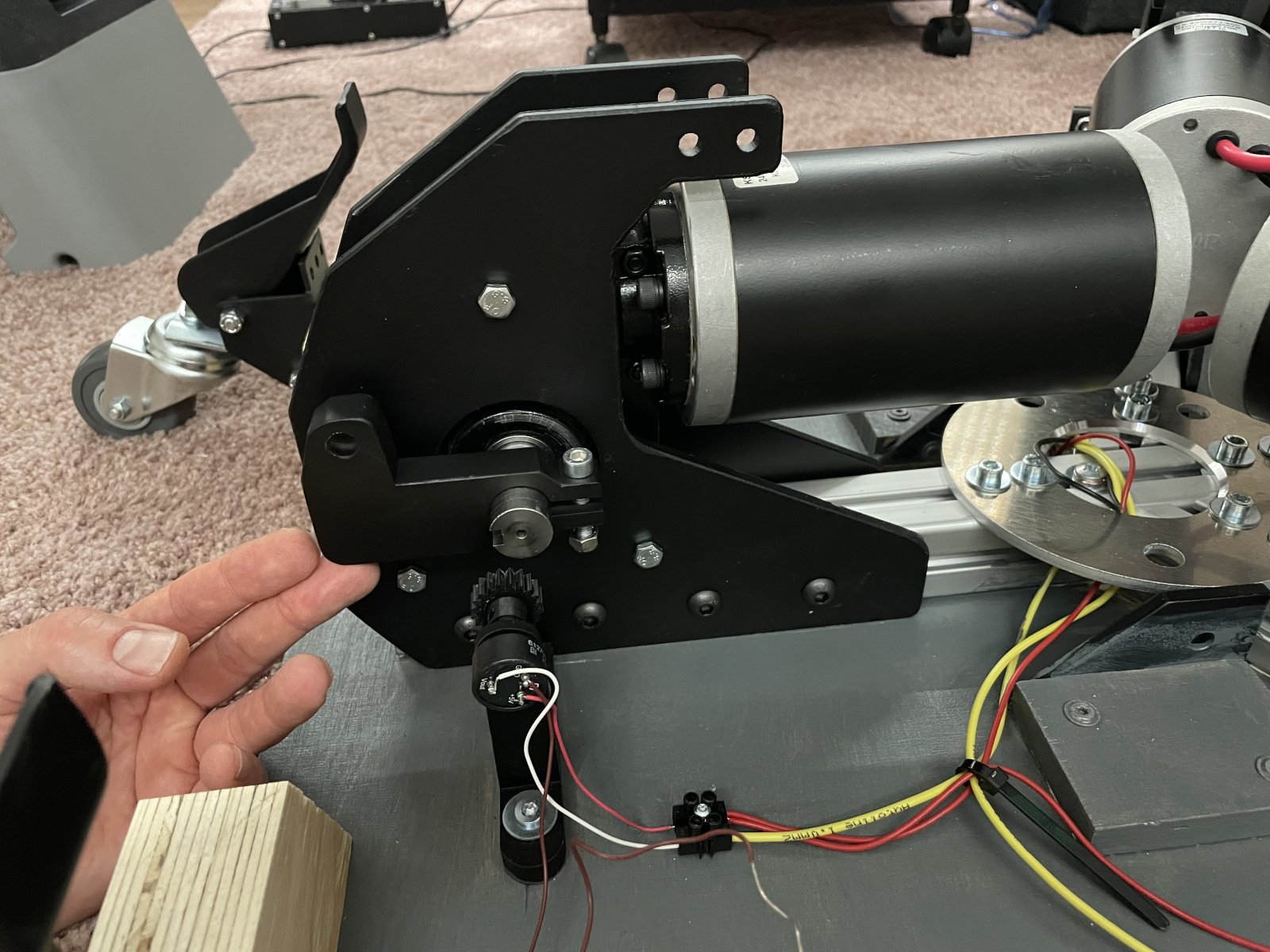

    Small update:
    I went ahead and ordered custom-made mounting brackets and cranks for the motors to make the system more rigid and to reduce small play / twisting of the base. These should also be safer for fingers than the previous setup (which was much like power scissors).
    The aluminium parts were laser cut, which was cheaper than cnc milling. Let’s hope I didn’t forget anything important while drawing these.
    Next I’ll smoothen the edges with a grinder, drill missing holes to the cranks and paint all parts black.
    I’ll post further photos once I have the base back in working order.

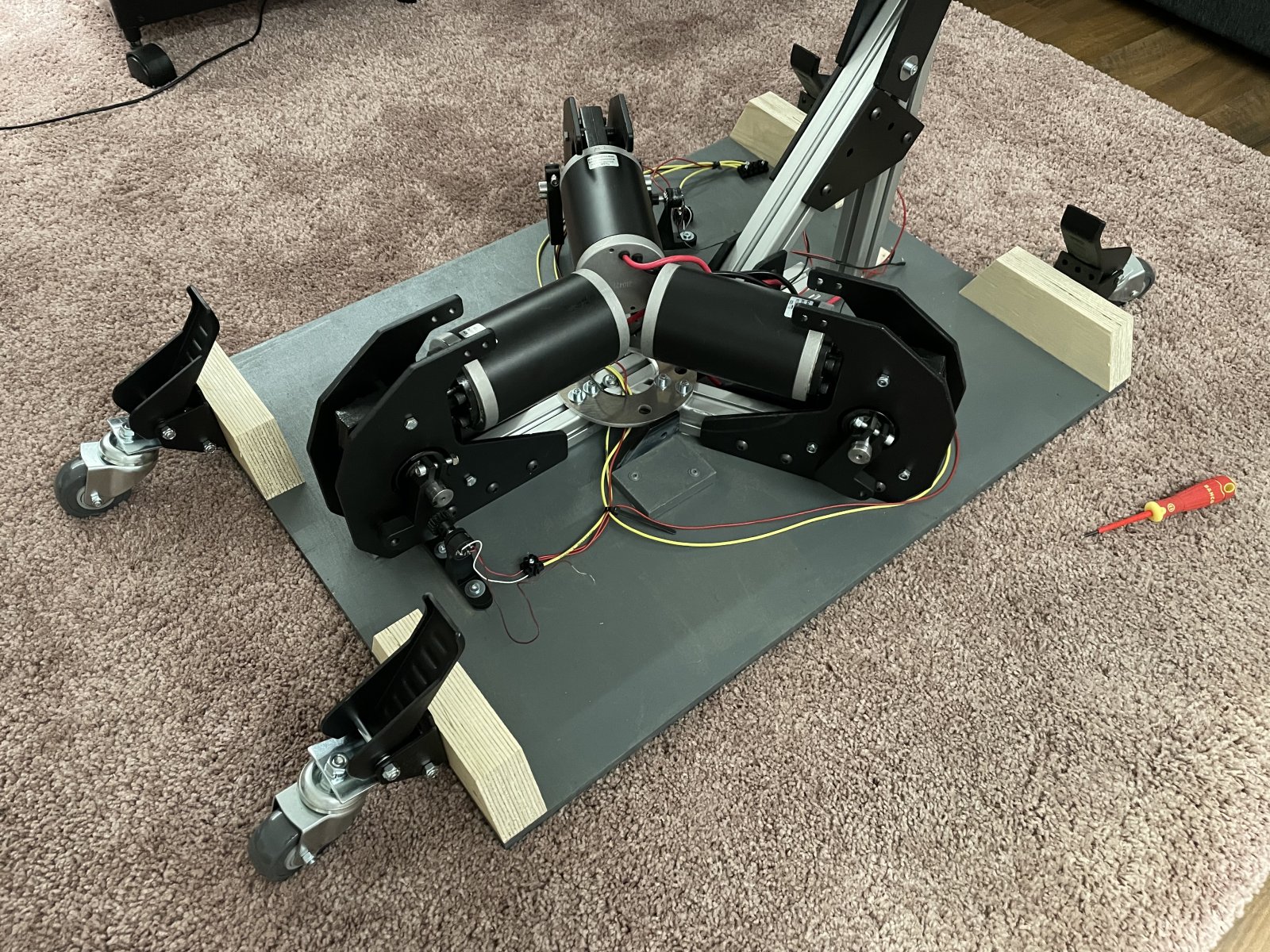

    After substantial sweating and swearing, the base is back together.
    Now featuring tiltable wheels for easy movement when not in use.
    next up is better housing for the electronics, e-stop + motor relays and a main switch.

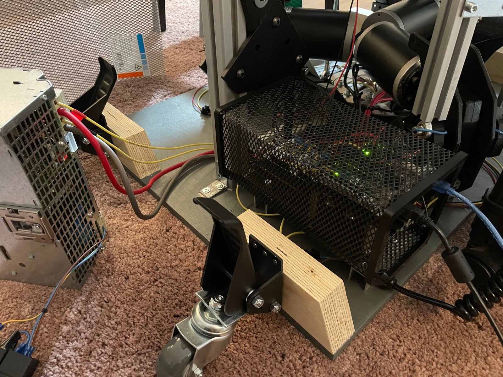

    Here's a long scribble of recent progress and tinkering.
    1. Added the e-stop button
    -- Uses 3 x automotive 24V 40A relays, one for each motor.
    -- The relays are installed between motor controllers and motors, so the e-stop kills just the motors instantly and leaves everything else running.
    -- It's a really useful addition, I press it every time I end a flight or leave the chair or when I have to fix something or if the sim movement becomes too bumpy. The button has a 1,5 m spiral cord so it can be moved around. (photo 1, on the white table next to the chair).
    2. New setup for the electronics.
    -- Adding the e-stop relays would increase the amount of wiring by quite a lot, so it was time to redo the whole electronics installation (Arduinos, motor controllers and relays + wiring between them).
    -- The components are now sitting on two layers and covered by a steel mesh. (photo 2)
    -- However, the amount of wiring going back and forth is still quite terrible and messy, so I'm thinking of separating the components into blade-like modules with plastic housings and wire terminals in the future. These could then be neatly placed next to each other much like components on a DIN rail.

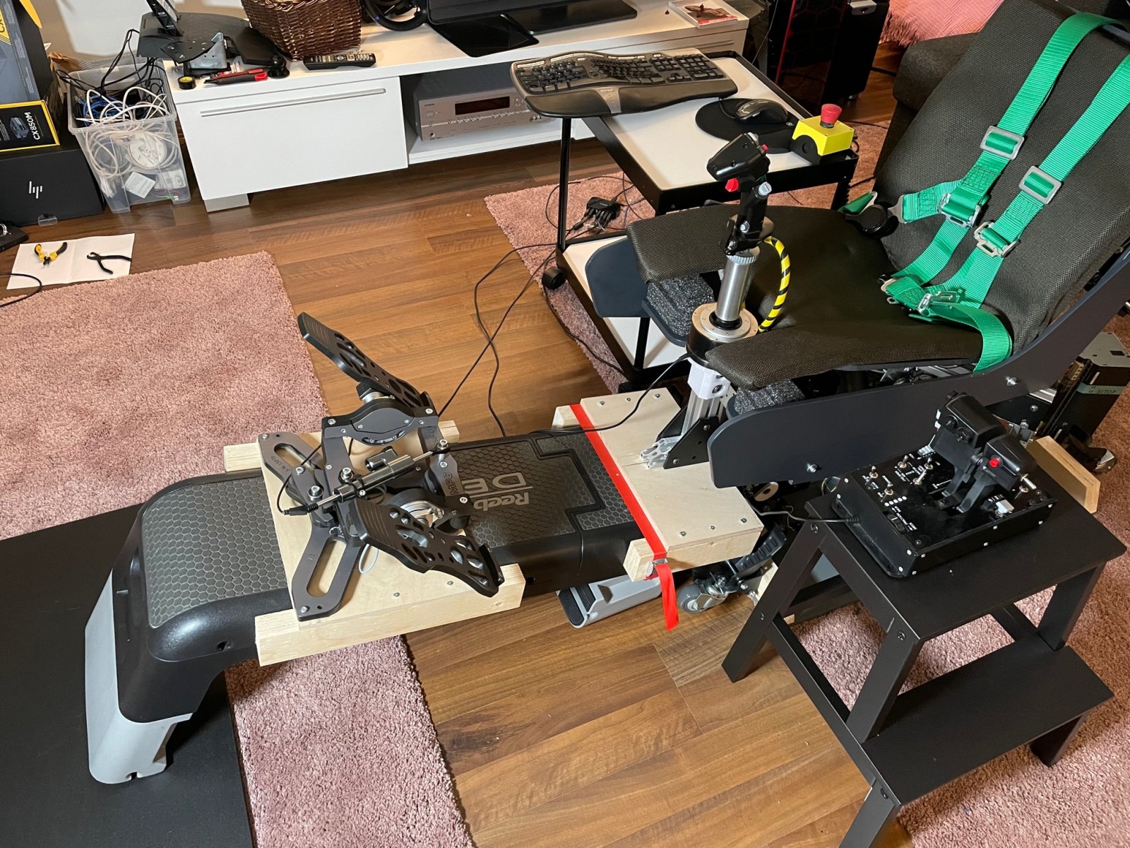

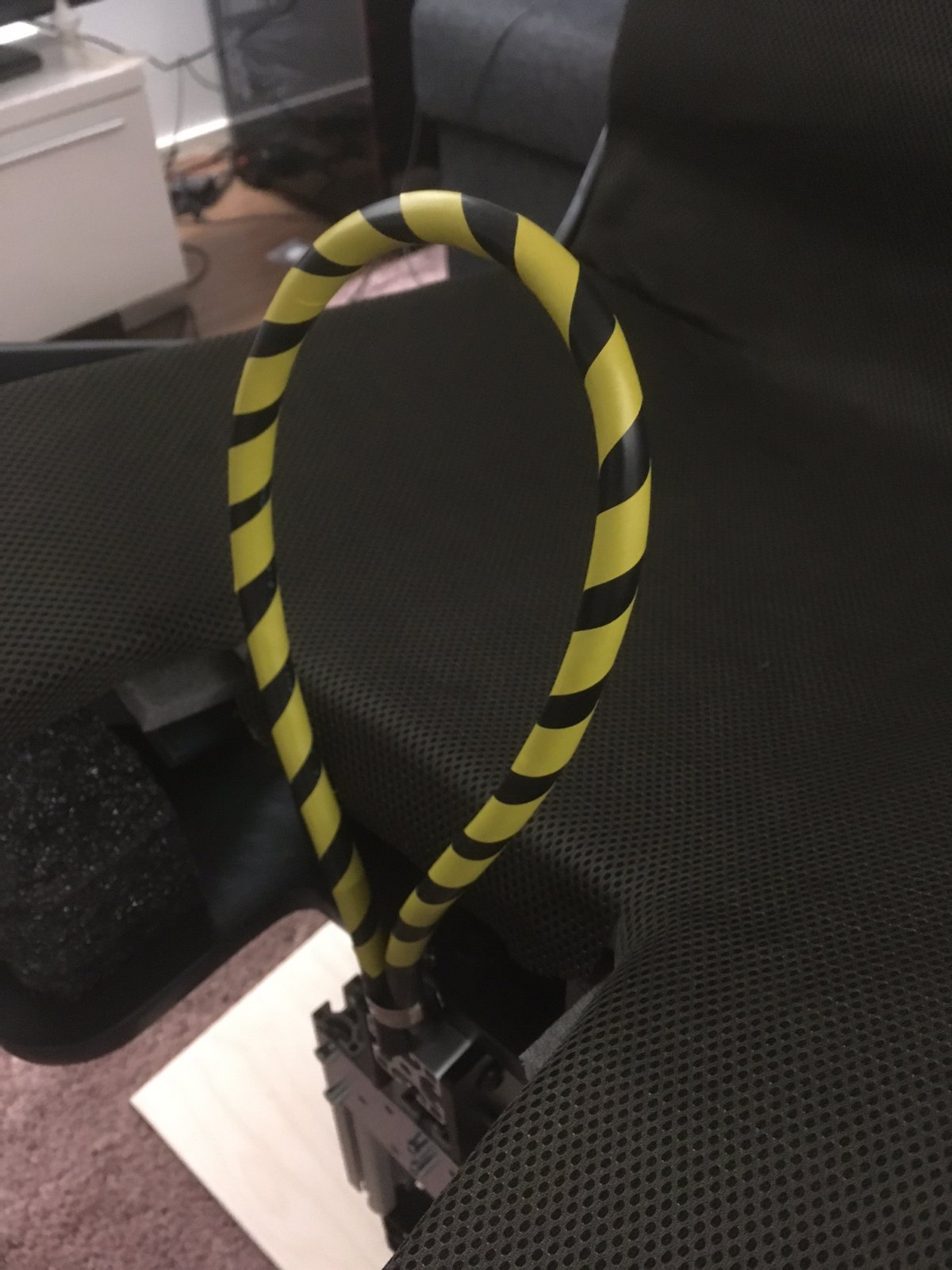

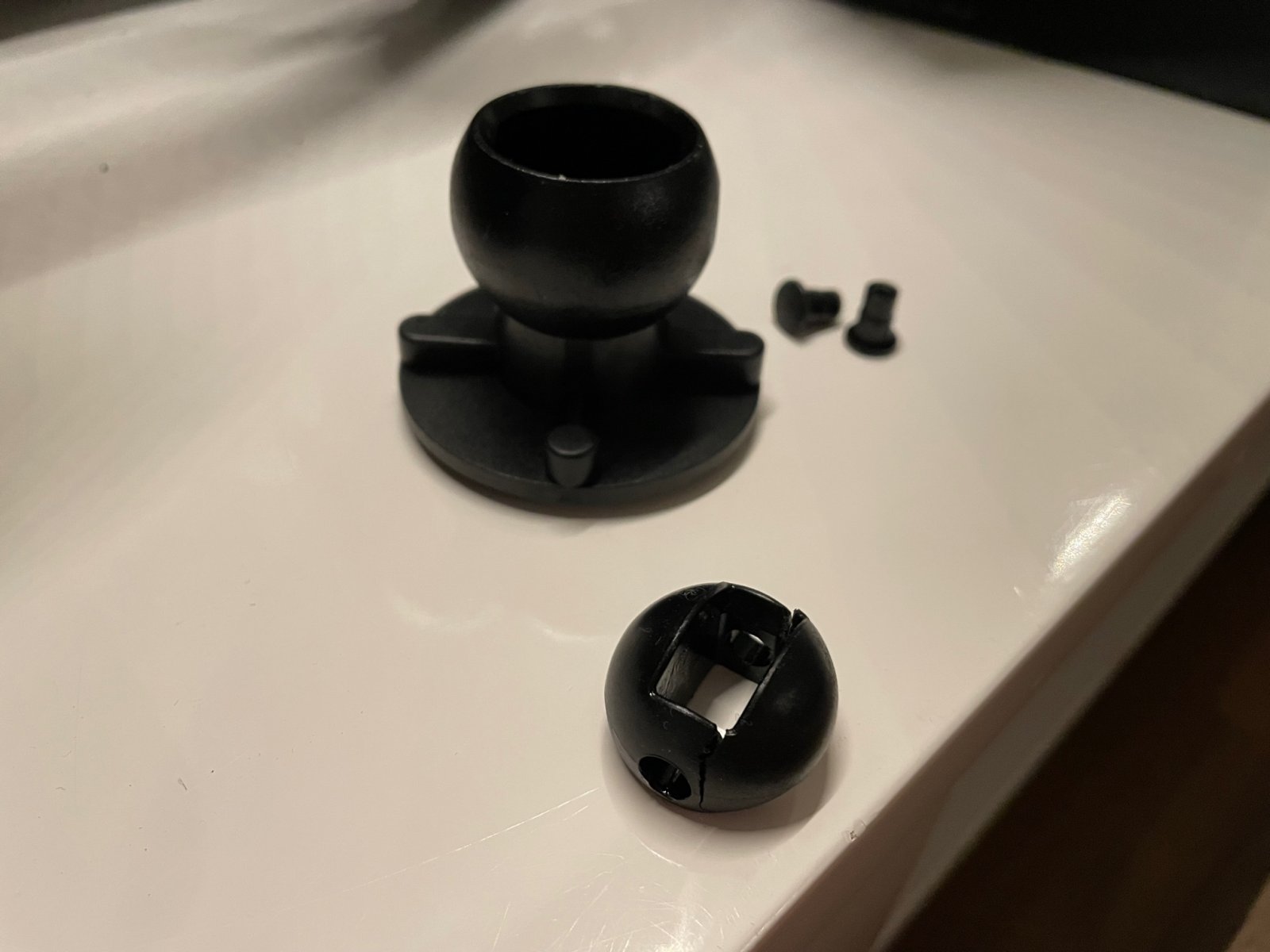

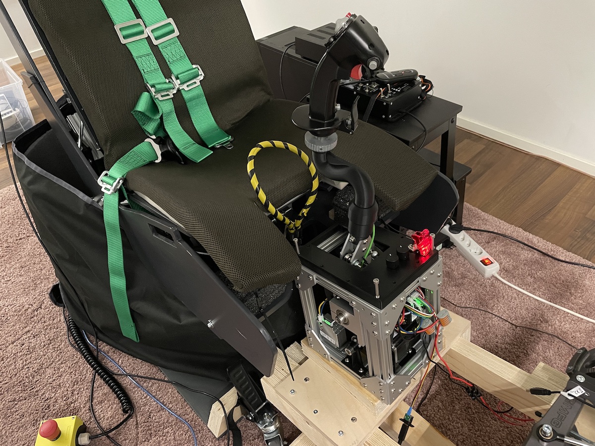

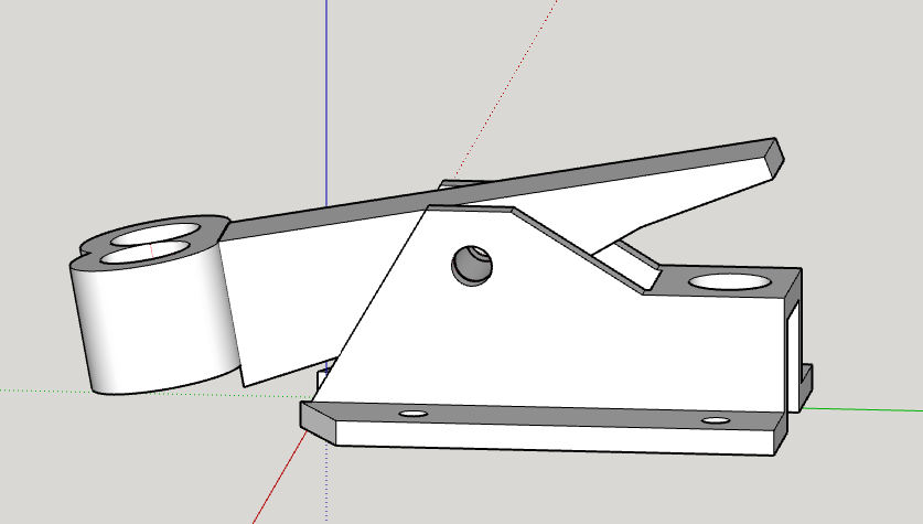

    3. New pedals, center stick and extension - and a mishap (photo 1 & 6)
    -- To make the most of the sim I invested in new pedals and a 10 cm extension for the Warthog stick.
    -- The seat was also designed to have room for center stick, so I used some leftover parts of aluminium bar to build a mount for that.
    -- Installing the pedals was quite simple, I sawed a sheet of plywood to hold them.
    -- Installing the extension should've been even simpler. But despite instructions, while adjusting it I managed to over tighten the extension and broke the Warthog gimbals :mad:. A critical internal plastic part called the "articulation sphere" cracked and nearly split in half. This resulted in a large drift on the X axis of the joystick and flying became impossible. A major disaster. The seat was otherwise just finished and I was going to actually get use it again and a new stick would cost another few hundred euros.
    (-- I've had the Warthog since 2013 so maybe it had already got some wear before, who knows)
    -- After reading online forums on how to fix the broken part or how to get a replacement part, I came across a project about 3D printable DIY gimbals + ball bearings to replace the Warthog's ones (https://www.thingiverse.com/thing:4550666). It looked like a cheap, feasible and interesting undertaking so I gave it a go. All I needed to get were the Tamiya ball bearings and some fine sand paper.
    -- It took a bit of sanding and several rounds of assembling/disassembling the Warthog base to get it right, but the end result is a buttery smooth Warthog stick with virtually no center detent, play or deadzone. Way better than the original one and works fine with the extension too.
    -- Also notice the fully adjustable plywood+aluminium installation for the pedals and stick on a Reebok stepper board :p It's great because it's heavy enough to stay in place by itself and you can step on it when getting in and out from the seat. And you can just lift the parts away without any tools if a family member feels like exercising.

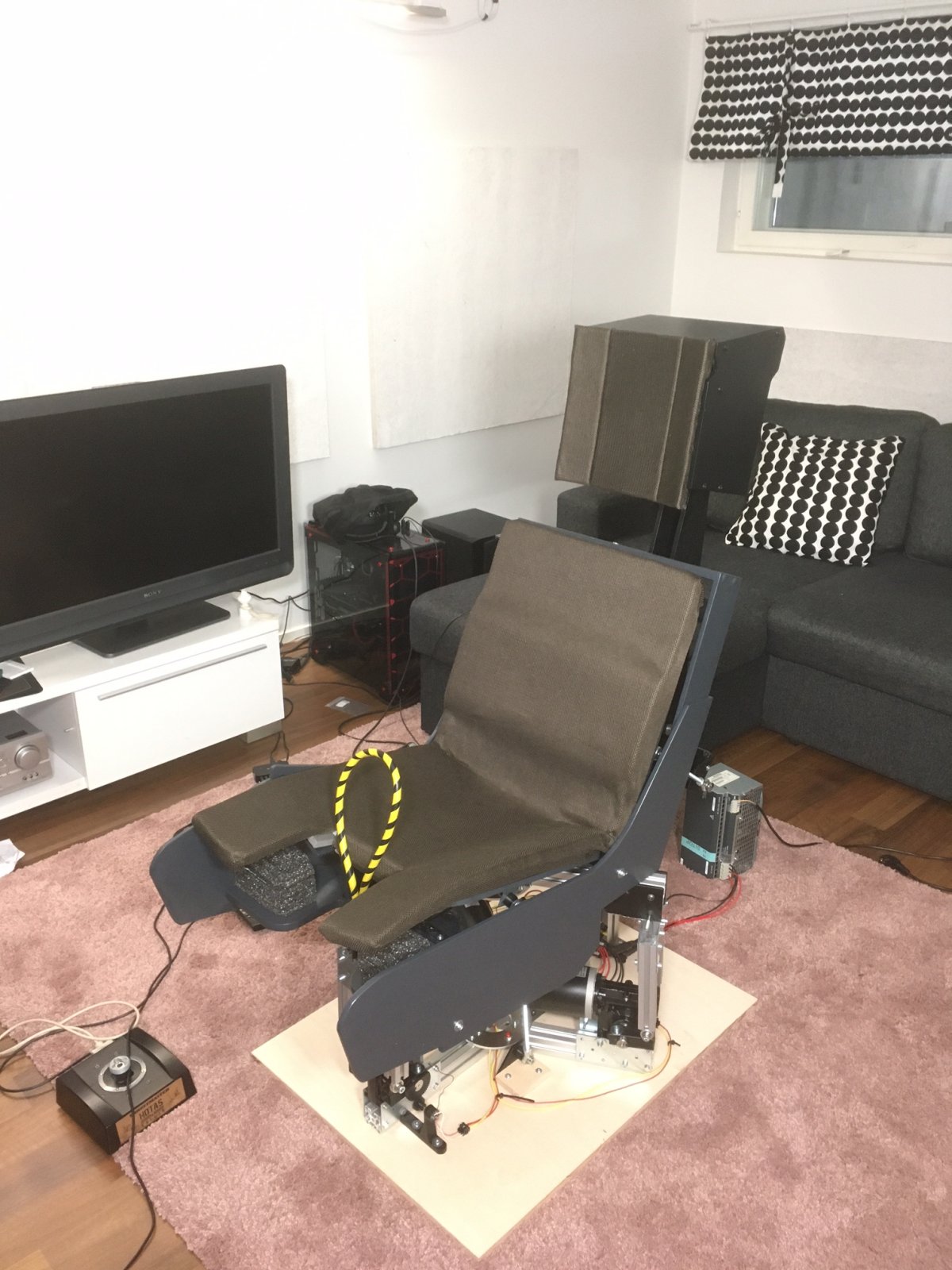

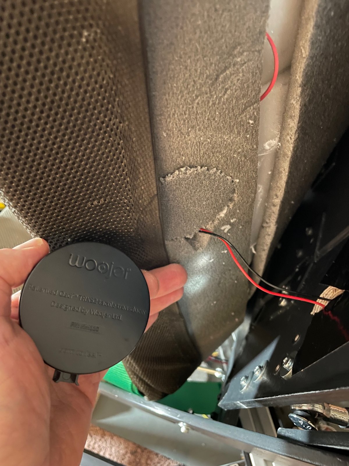

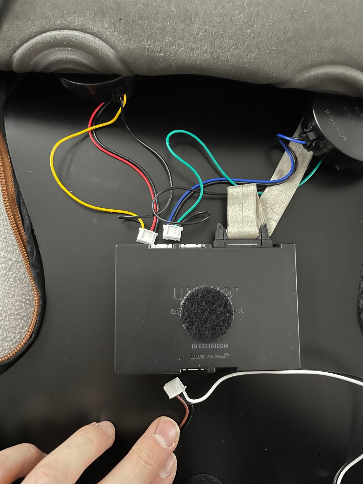

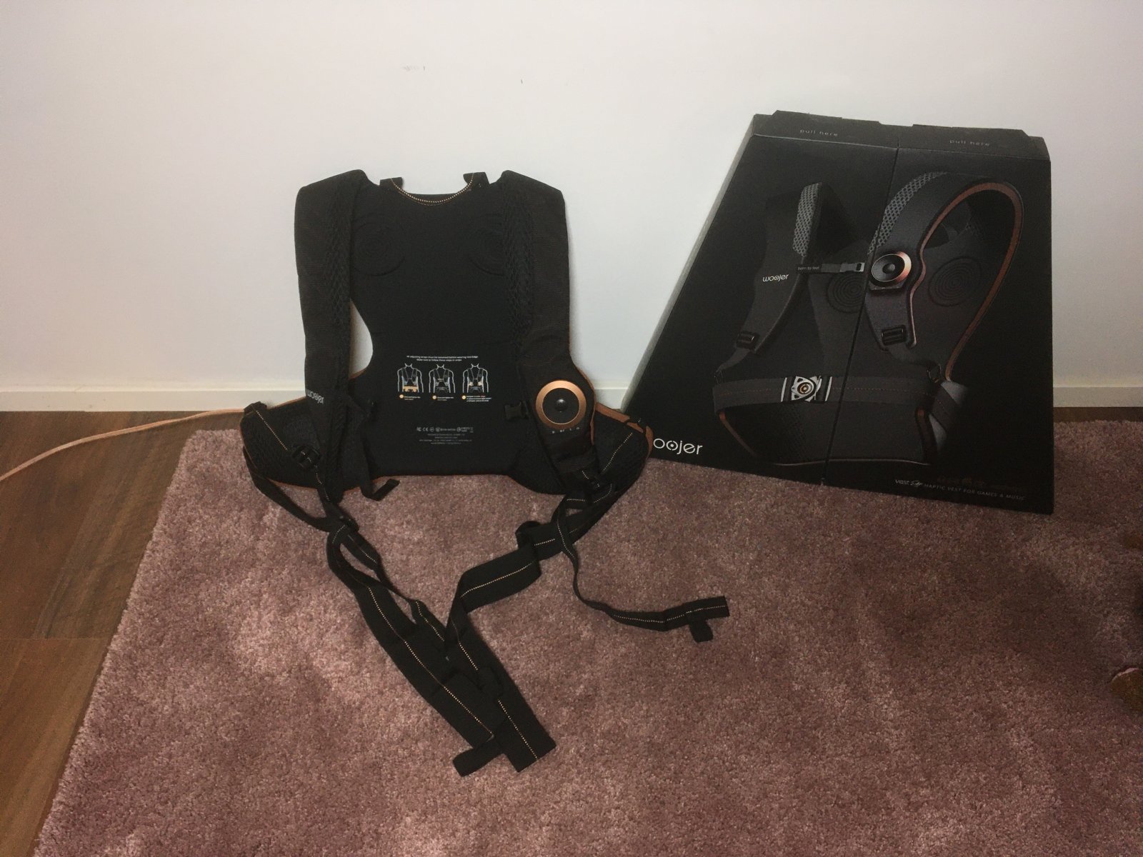

    4. Haptic vibration effect / reused Woojer Edge vest (photos 3, 4 & 5)
    -- Before I built the motion sim I tried using a second hand Woojer Edge vest for increased immersion in VR flying. It's a haptic vest with stereo effect and connects directly to PC via USB or Bluetooth. It worked ok together with Simshaker for Aviators + Sound Module software.
    -- While building the seat I didn't think about the vest or its dimensions. I tried it on a couple of times after the seat was ready, but the shape of the vest's lower back made it very uncomfortable to wear on the g-seat, so it was abandoned, collecting dust on the shelf.
    -- I tried to sell it on a few online marketplaces with no luck. Finally the Woojer went out of warranty now in August. So, now it would get a new life inside the motion sim :cool:
    -- The vest was easy to open with zippers, everything was neatly attached with velcro and all of the wiring was with connectors, so taking everything out was simple. Only its round UI unit with USB and charging connectors and push buttons had to be cut out with a knife, as it was tightly glued to the fabric.
    -- The vest came with 6 small round transducers; I've so far placed two on the back g-flaps and two on the bottom g-flaps, by cutting round holes in the cushioning. Installing it was dead simple, just reconnected the wires and included battery to the Woojer control box.
    -- The last two transducers I might attach on the Warthog stick pylon and the pedals later to see if that can provide some slight feedback via the controls.
    -- The effect is not very powerful (probably nowhere near a buttkicker or some other sofa shaker), as the transducers are quite small and are meant to be tightly pressed against the user with the vest's straps, but it's enough to feel some vibration of the plane's engines / stalls etc. The Simshaker software has a lot of adjustments that can be played with to increase the effect or to emphasize certain effects, so I'm positive I can improve the effect a bit further.
    -- Overall, it's a nice addition. I'm happy to have use for the Woojer finally, and didn't have to spend extra €€€ on a Buttkicker system.

    Here's a more recent photo of the current state of this machine.
    - New fixture for stick and pedals; both can be moved along the frame to adjust distance
    - Racing wheel stand with pedals elevated by a bit
    - A real Buttkicker now under the seat
    - The rods moving the back flaps now attached to pieces of 3030 alu profile for easy adjustment and better angle
    - Extra layer of foam under the butt..
    - Varjo Aero VR headset (I found it second-hand - an amazing headset with eye tracking for MSFS And DCS)
    Next up will be a new video.

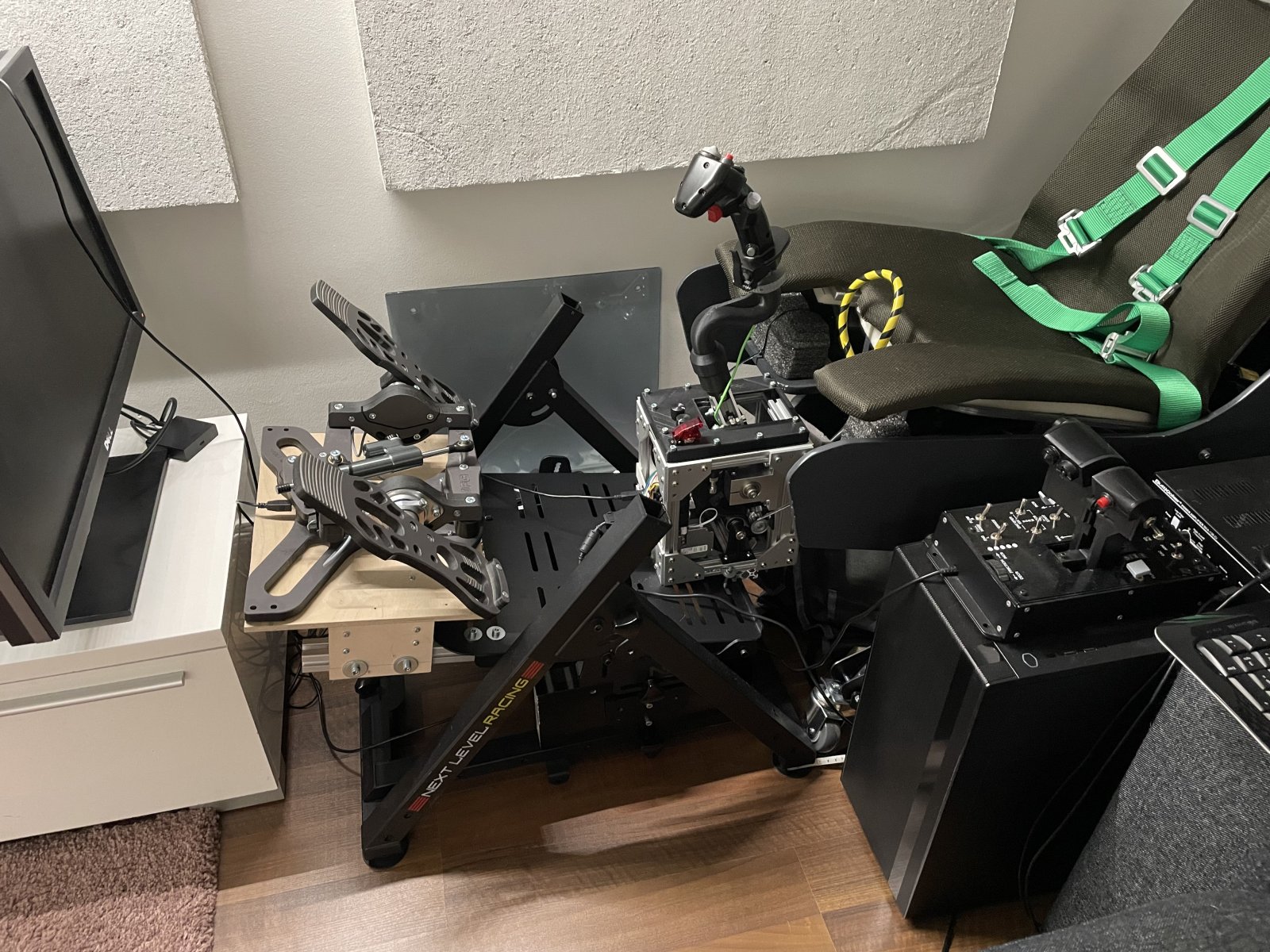

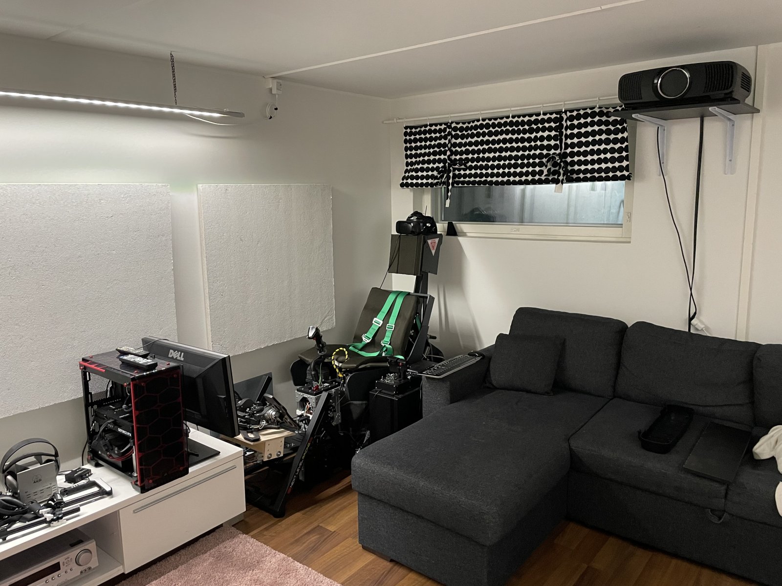

    Latest pics - I finally had some time to tidy up the mancave.
    Pedals and ffb stick now mounted on a customised Next Level Racing wheelstand. It's easy to remove the flight gear and put wheel and car pedals on for racing sims.

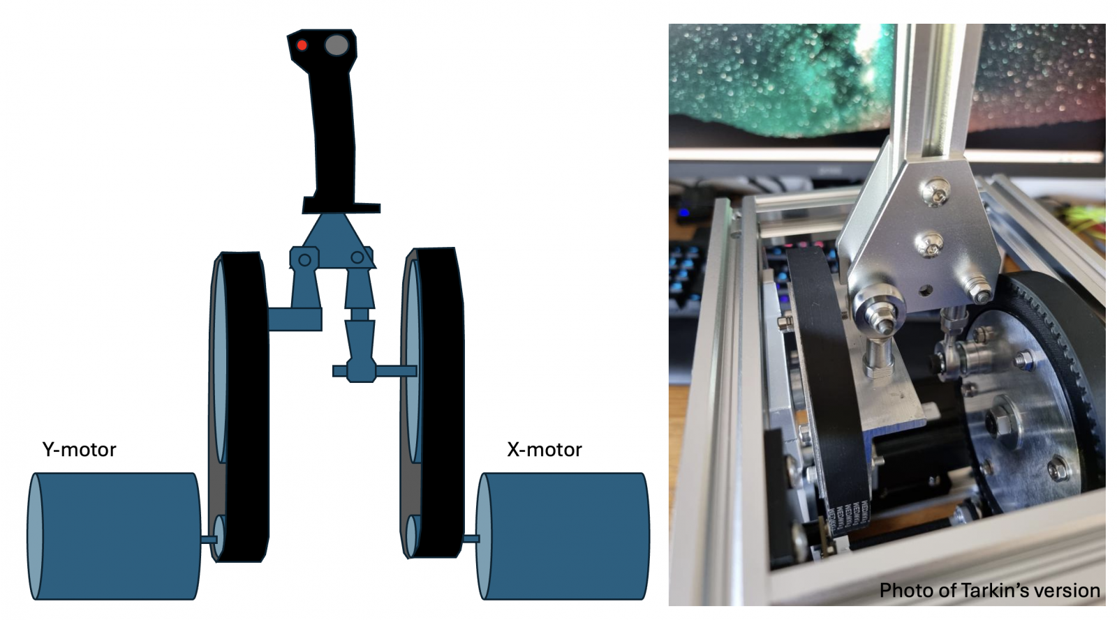

    Hi @noorbeast, sure, here you go - some further info:
    The VPforce RHINO is a commercial FFB joystick developed and sold by a Lithuanian guy that goes by the nickname Walmis: https://vpforce.eu
    The basic concept is that there are two stepper motors, one for x axis and one for y axis. The motors are connected to a gimbal system through two belt-driven pulleys.
    The stepper motors provide both positional tracking (with built-in encoders) and force feedback effects, including g-forces, trim, damping, air flow on control surfaces etc.
    The VPforce RHINO works natively with DCS's ffb effects. For MSFS 2020 there's an additional app that generates ffb effects based on sim telemetry data.

    - Walmis however sells also DIY kits for those who don't want to wait. The DIY kit contains two motors, a control board and access to the software. There are three motor sizes to choose from.
    - In addition, there are already DIY projects to add VPforce ffb to pedals, yoke controls and helicopter collective.
    I bought the DIY kit and based my version on a mechanical design by a Discord user named Tarkin.
    - I've included a rough drawing of the mechanical concept.
    I've connected my TM Warthog grip on the base mechanically, but I haven't connected the wire to the VPforce board for buttons and switches; instead, the grip is still wired to the Warthog base. This allows me to use the DCS aircraft-specific TM macros by Home Fries ("DCS World TARGET profile for TM Cougar and Warthog + MFDs"), without having to map the buttons myself.
    - with the big extension and a heavy TM grip (made of metal), my version currently has quite much leverage, so I would almost need the bigger motors. I might try making the extension smaller.
    What's neat is that I have two pots on the base, and can use the VPforce software to select what they do. Currently they are working as controls for X and Y axis trims.
