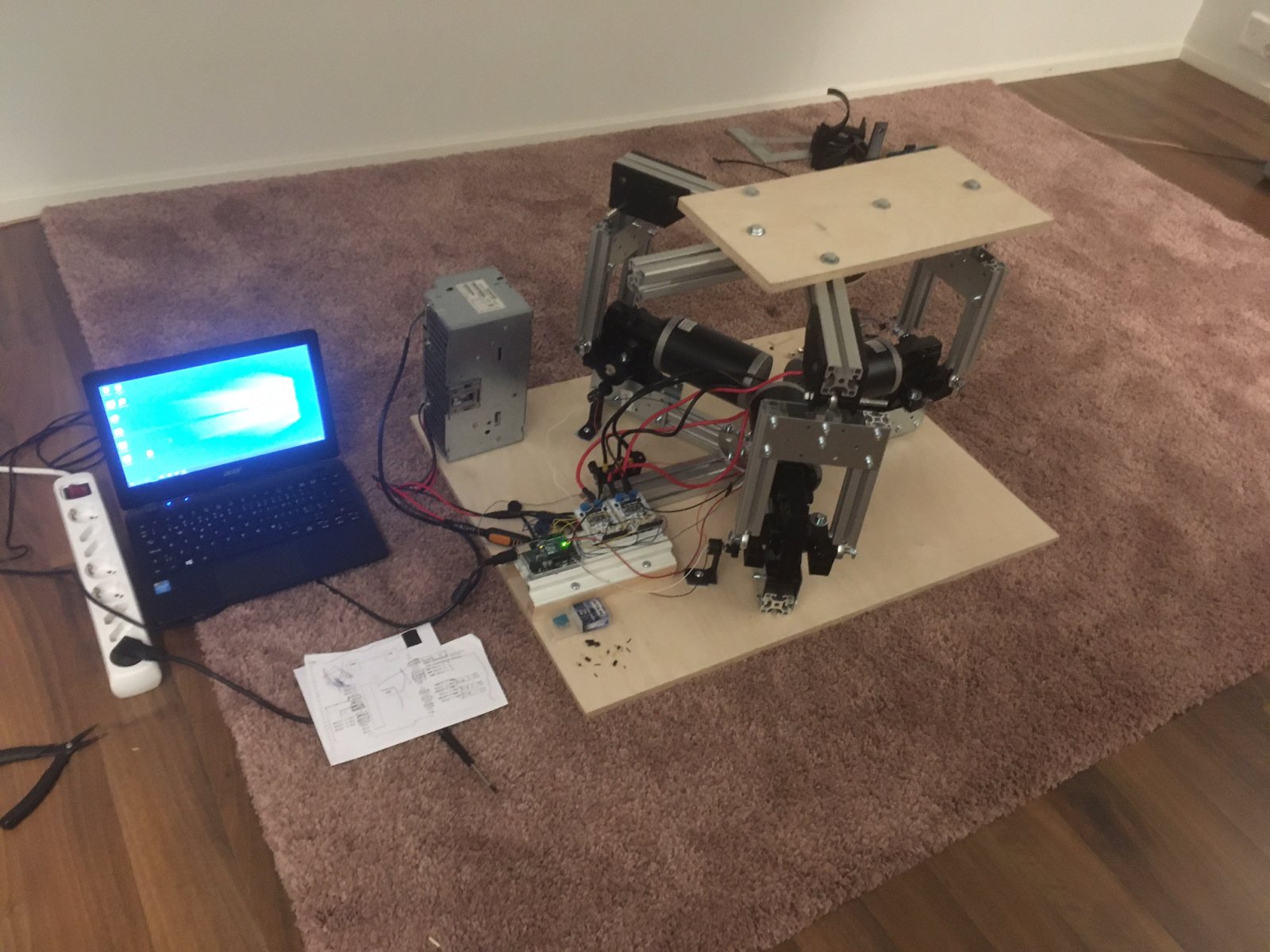

    Hello community,
    I was originally interested in building the actuator-based SFX-100, but then found out about Bergison's motion integrated G-seat and instantly knew that that would be much more suitable for my gaming (mostly DCS + VR).
    So, after reading tons of threads and admiring the great setups done here, I went ahead and gathered a bunch of stuff in January-February 2022 to build my own 3DOF + G-seat sim setup.
    Building the base took a long time, since I don't have access to sophisticated machining tools or welding kit, and can mostly work on it during the late evenings. I've also had to improvise quite much, for the better or the worse.
    This project owes a lot to Bergison's motion integrated G-seat, Sielu's awesome take on it, and, of course, momolic's thorough and excellent tutorial. On the software side I've been enjoying SMC3 by RufusDufus.
    --Update 2024-06: Also check out the motion integrated G-seat project by @Gefahren https://www.xsimulator.net/community/threads/3dof-g-seat-all-metal.18816/
    Main parts (Feb 2022):
    - 1x Arduino Uno R3
    - 2x Pololu G2 24v18 shield dual-channel motor drivers
    - 3x Alibaba Chinese 24V 300 W worm gear motors
    - industrial Siemens power supply 24V / 40A
    - 3x rotary hall sensors
    - 40x40 and 30x30 aluminium profiles
    - various 3D printed plastic parts
    Current status (Feb 2022):
    - motion system has been built
    - seat part and G-flaps missing
    - first iterations with SMC3 PID tuning done
    - having issues with over-current protection shutting the system down in axis testings.. don't know if it's Pololu or the power source that's doing it

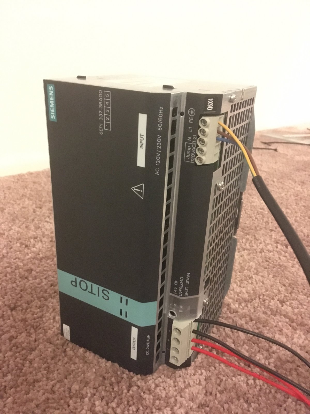

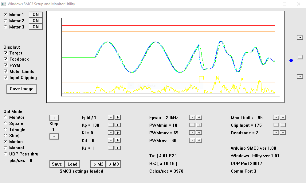

    Many thanks for taking the time to look at this noorbeast;

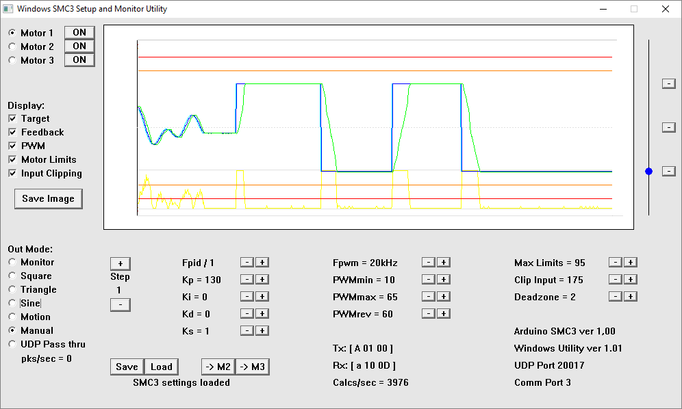

    Please see attached screenshots with SMC3 settings and results with "motion" and "manual" (same settings used for all motors) as well as my Simtools settings. The SMC3 screenshots have been taken without weight on the platform. SMC is running in mode 1, no pot scaling etc.
    - In SMC3 everything works well (only one motor runs at a time). My current settings are using only Kp and (I think) quite conservative values for PWM.
    - In Simtools I haven't run any game plugins yet, as I'm still waiting for my DIY license. I've just played around with axis testing. When I'm sitting on the platform, a downward movement in heave (from top position to bottom position) shuts the system down. Otherwise it seems to stay within current limits with these settings.
    - The motor drivers are not running hot at all.
    - The PSU is Siemens SITOP modular 24 V / 40 A 6EP1337-3BA00 (sourced second hand from ebay, but appears to be in mint condition). According to the manual, it should light up overload LED before shutting down, but I haven't noticed that. Motor drivers and PSU power LED just turn off.
    - After the shutdown, the PSU doesn't come back online unless I unplug it for a minute. Detaching the motor drivers doesn't affect this.
    - Specs of the PSU's output attached as a pdf. The used input is 240V single phase.
    - The whole PSU manual is available online: https : // cache. industry. siemens. com/dl/files/578/81287578/att_21914/v1/modular_1-2ph_Handbuch_englisch_en-US.pdf

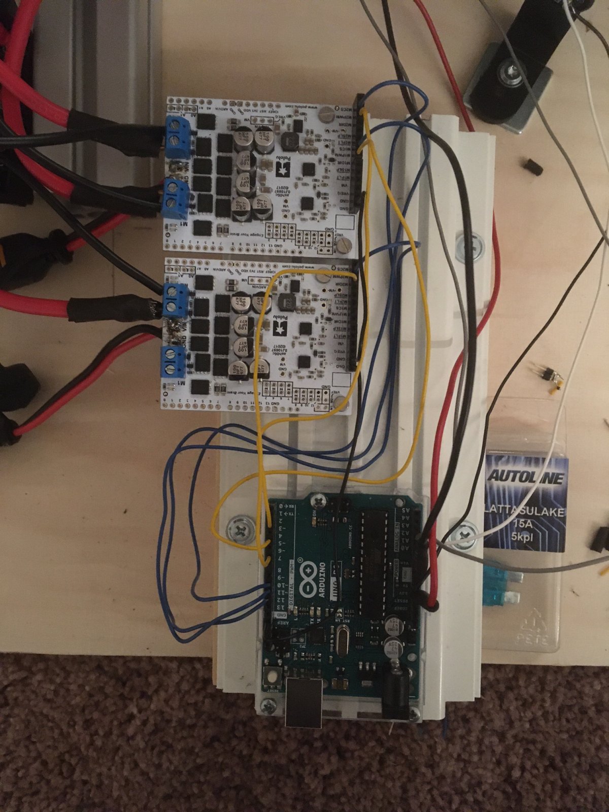

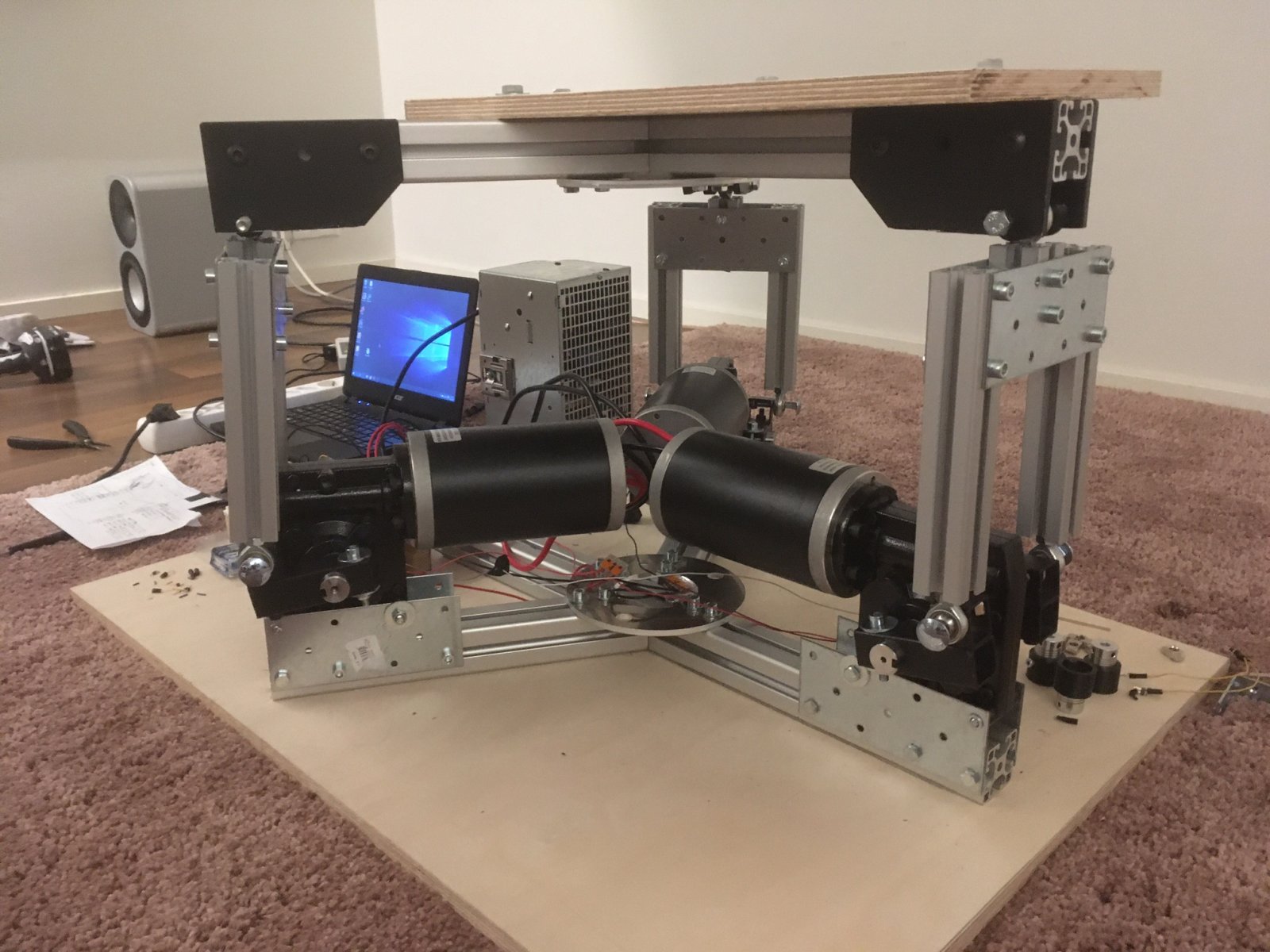

    Few further images:
    1) Control boards.
    2) Siemens power supply.

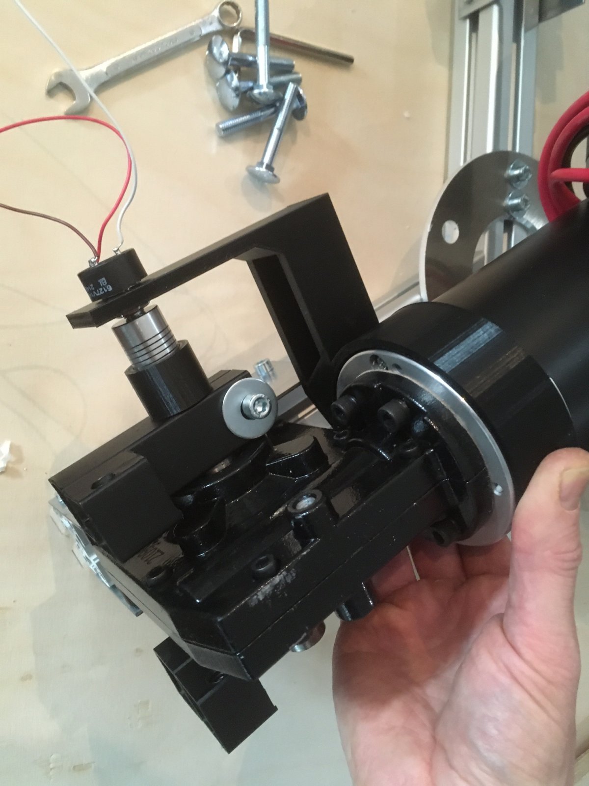

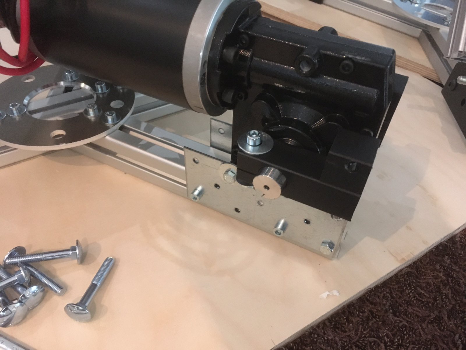

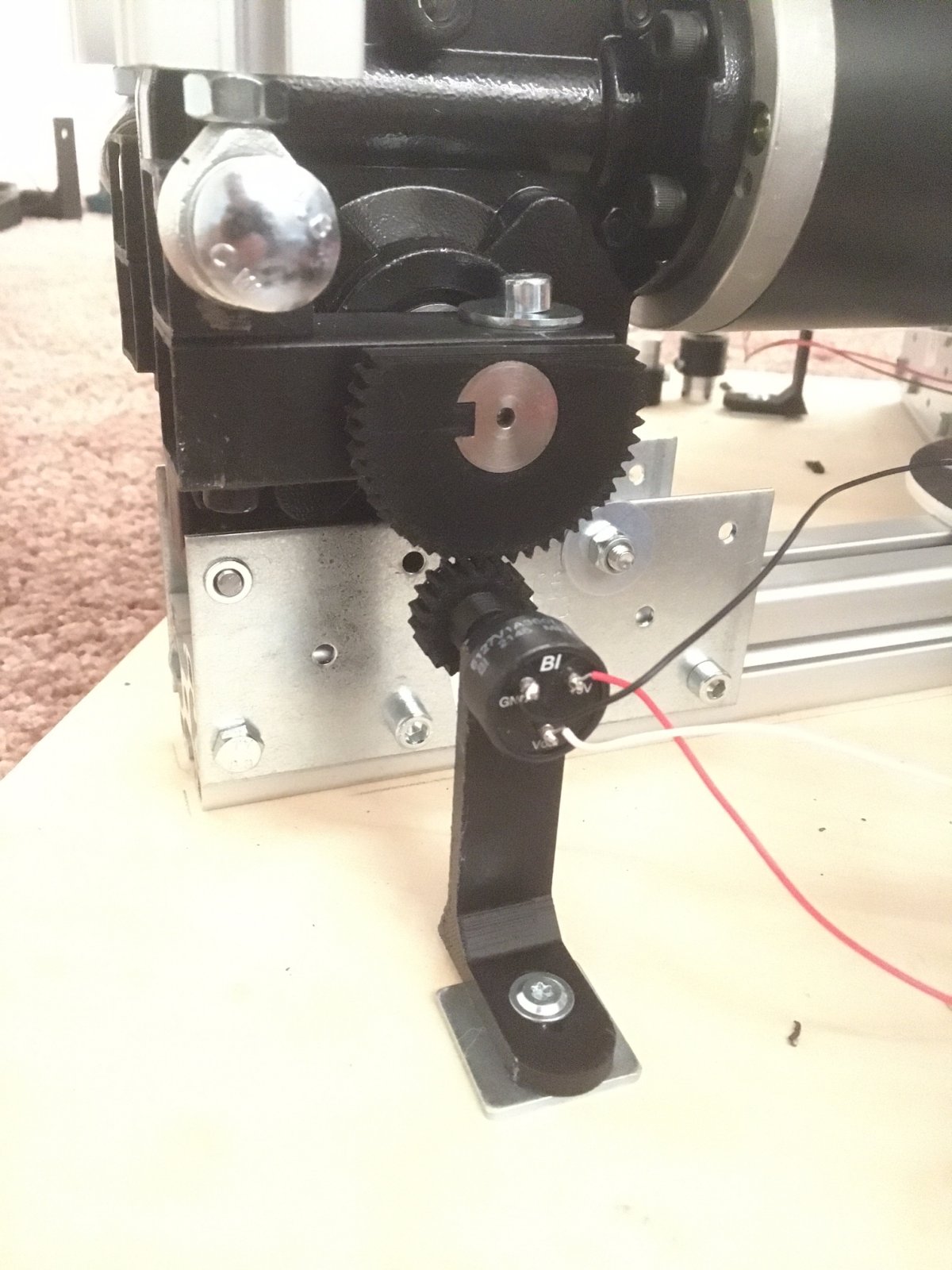

    3) New hall sensor setup with 50/20 gears. Still using 3d printed plastic parts so precision isn't great, but now I have proper resolution and can limit the turn angle with SMC3.
    4) Old hall sensor setup. The SMC3 max limit of 255 wasn't enough for limiting the physical movement to ~120 degrees. It was also difficult to center the axles of the sensor and the motor. The sensor would move a bit when motor turned, causing unwanted jitters.

    First try refining your SMC3 settings further, as it is not tracking well.

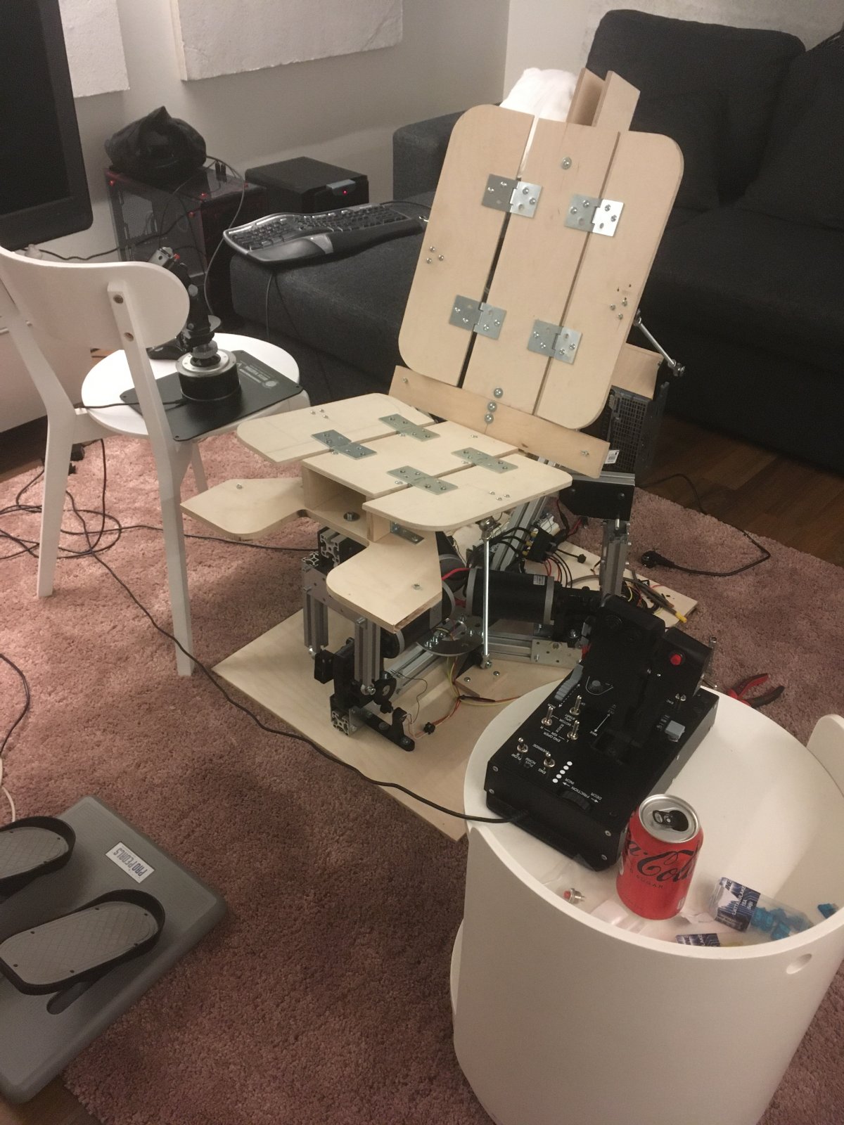

    I haven't yet adjusted the motor profiles with SCM3, but have been building the seat part. It's starting to look like a seat already.
    Now there's an issue with one of the motors.
    The motor is making a clicking sound when moving a weight down (turning counter-clockwise). When lifting the weight up it sounds normal. Also when running the motor freely (pusharms detached from motor axle) it sounds normal in both directions.
    In the video it's the one closest to the camera, on the left.
    Is that a busted gearbox or a bearing ? Next thing to do will probably be to detach the gearbox and look inside, but if someone already has ideas about what to look for, I'd appreciate any advise, thanks !

    Building the seat itself has moved forward -- the G-flaps are now done and moving. I also did some cable management and tuned my DCS profile. Surge effect are great; shaking on the runway is a bit too much. I'll have to test with smoothing and deadzone.
    Btw, there has been no shut down issues in actual sim use so I guess the power source / motor drivers can handle actual use without issues.
    Next up is the headrest, some foam cushioning, some kind of cover for the base's moving parts to prevent kids putting their fingers there, ejection handle, paintwork and seatbelt (still in the mail).

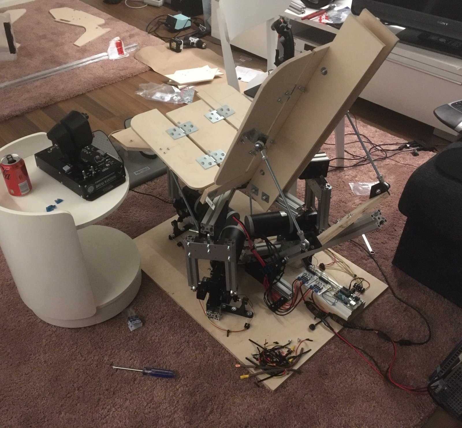

  11. hcee2022
    hcee2022 Member
    Feb 13, 2022
    34
    Finland
    184Coins
    +45 / 0 / -0
    Another photo from a better another angle.

    +32 / 0 / -0
    Awesome work friend! I really like the recumbent angle on the seatback pylon support. You'll have to let me know how well that translates to flap-movement!

    Thanks mate ! The pylon wasn't planned, but I had that alu profile piece as a spare and it seemed like the perfect solution :) The nice thing is that I can slide the wooden piece up and down to adjust the neutral flap position.
    The flaps themselves do give a decent push to the back -- I'll make a video later.

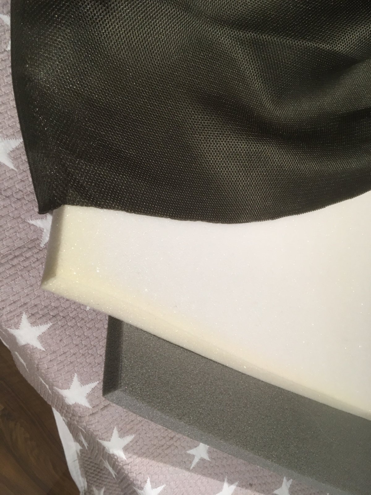

    Crafting 6 identical cranks for the motors of furniture tube was hard, but I have to say doing the seat cushioning and textile finish looks even more challenging now (the wife may have to do this part eventually...)

    I was very intimidated by that part as well! I just ended up hot-gluing the fabric on to the back of the foam. Doesn't look great from the back, but as soon as the cushion's down on the seat it's fine!
