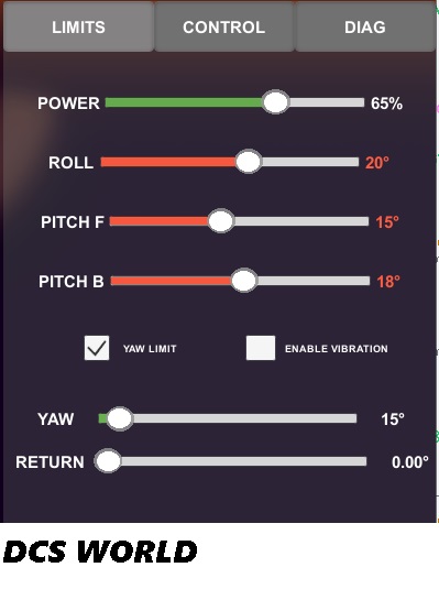

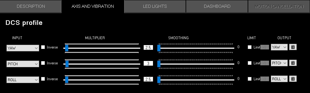

    I just wanted to put my findings for configuration for the yawVR on DCS World
    Since i plan to use yawVR tethered to a VR headset, i dont want to have the yawVR rotate 360 degrees so yaw limits will be ON. with that said, the available export.lua file available by the company only allowed the yaw responded to yaw position (as per the cockpit compass) but i find it more realistic for yawVR to respond to yaw speed (as per the cockpit turn & slip indicator), especially since i am not using yawVR in full 360...
    hope this helps anyone out..
    i attached files and settings to use with yawVR game engine...
    ***RENAME export.lua.txt to export.lua***
    and drop it in the C:\Users\USERNAME\Saved Games\DCS.openbeta\Scripts folder
