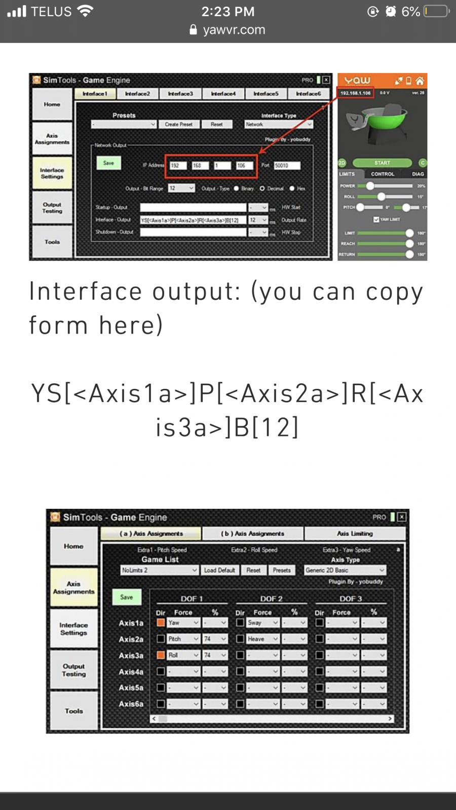

    Alright guys I made it work but I need a big help from you. As I said before, I got yaw vr. On their user manual they only have stats for no limit roller coaster and it works ok ish. When I tried assetto corsa movement is not matching at all, same as the other car racing games. I tried min/max but I think I need to find a better axis Assignments. Any help would be great, especially @yobuddy :) thank you I’ll leave some pics from their website

    Hi Buddy,
    Your axis assignments don't make much sense to me really.
    What do the default settings look like for the roller coaster game?
    Once I see that I bet we can get some settings that work.
    A little trial and error and I bet we can get it running nicely.
