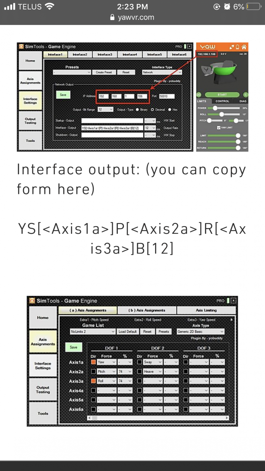

    Anyone using yaw vr? What’s your axis assignments, min/max for racing games?

    Nothing other than user manual which has this info(attached) for no limit roller coaster

    So with the proper IP and the Interface Settings configured as per that picture does SimTools Output Testing work if you configure the Default Profile in Axis Assignments as per the NL2 example given in the picture?

    Just need to set simtools axis limiting. Start off with 8% or less. Disable yaw at first and add try to add it later after you get pitch and roll working like you want.
