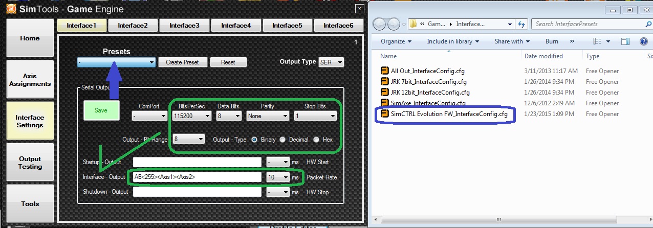

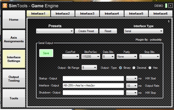

    SimTools v1.3 xSimCTRL Revolution FW_InterfaceConfig

    Thanks Dustin ... It's your Great program and the Honor is still mine :)...

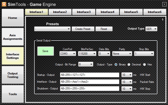

    For setting extra start up/shutdown values ...
    Assuming that actuators are in the getting on/off the simulator cockpit and it is in my case the 255 point "third line" ... So I set the Game Engine start up with actuator's center 127 point so the game can take it from there ... And when finished playing and need to get off the cockpit it is set back to 255 point again .

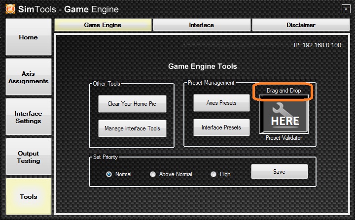

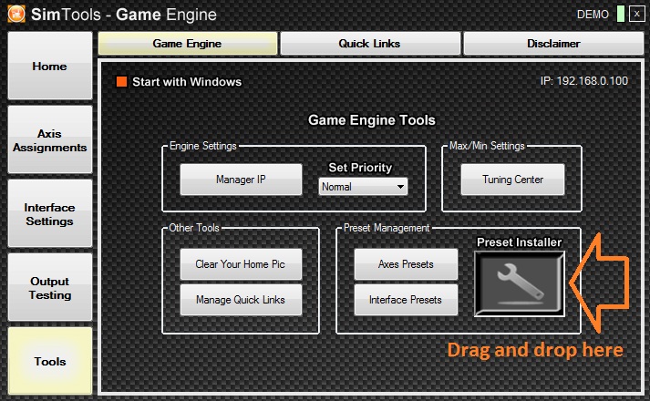

    SimTools v2.0 xSimCTRL Revolution FW_InterfaceConfig ... UPDATED .
    just extract the zipped file and drag and drop it to the preset installer ...
