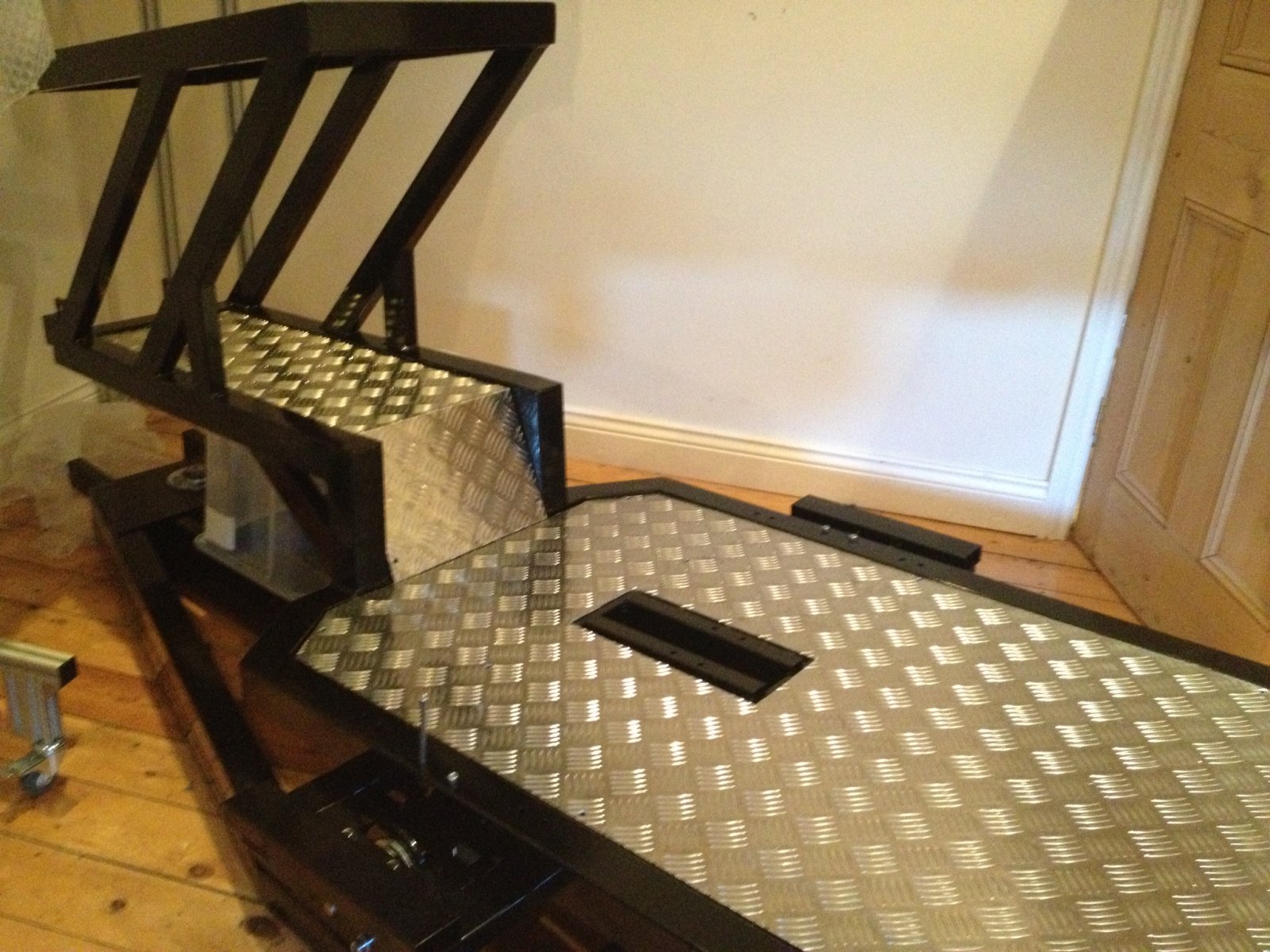

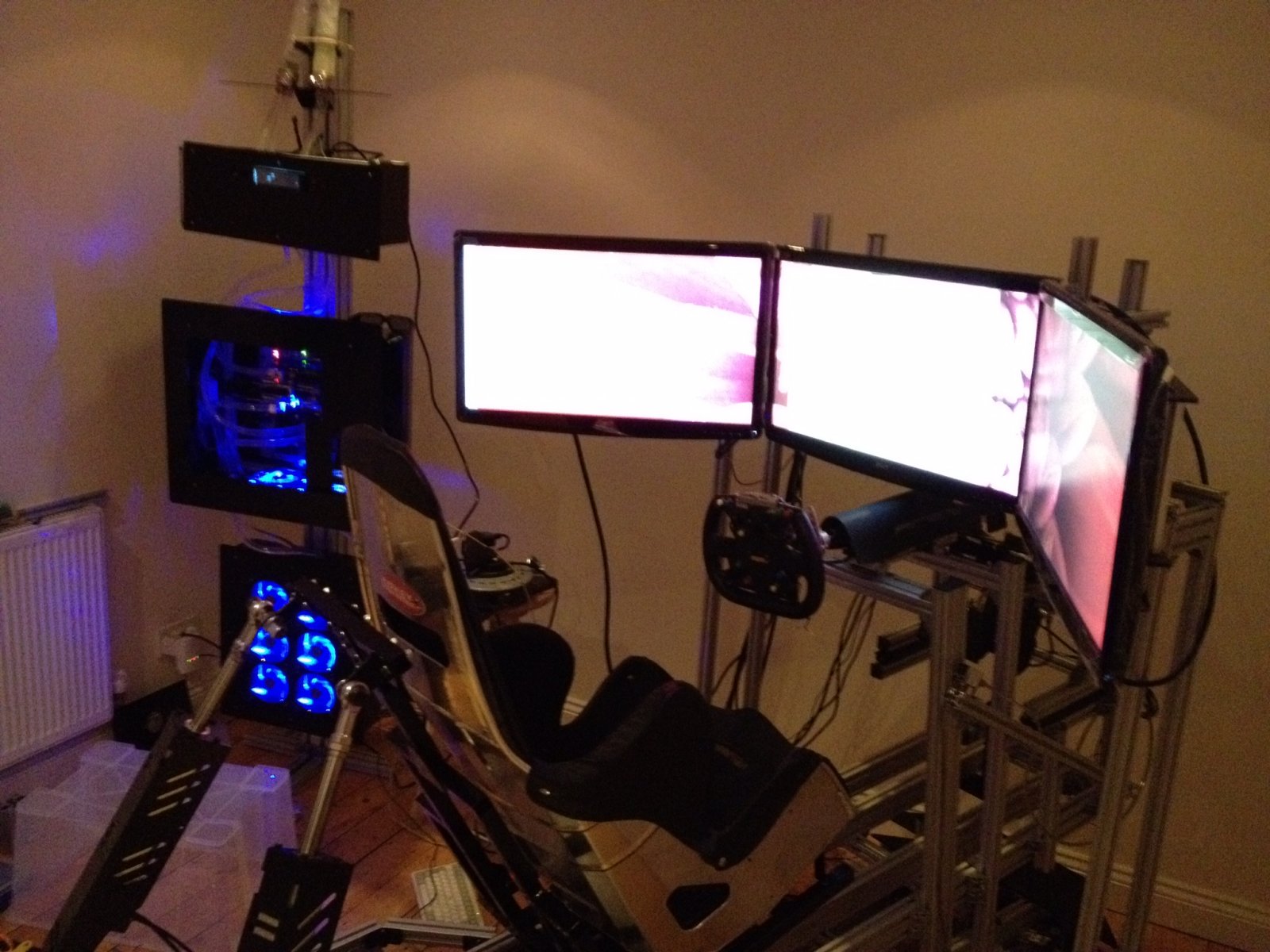

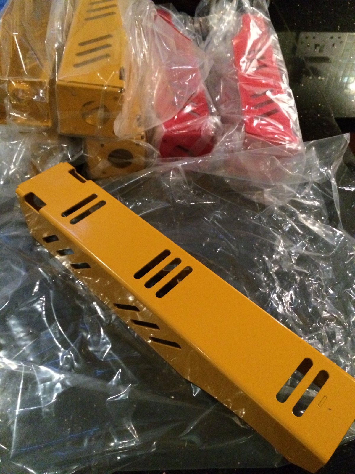

    Some pics of my motion simulator

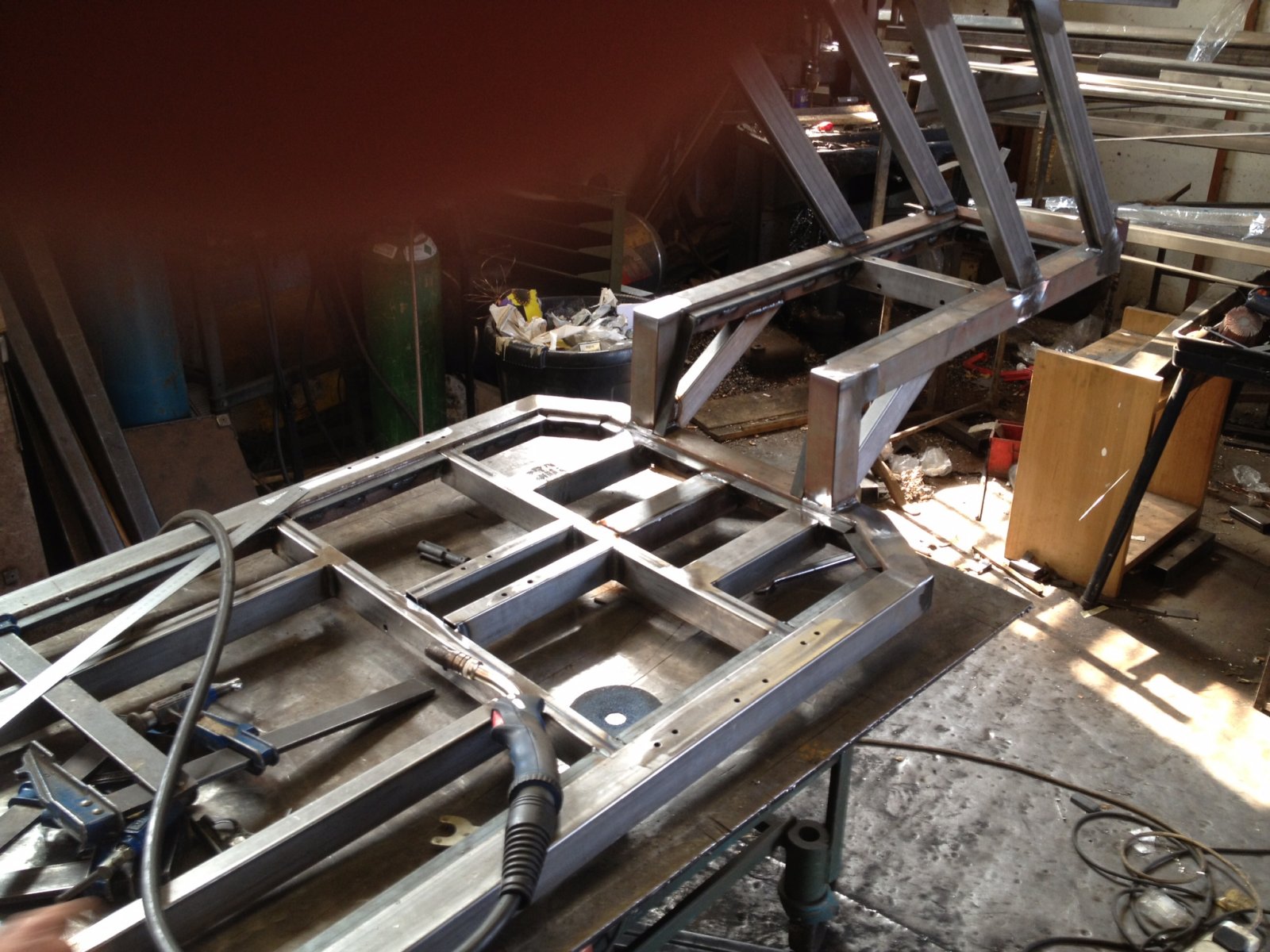

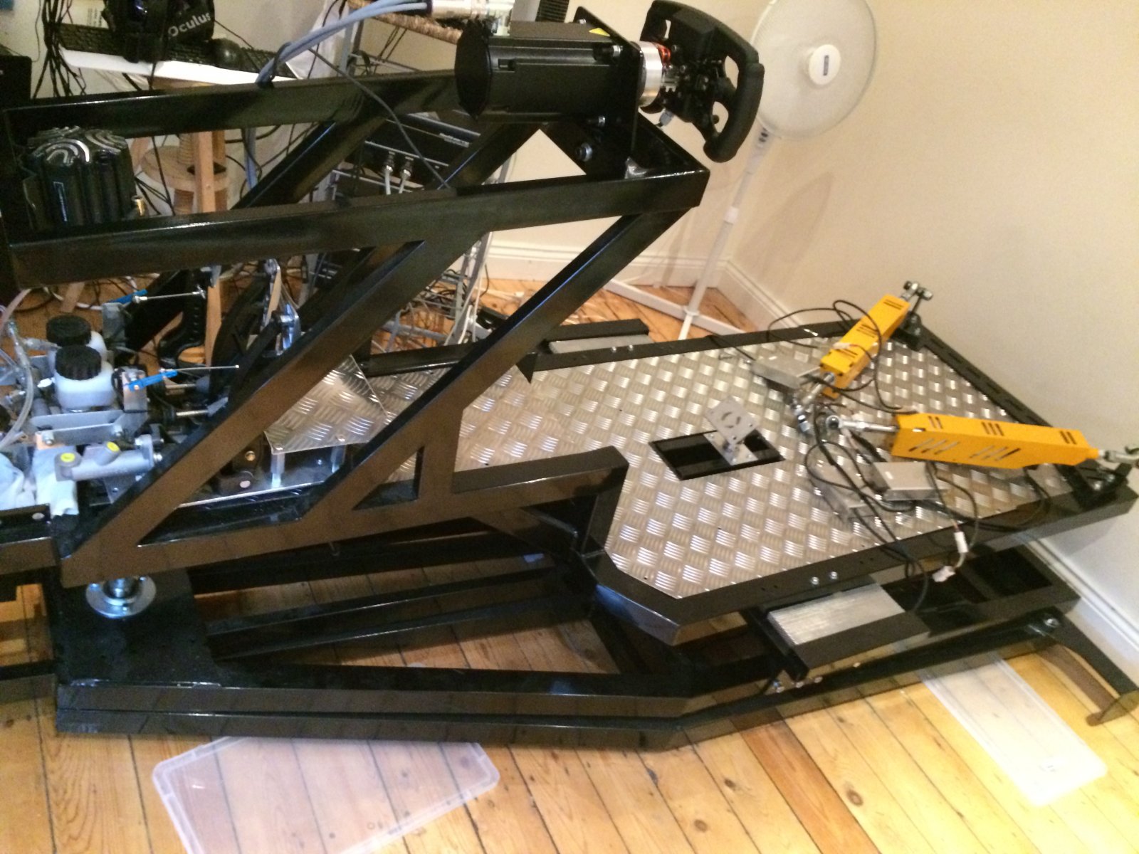

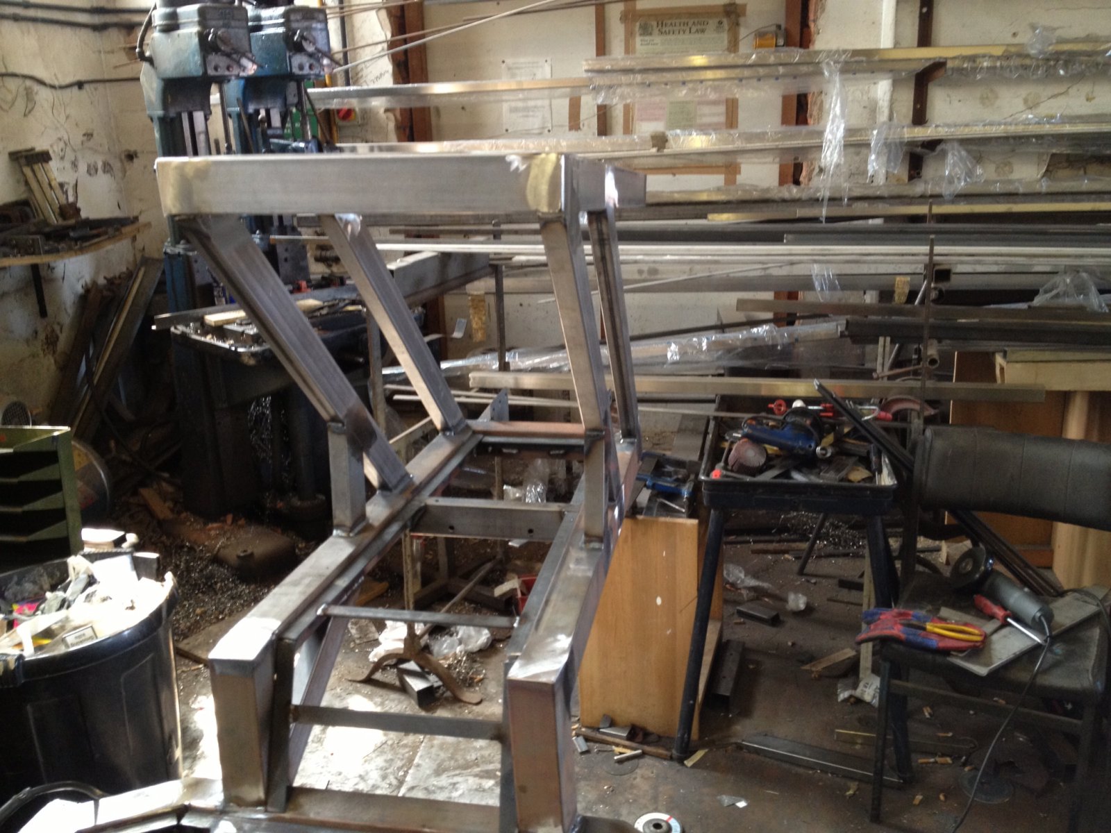

    I decided to get a little local weld shop to help me out with fabrication,
    Some if the pics are showing it in the weld shop
    I wanted as close to zero flex as possible
    The reason for moving to steel box tube & welding

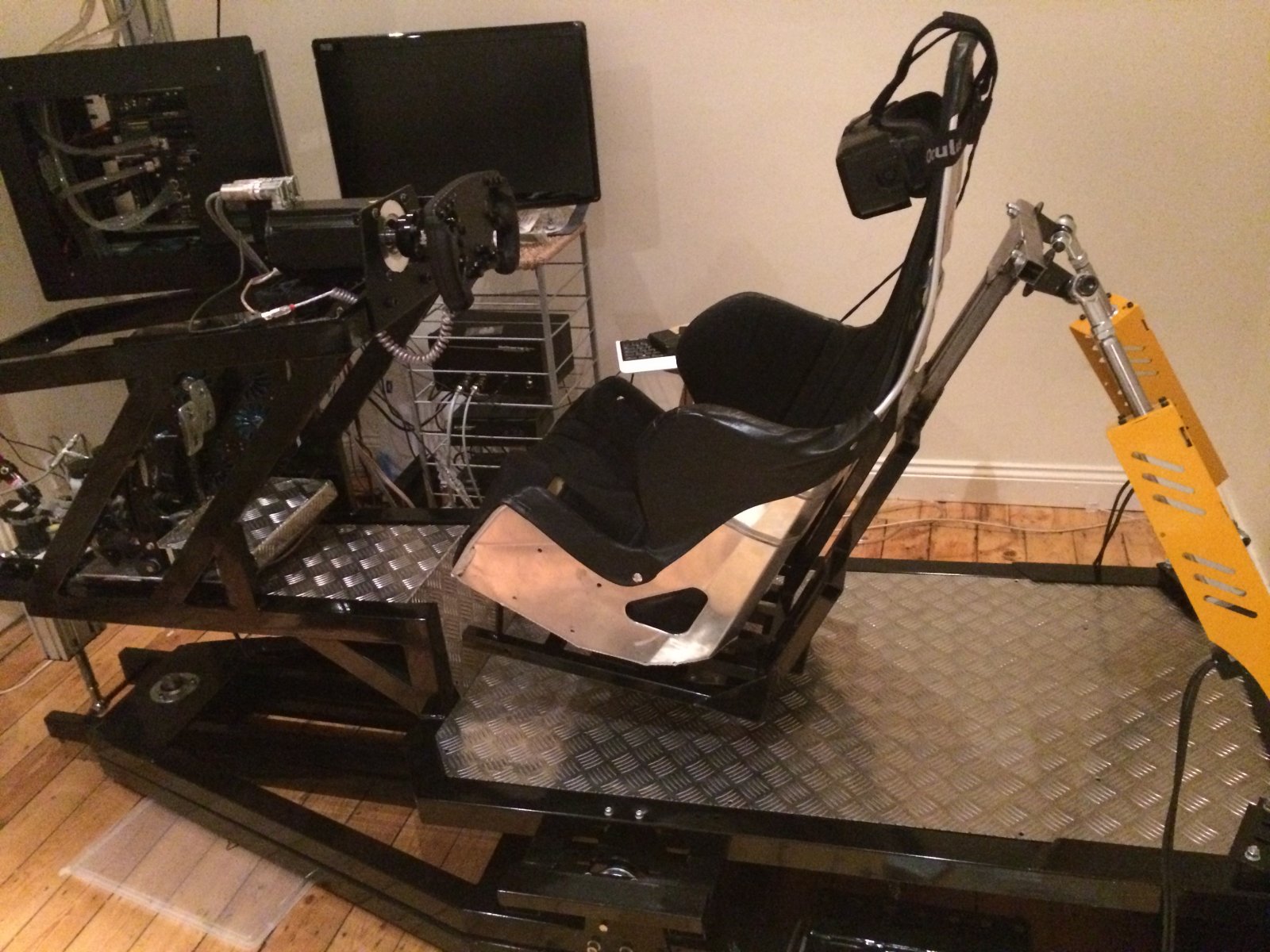

    The seat is conventional rocket type
    The platform under that also does overall pitch
    The base has rear traction loss
    This x4 SCN6 actuators needed
    Getting good SCN6 covers was a pain so I had some manufactured/laser cut
    Everything was professionally powdercoated locally
    see youtube for contact details if anyone needs some (search scn6 actuator covers )
    ****sorry all text is not with right pic )-: will correct
    ———will update with info bit by bit

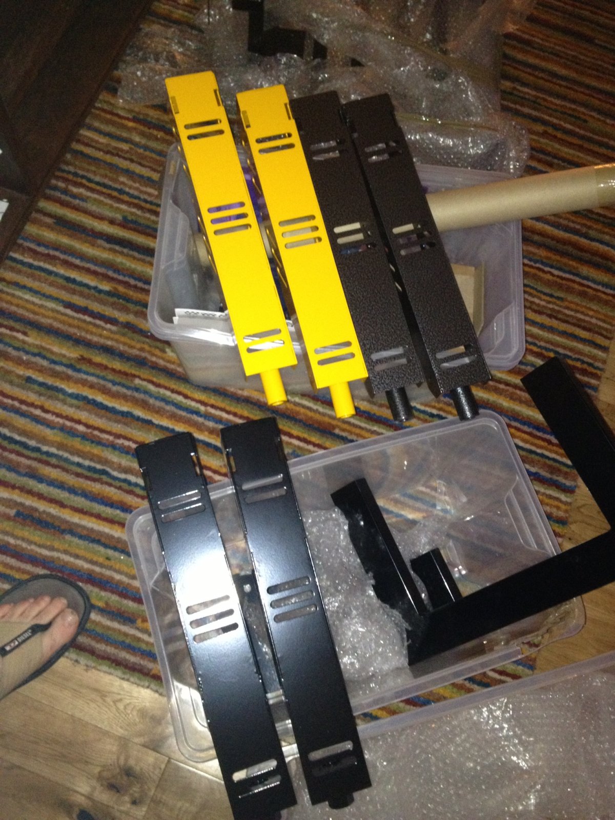

    Custom made SCN6 covers, laser cut / powder coated , work brilliantly:
    (made extra's as few people on iracing forum needed some too)

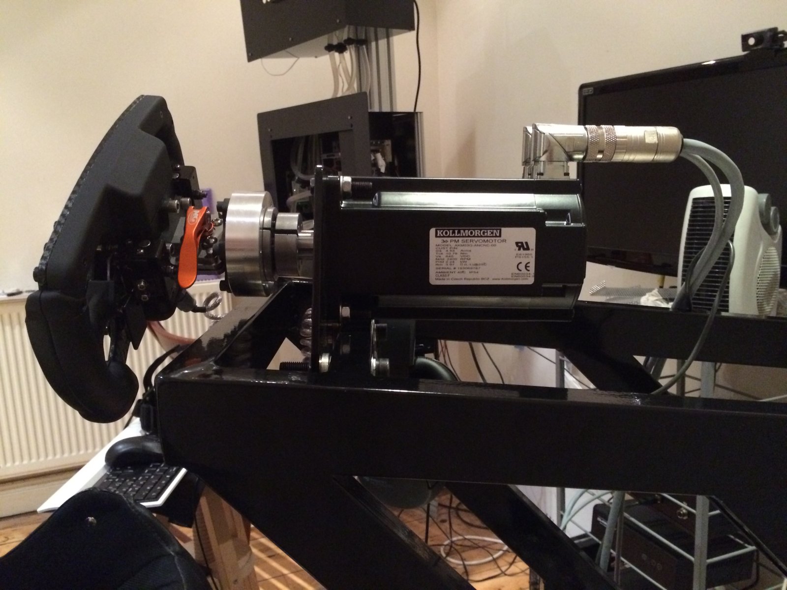

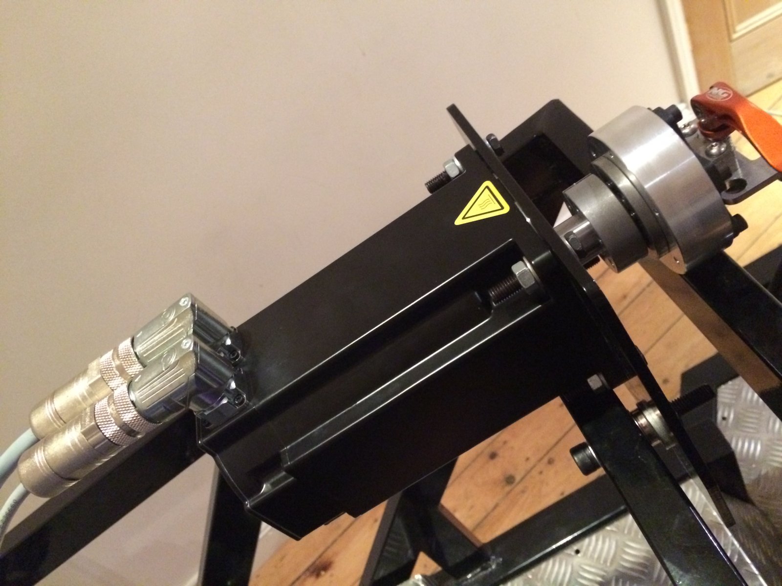

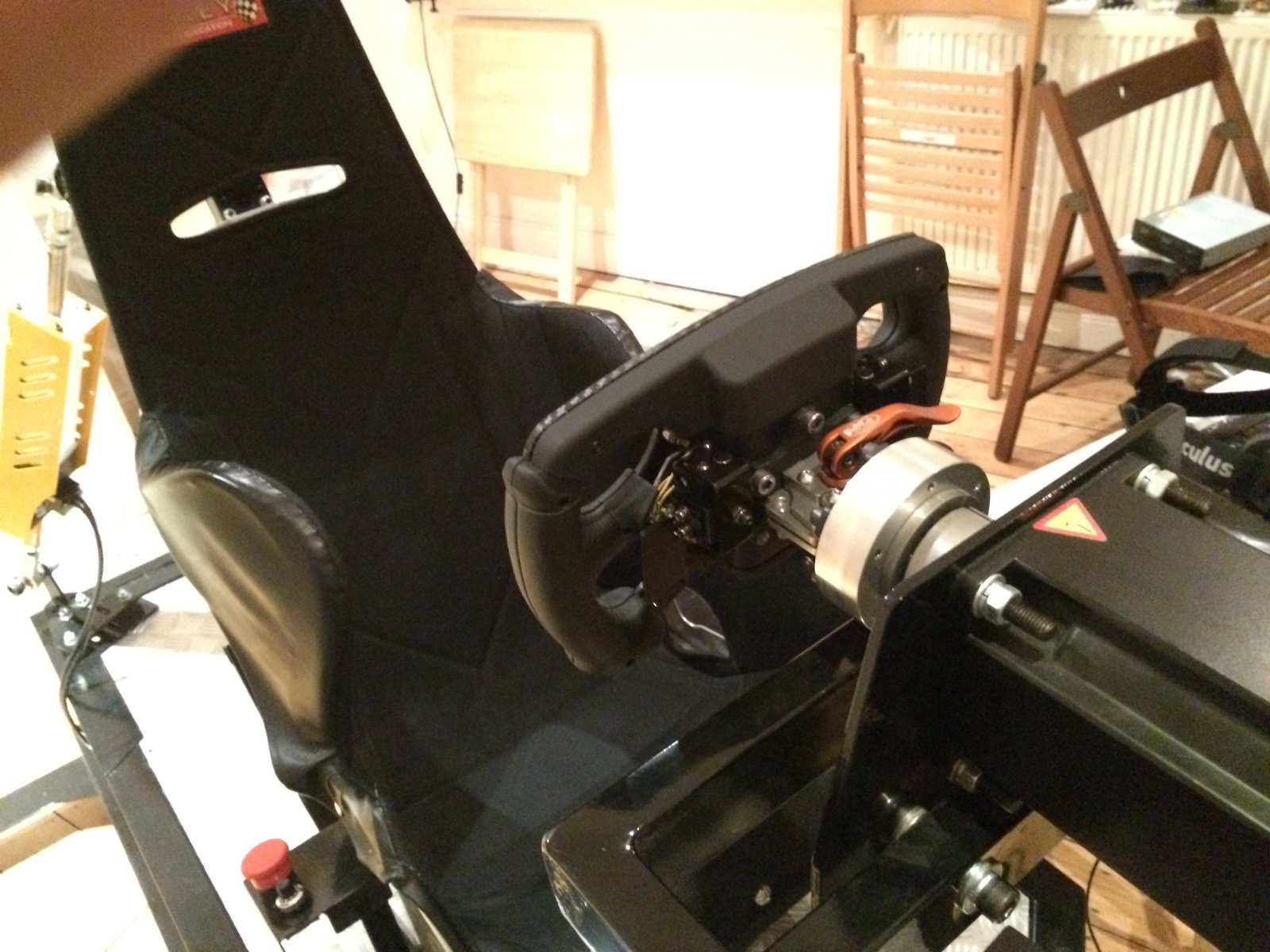

    Customised a Fanatic f1 wheel, using a bodnar PCB
    ( leo bodnar now has an easy conversion PCB) :
    E8C5E17F-7061-49C6-B74C-421696F8D9BC.jpeg 54183118-D3CF-4707-BE11-9E6EC3D8AA40.jpeg

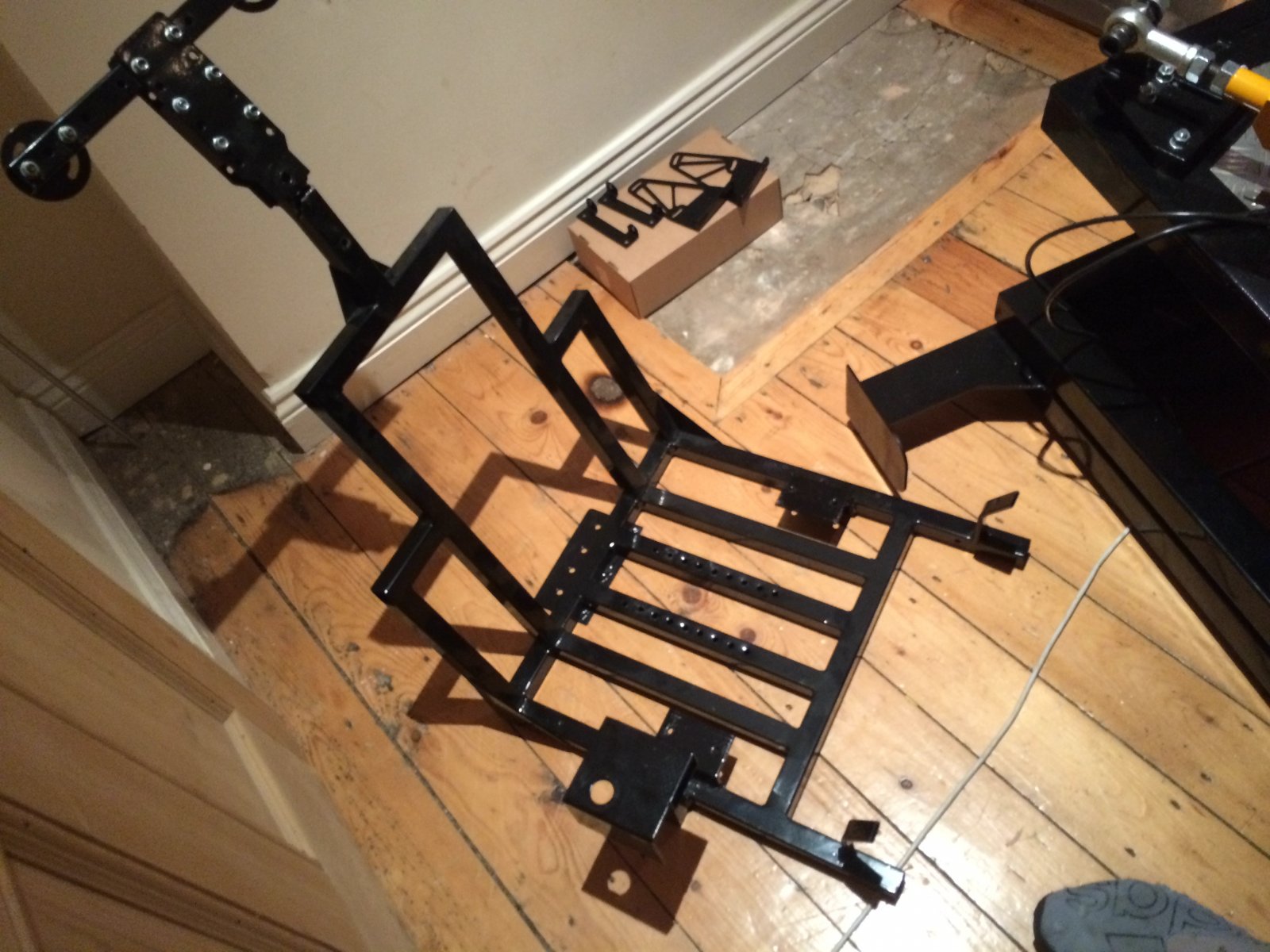

    Seat holder, universal joint attached underneith :
    15AD190E-0529-4F6E-A2AA-260DDE003E3F.jpeg 59845193-8E98-47AA-AE60-A6FDDE225CC5.jpeg

    with ffb unit & seat assembled :
    E0123F99-C53C-423F-90FE-3AC262FB91D2.jpeg 0D0B1DF0-AAE4-4426-B7E3-B560572CA748.jpeg 101112DD-6A7E-4B5C-BD35-6DA80EC09EDC.jpeg E8C5E17F-7061-49C6-B74C-421696F8D9BC.jpeg

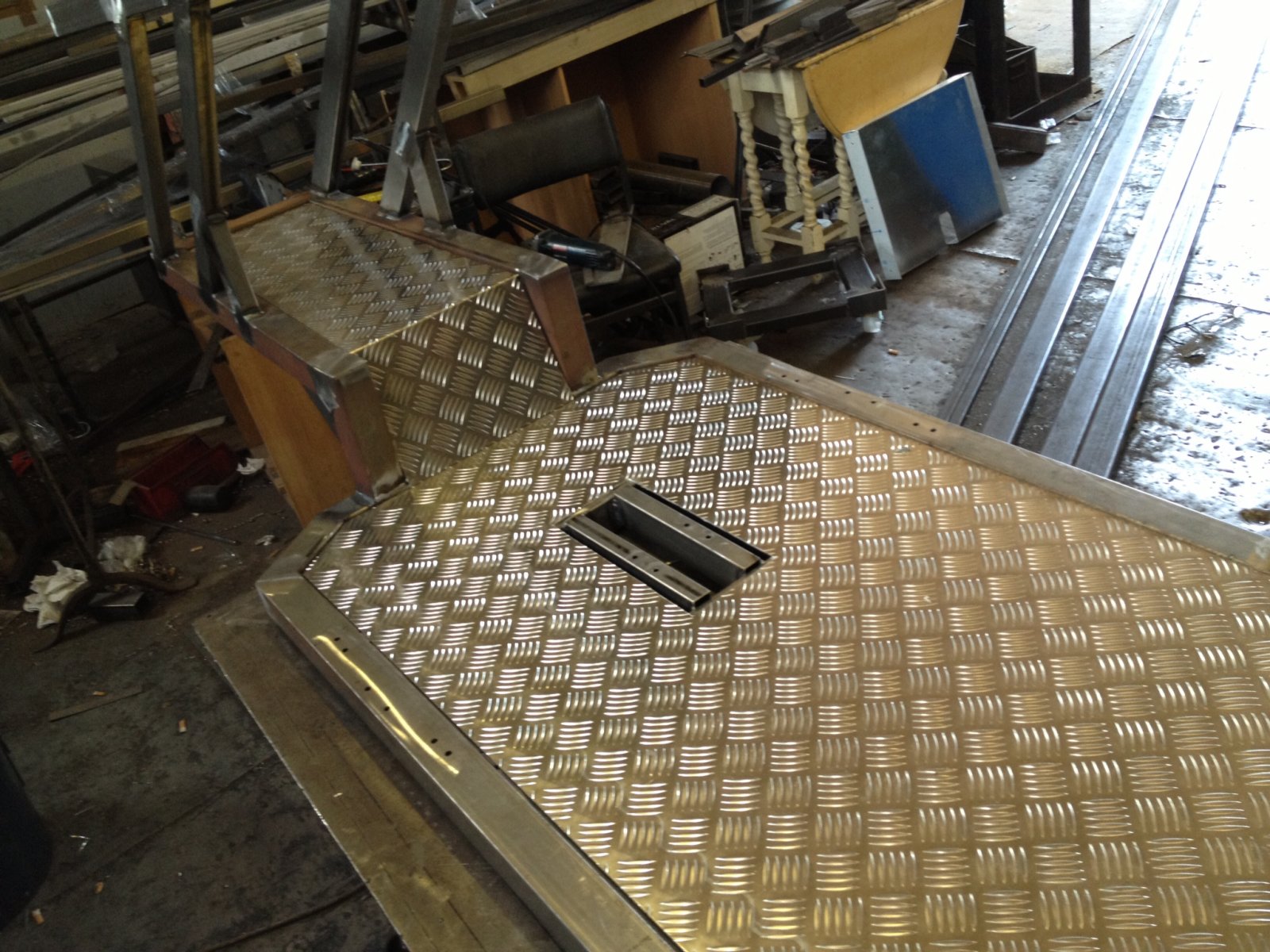

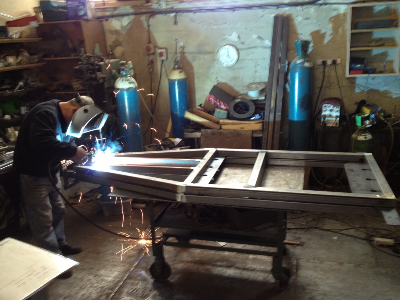

    back in time now ....at my pals little local weld shop, lovely seeing it coming to gether
    ( & helping )
    C99D6A05-63D1-45F7-B7C6-D3C20F90C2B5.jpeg 0D0B1DF0-AAE4-4426-B7E3-B560572CA748.jpeg

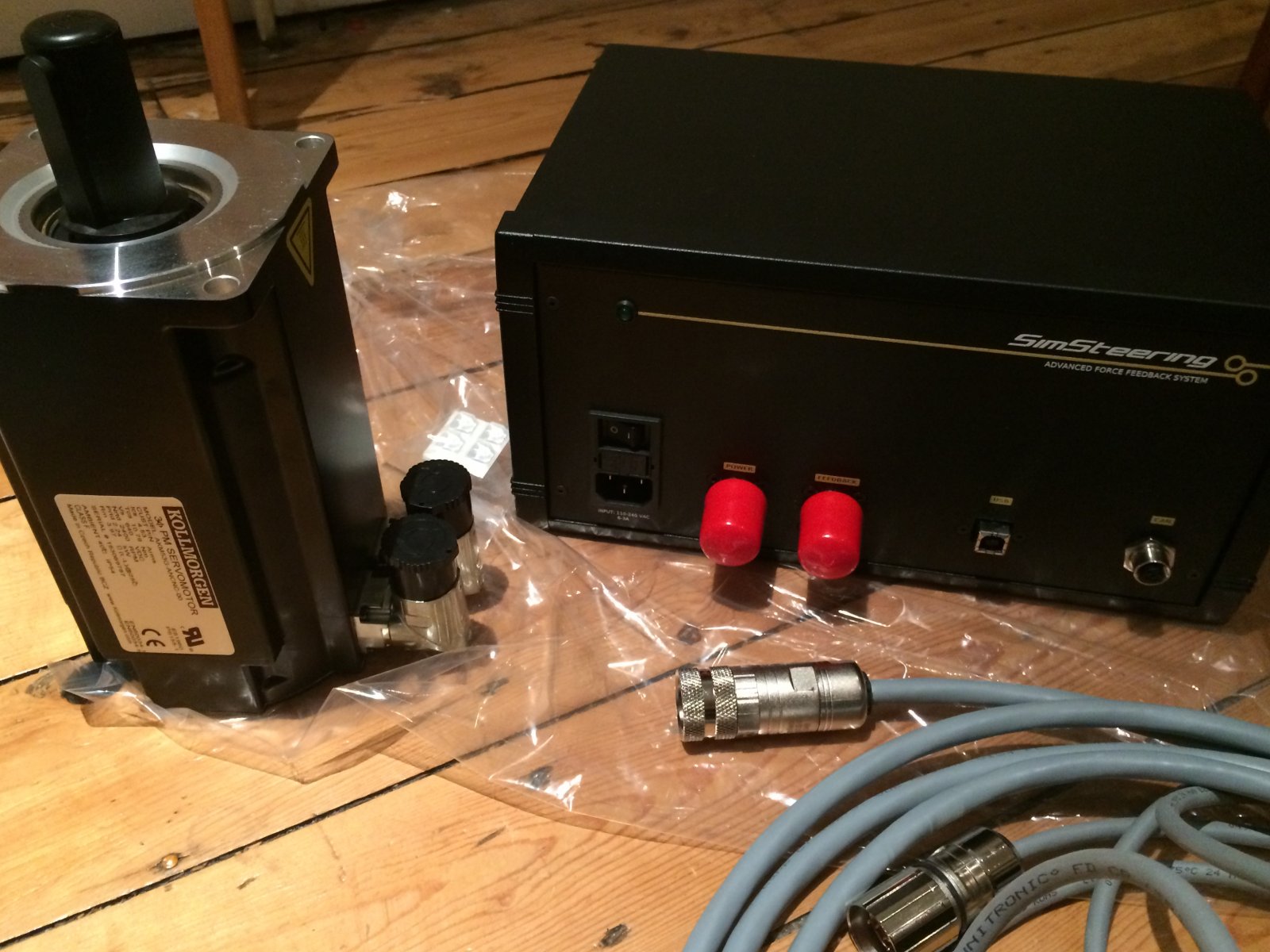

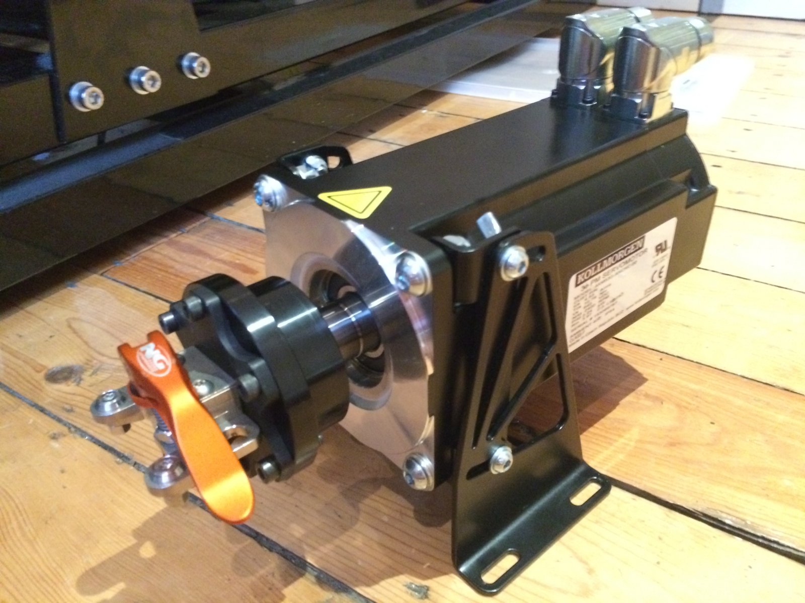

    Leo Bodnar V2, quite a purchase but its a brilliant ffb system & for life :
    E0123F99-C53C-423F-90FE-3AC262FB91D2.jpeg 2F14DE89-41E0-488B-B80B-13A4DE26BF86.jpeg
    No monitors now as I use VR 100%

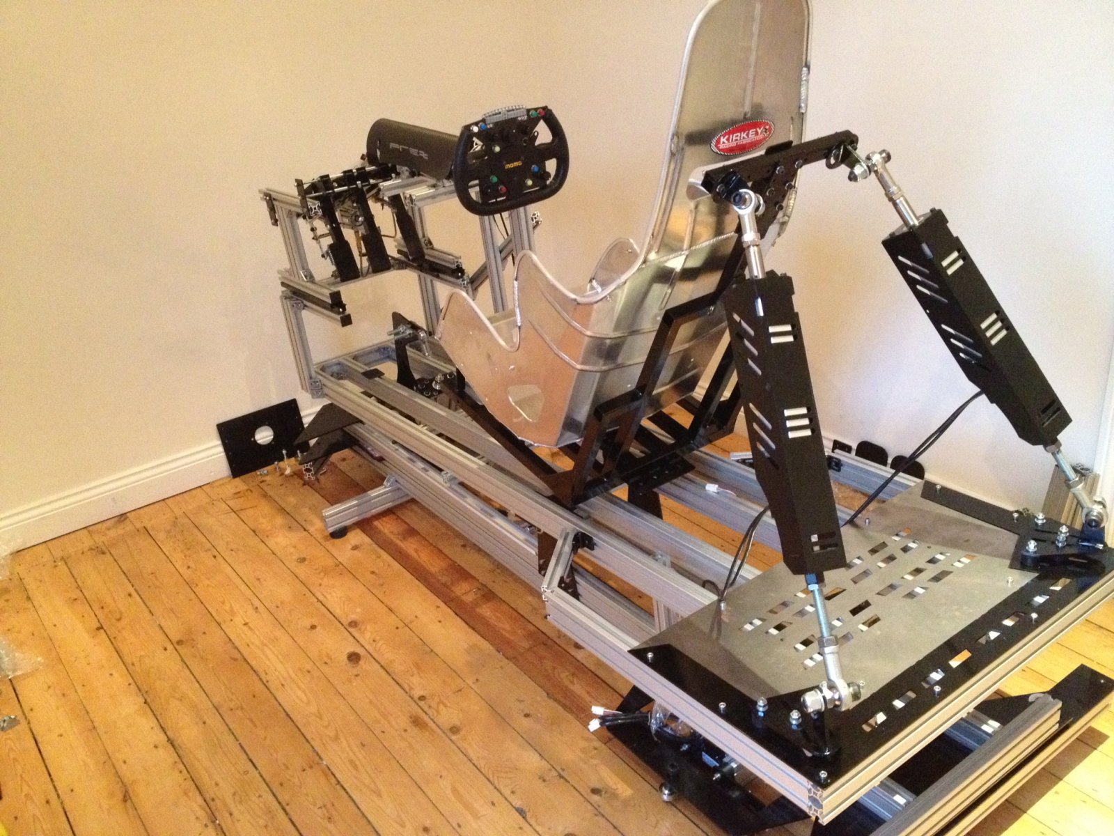

    Earlier version
    Maybe the last using screwfix frame
    28C4705F-CBB4-4F6F-958E-914BE76EDE5C.jpeg [​IMG]

    At the time I had my own formula wheel roughy designed but the rig was taking all my spare time , so for speed I bought a fanatec f1 wheel & converted it -resoldered all the electronics inside to a bodnar pcb it works & feels good for formula sim-cars
    Ps the covering is just a good quality carbon look vinyl , it’s very hard wearing & looks good too
    If you can pickup an old 2nd hand fanatic formula wheel , Leo bodnar now does a conversion PCB for it -makes it much easier & quicker to convert to USB to use on non fanatic ffb systems

    You say you want zero flex, but what car out there has zero flex? I feel like this is just overkill and taking away immersion not adding it. Are there any facts to prove me wrong as this is just my 2 cents opinion.

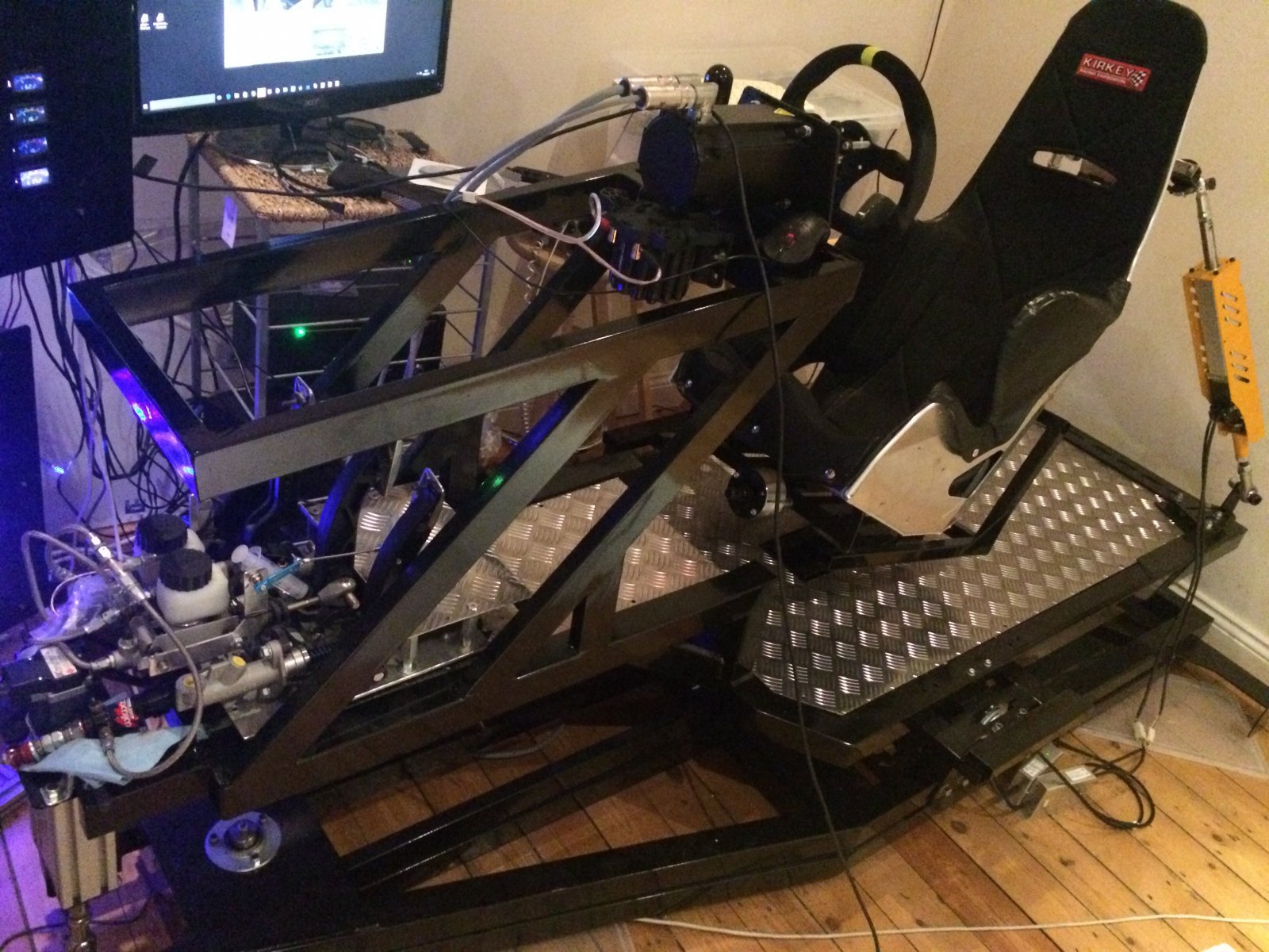

    The front actuator shown is much bigger,
    What is the model number of this one?
  14. Adrianstealth
    Adrianstealth Active Member
    Nov 18, 2010
    159
    director
    england
    334Coins
    +37 / 0 / -0
    SCN6, 4DOF
    Thanks for your interest Joe

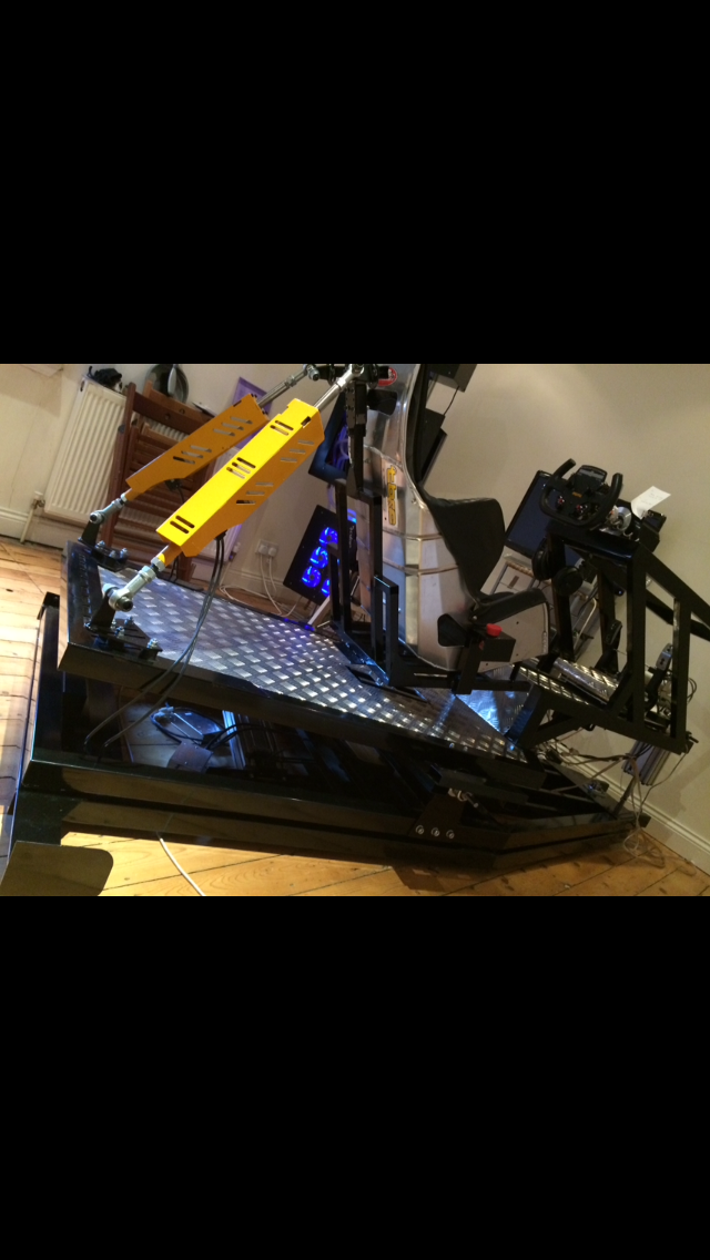

    No all x4 actuators are the same
    It looks bigger because I designed a different damping cover/holder for it
    In fact I’ll add some pics of the damping mechs on the actuators , they work great & help reduce any shock in actuators
    I wanted the actuators to have an easy as possible life + also helps with performance
    The pivot for the main pitch base notice it is in centre , the whole weight of rig can be lifted fully up & down with my little finger (whilst front actuator not attached ) , I know there’s more strain due to speed & quick changes in direction though this the dampers

    The front actuator is mounted to the base frame or just stand on freely? I built a similar setup but using two SCN6 in front instead of one, that is based on the Prosimu T1000 frame with 8020 profiles I build on the top. But mines are freely standing on. I don’t like at all.
  16. Adrianstealth
    Nov 18, 2010
    159
    director
    england
    334Coins
    +37 / 0 / -0
    SCN6, 4DOF
    The front actuator is mounted at both sides to ball joints to allow free rotational movement
    I wanted to be careful all actuators didn’t suffer from bad alignment strain

  19. Adrianstealth
    Nov 18, 2010
    159
    director
    england
    334Coins
    +37 / 0 / -0
    SCN6, 4DOF
    no problem , notice the pivot for the main pitch base is around the centre , with a person in seat prior to putting on front actuator I could move the front fully up & down with my little finger
    I made sure the balance was perfect
    The actuator obviously has to cope with inertia for a change in direction after quicker movements , I don’t use a high speed setting for pitch + the actuator is mechanically dampened , it works well without strain , one can feel a good “thump” movement if hitting a curb or a bigger bump in driving simulation
