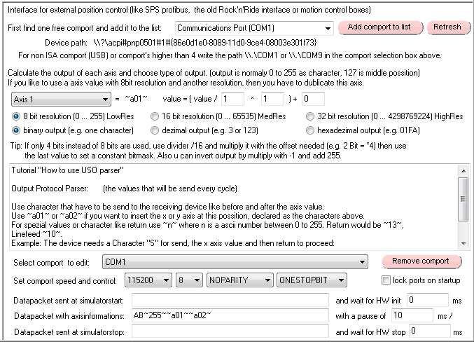

    Now that i have the AMC and lcd and pot's working.. its time to test with X-sim..
    Its quiet a bit more complicated than i thought.. I watched tronics guide but he uses x-sim 1.8..
    I put the axis information AB~255~~~y~~x~ .... but dont know where i can go to test it to make the numbers move on the lcd??
    I dont suppose there are step-by-step guide for using tronics Design on the x-sim 2.0?
    i cant figure out how to test it like tronic does in his tut video

    Hi ,
    You have set all wrong settings in the profiler... Load this profile please and use it as a starting reference:
    Thanos AMC1.5 firmware v1.1 (2DOF) 8bit.rn2
    It has some more axis in the math section (about instrument gauges) but you only need two for now (X, Y)
    The USO data packet was wrong on your photo. The correct one is AB~255~~a01~~a02~
    In the math section you can move the calibration offset of this axis slider to see the LCD screen numbers change or to move the motors on the h-bridge by hand.
    Regards, Thanos

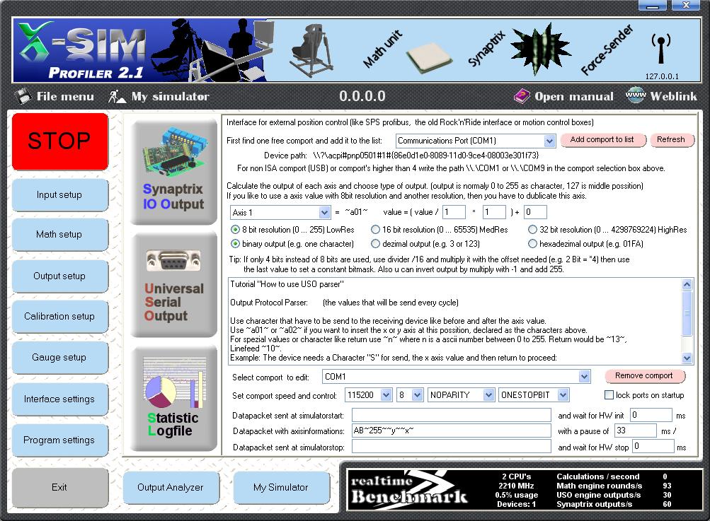

    So ive been playing around with it and still nothing.
    heres everything i have done.
    * Loaded the firmware on.
    * logged into the AMC via hypterterminal via com1 (to test it) - works.
    * installed X-sim2.
    * Loaded X-Sender . Clicked Try to send.
    * loaded X-profiler2.
    * loaded the setup file tronic gave me.
    * clicked Start.
    * Moved The calibrate axis bar..
    nothing :(
    would it most likely be a hardware issue? or a software setup problem?
    ps - i should note. when the pot is connected the numbers seem to move between (Random number between 0 - 100) and 863 ?????????
