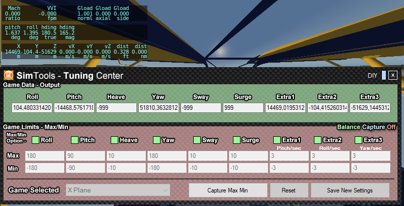

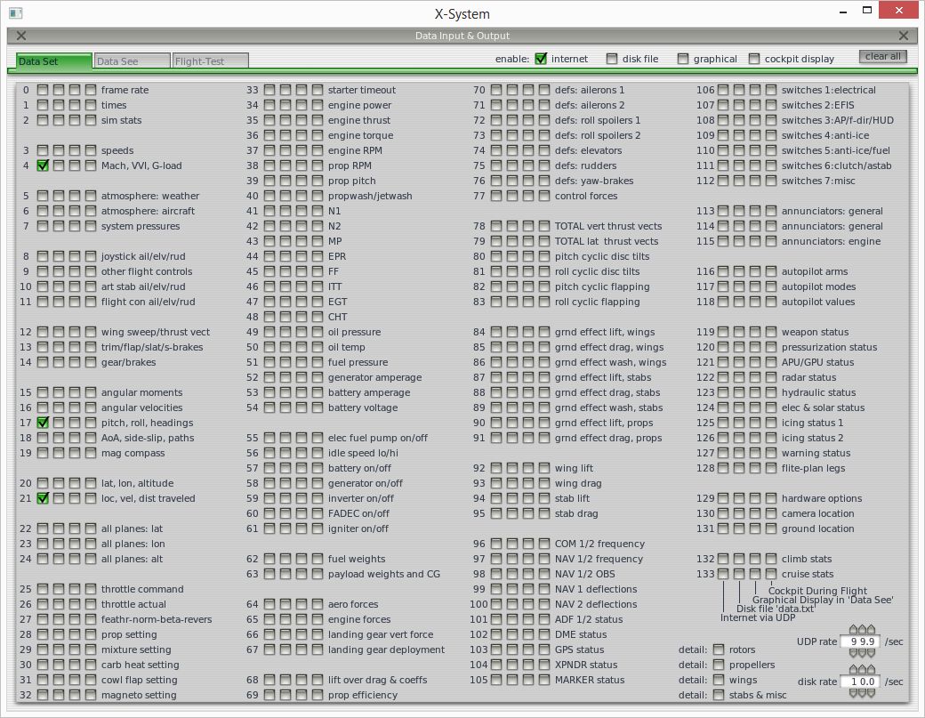

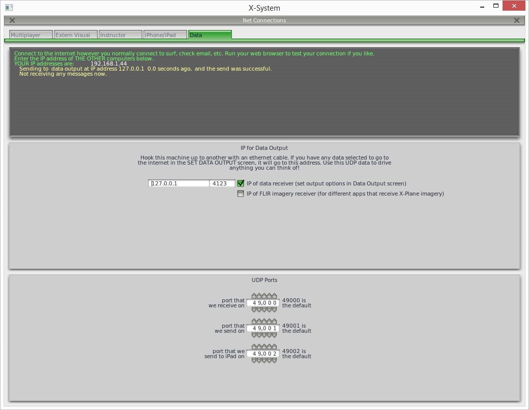

    Hello Value1,
    first thanks for the detailed explanation that did help me starting solving my problem of communication.
    unfortunatly, it does'nt work for me and i come to you to see if you could somehow help me.
    first what i use :
    • Xplane 10.51
    • Xsimulator
    • X plane plugin 2.0.2.0
    I did set the input/output windows as shown, so i did with the internet connection.
    the game couunicates with the simtools game engine but i have weards infos sent.
    on my screen, i have the datas i would like to send to xsilulator.
    I can read the pitch, roll and heave but on the tuning center, the datas are not the same as the one on the screen.
    when turning on the sim, it goes hard right and stays in this position no matter what i do with the plane.
    if somehow you see someting i could try....
    i also uninstalled the pluggin and reinstalled it. bu no change.
    all the best.
    railman.

    Check only the UDP chceckbox “Motion platform stats” in xplane. I think @value1 uses this stream in the last plugin

    Hello hexpod.
    Thanks for your fast reply that did solve my problem.
    All axes are now responding fine.

    You may want to use Simtools High Pass Filter under the name « washout » in order to bring the cue to the center. Also you can tune the min/max values in the tuning center. What you are asking for is already embedded in the heave cue.

    Thanks hexpod
    The answer was indeed in the definition of my min/max in the tuning center of xsimulator.
    Mine were set at +60/-60!.....
    Mooving them down to +3/-3 made all the difference.
    Thanks very much for your help and support.
