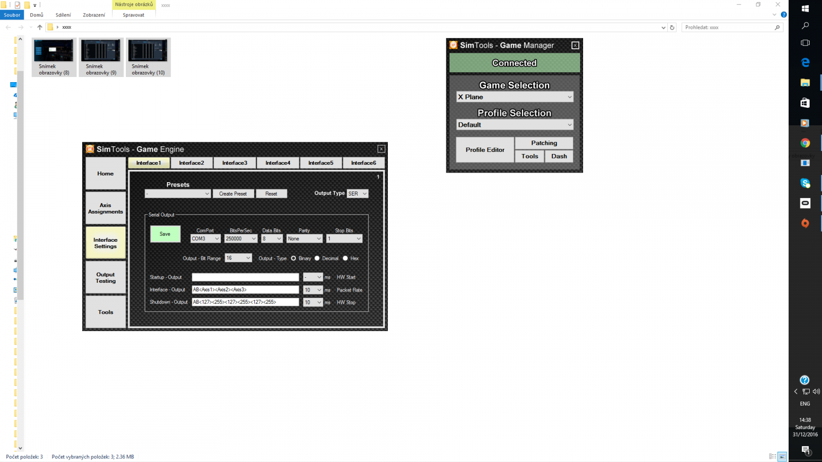

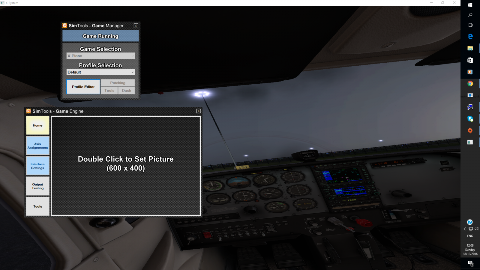

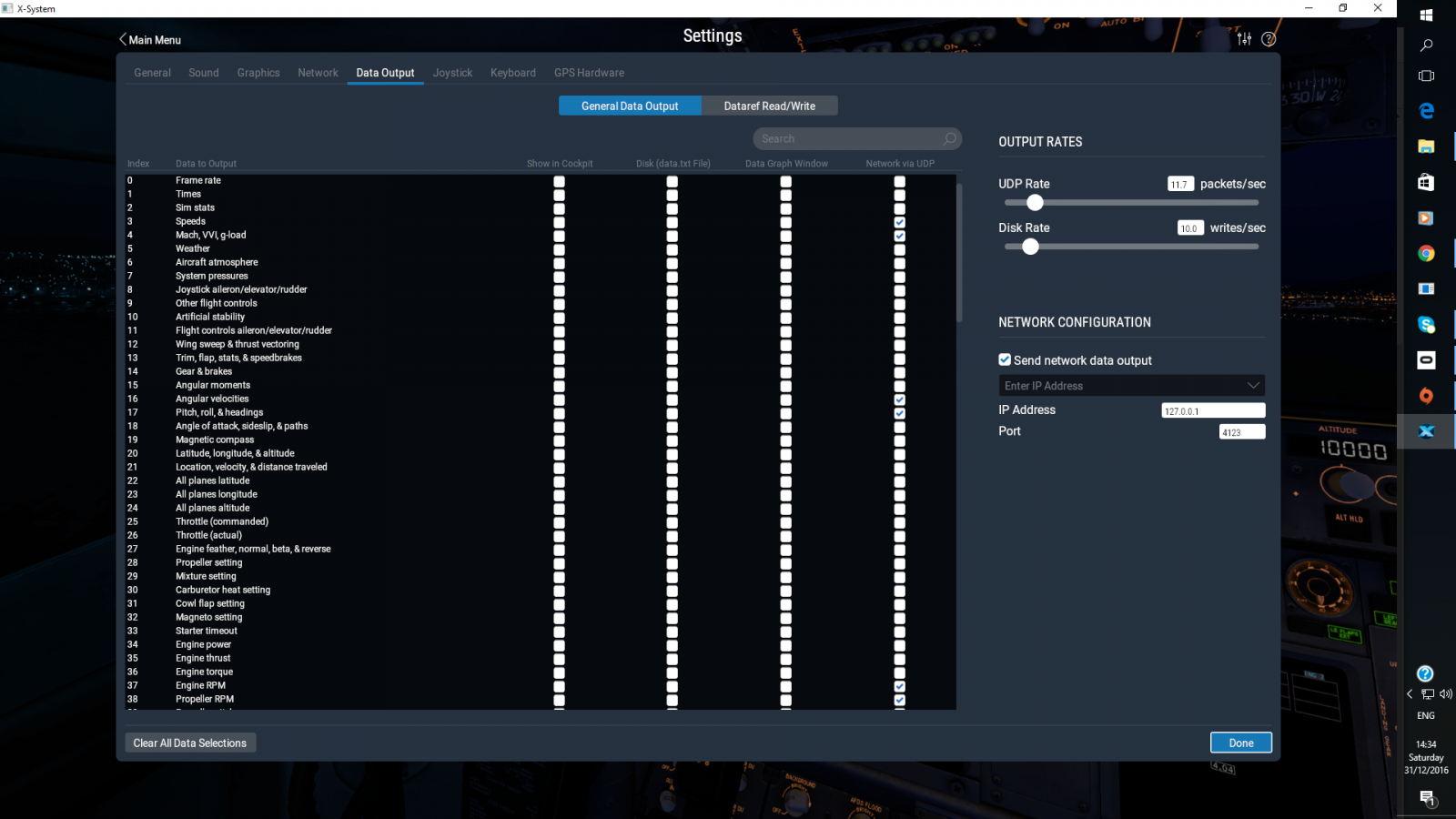

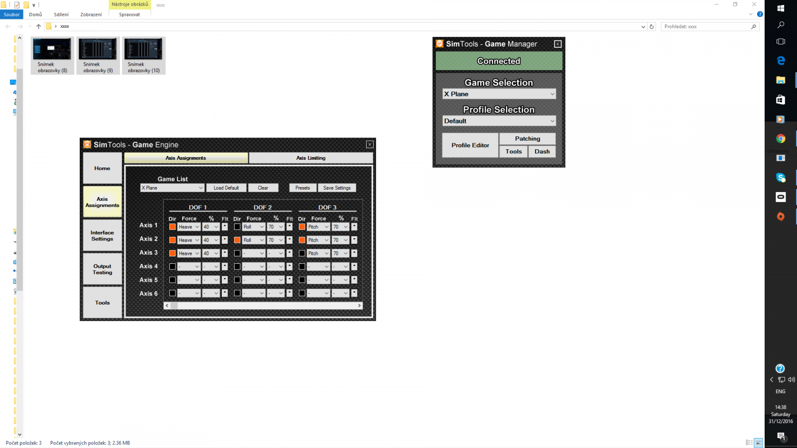

    Patch the game with GameManager.(blue) ok
    My problem is that the games do not want to send data to the game engine.
    thanks

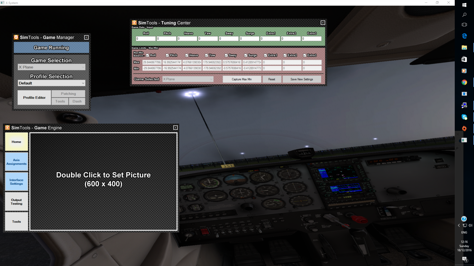

  13. noorbeast
    21,724
    152,057Coins
    +11,063 / 56 / -2
    Are there values in the top row of the Tuning Center?
    Screenshots of your settings would help.
  14. misoswan
    misoswan Active Member
    Jun 27, 2014
    291
    1,032Coins
    +77 / 1 / -0
    3DOF, Arduino, JRK

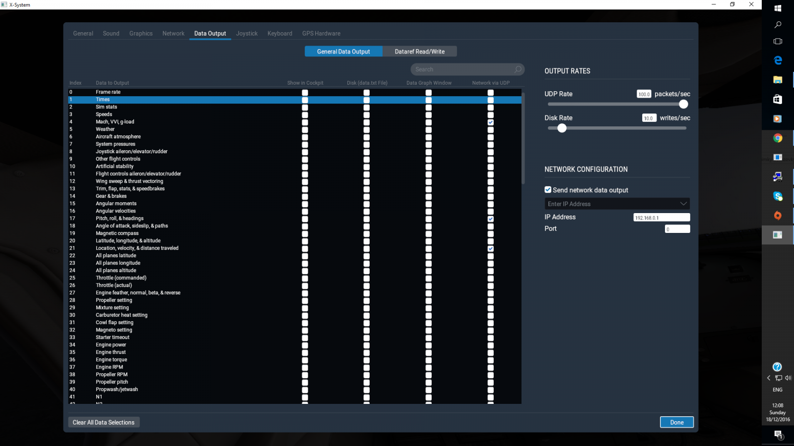

    hello
    I don't know what should I tick.

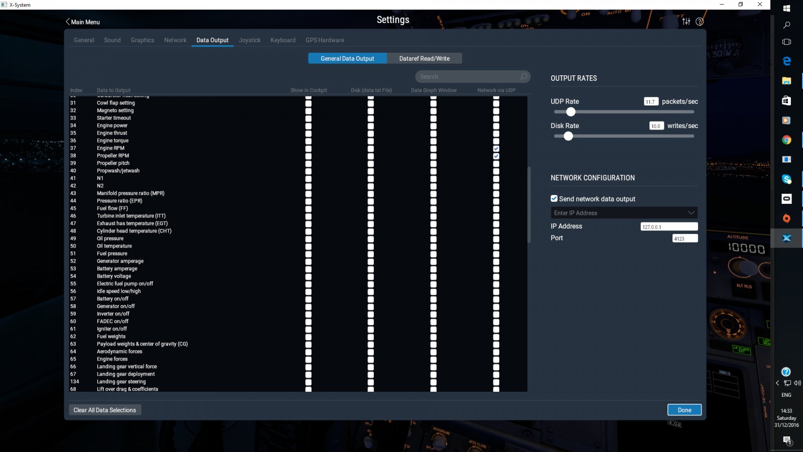

  16. value1
    Jan 9, 2011
    2,185
    Zug, Switzerland
    15,029Coins
    +3,338 / 12 / -1

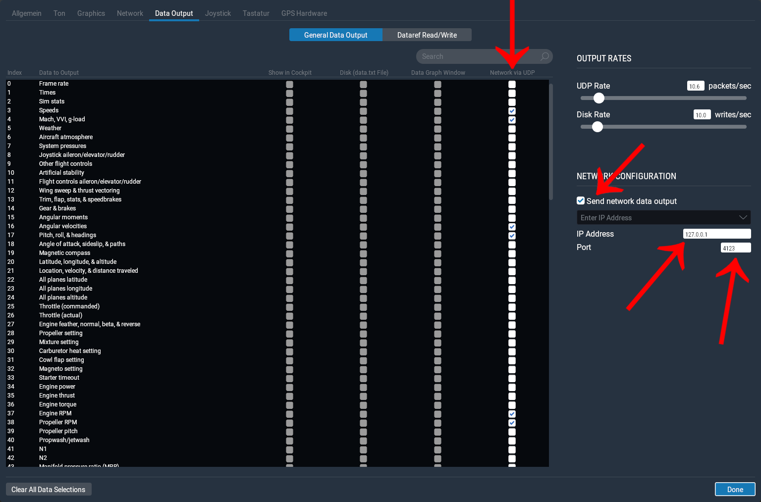

    In the Data Output settings, last column "Network via UDP" click
    • 3 Speeds
    • 4 Mach, VVI, g-load
    • 16 Angular velocities
    • 17 Pitch, roll, & headings
    • 37 Engine RPM
    • 38 Propeller RPM
    Click
    Send network data output and enter IP Address 127.0.0.1 and Port 4123.
    With this configuration it works here fine.
    • Informative Informative x 4
  17. noorbeast
    21,724
    152,057Coins
    +11,063 / 56 / -2
    Thanks, I have added this to the Game section of the FAQs for easy future reference: https://www.xsimulator.net/community/faq/x-plane-udp-settings.259/

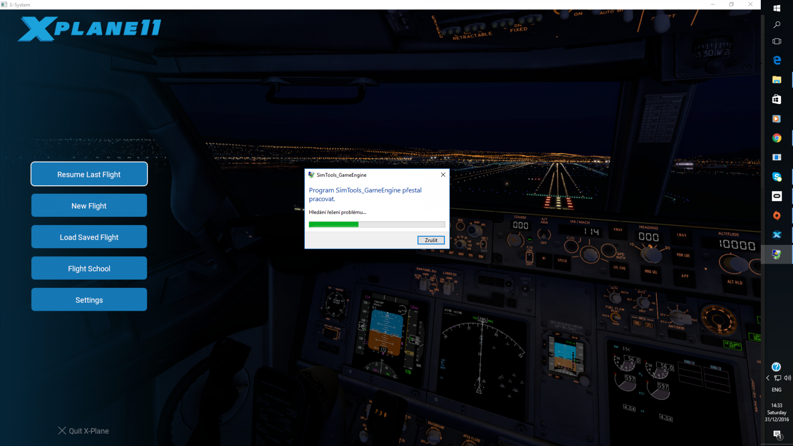

  19. misoswan
    Jun 27, 2014
    291
    1,032Coins
    +77 / 1 / -0
    3DOF, Arduino, JRK
    simtools stopped work :( any idea why
  20. noorbeast
    21,724
    152,057Coins
    +11,063 / 56 / -2
    There could be lots of different reasons, can you elaborate under what circumstance did it happen and is it reproducible?
