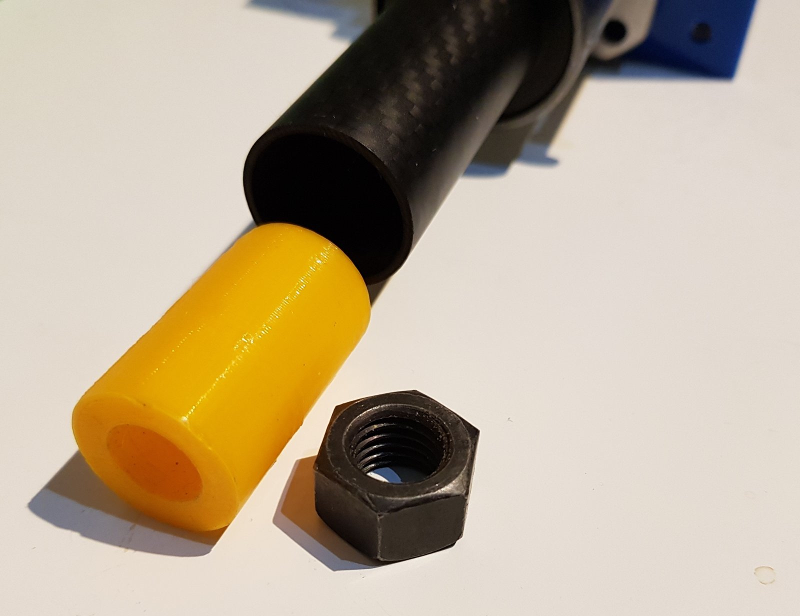

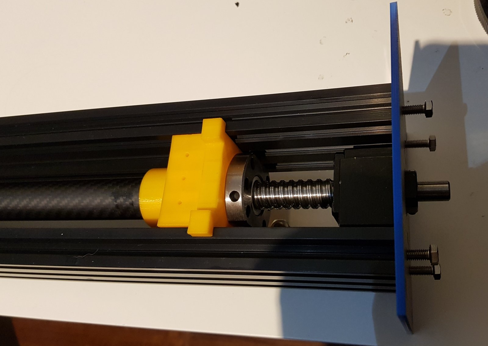

  5. SixDegreesOfFlight
    SixDegreesOfFlight Well-Known Member
    Jul 7, 2017
    250
    Secondary Teacher: Systems Engineering & Computing
    Melbourne, Australia
    2,224Coins
    +399 / 0 / -0

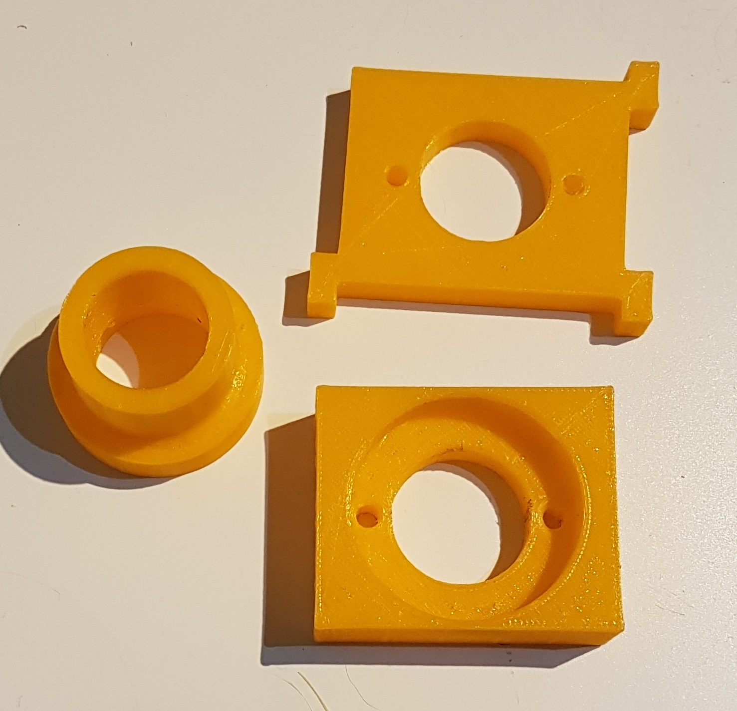

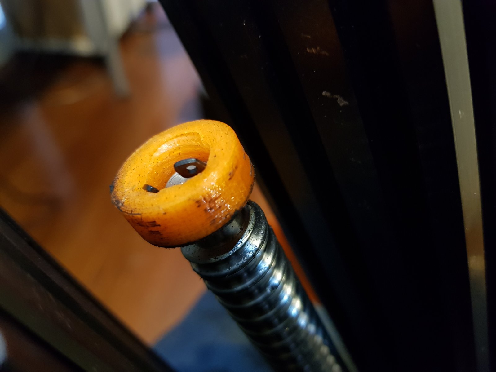

    Had some time today for test printing the lead screw ball nut adapter. Everything is a friction fit a the moment. The carbon rod sleeve it very tight so I might have to give it some room for the 3M epoxy. Edit October: it would have been better to have one part rather than three separate ones - maybe combine them with Meshmixer? This would have avoided one rod being epoxied at an angle and would make the overall part much stronger.
    Edit Nov2017: I posted the Fusion 360 files for these parts in the first page of the thread. They MUST be modified as they will rub on the frame. The edge closest to the frame needs at least a 2mm clearance on either side. In other words, it needs to be at least 4mm narrower on the dimension closest to the V Slot extrusion.

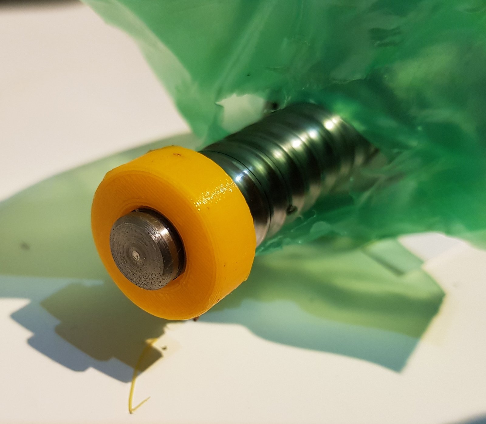

  6. SixDegreesOfFlight
    Jul 7, 2017
    250
    2,224Coins
    +399 / 0 / -0

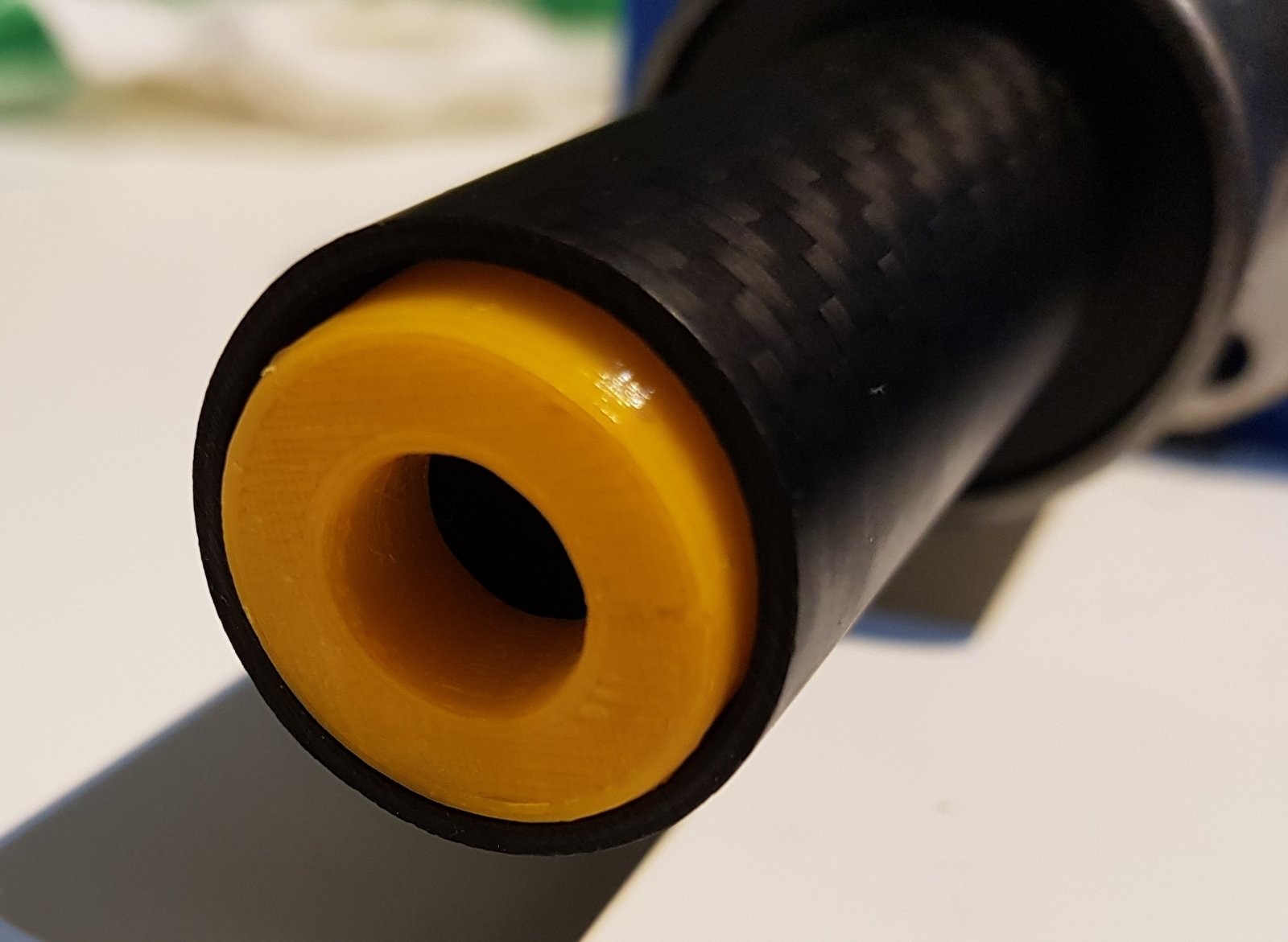

    ...and the anti-wobble ring
    Edit (Nov 2017): I am not recommending using this idea - it causes too much friction on the inside of the tube and is more of a source of problems than what it is trying to solve. See the attached photo of what the ring looks like after a few months of use.

    Out of interest, has anyone tried using one of those POM/Delrin bearings to go at the top of the ballscrew?
    The bearing should do a better job of reducing rotational friction and POM is a fairly low friction material anyway so should be pretty good at handling any vertical movement. It's also hard-wearing.
  9. SixDegreesOfFlight
    Jul 7, 2017
    250
    2,224Coins
    +399 / 0 / -0
    @DEADBEEF
    A few projects on Xsim have tried different bearing types for the top part of the actuator including sintered bearings, igus polymer, 3D printed and linear ball bearing to name a few. I liked the idea of the longer linear bearing to support the side load on the carbon rod, coupled with the fact that it was cheap and fitted exactly. It will be noiser and it may wear the carbon rod prematurely. However, like most things what now seems to be final design becomes just another step to something better a little way down the track.
    Edit: I have re-read your post and I think you now mean where the anti wobble ring goes? @wannabeaflyer2 and @baykah discussed this and came up with the idea of the 3D printed ring held at the top of the lead screw by the cir clip. They suggested it be quite loose and not rub on the inside of the tube only touching occasionally - at least that is how I read the exchange. A proper bearing might be a good idea, maybe someone else can give their opinion?

    Yes, I meant the anti-wobble ring.
    You'd want to use a plastic bearing to save wearing the inside of the actuator tube, but assuming you can get one which has the right inner/outer diameters and is thin enough to be secured by the circlip I'd have thought that'd be a better solution as it'll have far less rotational friction (which is where some 95% of any movement will come from).
    Granted, there shouldn't be a great deal of friction there anyway, but I'd imagine that anything you can do to reduce what there is has to be a good thing.

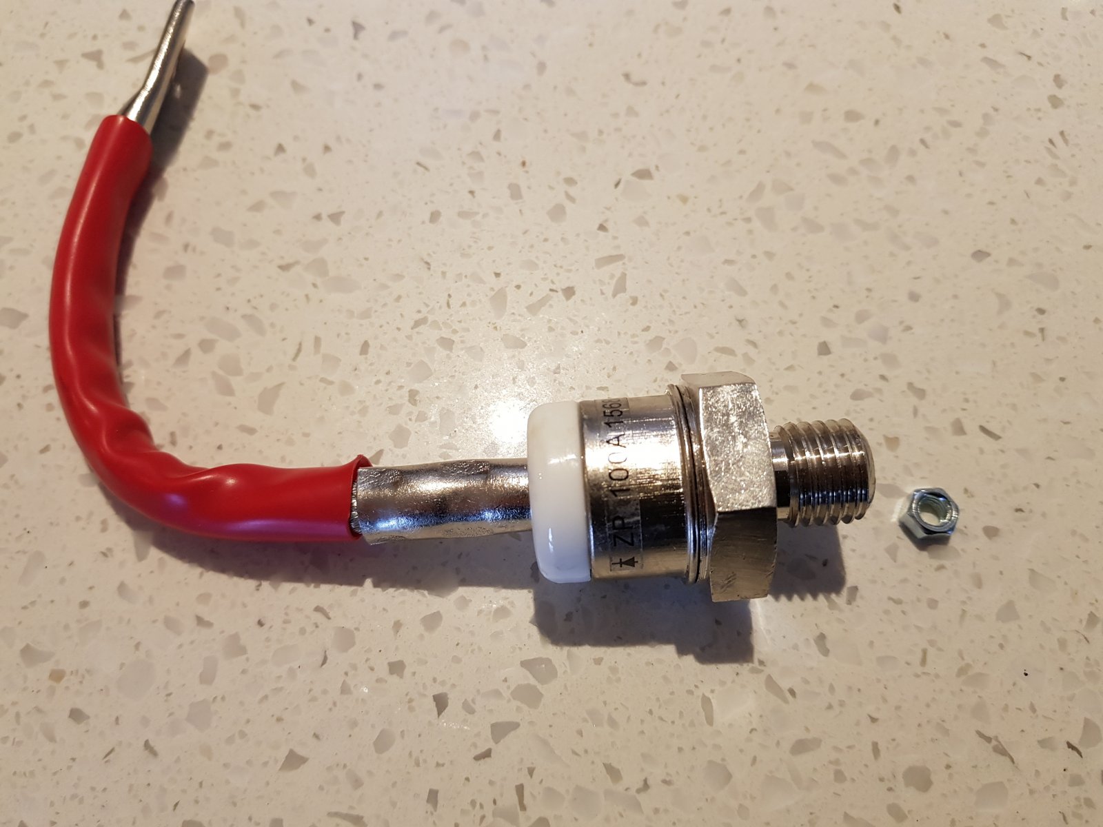

    The blocking diodes arrived yesterday and they are massive! I wanted a continuous working current of around 35A and a high reverse peak in a stud mounted package. These were the only ones I could find with a reasonable postage...but they are HUGE :grin
    The image shows it compared to an M5 nut
    Edit: they may be available in different packages but the ones I received has the case as the anode which will make things difficult if I want two to share the same heatsink

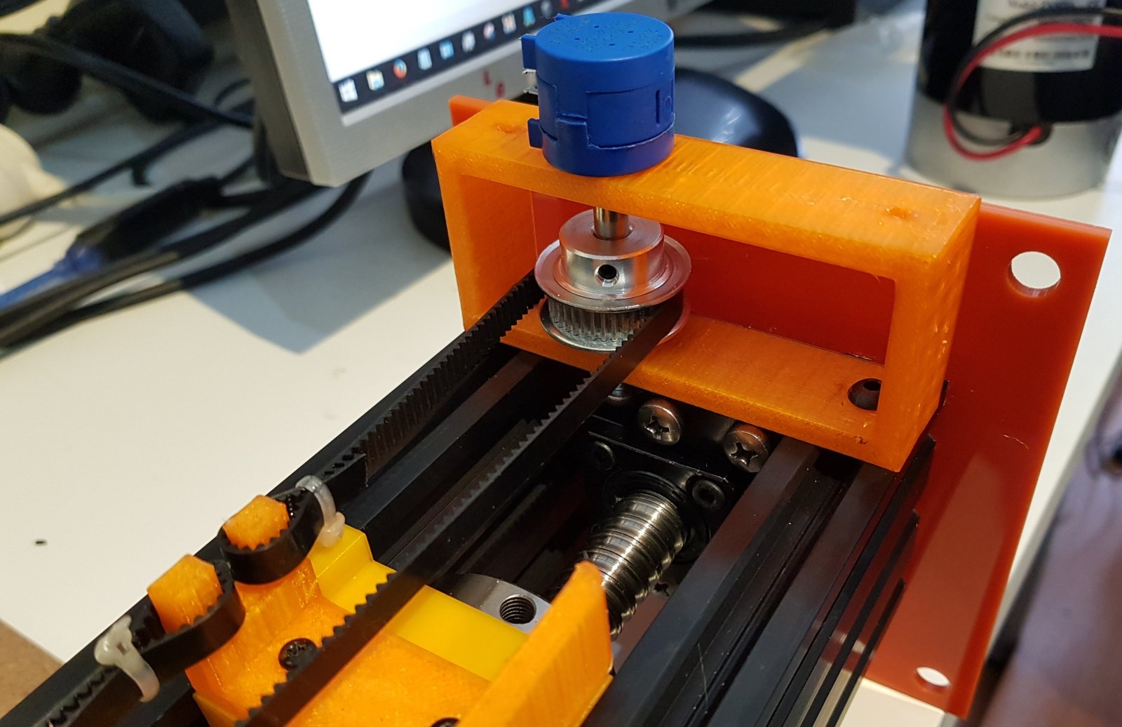

  12. SixDegreesOfFlight
    Jul 7, 2017
    250
    2,224Coins
    +399 / 0 / -0

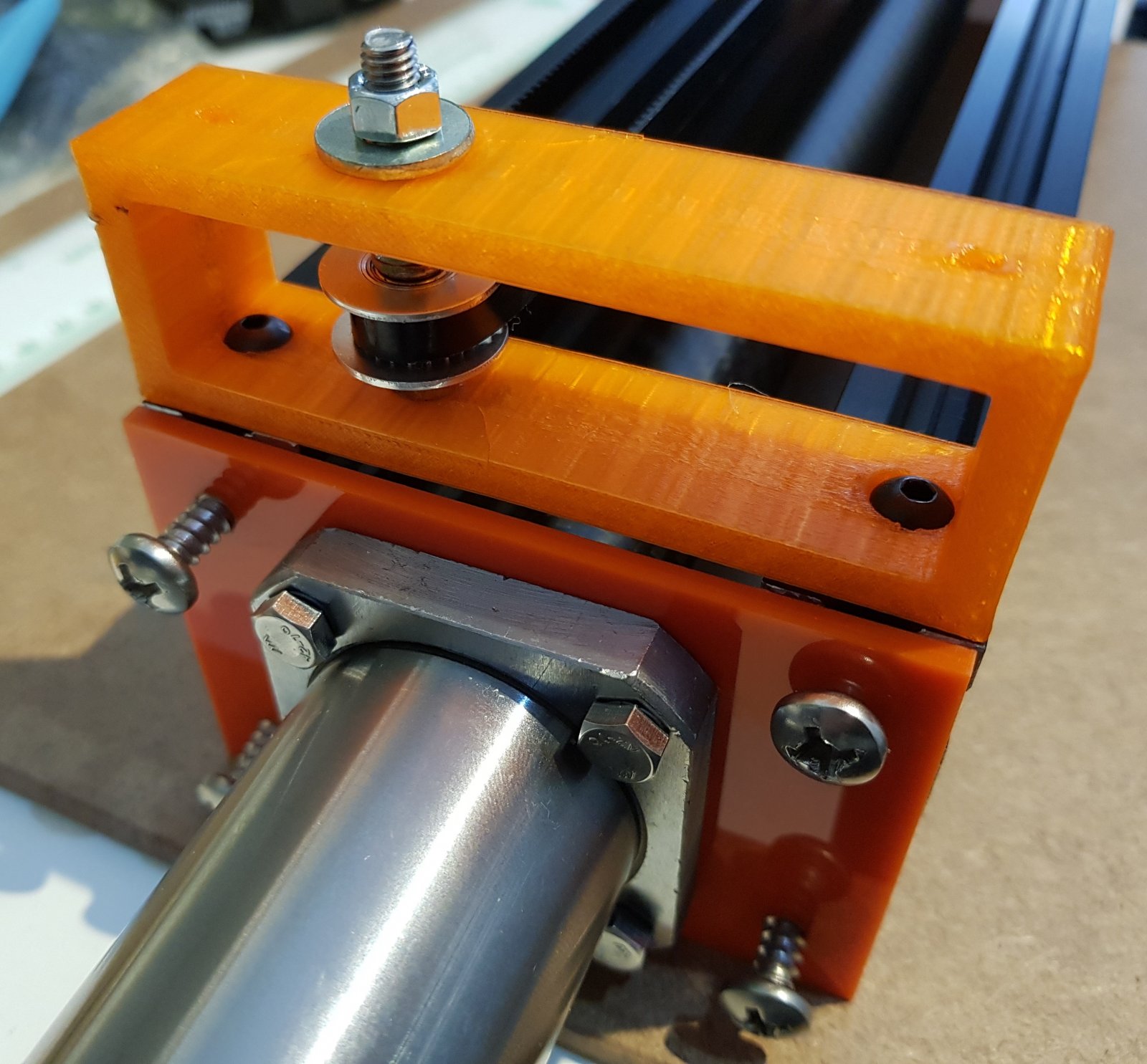

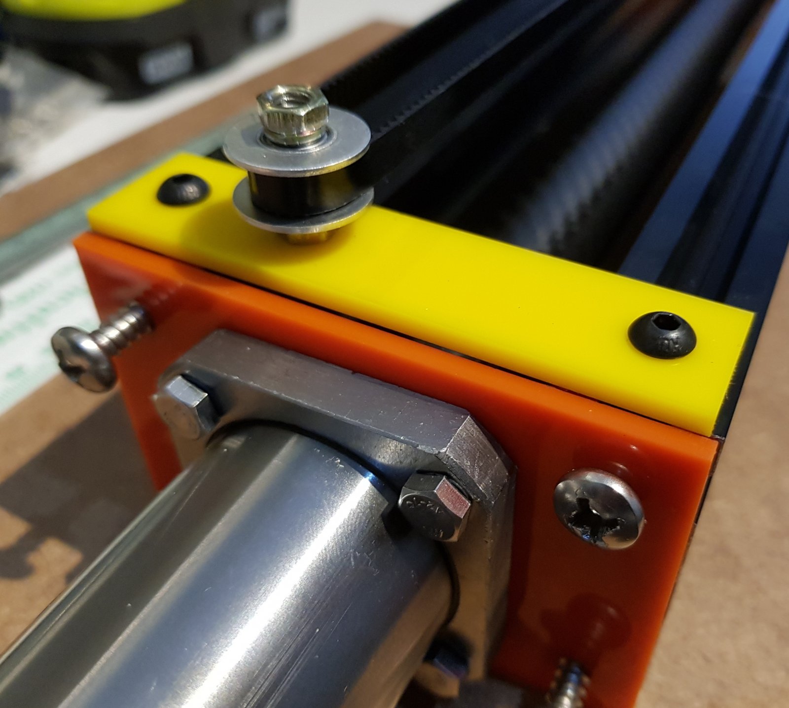

    I began experimenting with the position belt and pot.
    The PLA filament was getting really annoying as it kept breaking into multiple bits within the bowden tube which meant 10 minutes of wasted time re-threading it and clearing the hot-end. I wouldn't recommend the Anet PLA filament, it is simply too brittle.
    So time to give the eSun PETG a whirl. Very easy to work with and I don't have to heat the bed. The parts are much easier to remove from the bed once finished too. I did find, though, that if I tried any hot-end temp lower than 245C Skynet would stop the print after the first layer and report a 'thermal runaway'. I suspect the hot-end fan is working too efficiently and dropping the temp more than 10C for 60 seconds which triggers the panic stop.
    The image showing the Bourns 10 turn pot frame has a M6 bolt underneath the supporting the geared pulley. I am trying to get the bolt to take most of the tension of the belt. The other two images of the top idler pulley show two variations - one 3D printed and the other cut on the laser from 3mm acrylic. I will probably go with the laser one.
    Using my battery drill I ran the actuator its full length and counted how many revs the pot turned which ended up to be nearly 5 full turns. As I haven't even thought about Simtools yet I hope this can be adjusted in the settings.

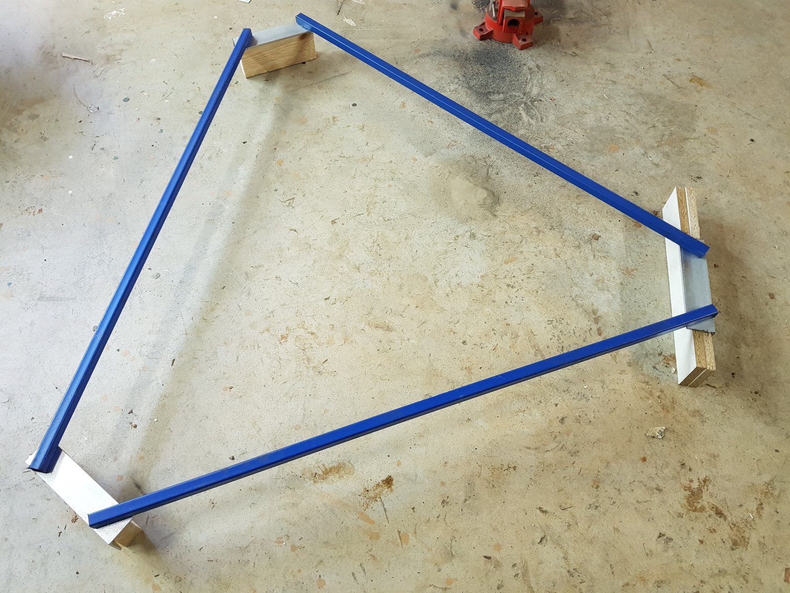

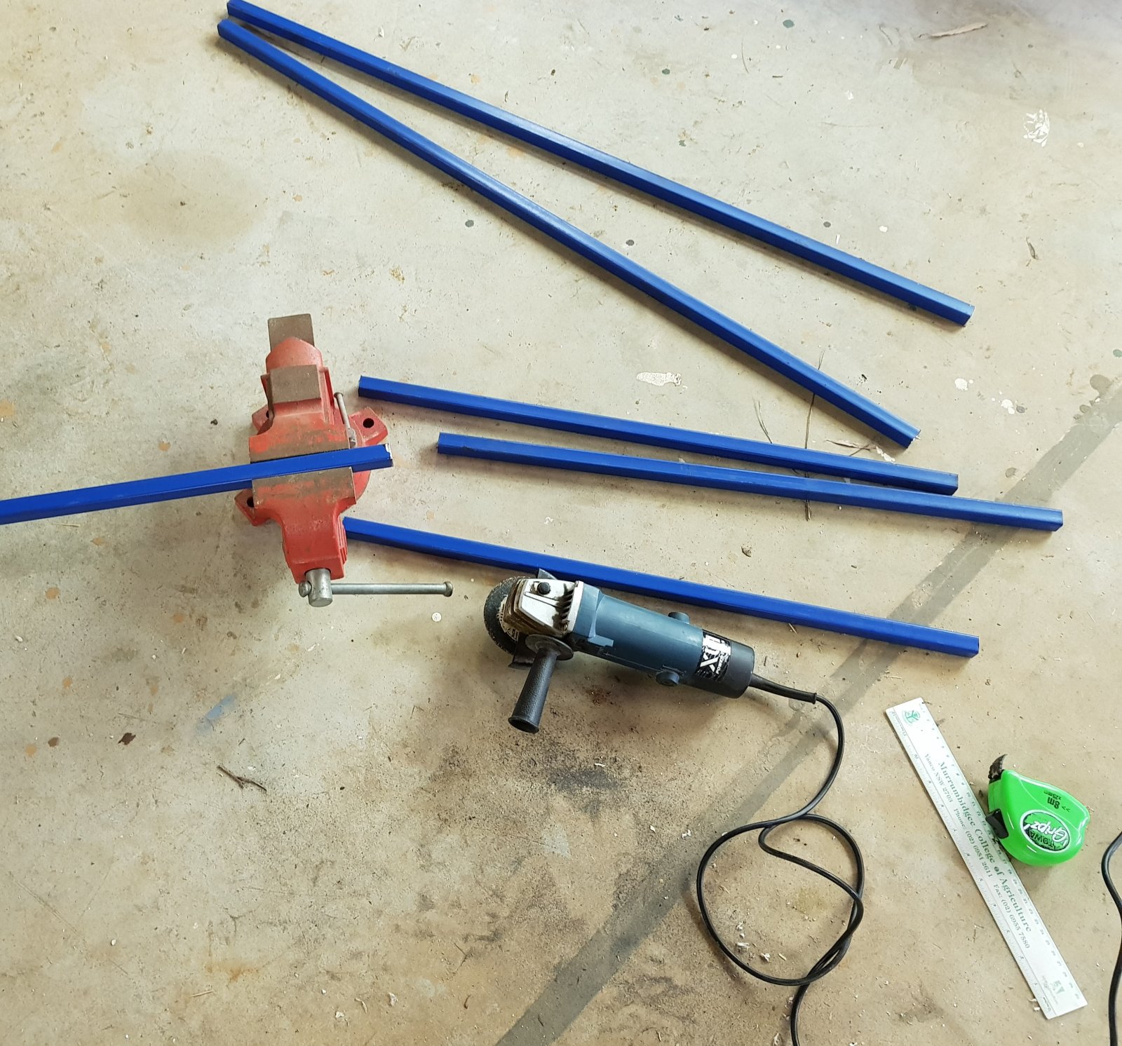

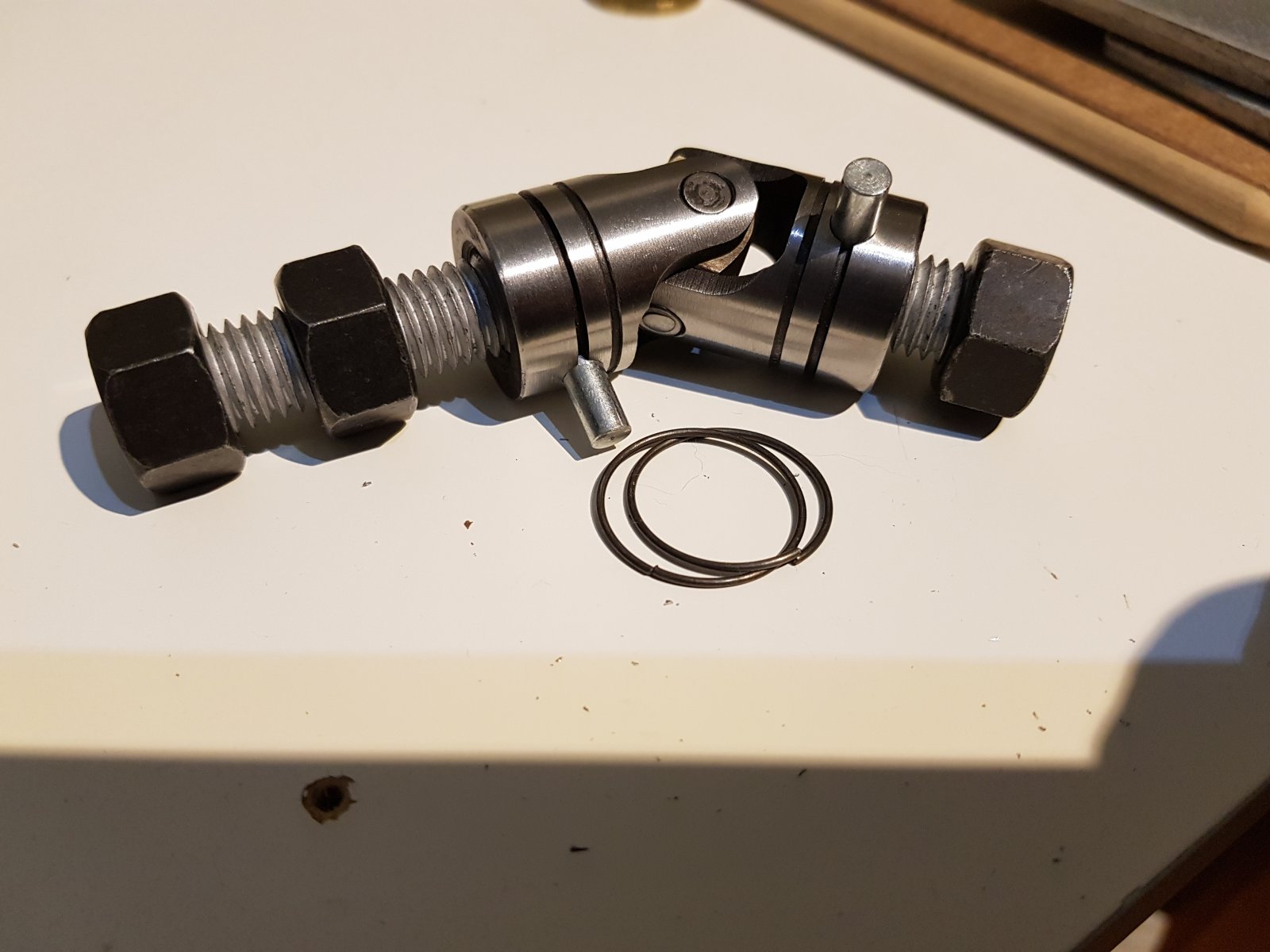

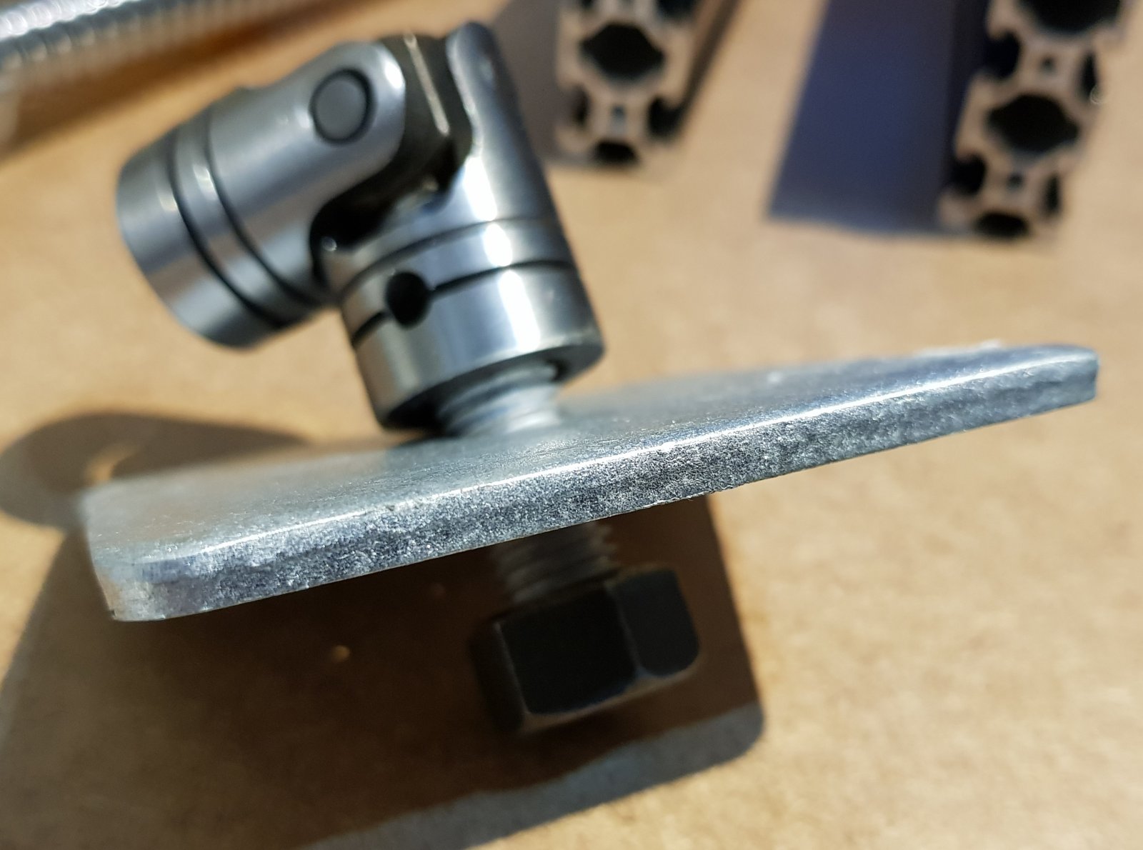

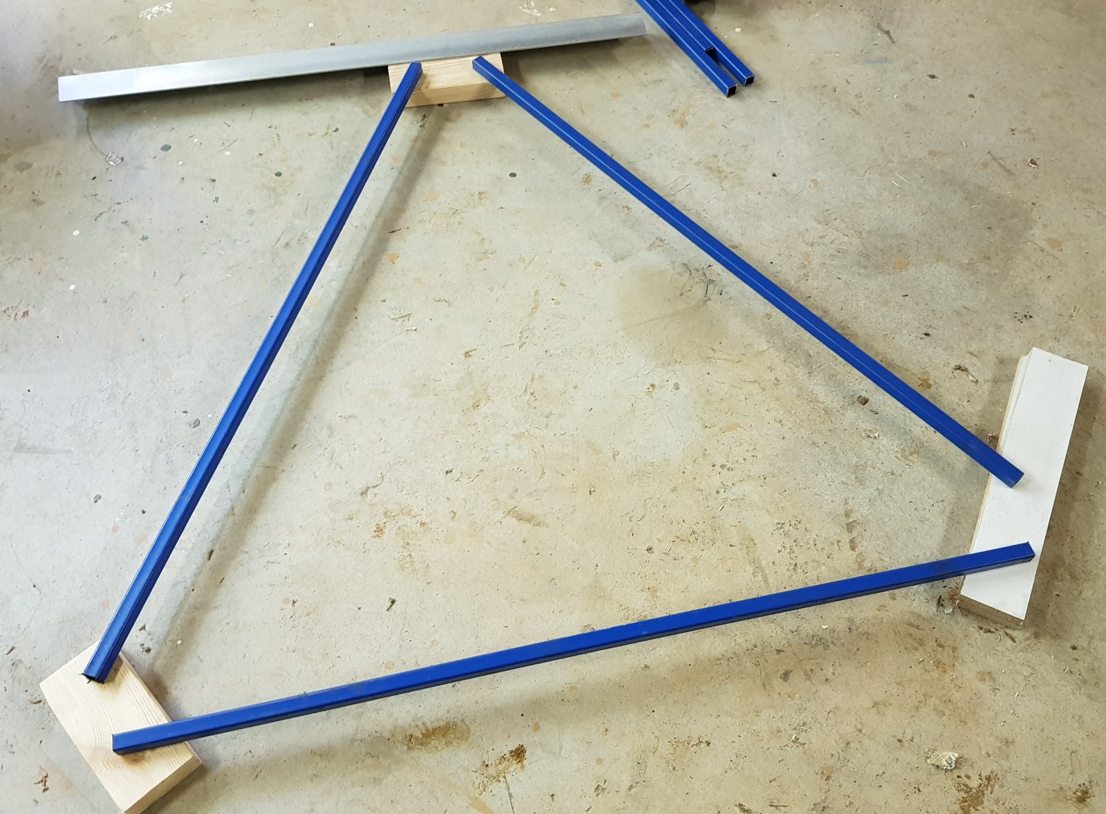

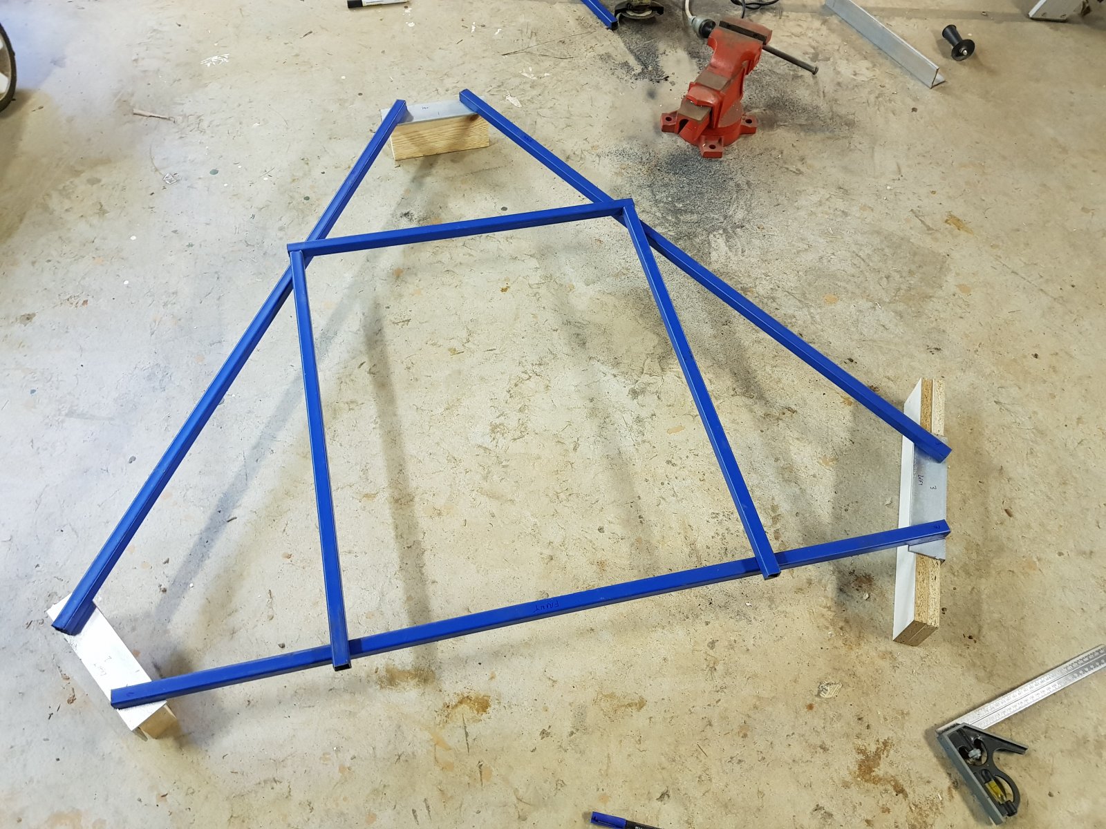

    This afternoon I thought I would pull out the angle grinder and start on the upper frame. I cut the 20x20x1.6mm steel tube into 1100mm lengths and the 50x50x4mm angle into 240mm lengths. The idea was to reduce the time to set it up when I get the chance to weld it at school with the MIG.
    I also cut the M12 rod for the u-joint. The last image shows a 75x75x4mm 'washer' I got from Bunnings for $1.50. This will help spread the load of the actuator on the timber frame.

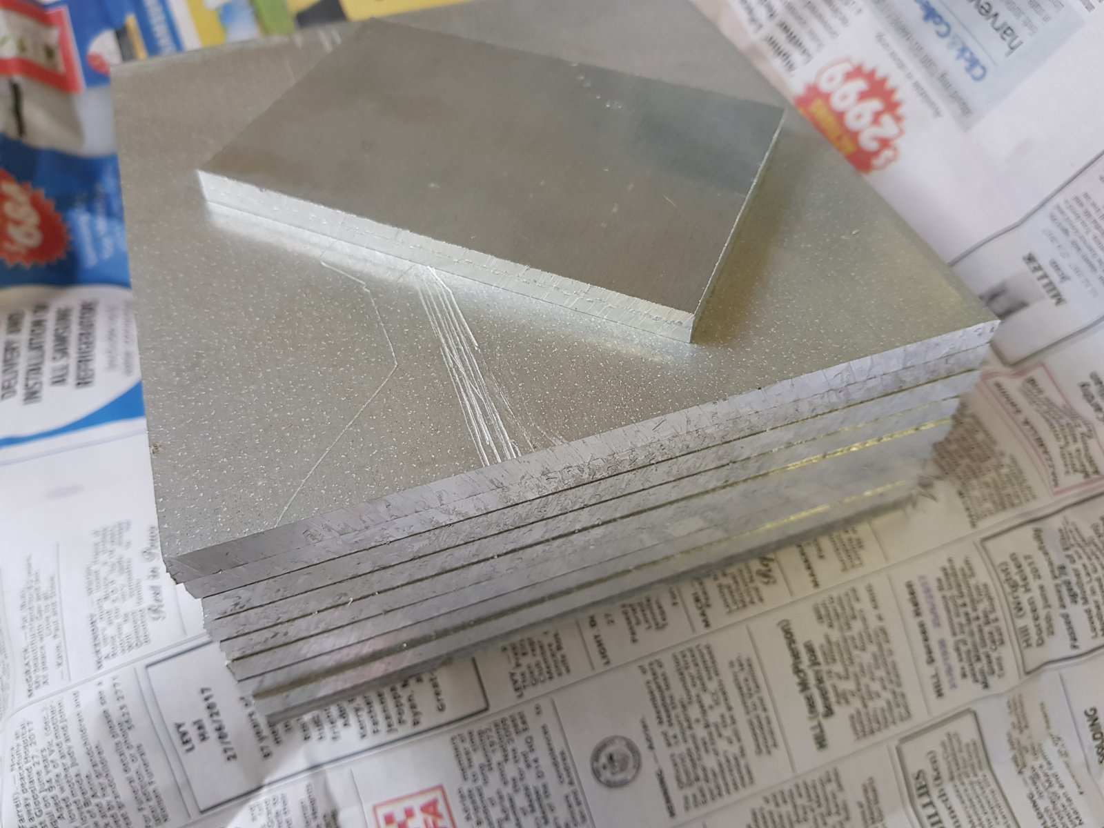

    Great day today...Kev brought in the 6mm aluminium sheet and cut it up for me :grin Good on ya Kev! I am going to finalise the drilling template tonight and begin drilling the pilot holes tomorrow. I also drilled the M12 threaded rod for the u-joints to see how that would work.
  19. wannabeaflyer2
    Jun 12, 2015
    724
    london uk
    8,359Coins
    +958 / 7 / -0
    Hi @SixDegreesOfFlight nice work and pictures , very helpful stuff , got a piece of experience to pass on regarding the Universal joints and mounting plates , I used the same method on my platform as you ref Picture 20170814-1 and to a great extent it was ok but I found that the actuator could twist if the Nuts became loose , I have my platform in bits at the moment to redo this support joint part of the build ... the method works but if the joint were welded or permanently secured to each top and bottom plate it would prove to be one less area to worry about ..
    as I always say guys this is not a criticism just my way of passing on what may be helpful info learnt by experience... I think @SilentChill welded his in place and I aim to follow suit :) This Tight arse just need to buy some material LOL ...E bay anyone :) cheers
  20. SixDegreesOfFlight
    Jul 7, 2017
    250
    2,224Coins
    +399 / 0 / -0
    @wannabeaflyer2
    Thank you for the helpful advice :thumbs I am trying to follow your build as closely as I can.
    I feel like I have met you in person as I have watched your videos so many times and studied your photos hug:
    I will put some spot welds on the joints as you suggest. I noticed in one of your early test videos that the actuators did twist quite a bit.
