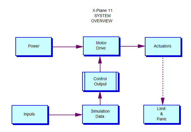

    I have finally settled on my interpretation of how the 6DOF is going to work (updated 23JUL17@19:11):
    Edit September: I have discovered that the Sabertooths respond to the Arduinos better if they are powered up first. The Arduinos send out an auto-baud command to the Sabertooth when the Arduino powers up. This means that the Sabertooth must be powered on first before the Arduino. So the turn on/off sequence will need to be changed. Also I don't think the Arduinos will need to be powered externally from the 12V source. They seem quite happy being powered by the USB hub. Once the Arduinos are powered-on they command the actuators to go the the middle of their travel. So the platform always starts from the same position.
    The power up sequence is now:
    1. Power supplies
    2. Batteries
    3. Powered hub
    4. Gaming pc (otherwise the pc will power the hub on its own)

    Small update to the cost spreadsheet and a slight change to the schematic to remove the need for an additional 5V power supply for the Unos. I have also included the weight of the steel and seat in the spreadsheet which will give some indication of the weight of the top frame

    @SixDegreesOfFlight , Are there three independent circuits in your schemat ? Will you have three independent power supplies? Did I understand correctly your scheme?
  16. SixDegreesOfFlight
    SixDegreesOfFlight Well-Known Member
    Jul 7, 2017
    250
    Secondary Teacher: Systems Engineering & Computing
    Melbourne, Australia
    2,224Coins
    +399 / 0 / -0
    @Grizus
    Yes that's right. If you are following the kind of build led by @SilentChill & @wannabeaflyer2 then you put all the power supplies in parallel, otherwise you split them up into three modules like @baykah (at least that is what it looks like from his photos). @SilentChill has shared his ideas about his approach in many replies and you have to consider that he has a fully working, proven system.
    I suppose my concern is trying to balance the six power supplies in parallel. Inevitably, there will always be one or two supplies doing the 'heavy lifting' while the others cruise. It apparently, doesn't seem to matter too much seeing as his platform has been working fine for 8 months ;)
    So my thoughts at this stage is three separate modules each with two psu & two batteries driving a Sabertooth 2x60.
