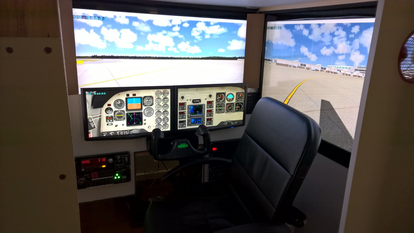

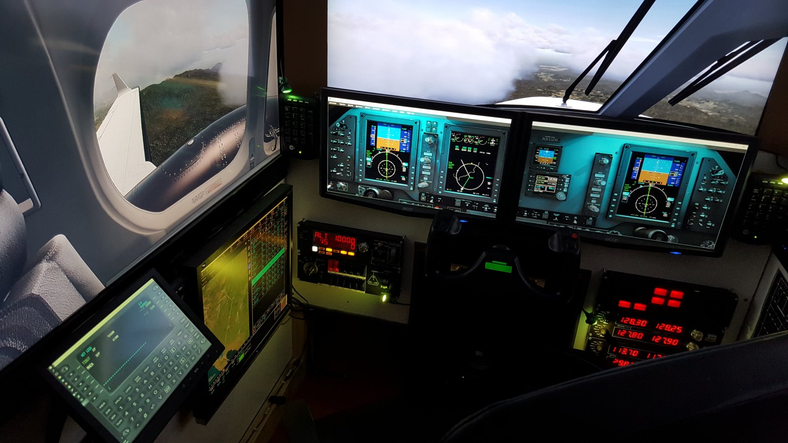

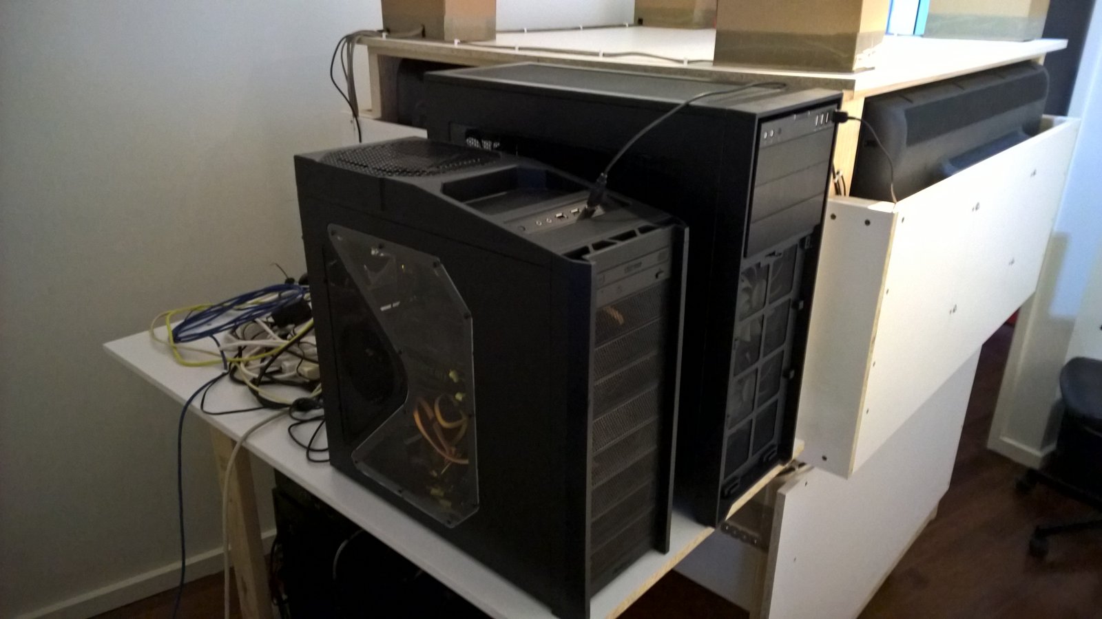

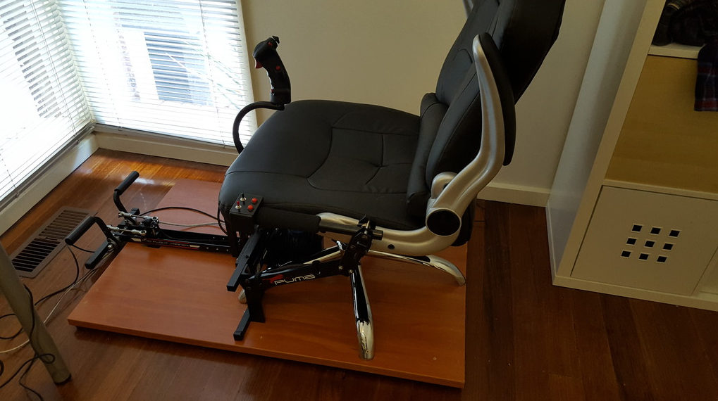

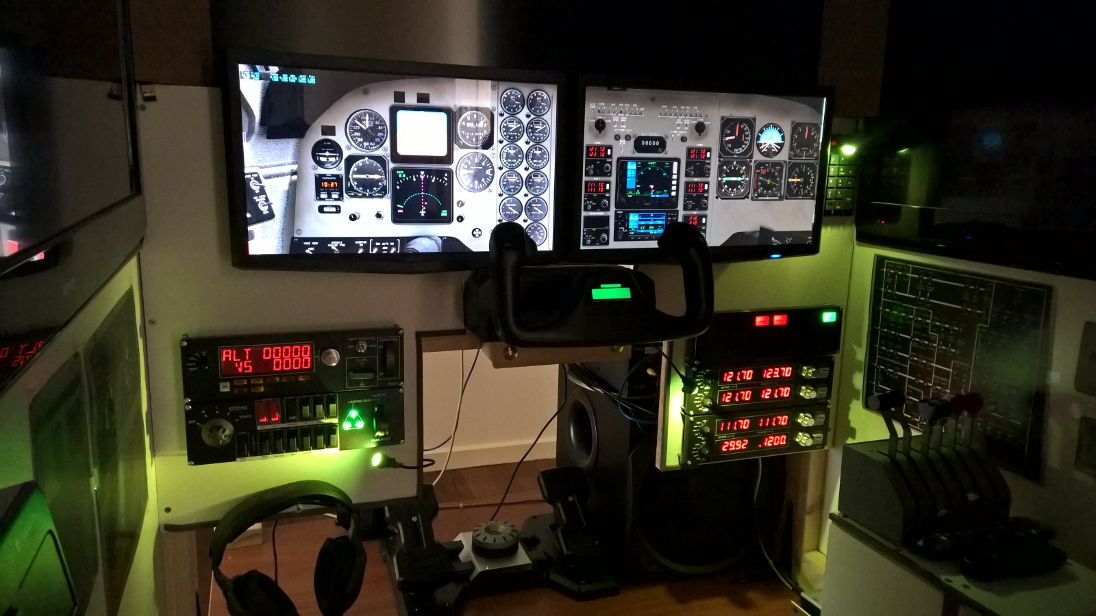

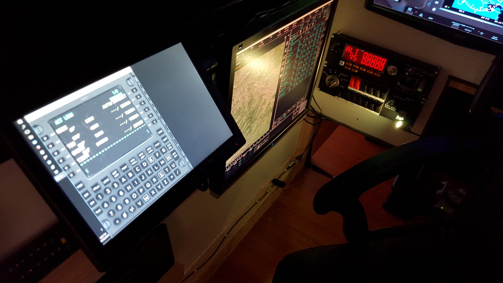

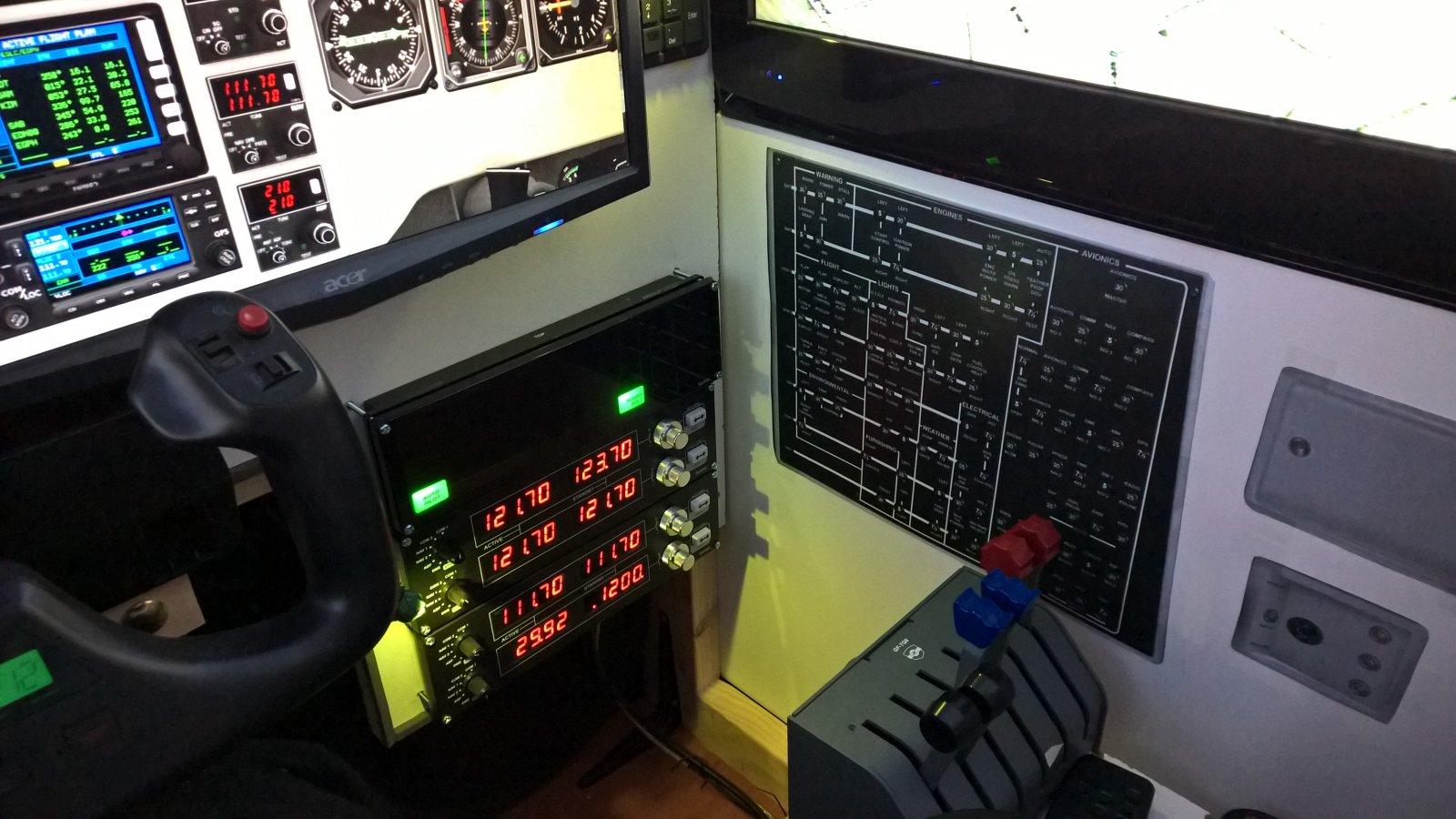

    This might be of interest to other flight simmers - my previous cockpits.
    The first image from a couple of years ago is one pc and a 42" 1080p, and 2 x 19" for the instruments. This was followed by a data projector for the main screen in an effort to increase immersion.
    The following six images are a walk-in cockpit with three pcs, 3 x 42" 1080p monitors 3 x 19" monitors and one 10" touch screen.
    The final image is what I have now with the HTC Vive and what will be used on the 6DOF platform - Puma helicopter controls
