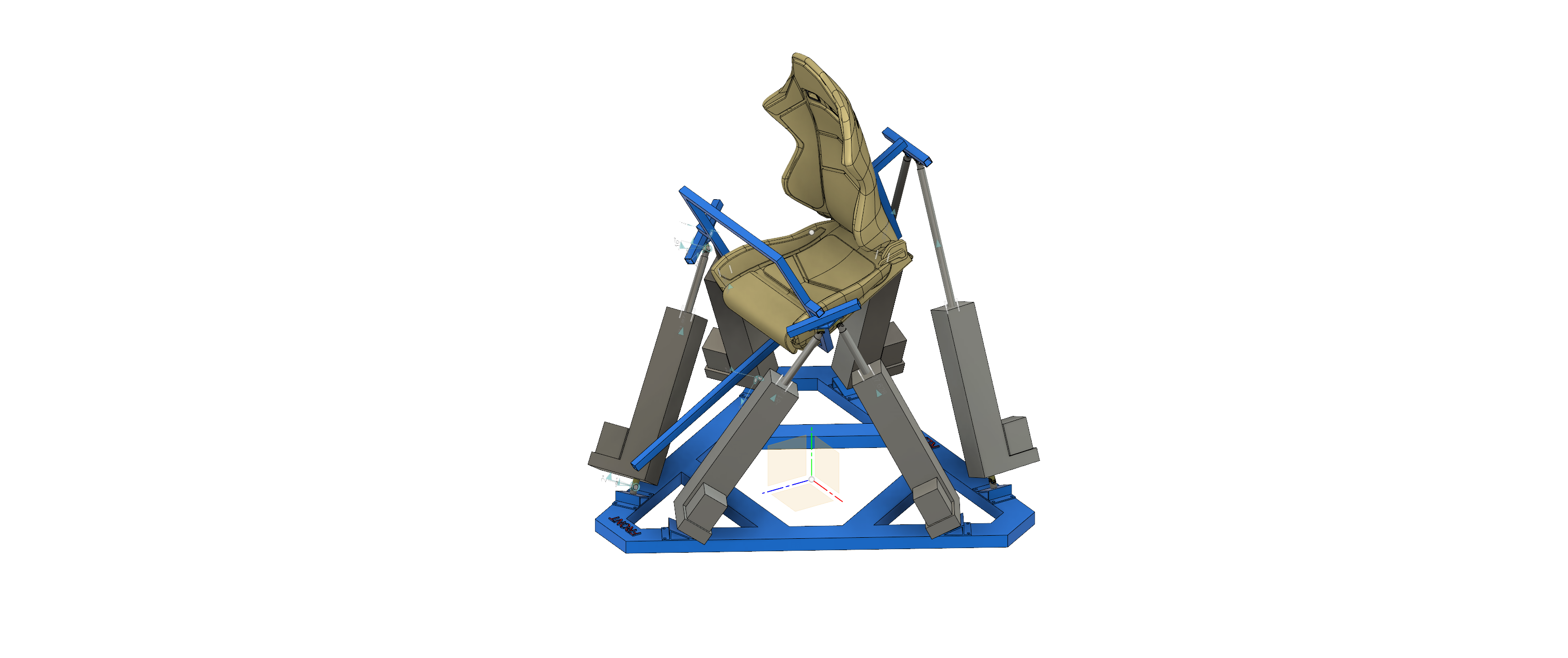

    my project also keep going. I have to admit that your previous pictures maded me back again in the project. I was near giving up.
    I have a question (again) : are your 1605 screw ball reversible ? do your seat go down when you stop motors ?

    @dureiken
    If you are asking whether they will 'unscrew' down on their own if you turn off the motors while sitting in the seat (like if you hit the panic button) then the answer is yes. They don't do it if you are not sitting in the seat. The two front actuators generally are the only ones to do this because they are carrying more weight than the other four. The small 'table' I built yesterday will stop it sinking all the way down to the bearings. There is some rubber under the bottom bar of the helicopter controls which will touch the table first.

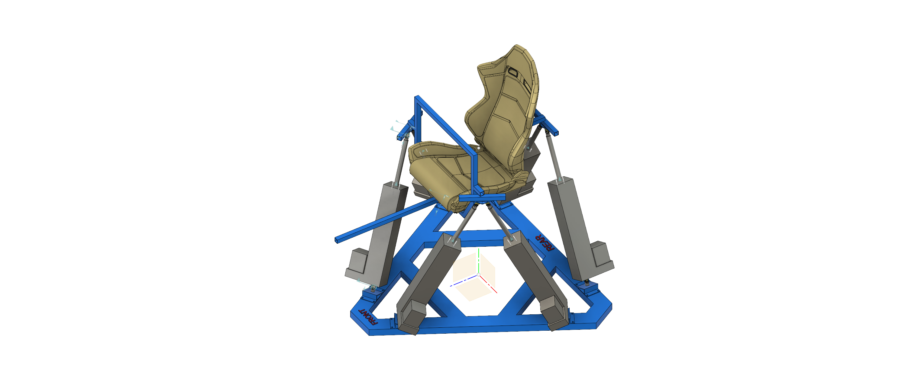

    @SixDegreesOfFlight just a question about your actuators : how do limit switch interact with command ? it cuts all the power ?

    @dureiken
    I have posted the schematic for the panic/limit circuit towards the beginning of this build thread. I can tell you it works perfectly ;) The 'start' button you see in the video is a 'self latching' relay which is basically a normal car horn relay that keeps itself powered up - that is the relay contacts provide power to it's own coil. In series with that circuit are all the limit switches and the panic button. If any of them are pressed the power is removed from the self latching relay coil and the relay drops out. This removes the power to all the relays whose contacts form a switch between the sabertooth and the negative lead of the motor. So all power is cut to all motors. The power supplies, batteries and sabertooths are still running at this point. To restore operation, I have to hand wind whichever motor has hit the limit switch to move it away from the limit switch lever. I can then press the 'start' button again. I hope I have explained it clearly :)
