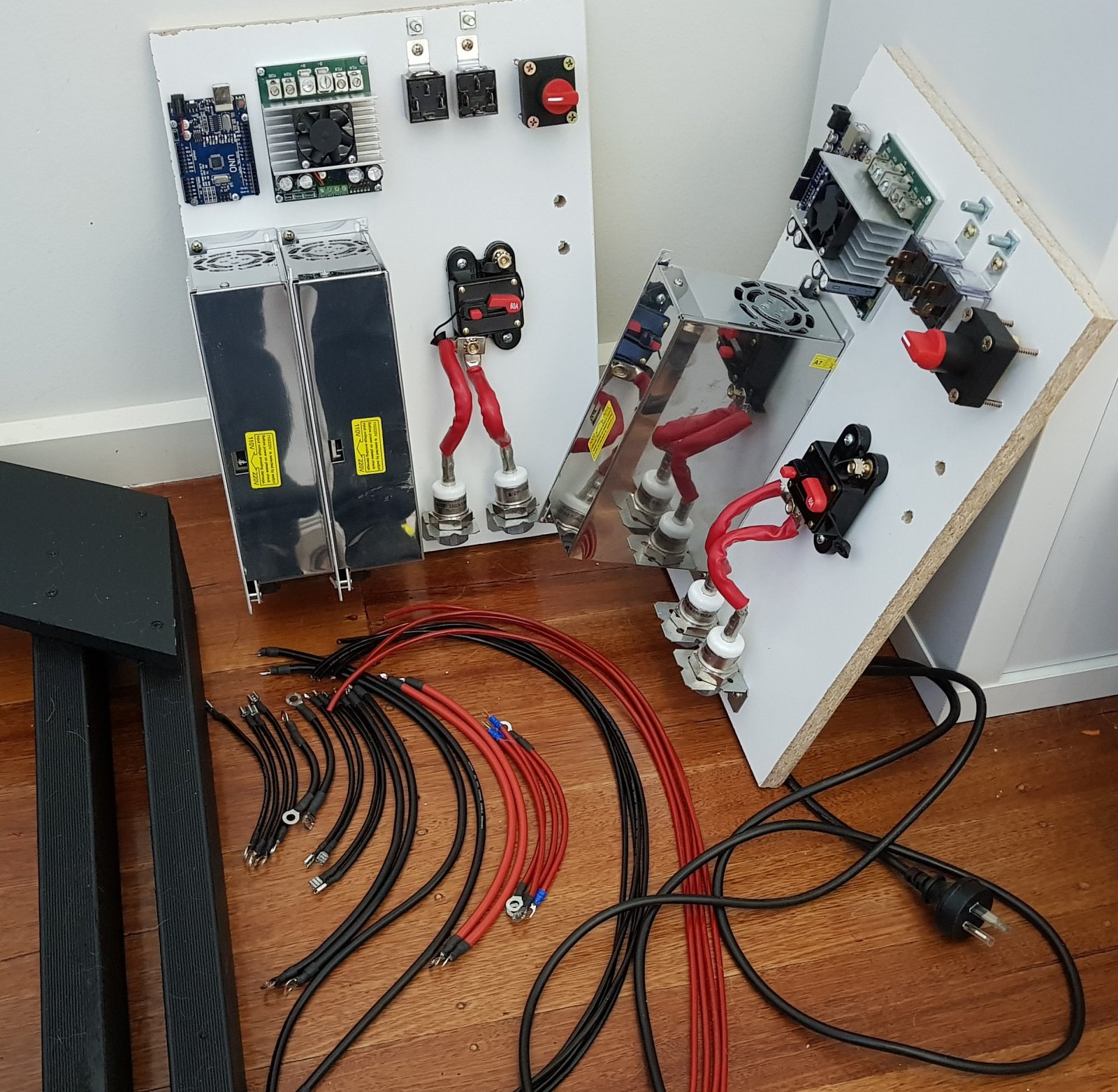

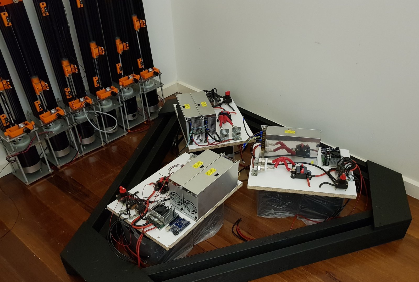

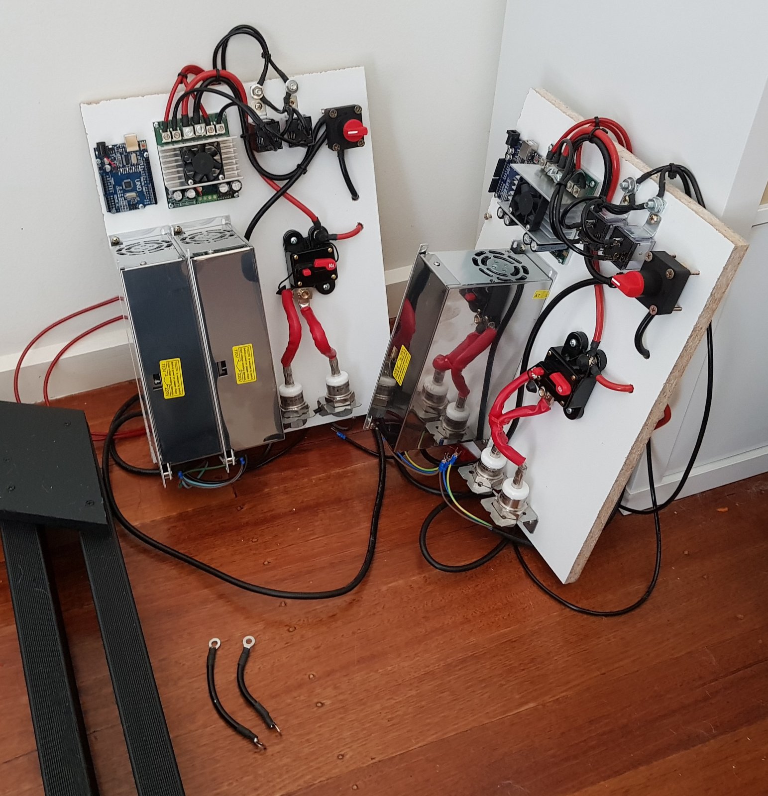

    Got a bit done this morning before household chores had to be done. The modules are now wired (I am still waiting for one replacement power supply but all the wires are crimped) so the next step will be mounting the actuators to their u-joints and bolting them to the frame. I hoping to get those welded tomorrow morning.

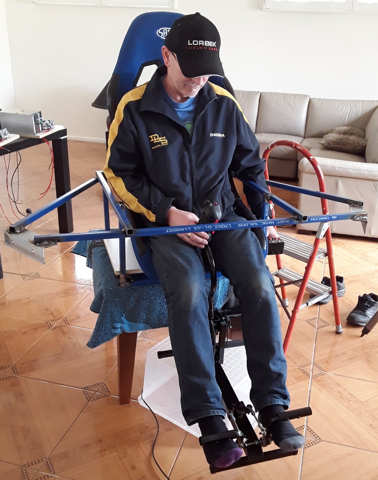

    I would have liked to do more load testing but the centre of gravity is so high - if anything goes wrong it could cause some major damage. I will leave further testing once they are bolted securely to the upper frame.

    @SixDegreesOfFlight thank you very much for post a lot of pics of your electrical modules, I learnt a lot from them as I'm a total newbie in that matter and that's the mayor concern part for me.

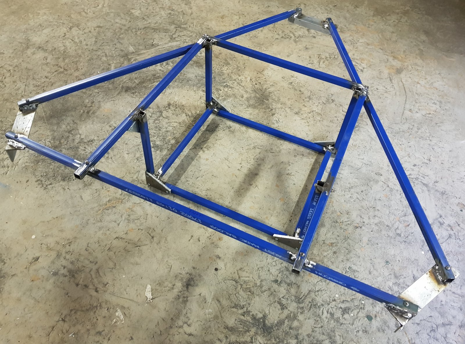

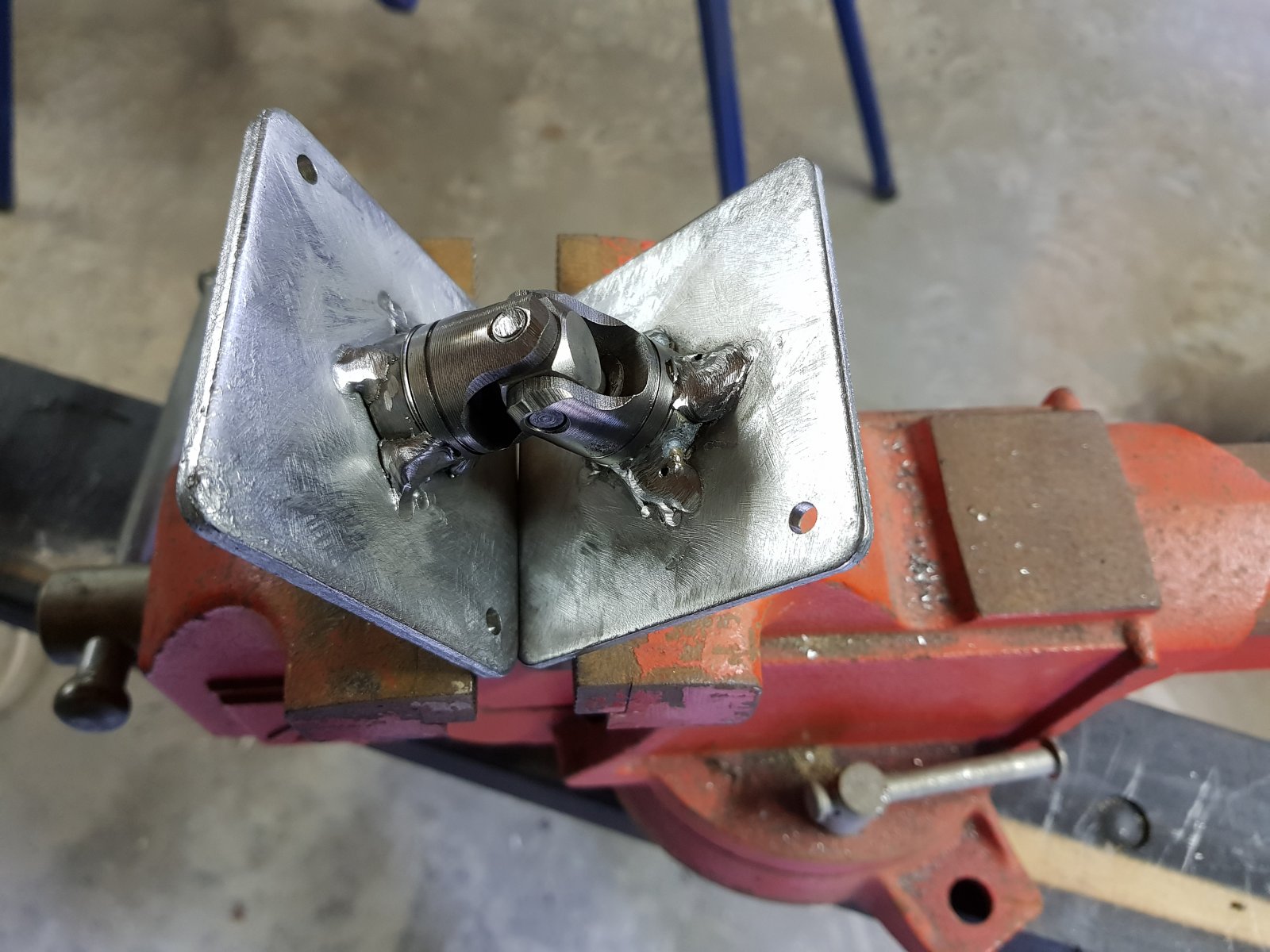

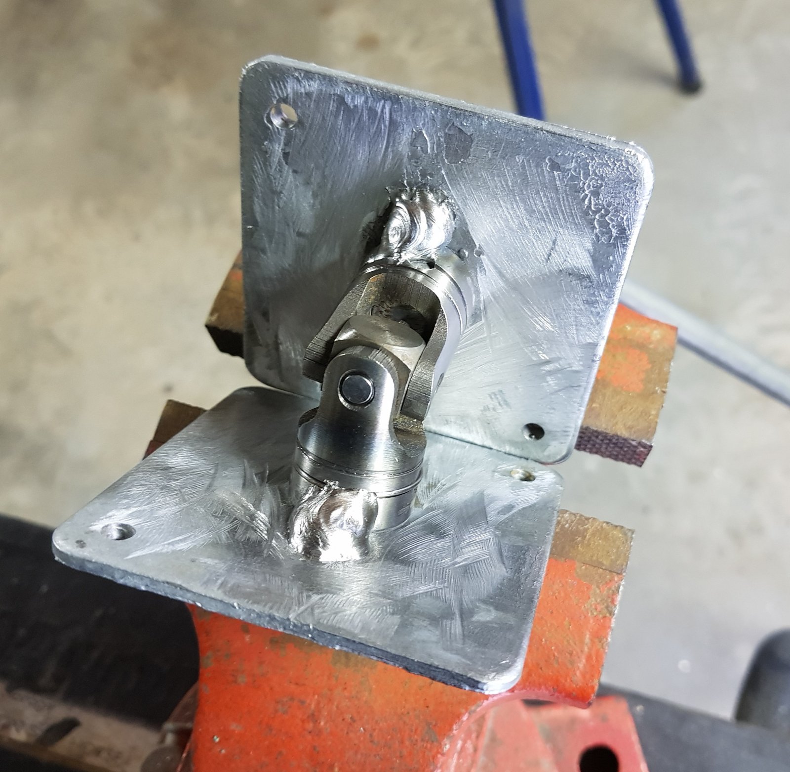

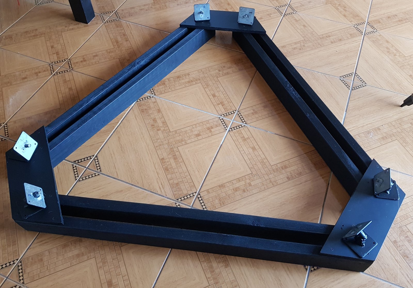

    I did end up welding the u-joints to the washers to stop them from twisting. I will post images of them once I have cleaned them up a bit with the grinder. While the MIG is fun to use that doesn't mean it's easy :oops: and I am too embarrassed to show my effort in its 'raw' state :blush
    I also tacked the triangular frame up to the angled corners where the rose joints attach. I hope to do some more welding tomorrow. I found that the undercoated steel acts as a nice insulator, causing me to burn a small hole through one of the bars before I realised what the issue was. Not too drastic but I need to be more careful.

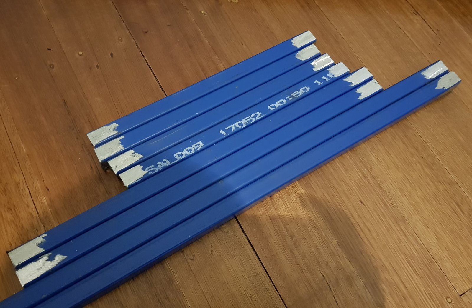

    To prepare for the seat 'box' I used the grinder to remove the paint as shown. The two longer bars should be around 550mm but I have left them longer so I can weld them to size then cut them. The measurements come from @wannabeaflyer2 blueprints :thumbs

    HI Ya @SixDegreesOfFlight Same here with the Mig welding LOL ( lets just say my welded joints are functional but ugly as sin) they say a bad workman blames his tools that being the case with my welding then lets just say im a Beaaaad workman LOL ... an angle grinder is my friend after mutilating so called welded joints ....Def need more practice on my part .. Those close ups wont be seen in any future pics I post just could not handle the abuse about weld quality :) again congratulations on another milestone and Great progress with you project exciting times ahead ..

    I got a 'bit' (not much) better with my welds as the top frame came together but with so many things to consider I ended up tacking the triangular sections on the wrong side of the line on the corner L sections ... so out came the grinder again :confused: Still it did prove one thing that the welds do have good penetration! I think I have nearly used one small grinding disc so far :p Unfortunately it took valuable time and not much else got done.
    The top section is now definitely welded so just the smaller pieces below which hold the seat. I am going to try for a final push today but I don't have much shielding gas left which might delay things quite a bit.

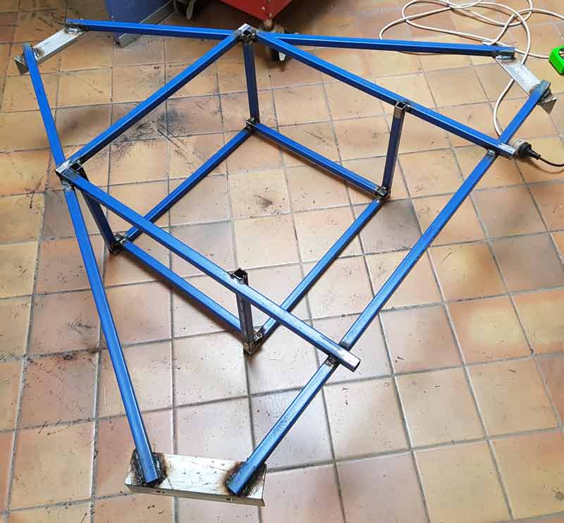

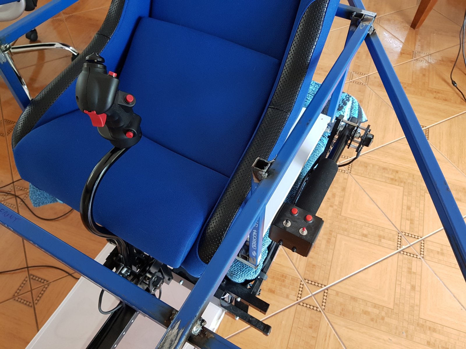

    The top frame is finished! Well it's welded - it still needs to be cleaned up with a grinder but happy with how it turned out. I welded all the places I could, at least the ones that I wouldn't burn a hole through. The welds themselves are strong. I know that because I had to grind a few off and make some adjustments. So for the moment I am going to simply clean it up and paint it. Once the seat has been fixed I will think about the extension for the pedals. Time will tell whether I need to add braces like @wannabeaflyer2
    I've added a few images with reduced resolution so you can't zoom in and see the welds :p

    Hi @SixDegreesOfFlight - Looking good , just be super critical of your joints and add gussets were necessary, as in a 6DOF (or any suspended rig) there will be allot of load on them when your rig is in motion (often over 2G). You don't want this to happen :p. I have a 'catcher' (doubles as a equipment cabinet), likely you won't - it's a big drop to the floor :eek:!

    I have seen that memorable demonstration before and it was certainly in my mind when I was welding. I don't think I am skilled enough to weld gussets without blowing holes in the steel tube. However, it wouldn't hurt to cut and screw triangular pieces to all or most of the corners. Thanks for the advice - I will pick up some plate tomorrow.

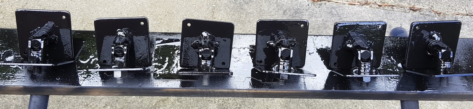

    Small update. I cleaned up the welded u-joints and painted them. These are my first attempts at welding with MIG (actually any welding) so don't be too critical :)
    I started with welding in four spots but thought that this was overkill seeing as it only has to stop it from twisting (1st image) so the remaining ones only had two welds (2nd image). I then gave them a coat of paint.
    I'll mount them on the frame this afternoon then turn my attention to the top frame. I have some time now so the progress should be quicker.

    Mounted the u-joints using a M12 nyloc nut to prevent it coming loose. Just realised that the diagonal holes that connect the top washer to the bottom plate of the actuator should have been a particular way around otherwise they won't line up. I might have to take off the bottom plate of the actuator so they line up.
    That's about all I can do today. Tomorrow will be dedicated to the top frame.

    I spent all day on the top frame and really I don't have a lot to show for it o_O I spent a few hours playing around with the helicopter controls and getting measurements together with a lot of pencil chewing and head scratching. The final position will mean the cyclic will have full motion in all directions except for full forward pitch - the cyclic handle hits the cross member just at the end of its travel. This isn't a deal breaker. If I need full forward pitch I am likely in a death throw anyway :p
    It also took time to accurately measure the mounting holes for the SAAS seat.
    The bulk of the time was drilling the holes for the M6 'insurance' bolts with nyloc nuts at every intersection where the frame was welded. I also found some triangular 8mm aluminium pieces in the scrap bin at work which I used for corner braces. These four were fixed with 10G 25mm self tappers. Finally, I gave it a once over with the grinder. It should be lot stronger now ;)
    Tomorrow, I will rub it down with turps and spray it.
