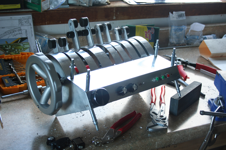

    Hi all,
    I'm new to the forum. Hopefully I can post some stuff on one of my projects. Most of the info is on the video, but some features:
    -Aircraft aluminum, rivets, and hardware used in construction.
    -11 axes, 4 rotary encoders, and 19 switches channeled to three arduino leonardos.
