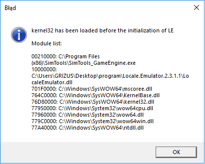

    AC motor, 6DOF
    win10 error ?

    After my test
    The local emulator runs normally in win8.1 and windows 10 2015
    Windows 10 2018 and later updates will have errors (win10 2016 to win10 2017 not tested)

    Looks like a emulator is loading, could it be that?
