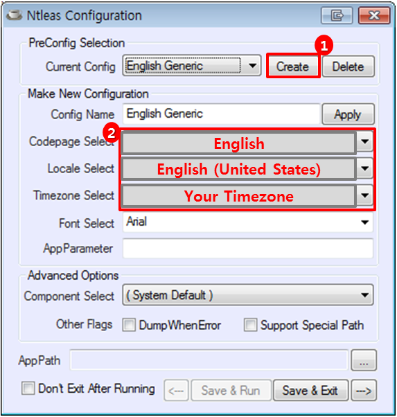

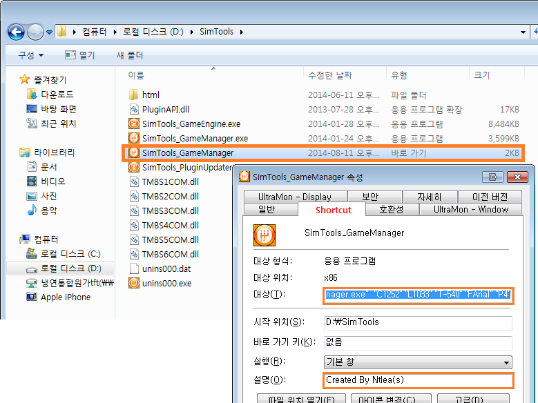

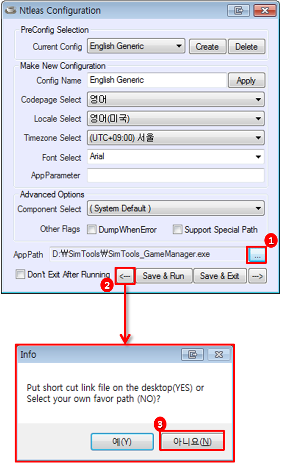

    I found a better solution using NTLEA (NT Locale Emulator Advance).
    1. Download NTLEA (url below) and extract it where you want.
    http://ntlea.codeplex.com/releases/view/125356
    2. run "ntleasWin.exe" then follow the steps below.
    3. Make Shortcuts.
    4. Voila!! you can see the shortcut under your selected folder right before this step.
    This method can use the OS default settings on your control panel for those who uses unicode languages to avoid language compatibility issues with other applications.

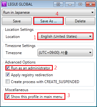

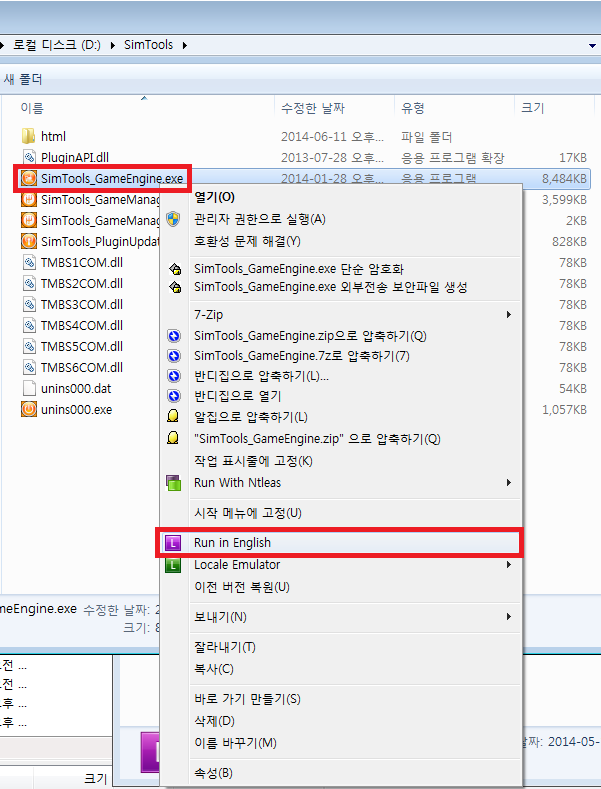

    I found more stable application than NTLEA for changing locale settings.
    The application is Locale Emulator.
    You can download it from the url below.
    https://github.com/xupefei/Locale-Emulator
    ※ Some antivirus software detects Locale Emulator(LE) as a virus but It's actually not a virus only misdiagnosis. please read the related issue for this problem below.
    The setting method is almost same as NTLEA's

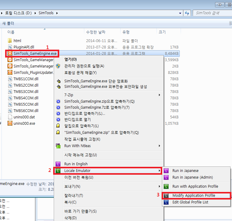

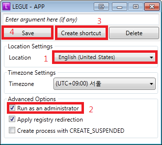

    * Make a new profile.
    - launch LEFUI.exe under the location LocaleEmulator is installed.
    * Method 1. Create shortcuts for launch.
    ※ Create shortcuts for both GameEngine.exe and GameManager.exe.
    - Step1.
    - Step2.
    * Method 2. Run SimTools directly without shortcuts.
    Here are my experiences that NTLEA CAN NOT execute both files, GameEngine.exe and GameManager.exe, at the same time and NTLEA is NOT working properly on my some other PCs.
    So, I recommend that you guys use Locale Emulator instead of NTLEA.

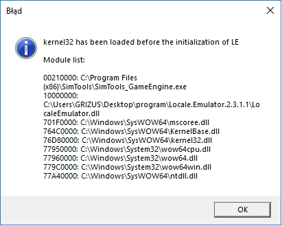

    I have a problem with "locale emulator" on windows 10 :( I get this error:
    does anyone know this problem? :( :( :(

  19. yobuddy
    51,749Coins
    +5,205 / 19 / -0
    Local region is fixed in SimTools v2.4 and above.
    So this should not be needed anymore.
