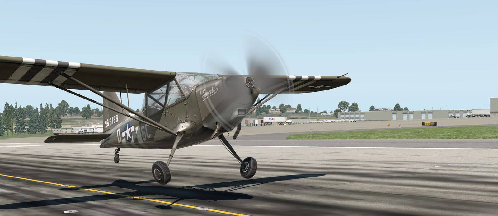

    1. Do you use a free spinning nose wheel? If so, the forward kinematics of it might interfere. Make sure you have "Nosewheel steering" assigned to an axis.
    2. Try exporting the data that Austin provided under "Motion platform stats". That's what you need. Yes XYZ are identical, but QPR are not identical to MLN.
    3. Try displaying the graph data at 99.9 fps (that's max). It will smooth things out.
    If it still persists, try the taildragger aircraft...
    If that is symptom free, it's not the friction modelling, it's the nose wheel.

    Good try but...
    1.)
    For rudder assignments, unfortunately I see no other options than “yaw” and eventually “Nosewheel Tiller” which is not a solution.
    2.)
    “Graph data is for the “Data Output Graph” resolution. It doesn’t affect motion I think but I might be wrong.
    3.)
    Just tried the “Stinson L5 Sentinel” - the same spikes on the graph.

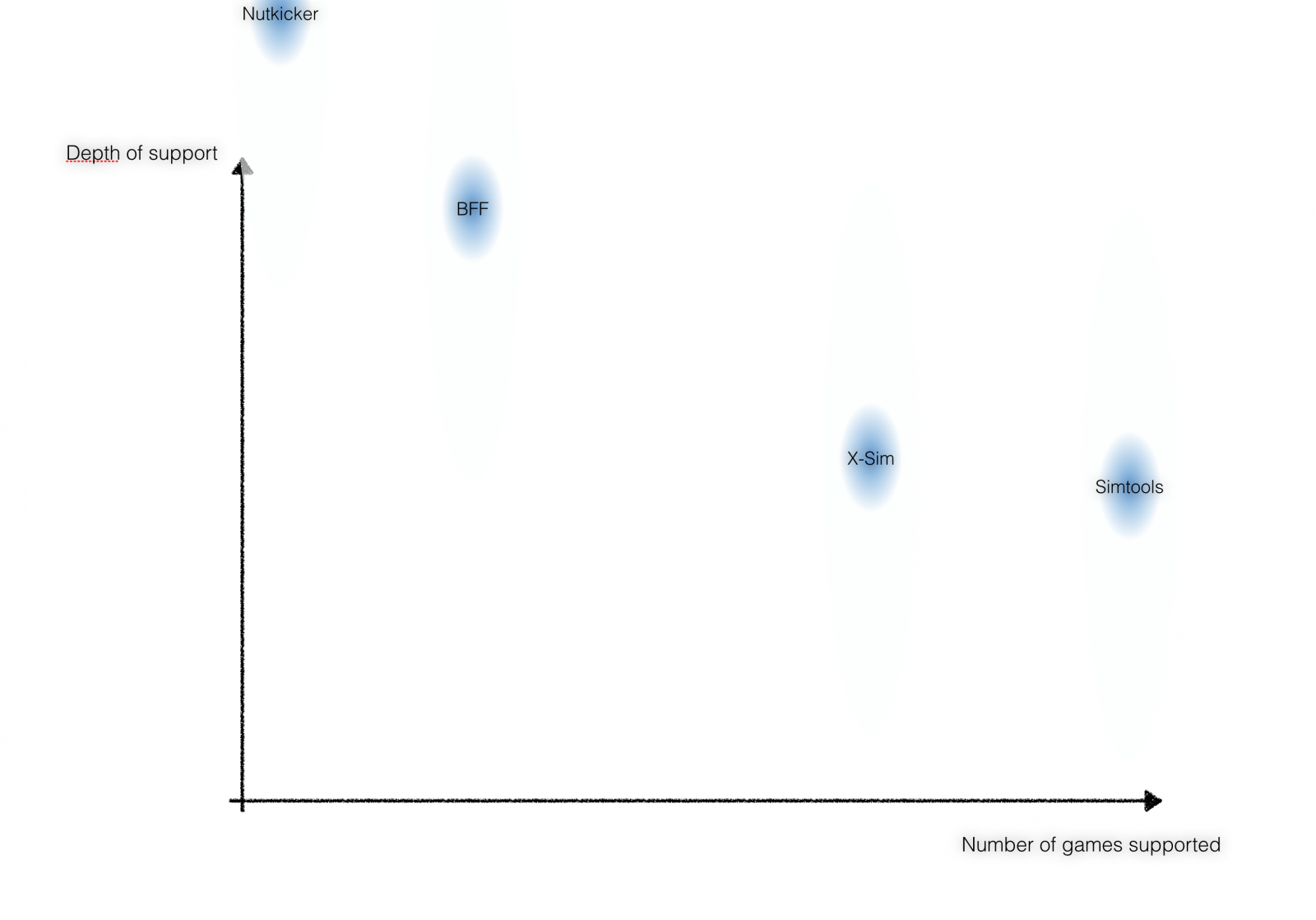

    Maybe we should move this over to the X-Plane section, because I 'd love to continue this. Open a new thread there. I think I can contribute. My Cessna behaves pretty plausible now as far as I can tell.
    Not sure if I understood correctly :) still trying to answer.
    Some good points in there! I'd love to see that happening if I weren't a total noob when it comes to programming. I actually bought a C# book in Dezember, read only 100 pages and that's about all I know of programming. I'm struggling to get even a clickable button to work reliably. I'd love to see this develop into an open source, community driven, free motion simulation software, but I simply lack the skills to do that.
    Basically my dilemma is this: I know exactly WHAT I wanna do. I also know exactly HOW I wanna do it, but I have pretty much no tools available to implement it in code. Every step I take is something I learned from scratch just a few days earlier.
    As I guess you have noticed, I have no problem arguing my points passionately (but rationally!) when it comes to vehicle motion dynamics, but I strongly doubt that anyone will ever hear me making a claim about programming. Absolutely not my area of expertise.

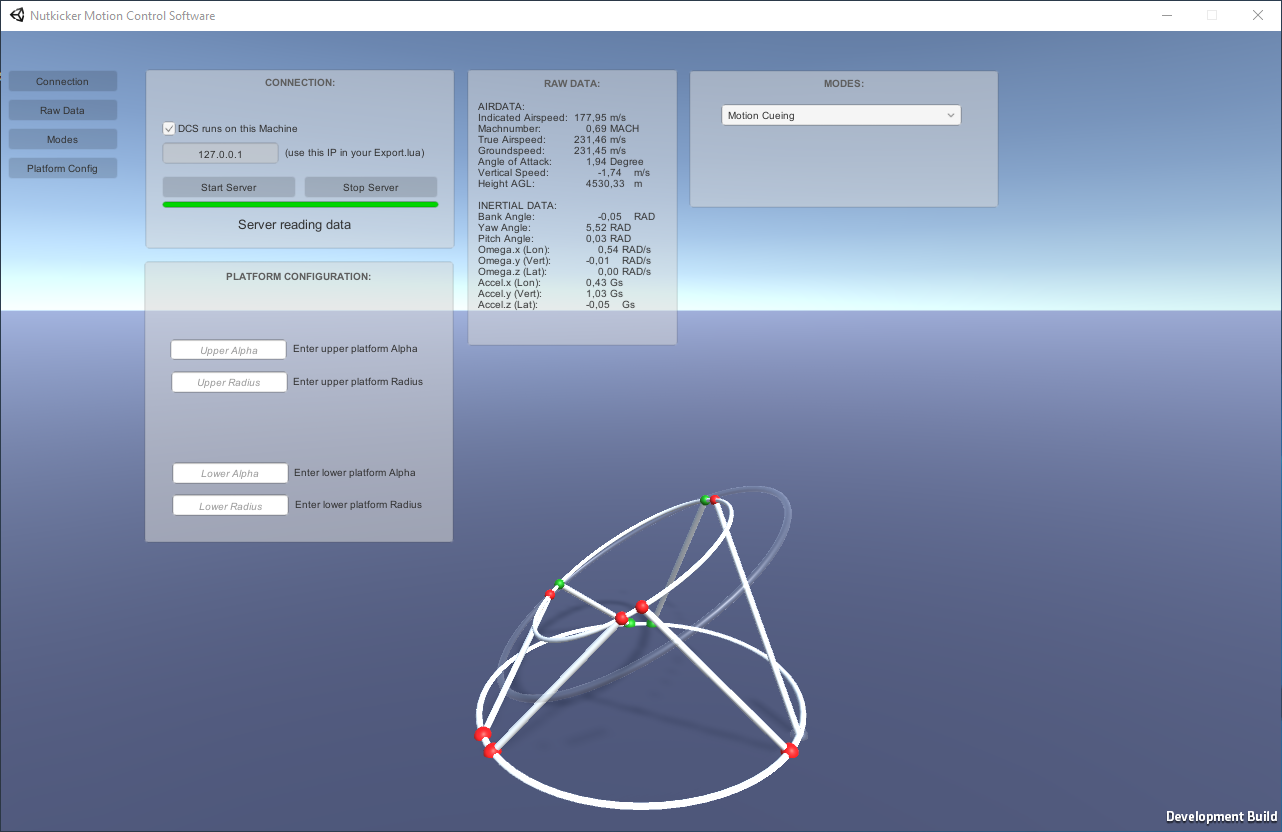

    And because a picture says more than a thousand words:
    ...this is the area my software (Nutkicker) is targeting in the near future. Very few sims (DCS, X-Plane, P3D and all others that allow export of data via Network) but a very deep integration between Sim and motion platform. I prefer depth over width anytime.
    Oh no. Quite to the contrary! Like @hexpod, I applaud with hands and feet if Simtools develops. Better Simtools --> more People --> more revenue for Simtools --> better Simtools.
    I'm in this only to satiate my appetite for knowledge. This is porn for my intellect! :grin

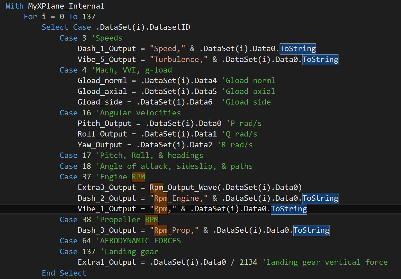

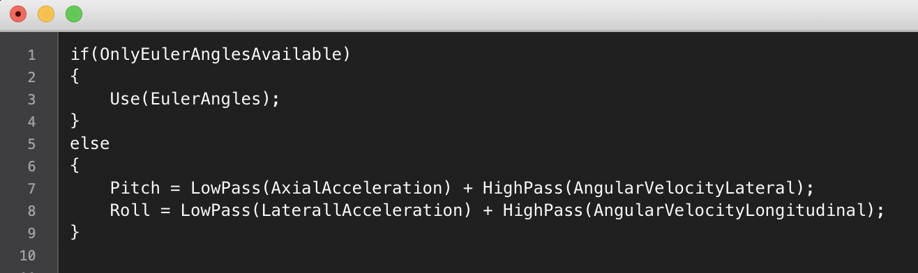

    After @Dirty has shared his 20yo flying experience and knowledge, I got totally convinced that using the "Euler angles" for our platforms is not only useless but also unrealistic.
    I mean if you don’t have the choice because of telemetry lack and it is your only option for pitch roll an yaw to use Euler, than it’s fine.
    It is absolutely great that @pmvcda has the "transform swap" kinematic option (When enabled I call it "local kinematics") which makes the translations dependent on rotations. (No need of @Dirty ‘s ghost platform approach I think)
    @value1 could got mislead by myself (apologies) concerning the x-plane telemetry.
    After checking it again and again, I am pretty sure the forces are local and not world!
    Concerning the telemetry mapping I prepared another experimental plugin where I use the rotational velocities on the Pitch Roll and Yaw instead of positions (Euler angles). @yobuddy no any need of any "roll over" in this case!
    Additionally, on the Extra1 I am doing the tests with "landing gear forces" trying to mix them inside Simtools matrix with the "g-load norml"
    I believe this is the right way to go if you want a good separation between "ground model" and "flight model" (more on this maybe later if somebody is interested)
    From what I can see in my tests, the result is simply mind-blowing. Simply this is it!

    @value1 , if you have an idea how to properly scale to the center the gear forces please share because « /2134 » is not a solution
    Thank you

    hug:Glad to hear that!

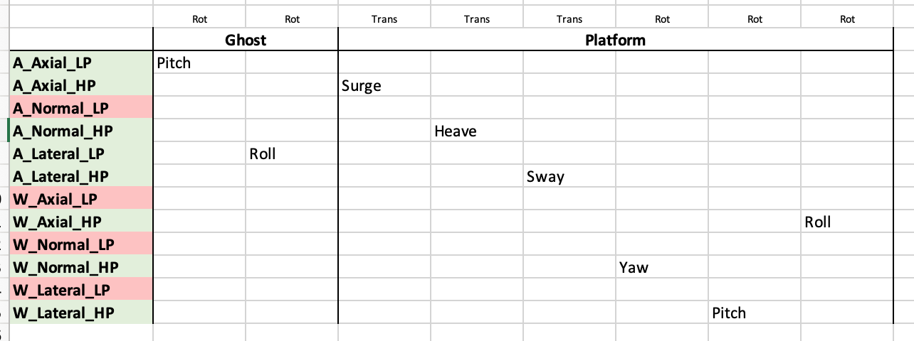

    The forces and moments from the landing gear should already be considered in the sum of all forces/moments that x-plane exports. The problem I guess is only you don't get to see them because you filter them out. (For good reasons)
    BUT.....:grin:grin:grin
    ...you could use the amount of "weight on wheels" to blend over between two completely different sets of gains. Without WOW you have one set of gains, with WOW you could have another set of gains. And then you could interpolate between the two as more and more weight goes from the wings to the wheels on landing.
    That's an example of "conditional processing" that I mentioned in my first post. It could also be seen as the first step in the direction of "adaptive cueing".
    Dirty :)

  18. hexpod
    hexpod http://heXpod.xyz
    Apr 18, 2016
    1,222
    berlin
    7,864Coins
    +378 / 5 / -0
    DC motor, 6DOF
    This is just a desperate way to overcome the lack of HPF.
    I thought that doing a simple arithmetic could give me a half solution waiting for a properly working HPF.
    Like subtracting 1 from G-load to bring the platform to the center of the heave, we could maybe subtract the landing gear force in the similar way.
    The small issue is that it is dependent of the aircraft type weight and its CoG.
    Subtracting 2134(lb) from the landing gear variable, brings more or less my heave close to the middle position but it works only for Cessna.
    I was thinking we could find a solution (other than HPF) which could work for all types of planes

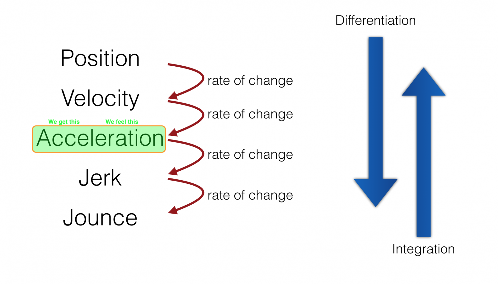

    Ahh, got it :)

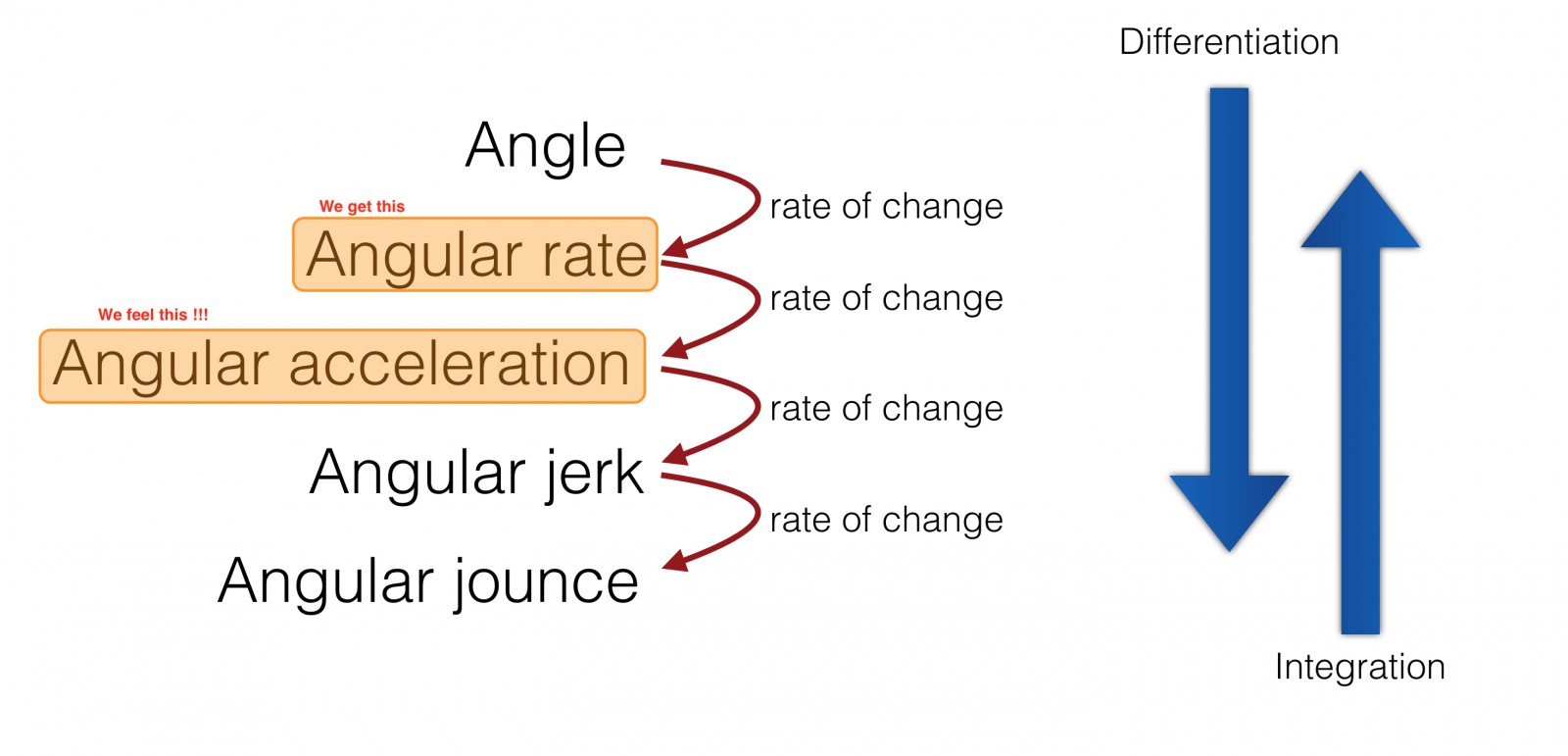

    Well there are two ways:
    1. High pass filter
    2. Differentiator
    I'd prefer a HPF, but what comes out is very similar anyways.

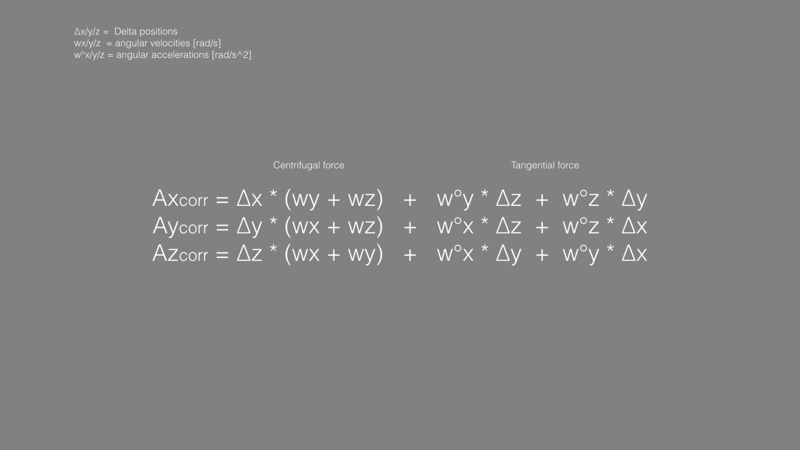

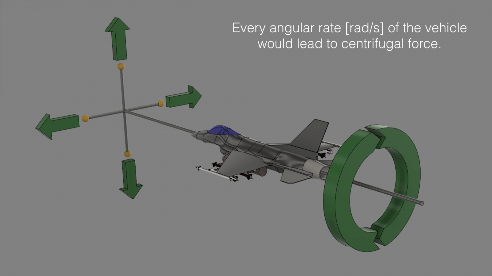

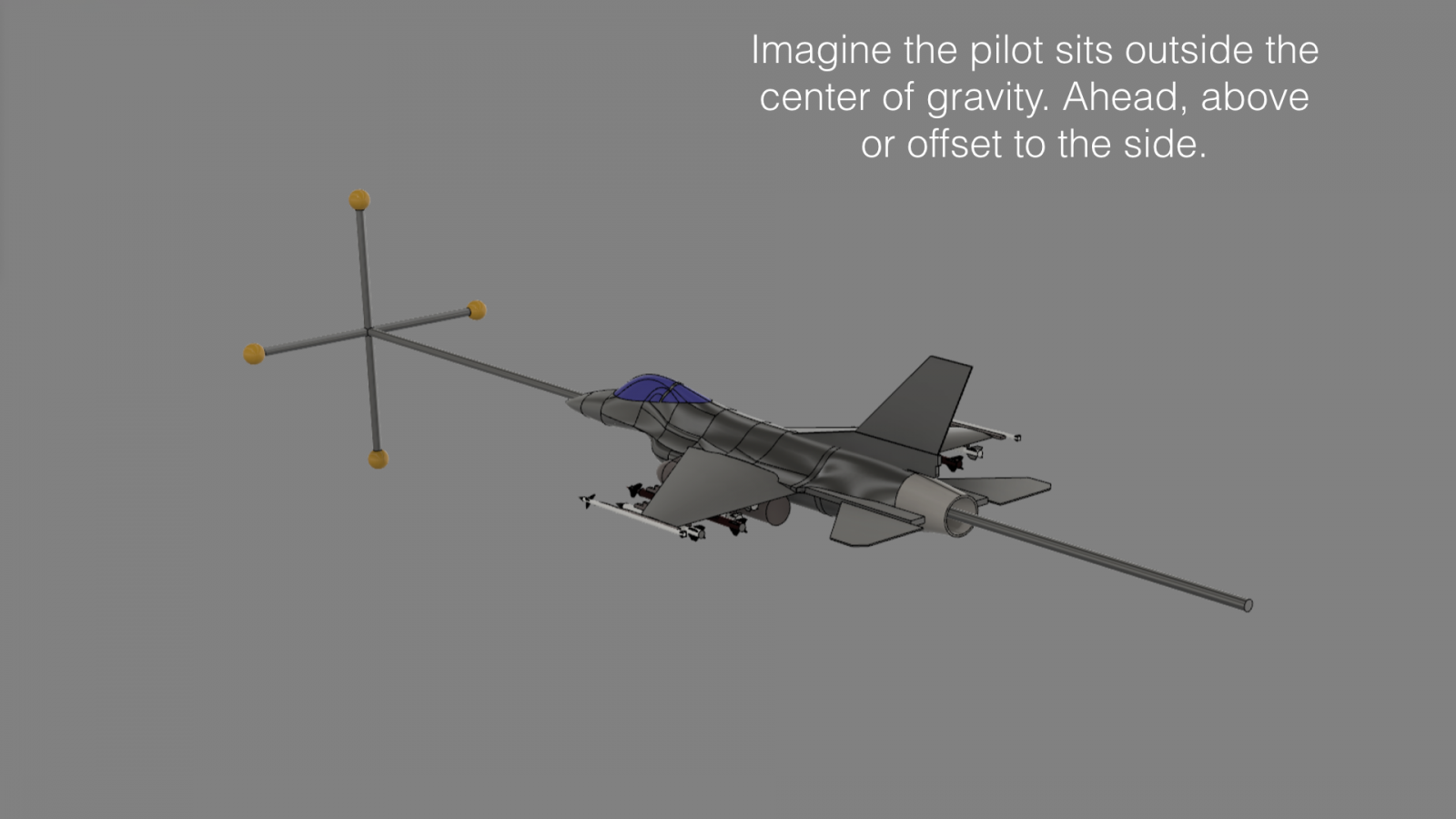

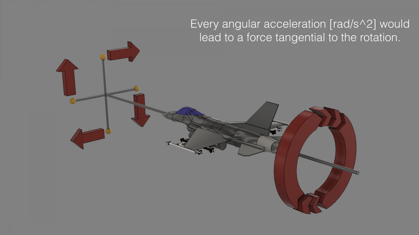

    I said I wanted to correct the datastream for offsets in the pilots/drivers positions. Turns out this was easier than I thought: About 1 hour and then another for the 3D illustrations :)
    If someone wants to correct for those offsets, you will just have to add 3 accelerations (Ax, Ay, Az) to the exported accelerations. These are dependent on the angular rates (w) and the angular accelerations (w°) of the vehicle.
    May be interesting to know for @pmvcda:
    Correcting in this way will not eat away your translational operating space :)

    ...isn't this beautiful:
    oh,... and I haven't tested those yet!!! Use with caution.
    oh,... and they're created in a right hand coordinate system,... but I think it shouldn't make a difference.
    Dirty :D
