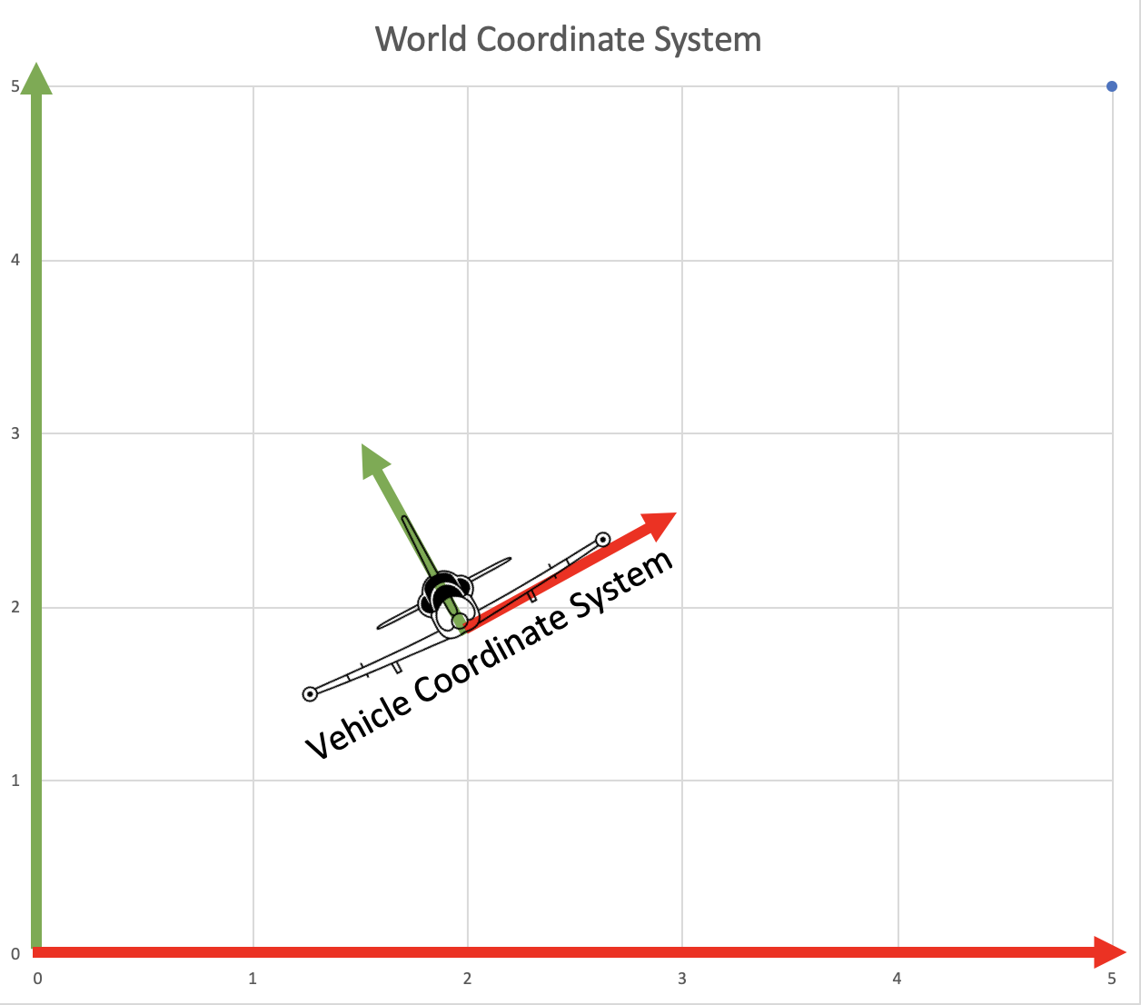

    Reference Systems (CoordinateSystems)
    Imagine this scene:
    Woman enters the hallway. Groceries on her arm. She shouts through the house „Honey, I'm home. I bought you Hall sensors and linear bearings“.
    Voice from the off: „Great!“
    She: „Where are you?“
    He: „Here!“
    She: „Where is here?“
    He: „In the West Wing, second floor, third door on the right, in the simulator workshop that you and your Mum built me for my birthday, remember? Right between the electronics component storage and your table dance exercise room“.
    …ya know,… the typical everyday couple conversation.
    What you should take away from this scene is the idea, that „here“ is not a position. Neither is „on the chair“ or „in front of the desk“, unless you and the person you're talking to are using the same reference system (in this case: knowing which room we are talking about) It is only when he references his position relative to the house, that she knows where he is. The house is the only common reference system they are both sure to be in.
    Whenever you want to describe a position (or motion) technically, you will have to make sure that there is absolutely no doubt about which reference system is being used. After all, the position information is nothing but „go this number of units in the X-direction, and this number of units in the Y-direction“. For that to make any sense at all, we first have to agree on where the origin is, and which direction the X and Y direction is.
    Another concept that I hope you can embrace is the fact that reference systems themselves can be defined within parenting reference systems. Like, on a cruise ship, you can define your position by saying I'm at the bow/stern, port or starboard. And that makes perfect sense to someone on the cruise ship with you.
    However, if you need the actual precise geographical location (because your buddy wants to beam down from Starship Enterprise), then you will need to know where exactly on the globe that cruise ship is and how it's oriented. You will have to define the reference system of the cruise ship within the reference system of the earth.
    So, take away these two key concepts:
    1. Position information only makes sense within a reference system
    2. Child reference systems can be defined within a parenting reference systems
    For our particular case, those would be the „World Coordinate System“ (WCS) and the „Platform Coordinate System“ PCS. To keep those well separated I will call the WCS coordinates x-y-z and the PCS coordinates u-v-w. Similarly I will call the rotation rates around these axes Wx-Wy-Wz and Wu-Wv-Ww. „W“ being the greek letter „Omega“ which is normally used for angular rates.

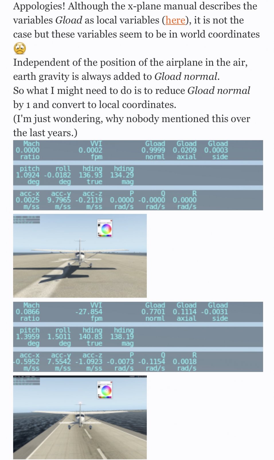

    Quote: 39533A8F-3CB7-4457-99F0-B9E8A47DF31E.jpeg 691A8585-675E-4563-9FF7-98D8E4D38FEC.jpeg I mean, your interrogation is absolutely right. I remember, recently we had a hard time to sort out the telemetry of x-plane because what you find in the documentation doesn’t seems to correspond what you find in the game.
    https://www.x-plane.com/kb/data-set-output-table/
    Austin talking about the forces: go to 24min 10s.
    https://m.facebook.com/story.php?story_fbid=1493547950669175&id=442899392400708&_rdr
    After all @value1 just subtracted the earth accel on the heave (-1) which seems to work well.
  15. Dirty
    Oct 15, 2017
    746
    All the way up front.
    7,981Coins
    +890 / 3 / -0
    Hey :)
    Did you find anything wrong with X-Planes representation of G-Load? Or found it unsuitable for use in motion Sims? Or did I misunderstand?
    I will confirm when I get back home, but last time I looked at it, I saw nothing wrong with it.
    Here's how I think it works in a nutshell:
    1. Add up all the forces on the aircraft (without gravity) into one resulting vector.
    2. Split this vector up into its Lon/Vert/Lat components (vehicle reference system).
    3. Divide by total mass, to turn force [kg*m/s^2] into acceleration [m/s^2]
    4. Divide by 9.81 m/s^2/G. To turn acceleration into G-Load [G]
    That's what the values of G-Load axial/normal/side represent. It is what an occupant would feel.
    If you want to determine the rate of change of the vehicle trajectory, you will have to
    1. Add up the vectors of all forces on the aircraft (Now including gravity!).
    2. Divide by mass. The result is in [m/s^2].
    Did it really make a difference when you subtracted 1? I was planning on using G-load (Accel_Vert) on heave only after a highpass filter. So the steady 1 would not be present in the filtered signal anyways.
    Can you describe what was "wrong" before you subtracted 1?
    Dirty :)

    Simtools needs we define max. and min. to scale the variable on a deg-of-freedom. Value 0 is needed to center the axis while the object is not moving.
    When the aircraft is not moving xplane g-normal outputs value 1, which is logical.
    That was lifting the heave regarding to scaling factor, eating almost all the workspace of the platform.
    I don’t know if it’s the best way to proceed but as I said subtracting 1 did the job.
