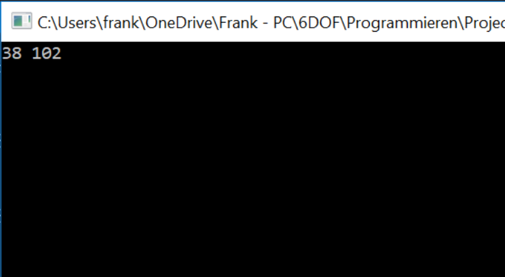

    Hey @Thanos or @pmvcda ,
    Would you mind helping me out here a little? It's still unclear to me how exactly to convert into bytes to send data to the AMC1280. You gave examples for 0%, 15%, 50% and 85%, but I am unable to come up with the same values. *scratching head*
    here's the code for a simple C# console application:
    Code:
    static void Main()
                float utilisation = 0.150f;                                 //Actuator position between min(0) and max(1)
                UInt16 value = (UInt16)(UInt16.MaxValue * utilisation);     //Map utilisation to a value between 0 and 65535
                Byte[] Bytes = BitConverter.GetBytes(value);
                Array.Reverse(Bytes);                                       //To get MSB first
                writeBytes(Bytes);                                          //Write bytes to thte console
                Console.ReadKey();                                          //Just to keep the console window open
    ...but this is what I see in the console when I try to convert 15% into bytes:
    How do you convert 15% into 064 000?
    Here's what I do, step by step:
    100% = 65535
    15% = 9830
    Binary: 00100110 01100110
    Bytes: 038 102.
    Can you tell me, where I am going wrong?
  3. Thanos
    Jul 6, 2017
    1,379
    Electronics Engineer
    United States
    2,917Coins
    +1,079 / 10 / -0
    The data string has the following format:
    ID AXIS1 AXIS2 AXIS3 AXIS4 AXIS5 AXIS6 AXIS7 AXIS8 LF/CR
    - The ID is byte values 0xFF + 0xFF
    - Each Axis is 16bit wide.
    - LF+CR is required in the end (0x0A + 0x0D)
    Here is an example in C ... kind of...

  4. Dirty
    Oct 15, 2017
    746
    All the way up front.
    7,977Coins
    +890 / 3 / -0
    This is what I get:
    0%: 000 000
    25% 063 255
    50%: 127 255
    75%: 191 255
    100% 255 255
    Are you sure, that the values you posted are correct?
  5. Dirty
    Oct 15, 2017
    746
    7,977Coins
    +890 / 3 / -0
    OK, thank you very much for the code! Straight forward :) I think I can understand and use it.
    Could you still confirm 15% and 85%?
    Thanks for the help!
  6. Thanos
    Jul 6, 2017
    1,379
    United States
    2,917Coins
    +1,079 / 10 / -0
    Yes, this is correct conversions... You could eve use the windows calculator in programmer mode for conversions between hex dec or binary...
    The reason there is 1 digit offset is because usually I deal with values like 127 or 255 instead of 128 or 256 for bytes...
