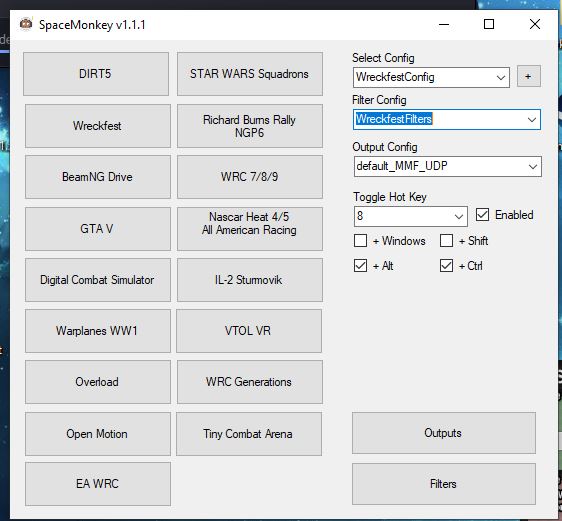

    You maybe haven't done everything correctly? Have you followed the instructions in the PDF? have you selected defaultPacketFormat instead of codemasters extradata3, are you sure you have specified the correct port (believe it's 10001, but you will need to verify it).

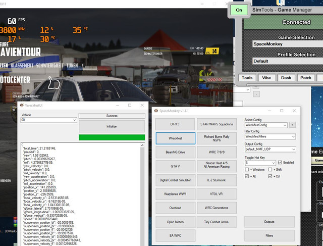

    i checked your manual again .. and its not working simtools wont switch to "game running"
    i do all the things in the manual. but its Spacemonkey 1.1.1 today AND its wreckfest 64bit what spacemonkey needs. but ST dont want to go "online" see screenshots[​IMG][​IMG]
    [​IMG] [​IMG]
    [​IMG] [​IMG]

    Can somebody please post some Screenshots of working spacemonkey plugin?

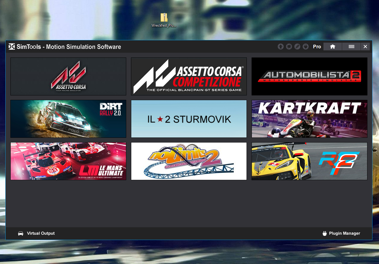

  7. LSDD
    LSDD 5DOF - 5x SCN5 - FREX connector
    Mar 9, 2024
    13
    Chiptunning
    Paris
    103Coins
    SCN6, 4DOF
    Hi!
    I have Simtool V3 and would like to test it. I used to play Wreckfest with SRS when my rig was 3DOF with spacemonkey plugin.
    22,206
    154,699Coins
    +11,210 / 57 / -2
    SimTools V3 is in opeen Beta testing, it is not yet released and these are the plugins currently available, other are being ported as time permits: https://simtools.us/plugin_library/
    SimTools V2 plugins, of which Wreckfest is one, are not compatible with V3.
    You can run V2 and V3 on the same machine with the same license, as long as you don't try and run them at the same time.

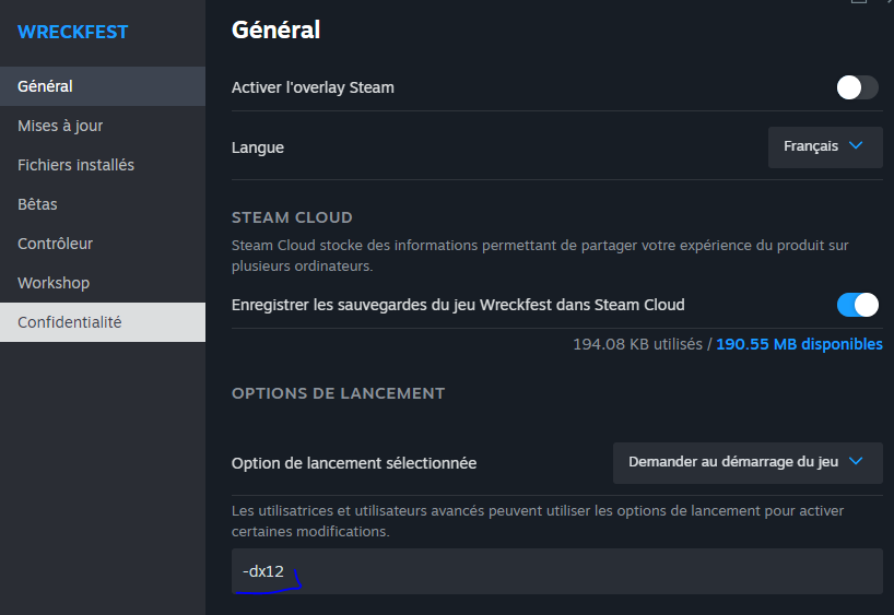

    Hello, I also tried with simtools 2, it starts working but no movement. I launched it in 32 bit dx11, nothing

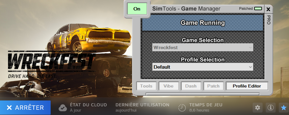

    Looks like bugbear has released a new version of Wreckfest, I tried to update the pointers to the new offsets and it appears to be working again with SimTools3.
    I'm not playing wreckfest nowdays, since it doesn't have VR support. hoping Wreckfest2 will have VR.
    https://drive.google.com/drive/folders/16BD6fnRgeu0ymLoeeFvTco1IjpkFDz8Q?usp=sharing
    Drag the plugin to SimTools3 to install it. Lower profile intensity in SimTools to about 15 (by clicking the waves, then adjusting the slider down right).
    Unzip WreckfestReader to a folder, double click the file WreckfestReader.Exe, then it should be just starting the game. (use version 1.0.1)
    You should use Wreckfest 64-bit.
    • Detects game running.
    • Automatically detects and attaches to send telemetry when you start a new race.
    • Works with multiplayer (by figuring out your name the telemetry provider can figure out what index you have and load telemetry for the correct player).
    • Also sends "basic telemetry" to SimHub when using buttkickers (udp port 20777, in format CodeMasters Extra Data 3, use Dirt2 for example)
    There could be a delay before motion starts, since the reader detects race running and then scans memory for telemetry.
    @Marin You can try this
  17. Marin
    Marin New Member
    Sep 27, 2021
    10
    - 50Coins
    A big THANK YOU THANK YOU it works. See you soon for Wrecfest 2 in VR I hope also have a good day
