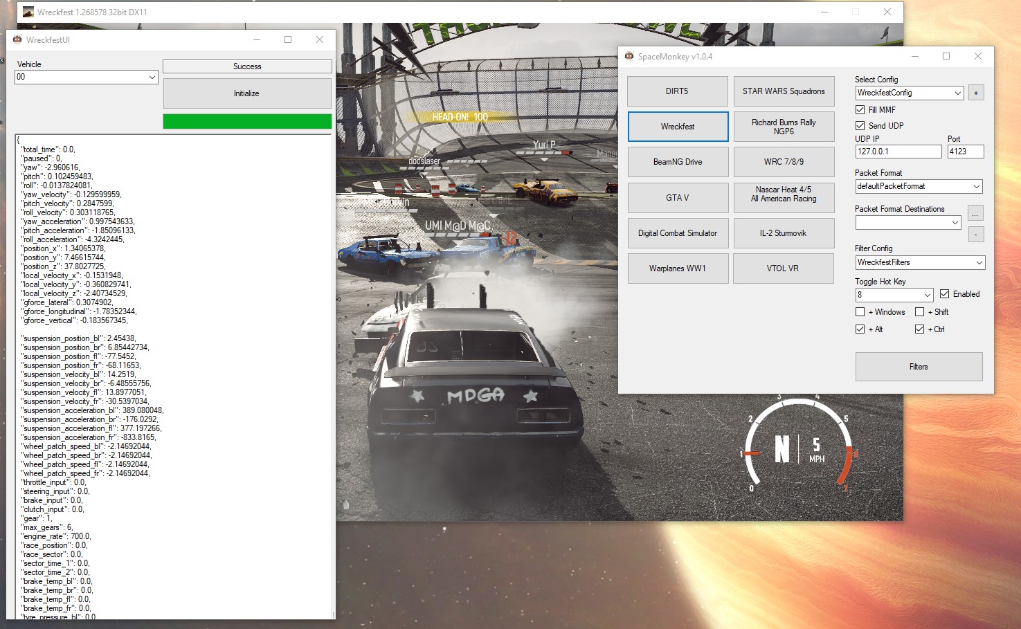

    I managed to get some form of telemetry from Wreckfest (any 32bit version) using a program called Spacemonkey mentioned by @Moe Colontonio . My hack wasn't pulling telemetry in quite the correct fashion, but it seems to be a good start. For anyone wanting to look at this and actually do it properly, what I did was:
    Download spacemonkey from Github
    Copy the spacemonkey exe and rename the copy DirtRally2.exe
    Run this as administrator
    Change the UDP output to port 4123 in Spacemonkey
    Start a Wreckfest race and get to the final screen before actually clicking/pressing a button to start the race
    Clicking on wreckfest in Spacemonkey and clicking initialise
    Wait for the game to be scanned and all the telemetry data to show up
    Voila - You rig will now go beserk
    It doesn't work as intended (and be warned my rig started walking itself across the room!) but it seems fairly convincing that with the correct settings and perhaps a dedicated Spacemonkey plugin, we might be able to get telemetry data from Wreckfest once more.

    I have very quickly done a Beta plugin for SpaceMonkey as mentioned above.
    Only tested on my rig and on Wreckfest so be careful testing it and on other games.
    Updated the pdf and added a filtering file. The SpaceMonkey Wreckfest filters was like driving on clouds.
    The file added removes the filters and now add maybe some smoothing in Simtools instead.

    I'm working on a SimTools3-plugin and a custom Wreckfest telemetry application with code from SpaceMonkey. My plans are to get it to detect Wreckfest running automatically, and automatically scan memory when a new map loads. It will only work automatically in single player mode.
    It's working, but I have a lot of code cleanup to do and need to fix the process detection (now you need to start Wreckfest first and then WreckfestReader. Map loading/exiting detection is done.

    You can get it to work in SimTools2 if you use Hocky's plugin and space monkey with the defaultPacket format. But it's rather cumbersome.
    I'm working on a SimTools3 plugin that auto detects the player id, with that you can also play multiplayer. Currently it's a separate telemetry application (like SpaceMonkey) based on code from spacemonkey and a SimTools3 plugin that uses the telemetry.
