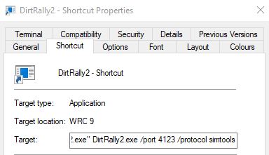

    my platform raises but no movement.what am i doing wrong?
  6. Daguru
    Sep 4, 2013
    725
    Kitchen installer
    Wales uk
    233Coins
    +634 / 1 / -0
    Motion platform

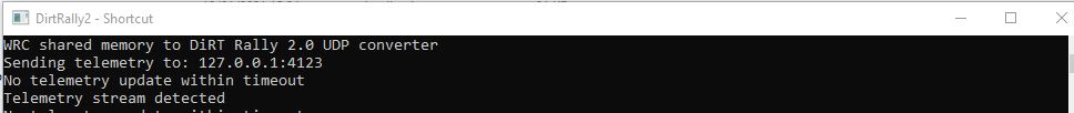

    Make a shortcut on your desktop of the dirtrally2.exe that come with the telemetry fix
    then right click >properties
    In the target box add this to the end DirtRally2.exe /port 4123 /protocol simtools
    Example
    My orginal target box "J:\WRC 9\DirtRally2.exe"
    New target box "J:\WRC 9\DirtRally2.exe" DirtRally2.exe /port 4123 /protocol simtools
    then click Apply
    Use shortcut and it should load with simtools port 4123 and then run game as normal
    Dont forget there needs to be a space between the " and Dirtrally2.exe as in the pic above.

    Yeah it seems at the moment that pitch and roll dont work only heave, sway, surge and extra1 (traction loss i guess) still more than we had before.
    yeah if you own Dirt Rally 2.0 and have a working profile then you need to change the settings to suit WRC 9 and then swap them back to use DR 2.0 again so pain in the butt hole, but as i said before still better than we had before.
    The guy that shared this fix has also shared the source code so you never know someone might take it up another level. (not me im Thick :grin)
