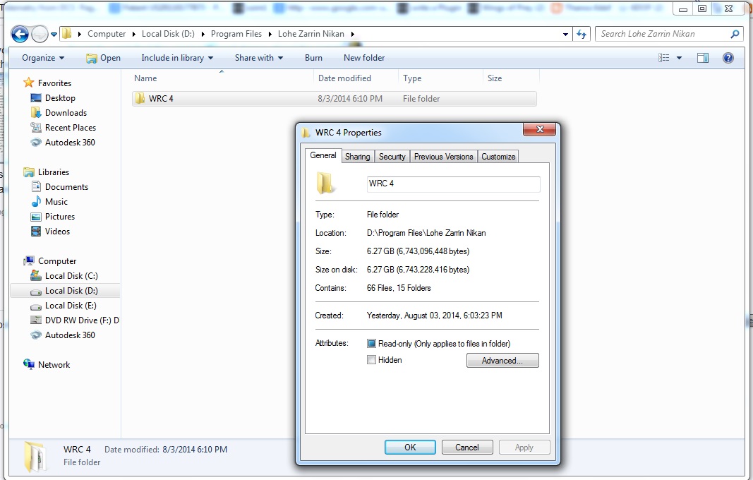

    thank you @yobuddy for reply ,cant find the version:confused:and donno about the patch:sos
    this is the game installed root
    regards
    Hooshang

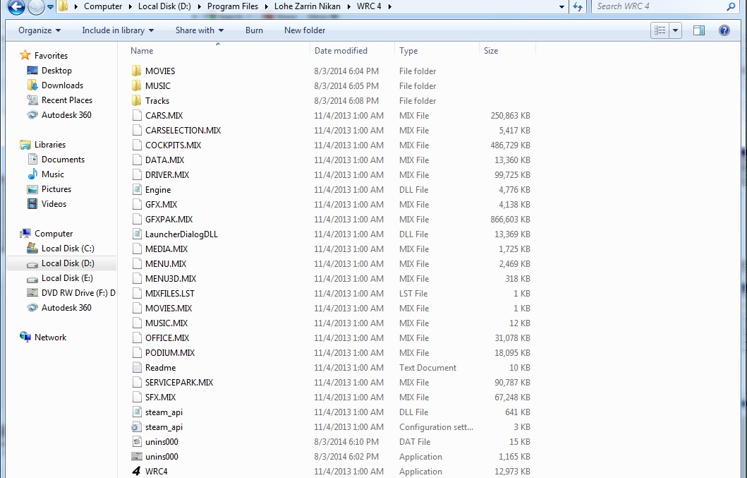

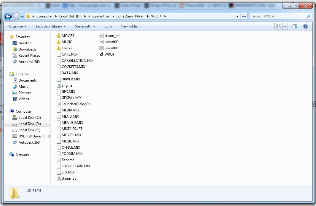

    Hi, Hooshang. It will be better if you give us screenshot of installed root with file attributes (size, create time ets.)

    Yes. I have files (*.exe, *.dll) with the size absolutely equal to your files. I hope it mean we have the same versions.
    Maybe your system's firewall or antivirus blocks access to games memory for data hooking? Try to start the SimTools with administrator rights...
