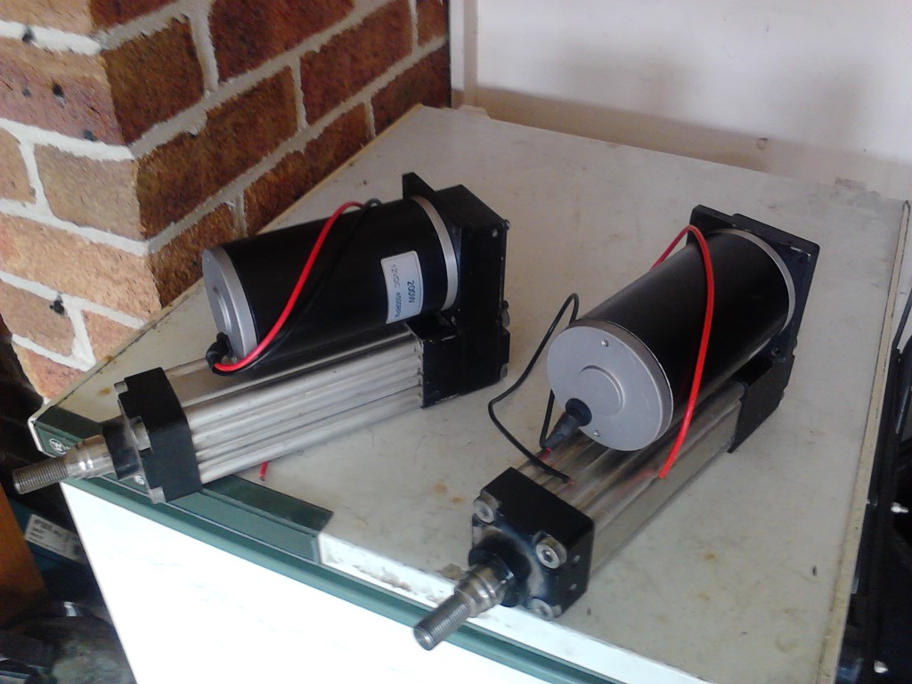

  7. bsft
    Never too big an actuator for a seat mover.....

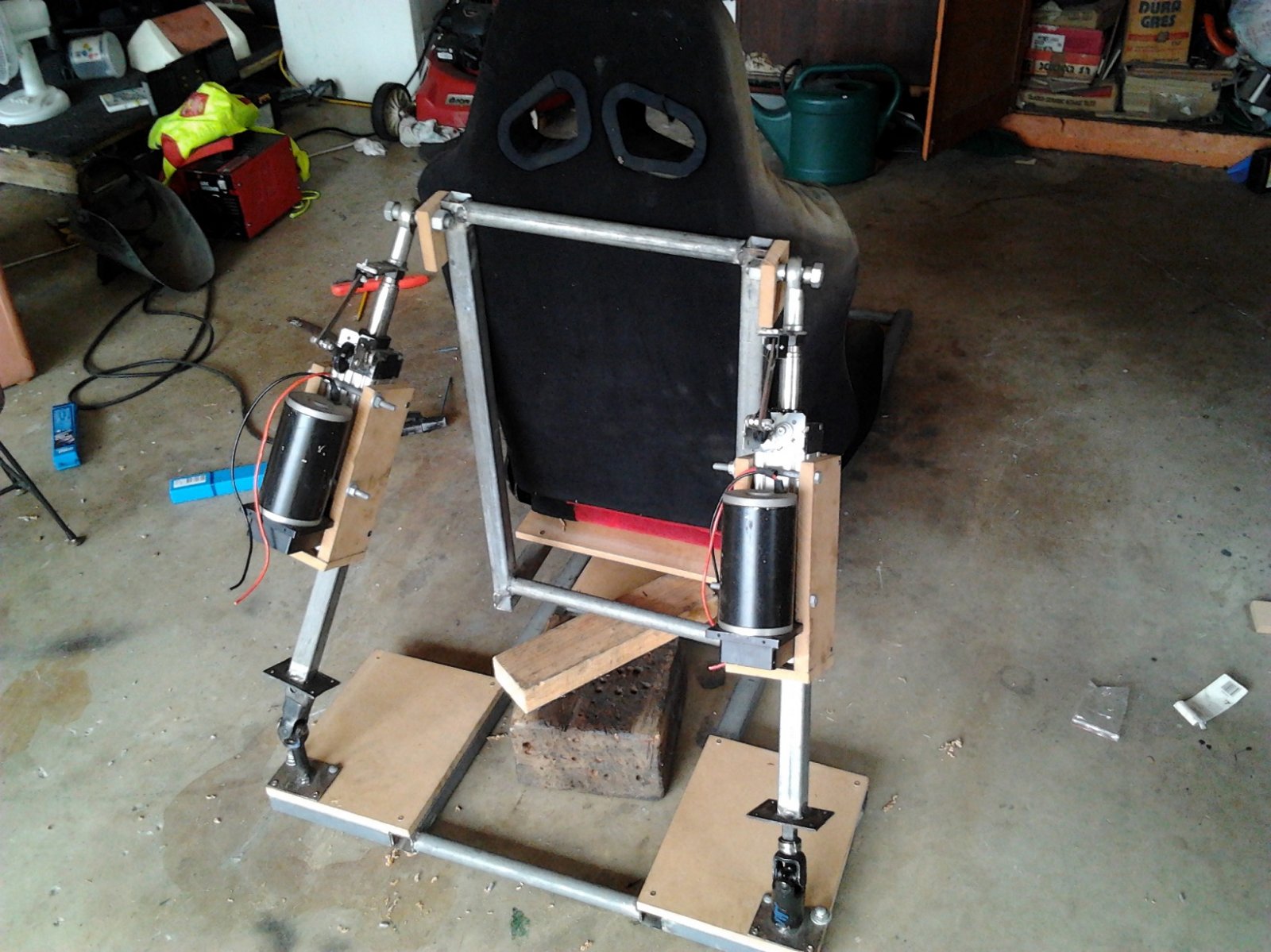

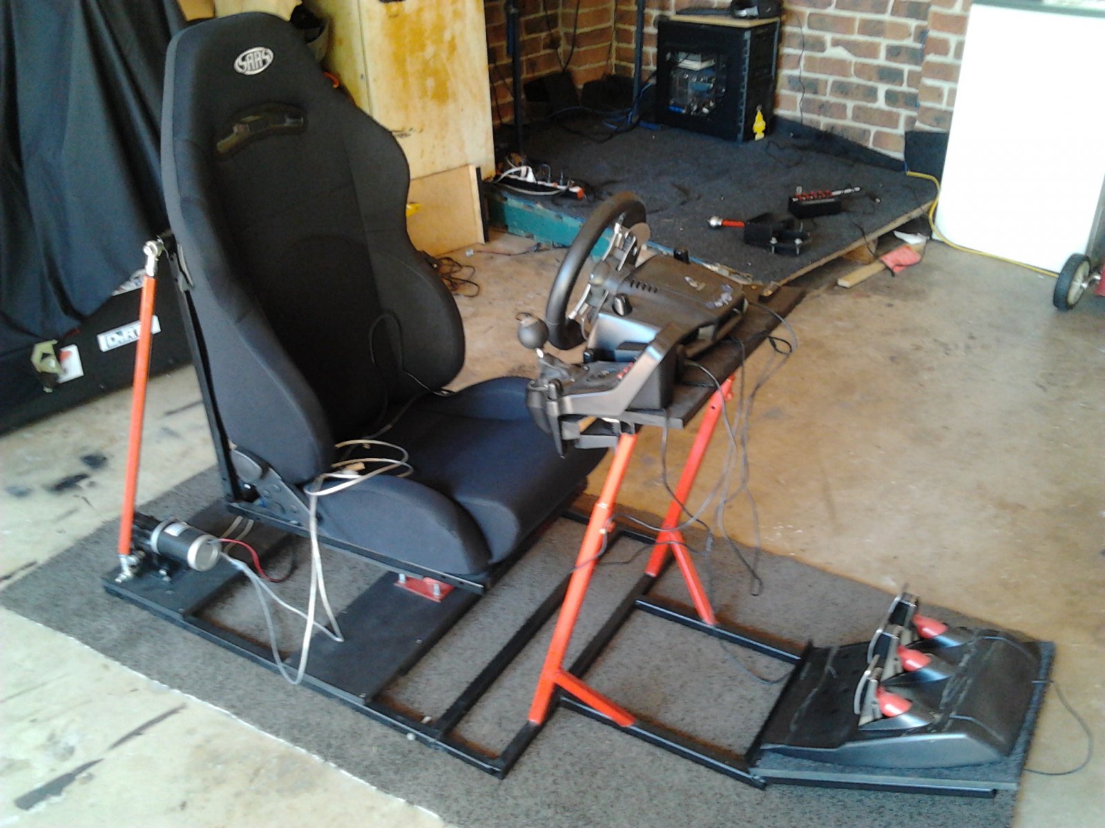

  9. bsft
    heheee...im being silly
    I got given those actuators so I re-motored them and use them
    heres a DC seat mover I had for a while
    I sold it to bring actuators back as they were just gathering dust
    I prefer the DC motors, but not going to sell actuators for the sake of a change
