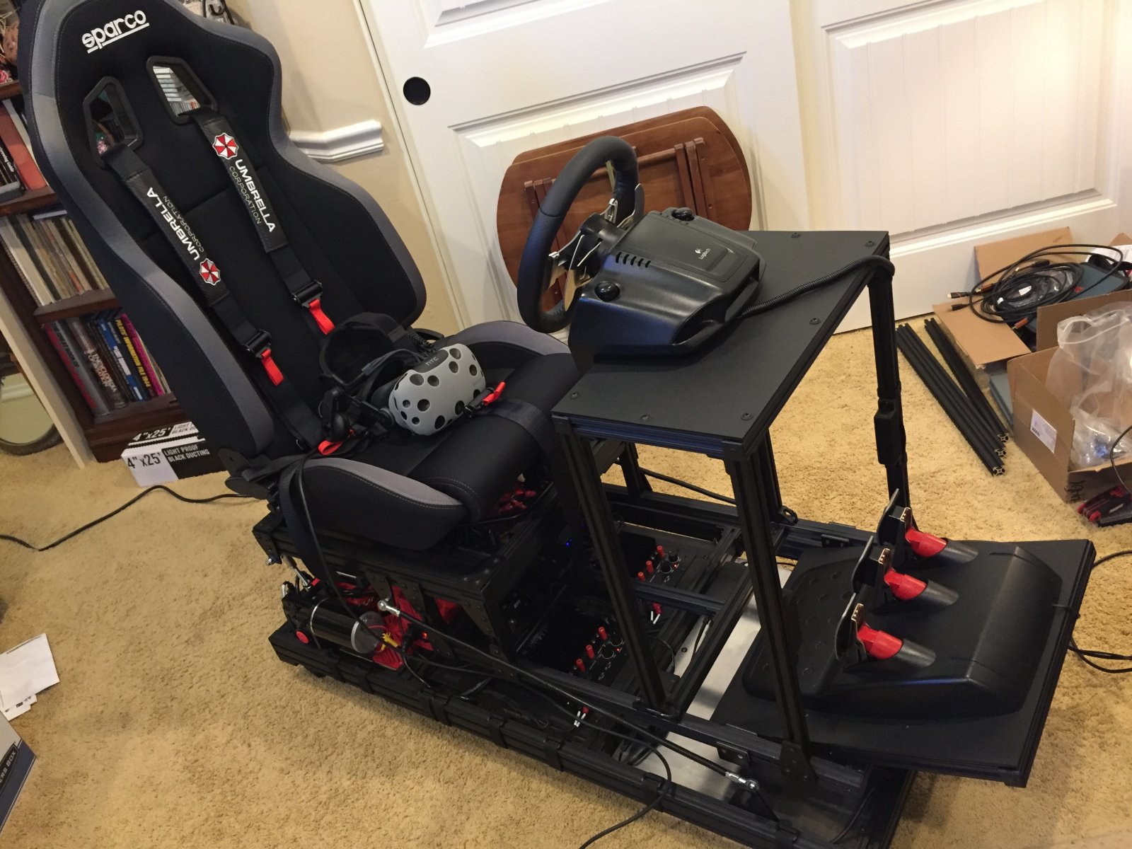

    I just finished taking my 2 dof rig for some PCars2 test drives after getting the throws all set and sorting the motor directions for the various forces. Still need to tune the forces but they are in the ball park.
    In VR. :grin
    So wild to have the traction loss throw the cockpit side to side even though I don’t have traction loss per se. And feeling the acceleration and braking, the curves, the curbs, etc. And this is without wind connected up yet or GameVibe since that is still in testing - but I’m ready for it as soon as it’s released!
    Still got some adjustments to make and a bit more work to do, but driving in VR is a trip. I’ve been driving an office chair with a bass shaker on it running on audio and that was great, but even just 2 dof is such a trip. Completely transforms it!
    Got to get wind set up and vibes whenever available, and need a change to the belt tensioner, but man! If anyone reading is on the fence about building a 2 or more dof for simming, it’s wild! I don’t regret a single penny I’ve spent on this thing! :thumbs

    Looks like a sweet build. What was the total cost? What 2 dimensions does the rig cover? front back, left right?
    and are those wiper motors? :D

    @Blame73 - Yep, still optimizing it. Mounting up the wind stuff. Was working on that last night. Made some angle mounts to aim the wind and just need to mount the circuitry and fans. Got some tweaking yet to do on the seat belt tensioner too and still need to mount my stick and pedals for flight, but it’s really close to done.
    Still lots to do but it now runs and had a blast this last weekend with it!

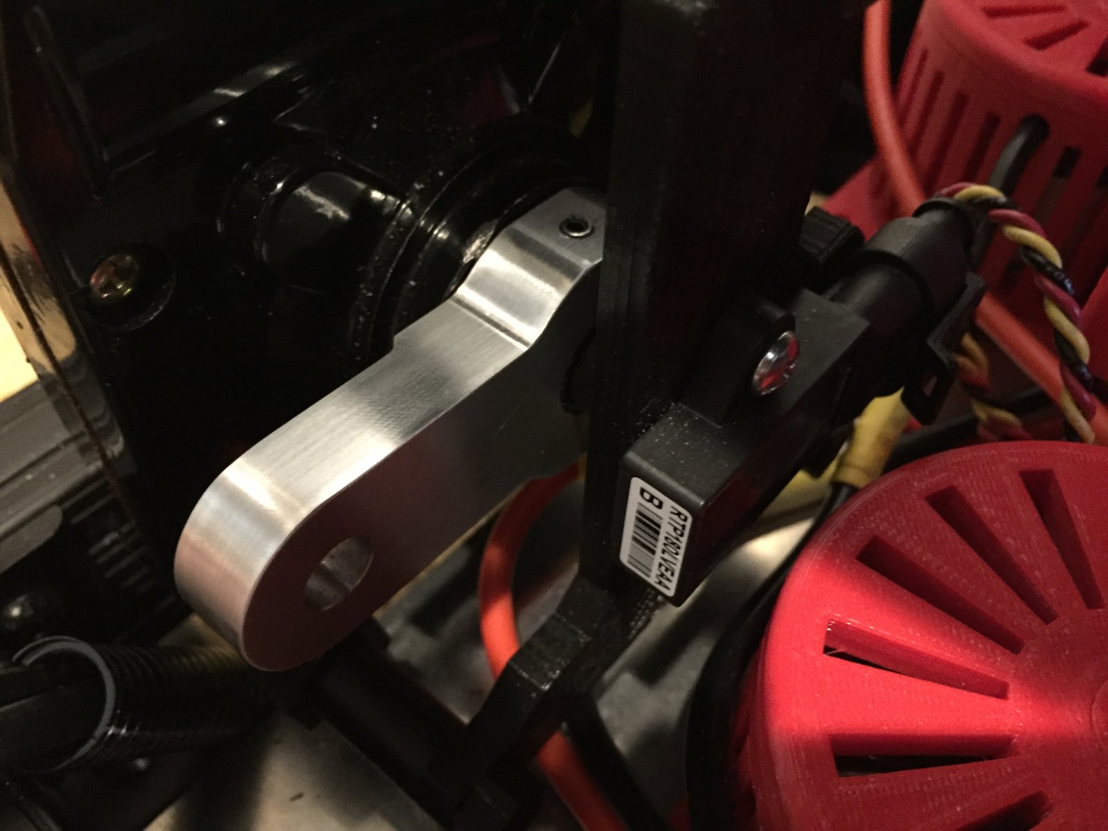

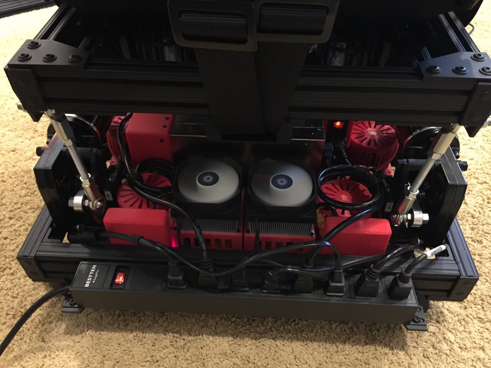

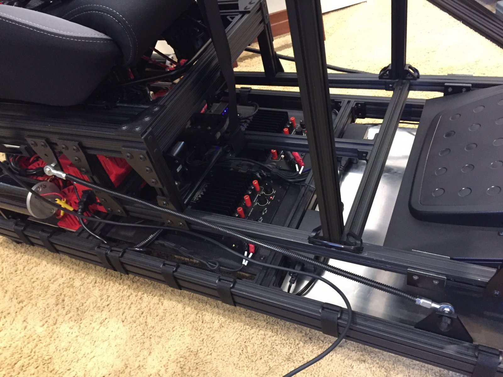

    Hey @Mohamad Ballout, I’ll post a build thread coming up but still getting the final bits in place. Built it myself with lots of ideas and information from here. I used Mean Well SE-600-12 600 watt 12 volt supplies, pgsaw (eBay vendor) 50:1 gearmotors, JRK 12v12 motor controllers, and an assortment of other parts and pieces for vibration, seat belt tensioning, wind, etc, all on a frame built from 80/20 Inc 10 series aluminum strut. I started this process last March and just now got it where I can start driving, flying, etc. with it. It’s way fun and this thing is a performer. I slammed a wall at speed yesterday at Daytona in a Lotus Type 38 Ford after I got sideways and my wife thought I was cursing because I was upset. I had actually just gone for a very unexpected ride while my car went flying and I was being thrown back and forth, forward and back and was cursing because it was just so wild of a ride. I had just finished running the Tuning Center to get SimTools to know what values to expect and the crash probably was hitting the controller logical stops over and over.
    If you’re thinking about motion, I really recommend it. It transforms simming big time with VR.
