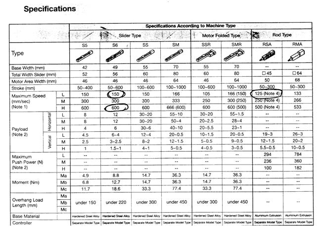

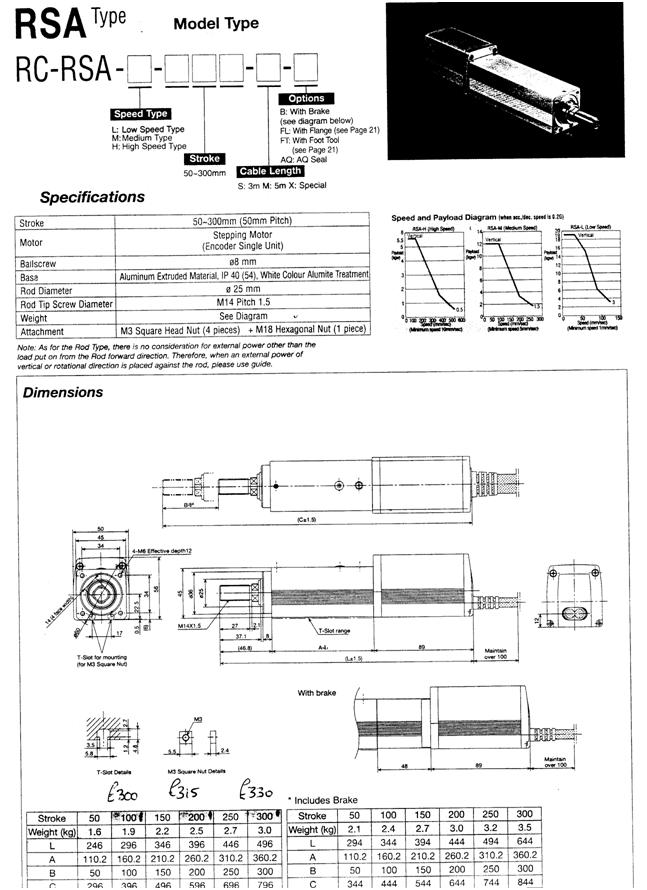

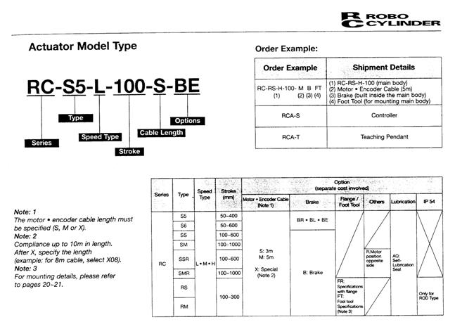

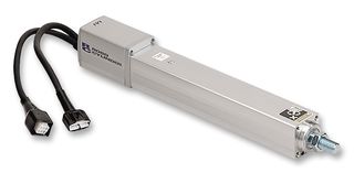

    -hey, I have been away for a while because of some I have been very busy ... (just started studying again, after 7 years of working... totally different)
    A friend of mine offered me these for a good price... but will I be able to use them... I think the specs look a bit like the SCN5...
    I hope someone can give me an answer, if I would be throwing away my money...
    IAI - RC-RSA-L-100-M-EU - ROD ACTUATOR, 24VDC 100MM
    http://mechatronica.eu/en/Mechatronics/ ... linear.pdf
    (I know I have asked some you these before, but its at good price now so it would been cool to know.)

    Try to find some info about their serial interface. The pdf you've linked just shows that serial control is possible, but we need to know it closer.
    You should send an request for info or datasheets about the controller to IAI' support directly.
    Regards
    Christian

    It is this one.
    http://www.intelligentactuator.com/pdf/ ... (MJ0162-2A)-E.pdf
    But I am not sure if the acutator you've suggested supports it. You rather should contact IAI and ask them about it. I not even able to find the RC-RMA model in their product list even. Discontinued!?
    Regards
    Chrsitian

    Yes i think it is a discontinued product... that why it was so cheap...
    So i should ask for a manual for serial communication for the model a
    I am looking at?

    IAI_Robo_Cylinder_Serial_Protocol_manuals.zip
    The serial protocol with BBC chechsum seems pretty similar to the SCN5
    Regards
