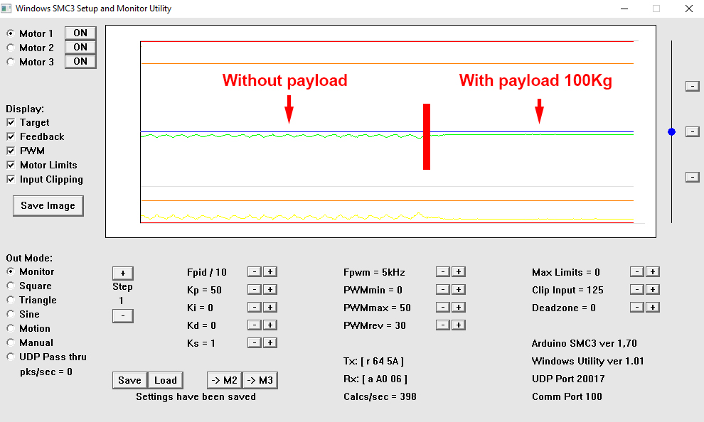

  14. superwhitewish
    superwhitewish Member
    Jul 3, 2016
    60
    Avionic Engineer
    Malaysia
    225Coins
    +51 / 0 / -0
    From this picture I see that your PWMmax is only 50. That will make the motor weak. Try to increase it to 250 and see what happen.

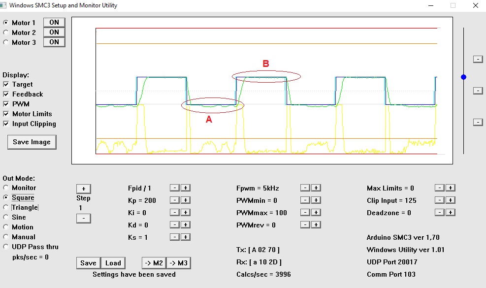

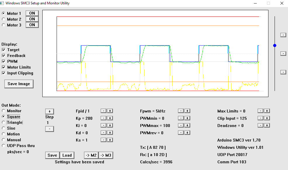

  17. motiondynamics
    motiondynamics Member Gold Contributor
    Apr 12, 2019
    211
    1,225Coins
    +9 / 0 / -0
    2DOF, 3DOF, DC motor, AC motor, SimAxe, Arduino, Motion platform, 6DOF
    Hi, I carried out the test as you advised me, you can see the result.
    Tell me.

  18. superwhitewish
    Jul 3, 2016
    60
    Avionic Engineer
    Malaysia
    225Coins
    +51 / 0 / -0
    Response looks sharp. That's good. But I notice the oscillation happens in certain area only. Lower area A it oscillates but upper area B it stays steady.
    Sorry but I don't have any more idea right now.
    Maybe you can check the potentiometer installation. make sure they don't get loose when the actuator moving or don't get forced side way.
