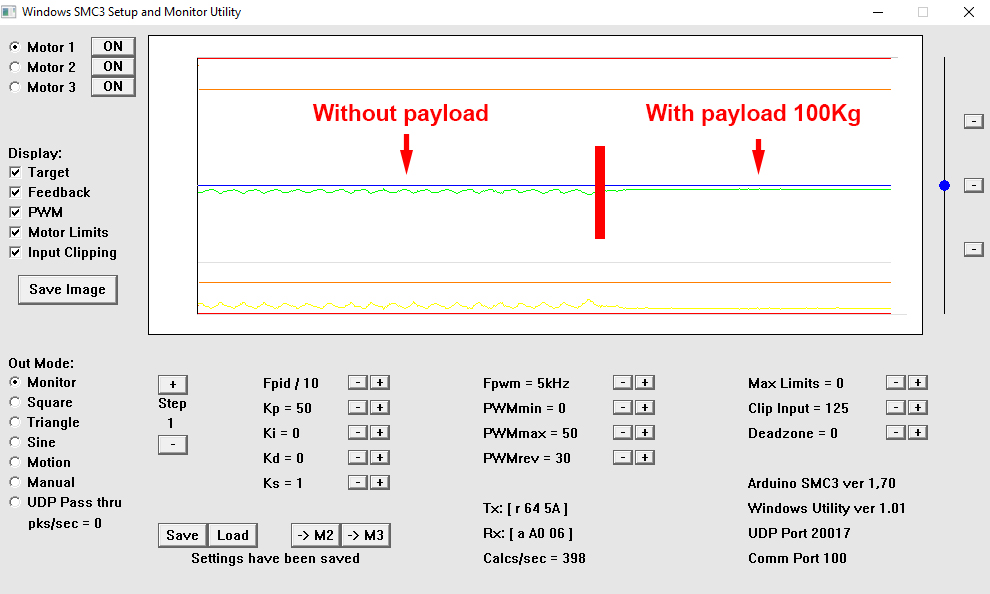

  6. motiondynamics
    motiondynamics Member Gold Contributor
    Apr 12, 2019
    211
    1,235Coins
    +9 / 0 / -0
    2DOF, 3DOF, DC motor, AC motor, SimAxe, Arduino, Motion platform, 6DOF
    Hi everybody.
    I carried out the first tests to locate together with
    you the cause and resolution of the problem:
    This is the 1st test: I removed the 100 kgm payload, the simulator swings up and down by 2mm (2 down, 2 up) constantly.
    As soon as I put on the 100 Kg payload, the oscillation ends (see the graph)
    What could be the cause?
    How could you solve the problem?

  7. Gadget999
    1,988
    12,132Coins
    +492 / 11 / -0
    Set pwmmax and pwm rev to 255
    Set frequency to 20khz
    Reduce kp to 1
    Not start a sine test
    Slowly increase kp till it tracks correctly

  18. motiondynamics
    Apr 12, 2019
    211
    1,235Coins
    +9 / 0 / -0
    I carried out the test of disconnecting the potentiometer: the actuator goes all the way down until it hits mechanically (mechanical stop). I put the potentiometer in right away to avoid burning the motor or the electronics.
