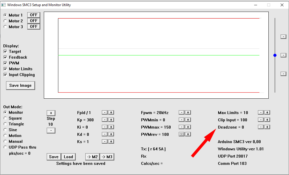

    Hi all, I have a very annoying problem:
    I built a simulator with 4 electric actuators (D-Box type) arranged in the 4 corners.
    For each actuator I use a 10K potentiometer.
    I loaded the SMC3 V1.0 code into my Arduino.
    I give power to the electronics, as soon as I connect the USB cables the platform starts to oscillate "up and down" of about 1 cm, around the "center" position of the potentiometer.
    This behavior is very annoying.
    Is there a way so that when I insert the USB cables, the motors stop, so they don't receive current?
    Surely it is the SMC3 V1.0 code inside the Arduino that gives this effect. Is there a way for the actuators to move only when the car is on the track?
    Please give me an answer, so the simulator doesn't look nice, it shouldn't move when you plug in the USB cables.
    It would be a good solution if there is a way to stop the motors from moving when you plug in the USB cables.

    Have you tried a little dead zone in the SMC3 settings?

    Hello noor beast.
    Do you mean the SMC3 Utils settings? (see picture)
    I've tried increasing this value but the wobble won't go away.

    Yes that is what I meant.
    The other thing to check is a noisy signal messing with the pots, use shielded cable, keep power leads well away from pot leads, and try some ferrite magnets.

    what happens when you open smc3 test program ? does it oscillate in there ?
    try a smaller Kp number

    Do you mean in the graph?
    The Kp value is already small, 150

    I believe it has been resolved in SimTols v3, but it has been a difficult one to pin down as it only affects a seemingly random small number of users. My understanding is that it is more of a Windows bug.
