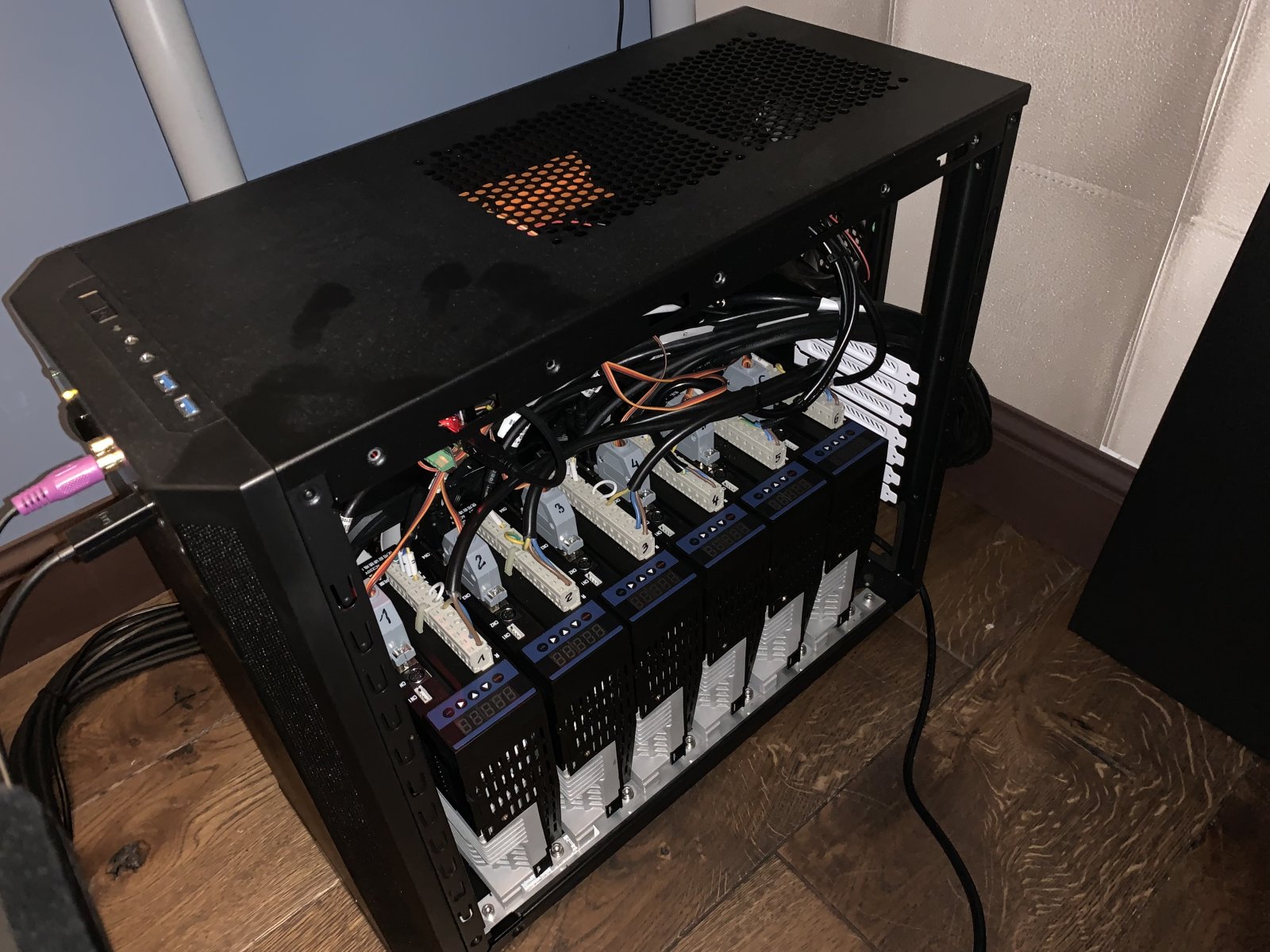

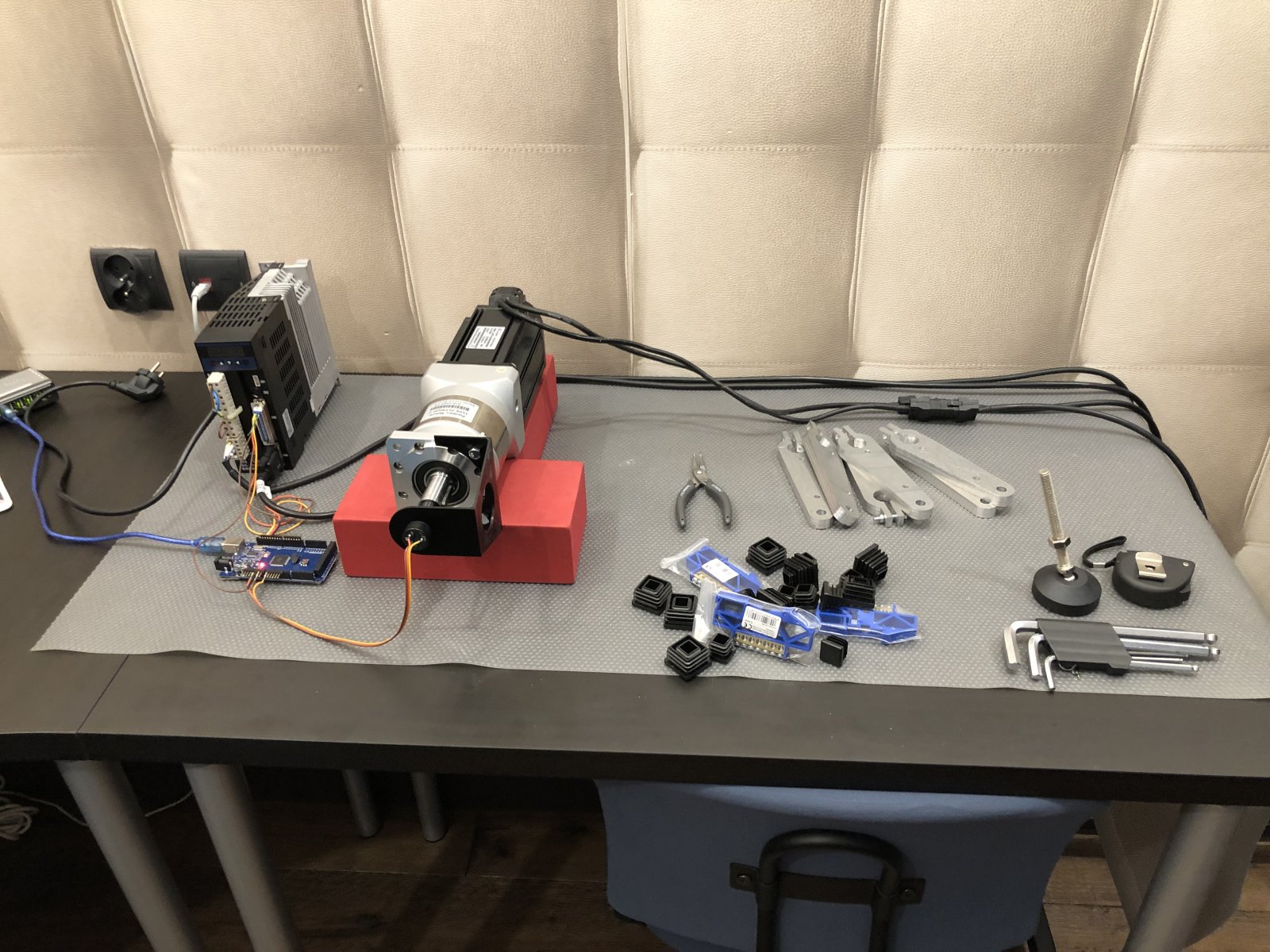

    I use step/dir position mode. The current state of the angular servo position is processed and stored in Arduino controller. It looks like, even after 2 hours session under full load, no step is missing.

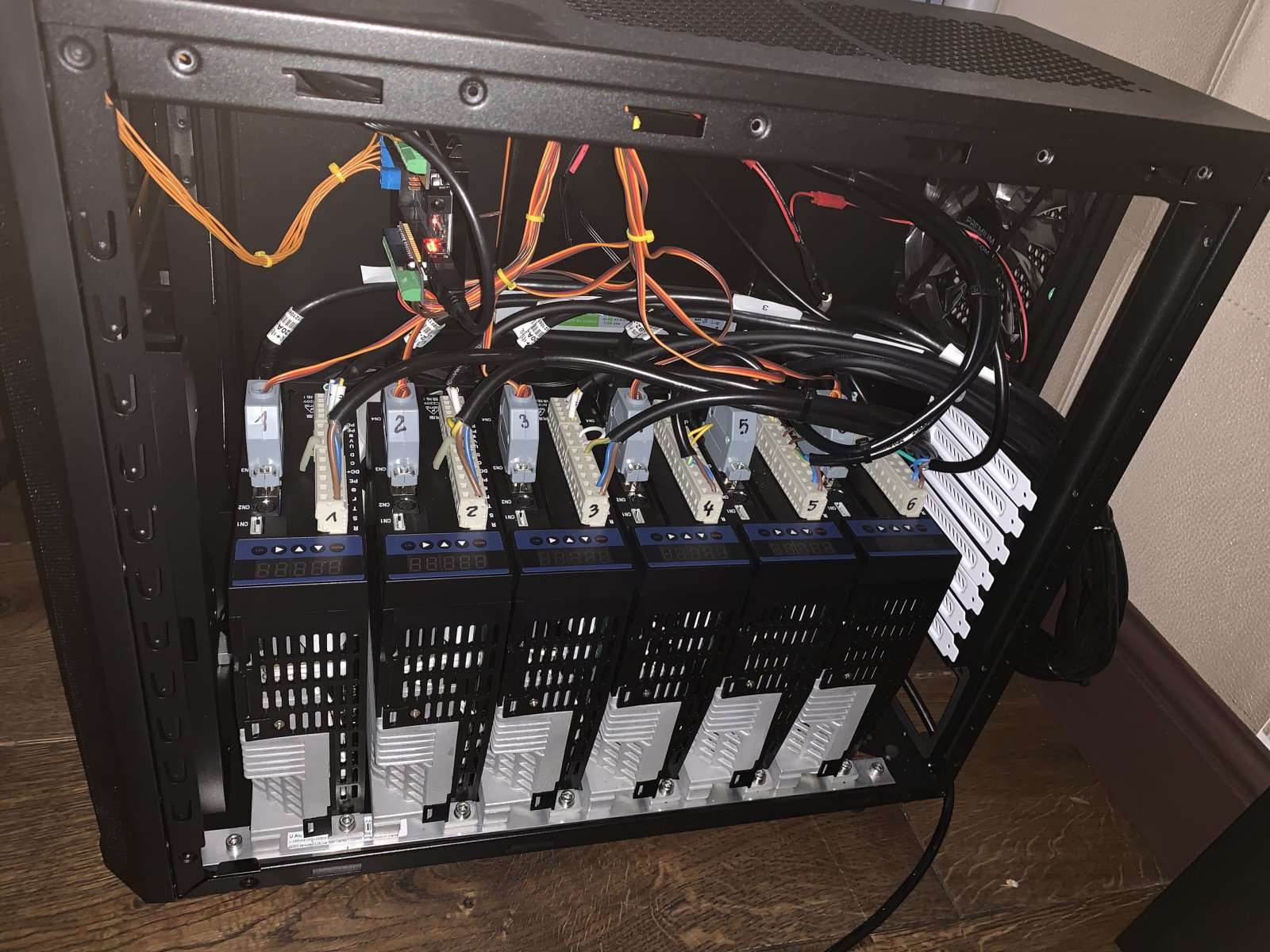

    I squeezed the servo controllers inside a typical midi tower PC case (Fractal Design - Core 3500 Window). Take a look a the pictures below. I also removed the noisy fans from the AC servo controllers and installed 4 slow and quiet 14 cm fans on the case walls. You can barely hear it working, while the controllers are kept cool.
    When I took the picture, I noticed the thick layer of the dust on the case top. It's a message: the rig is working flawlessly, no need to touch the control unit ;)

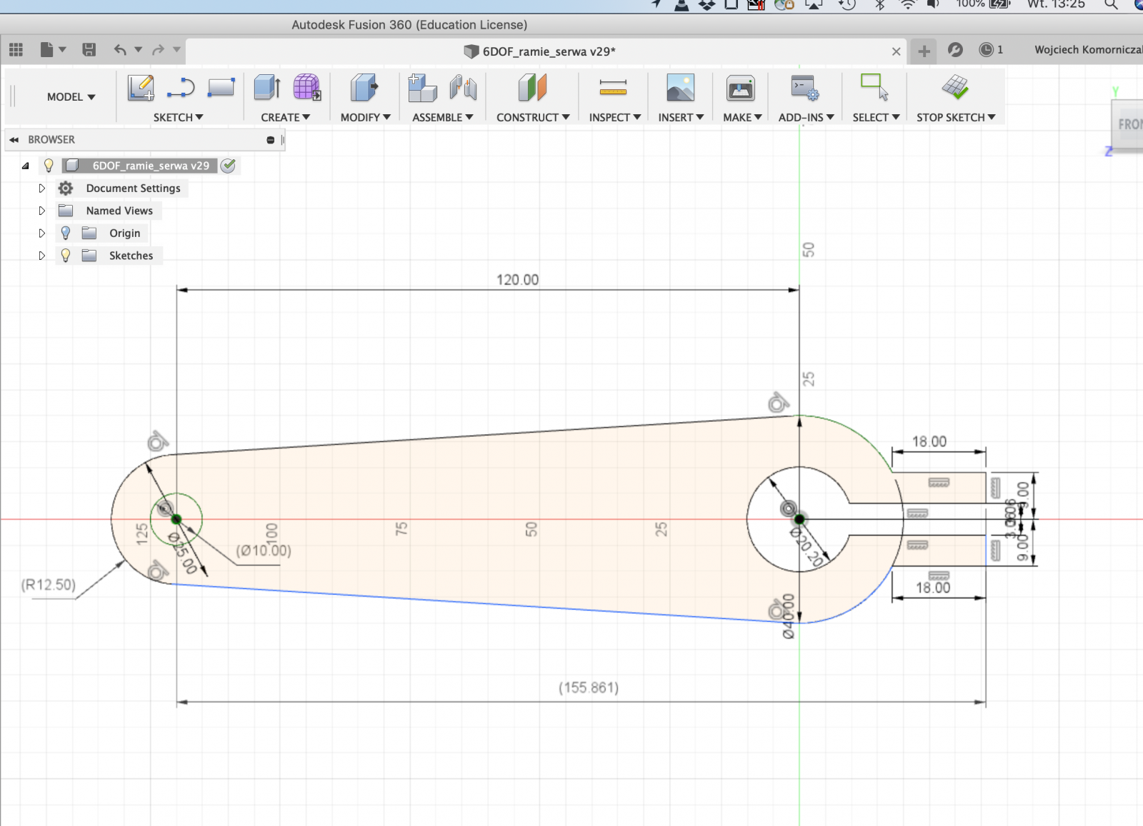

    I'm interested in your torque arm.
    would you please upload your CAD file?

    I attached Fusion360 export file and .step file. The basic drawing is below (milled in 12 mm aluminum sheet):

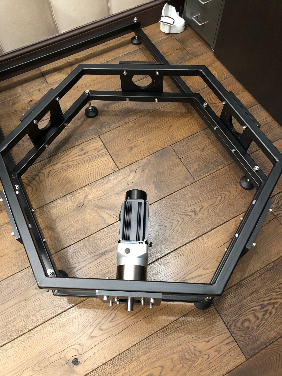

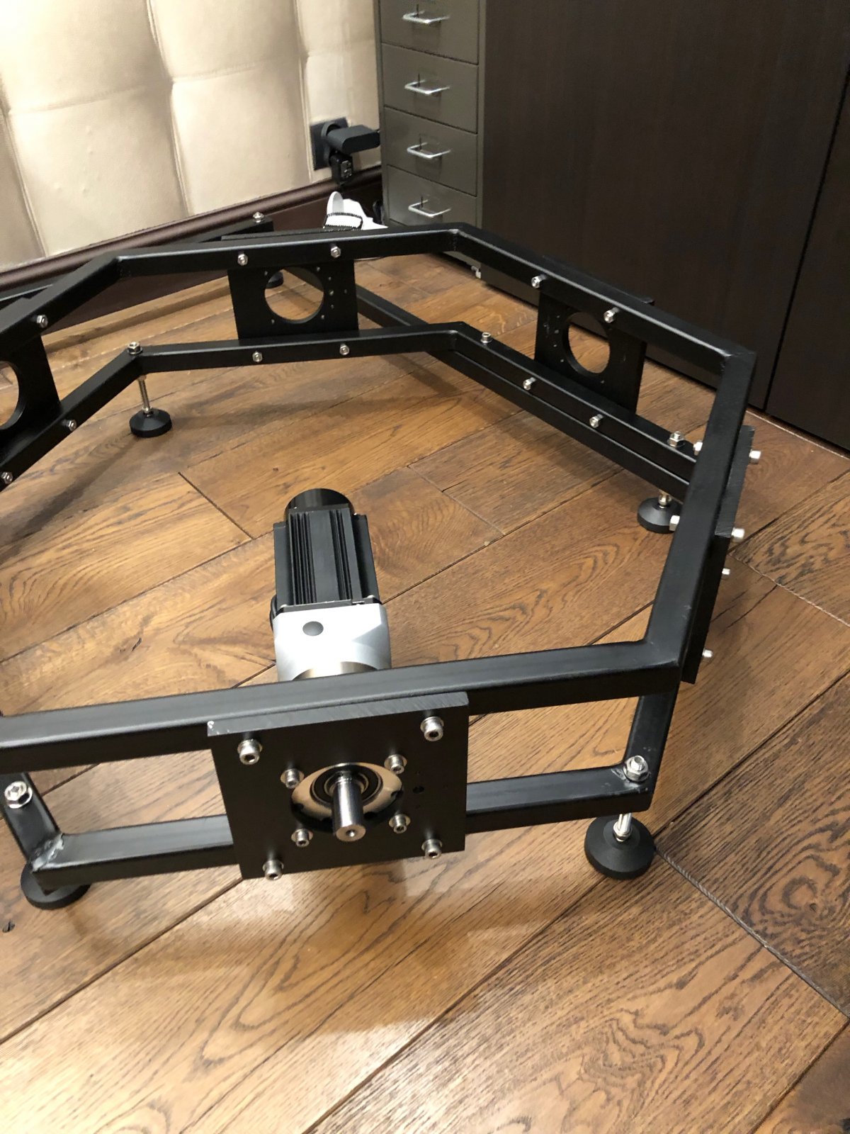

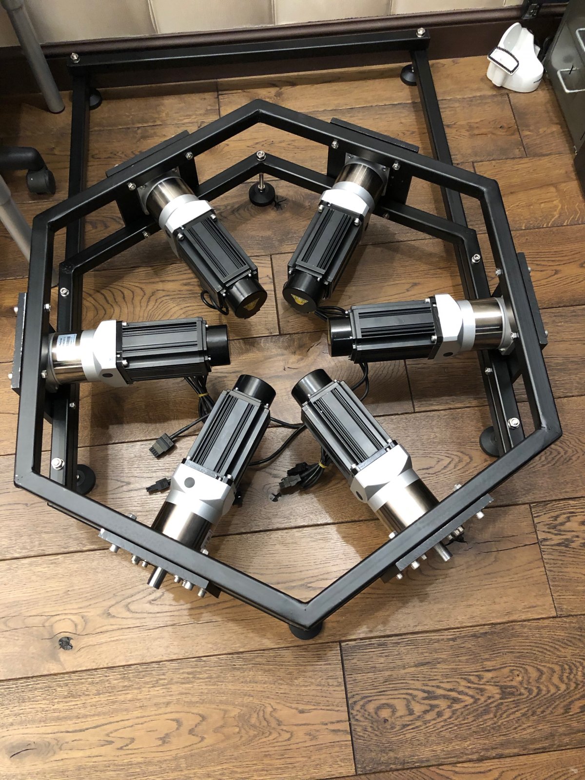

    A couple of pictures of the servos being attached to the lower part of the frame:

    Your case looks very neat. I was planning to put servo amplifiers in a rack cabinet of size 600x450 mm. My aplifiers have only radiators (and braking resistors) so my thinking was that they need some room to prevent overheating, but I havent tested tchem with real loads. Maybe your case solution will also work for me (less space taken by the cabinet - easier to carry). Thanks for the pictures!
    I'm very curious about your controll method, espetially how do you generate step signal? I have finished analog speed control mode but it requires additional IC'c (I'm using 12bit DAC and some expensive Aplifier to bring control signal to required +/- 10V range) thus when @Thanos presented its new firmware and controller that uses step/dir I'm thinking to transition to this kind of control scheme. What bugs me is how to properly generate step signal. My initial test where simple direct pin manipulation, just to see if it works, but I imagine that that signal won't have stable pulse frequency (I have no idea if it's even a requirement to have stable pulse frequency). My next thougth is to youse timers to generate required numer of pulses with desired frequency, but it's over my head for the moment. It would be awesome it you could share some details about how you are dealing with pulse generation?

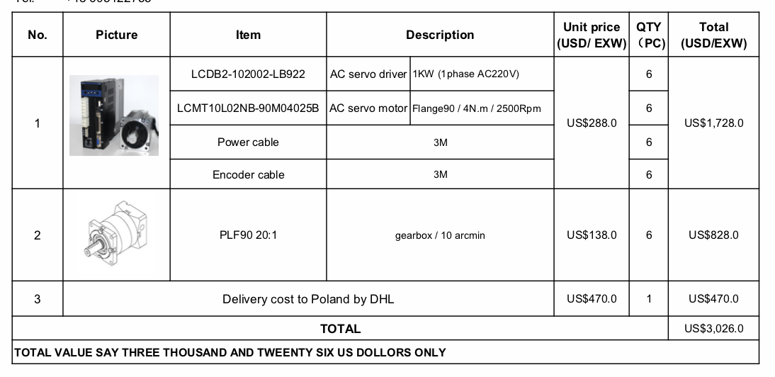

    At first glance the motor setup appears to be $550 per motor/driver/gearbox. Which would end up as a project cost of about $4-5k USD. Is that correct?
    Do you have any issues with backlash when you reverse direction? I always wondered if it was noticable with the lever arm style and a lowlash planetary gearbox.

    @BM114 In fact, I paid $3k USD including quite an expensive shipment cost from CN to PL (see the attached costs summary). The cost of the remaining pars was below $600 USD.

    @lromaniuk Regarding the pulse generation, I noticed that the AC Servo Controller is not sensitive to the pulse period fluctuations. It just counts the pulses and moves the servo the preprogrammed number of the internal encoder "clicks". Actually, the only thing you should pay special attention is the minimum pulse repetition period. In my case, it was something around 20 microseconds. Below that value, the servo movement was kind of jerky. For each servo, I use two digital outputs of my Arduino: one for the pulses and the other one for the DIR (direction) signal. Indeed, it took some time to tune the control method on the bench but the result is absolutely satisfying.
