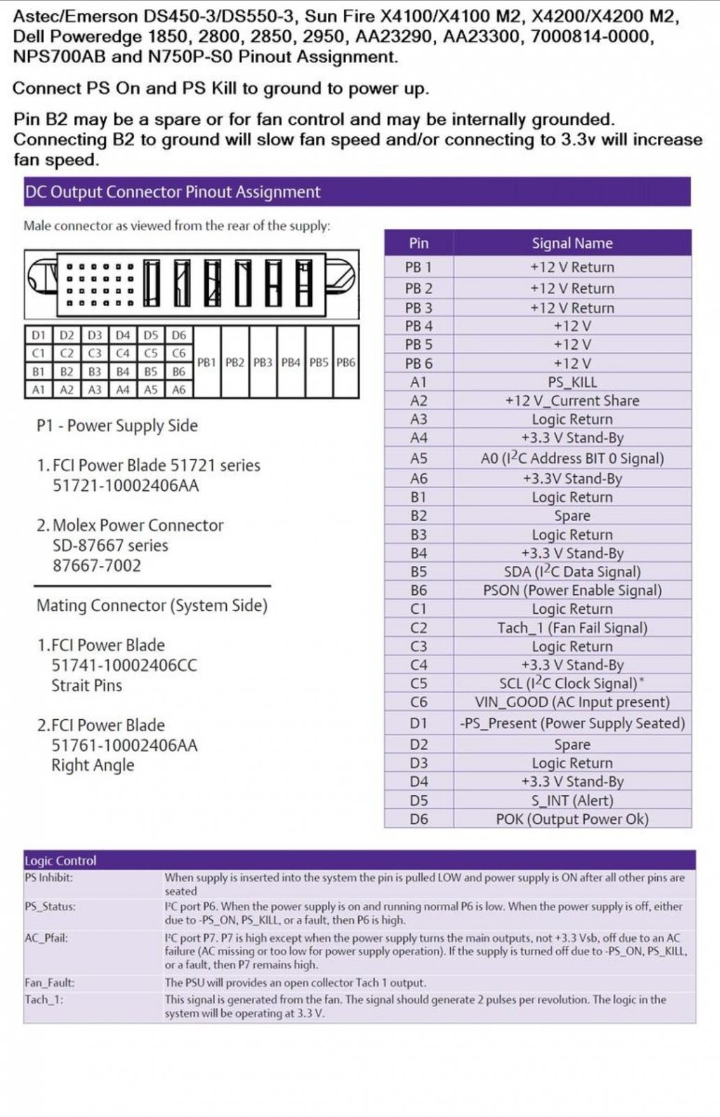

    I picked up 3 dell N750P- S0 PSU's from dell poweredge 2950. Electrical wiring is not my strong point. Can someone confirm that I'm connecting this correctly. I attached pinout for psu below. I followed instructions for power switch and fan mod from this post.
    Post 8
    https://www.xsimulator.net/communit...-server-power-supply-for-12v.5774/#post-65089
    Post 14
    https://www.xsimulator.net/communit...-server-power-supply-for-12v.5774/#post-68351
    I connect A1 & B6 to turn on PSU. How would I install a toggle switch to turn PSU on and off?
    For the fan mod I connect b1 & b2 and then just cap off the wire?

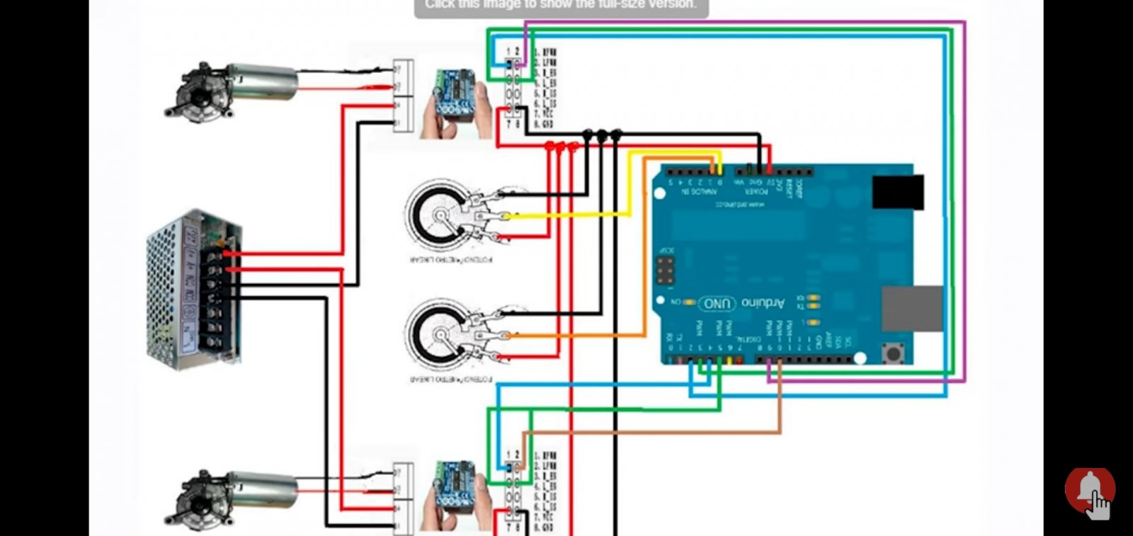

    Now I need to get power from PSU to motor driver. I'm gonna follow the wiring diagram i attached below that I got from DMax's youtube channel to connect everything.
    So to get 12v I just need to connect P4 & P3 to motor driver?
    Also if I want to run a 5.5v for a fan, can I run that off of the header on the Audrino?
