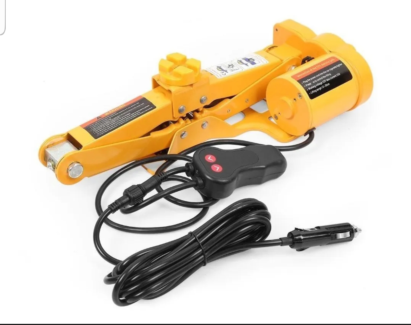

  5. moaale
    moaale IAN MRTIN
    Jun 29, 2011
    170
    NN
    ARGENTINA
    136Coins
    +41 / 0 / -0
    2DOF, DC motor, SimforceGT
    You would have to look for 12v electric cricket motors or electric winches, those go well, they lift a ton and others more ... those motors would come to your hair or if not look for a pair of controllers for the motors that you have 20200914_230722.jpg
