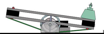

    I was emailing the seller of my second motor which is more like Thanos'.
    I included some illustrations and wanted to add them here in this thread as well. Example #1 is more like Thanos in that weight is to the side of the motor perhaps via tower/motor mount. Obviously, Thanos' is really a close loop with flywheel (but you get the idea). The 2nd is my current design where it is within/under the mechanics/platform requiring only a motor mount.
    This in no way is to say which way is better as a matter of fact if I went with a linear accuator, I would have to go to the side and do the example #1.
    This post is only meant to show 2 different setups and to better explain what is happening visually. I am really hoping to user wiper cause they are strong enough just need to get past this when stopped or holding issue.
    Kyle
  7. tronicgr
    tronicgr
    Hi Kyle,
    My wiper motors are from Nissan model 85', and particularly model B-11 !!
    And yes its impossible to rotate them with hand, body or whatever weight you put on it if not powered!
    And although its a positive to have it hold its position while in motion, I had to make manual controls for them while constructing my joyrider, to reposition them when needed! :rofl:
    And when sometimes something was gone bad, and the frames was locking into 45degrees, I had to repair the electronics first to get it upright! :eek:
    About a month ago I tried to measure the load of my wiper motors with a dynamo meter with scale of up to 30Kg, but somehow it broke and its spring launched bouncing in the room!! :lol:
    I think that any Nissan compatible wiper motor will behave the same even with the more new models! And these wiper motors was of the few that already had crank arm attached on their output axle, with the ability to easy remove the ball on it!
    http://ptyxiouxos.net//greekbotics/user_projects/Flight_Simulator/wiper_motors_pulley.htm
    Regards, Thanos
