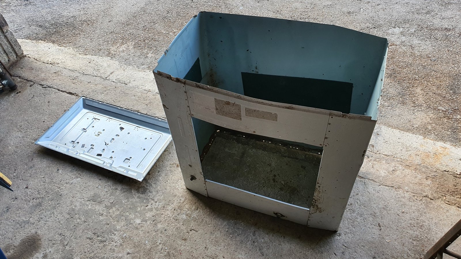

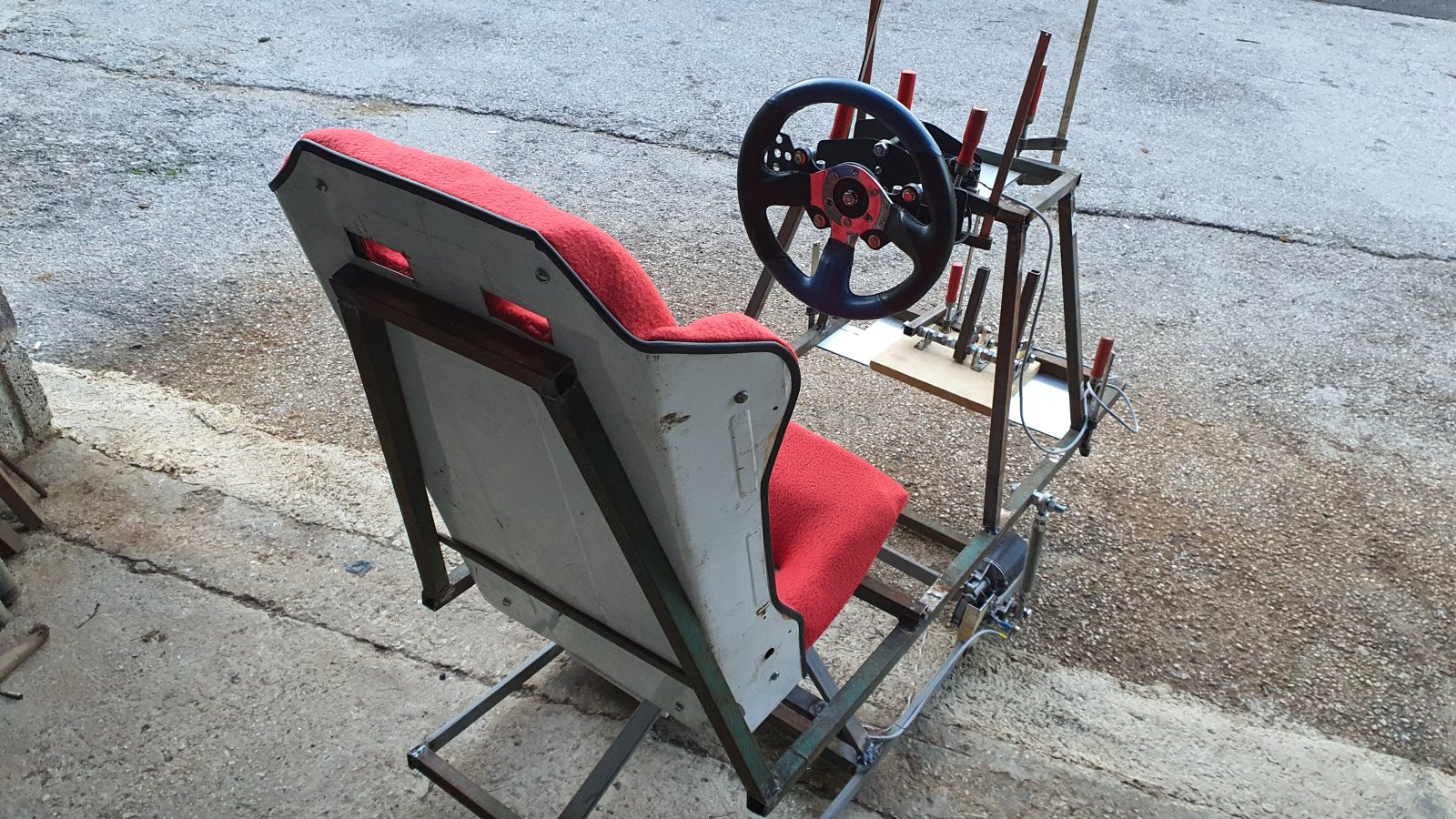

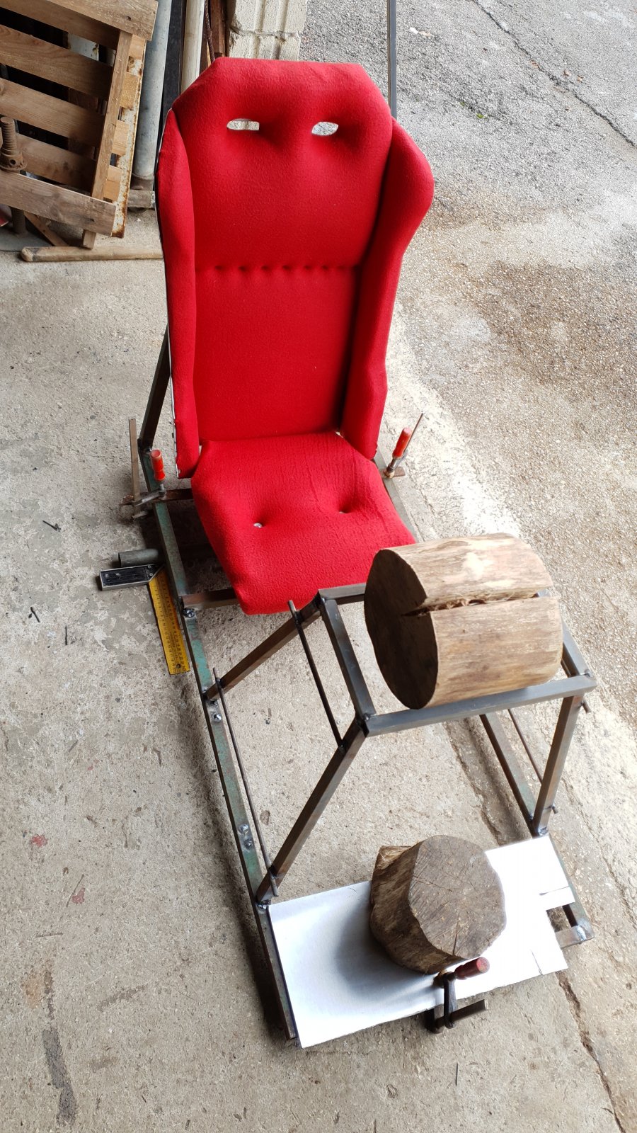

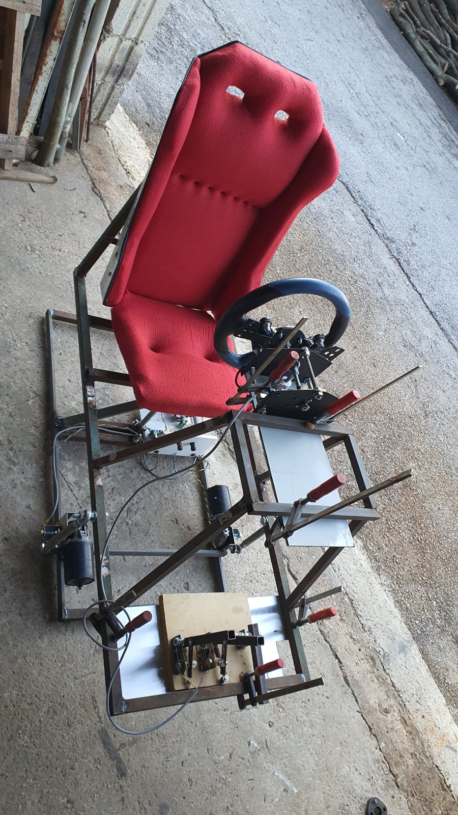

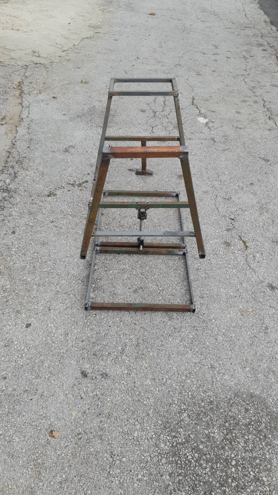

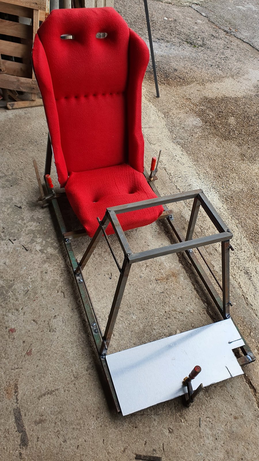

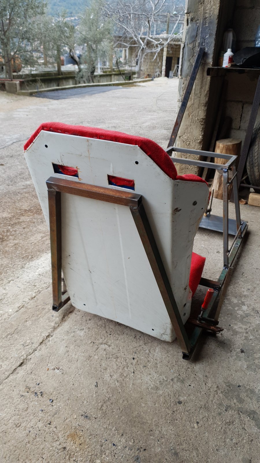

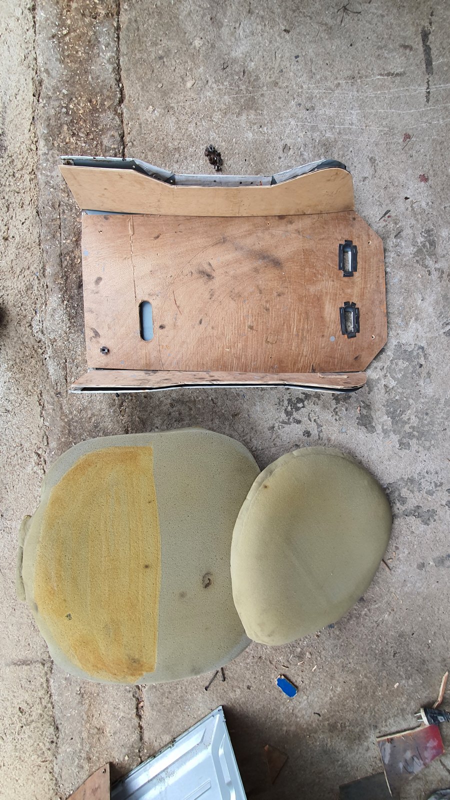

    I even built a diy "racing bucket seat", kind off o_O
    Using metal sheets from a washing machine for the back, and the chassis of an lcd tv for the bottom :grin

    Nice work :thumbs

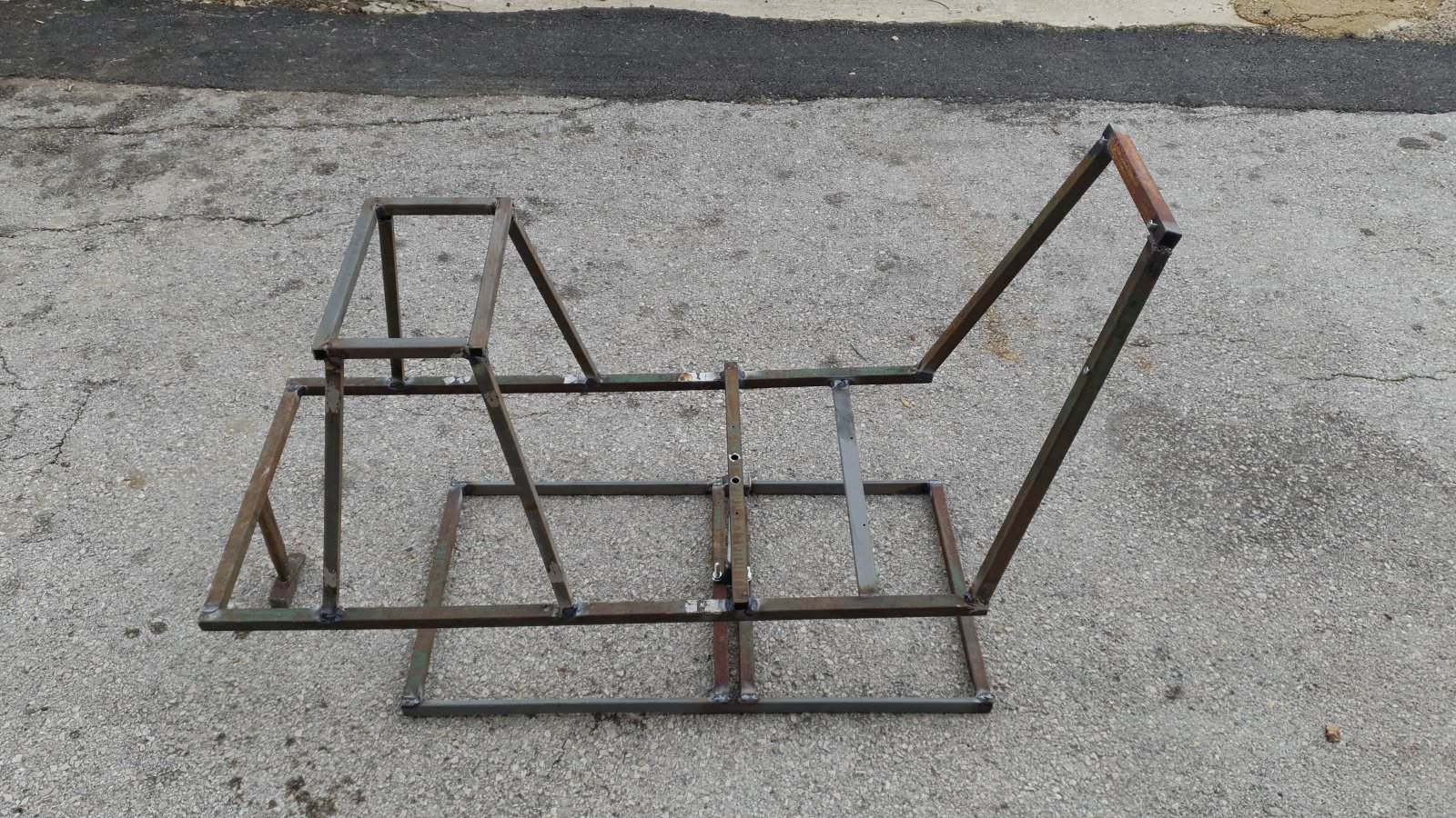

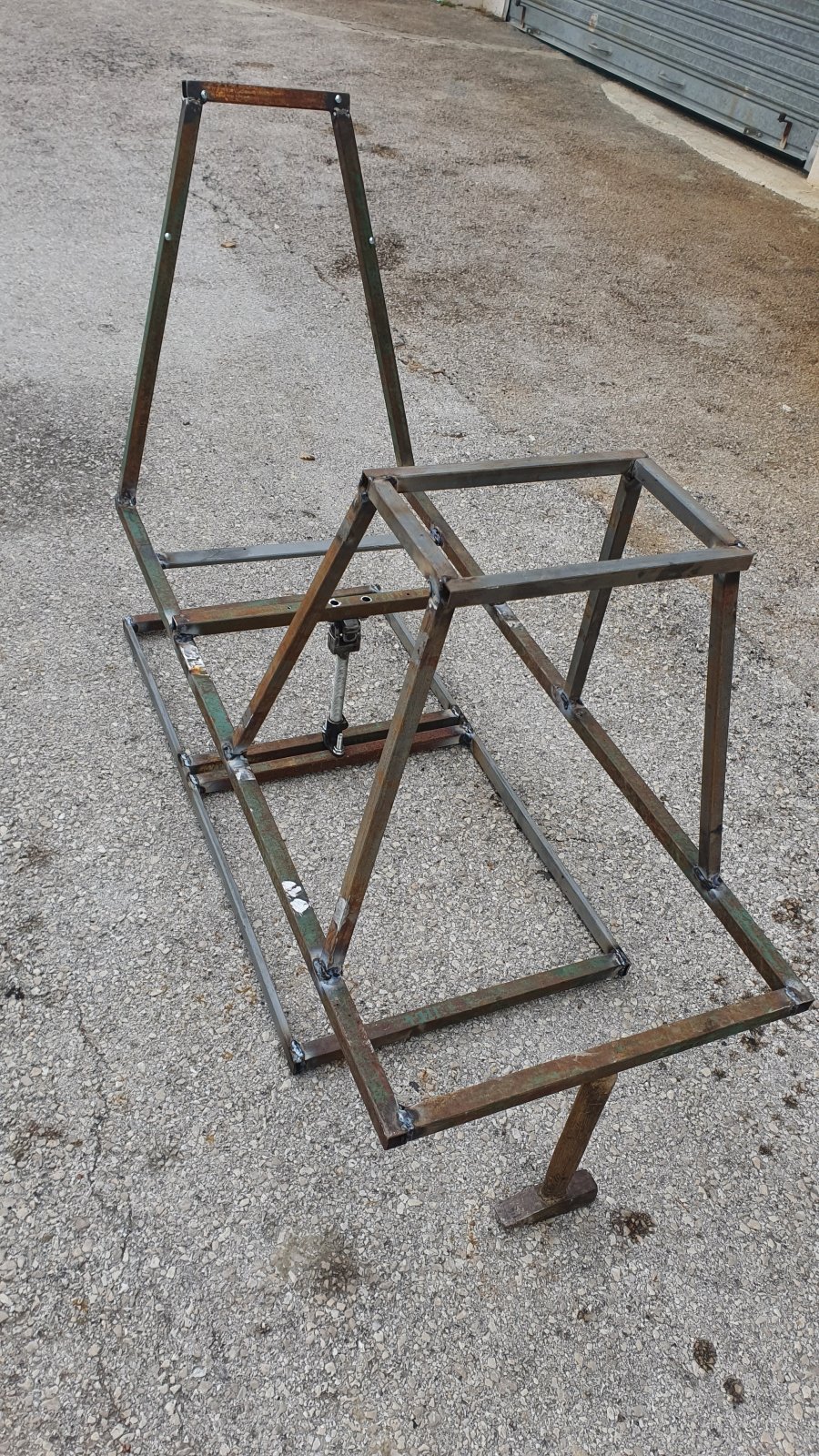

    Something to keep in mind, if you have not done so already you will need to check and if necessary adjust the balance of the rig with yourself in it, plus with all peripherals attached: https://www.xsimulator.net/communit...-of-gravity-to-balance-a-motion-simulator.55/
    The rig has a fair amount of mass, where do you plan mounting the motors, near the feet to maximise inherent design leverage or somewhere else?

    I agree with Mr. Noorbeast.. the balance of the rig (with wheel, pedals, and YOU sitting it it has to be pretty close to the center of mass. Also I had to mount my motors way back and use pushrods to the top of the seat to use the most potential power of the motors. Had I mounted them real low under the seat, they might not have had enough power to move the full frame like yours.. Keep building it my friend! DMAX

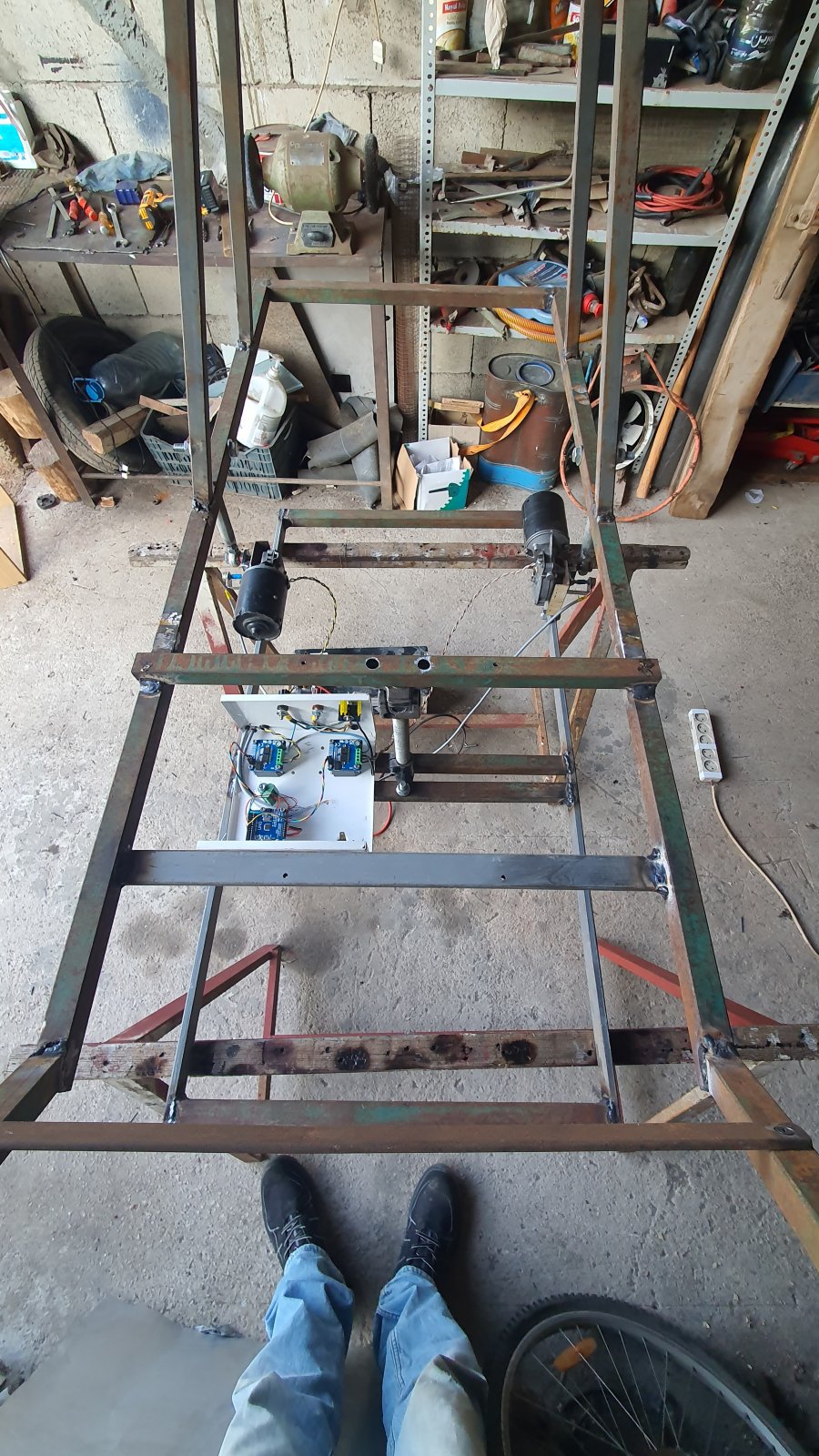

    Yes I did a balance check with me in it and wood logs to simulate the peripherals and steering kit weight. As shown below in the first image, but I'm working alone.

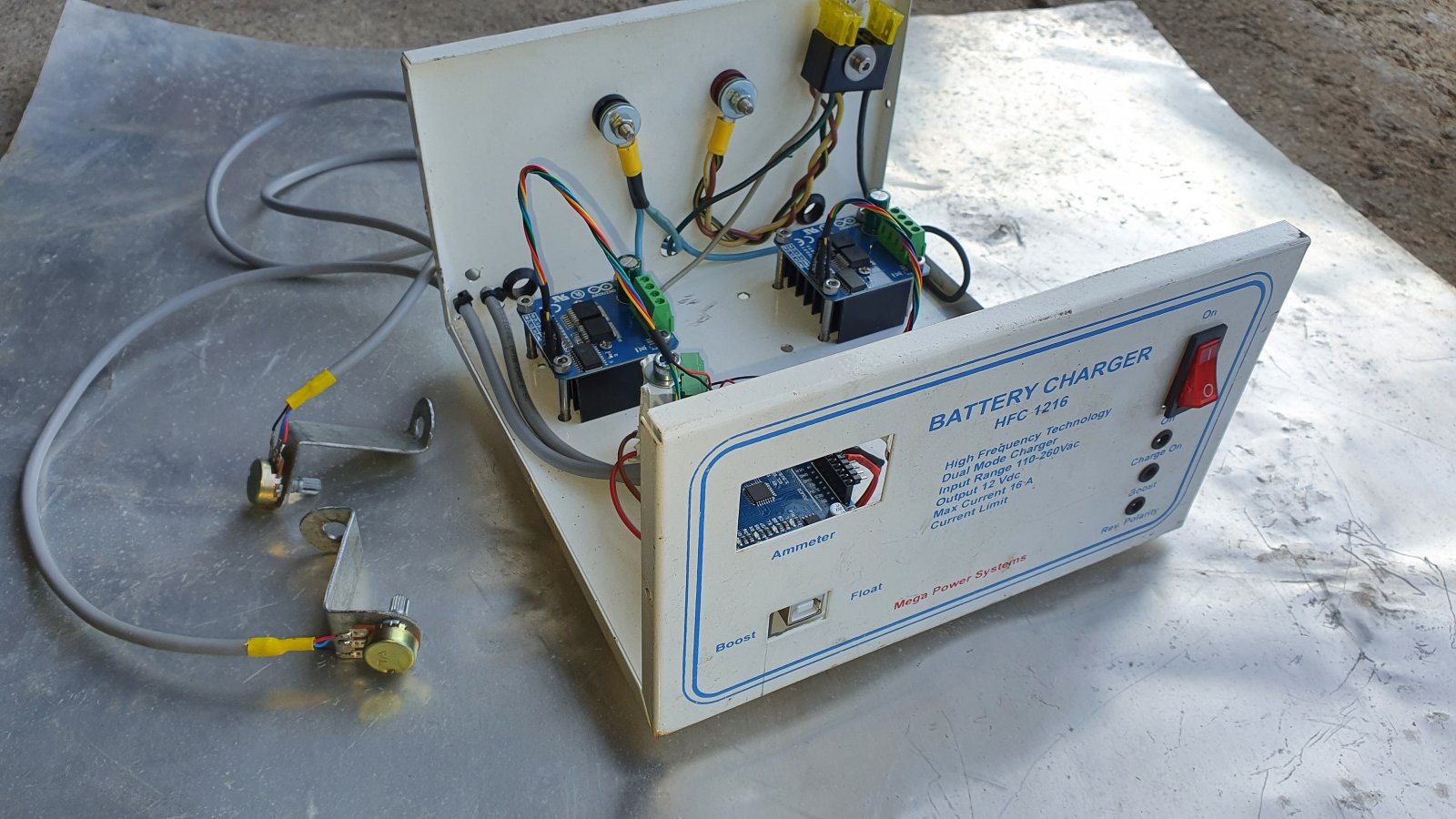

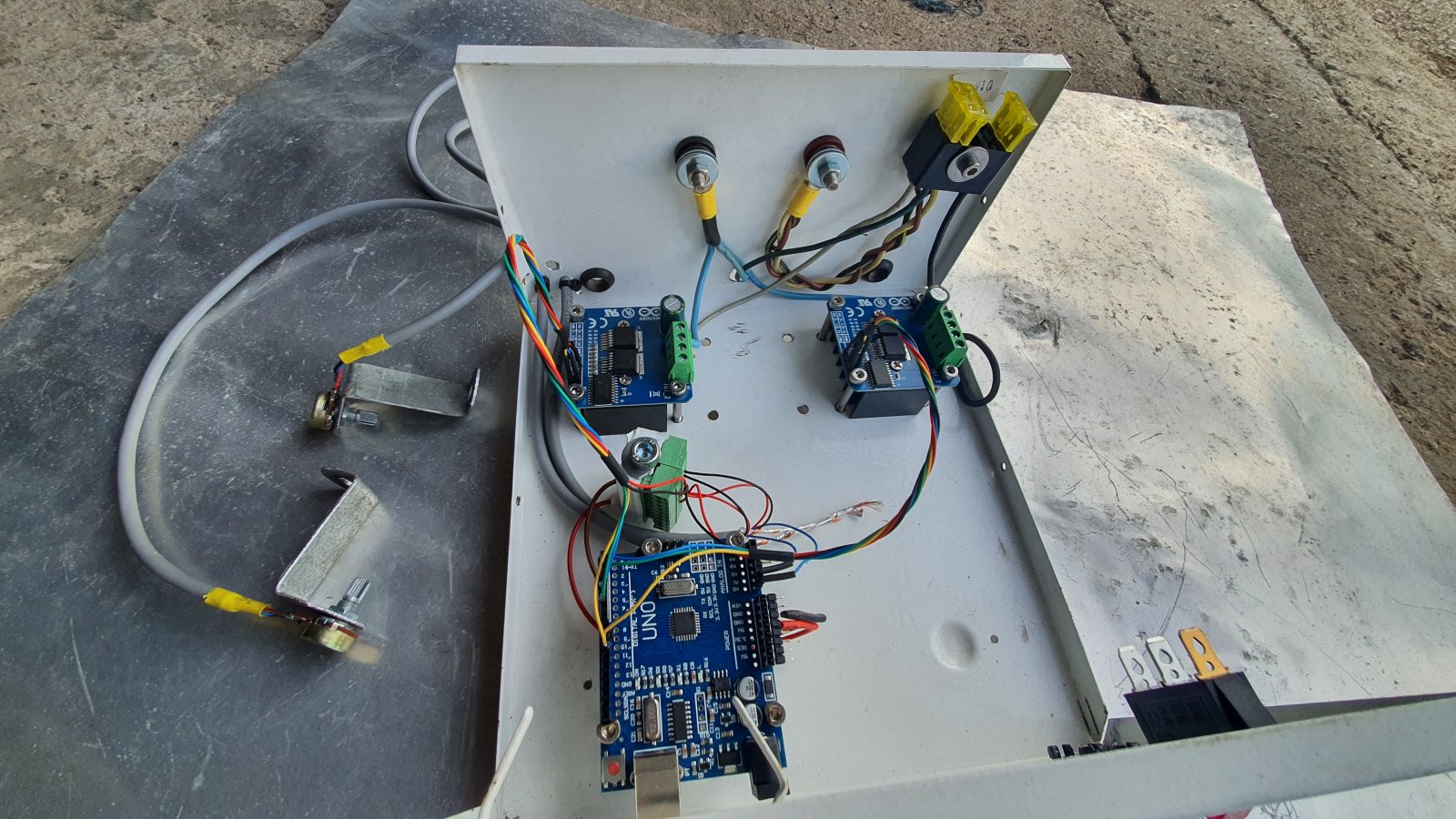

    I did also all the wiring and a startup on smc3.

    Great progress :thumbs
    How have the motors coped with initial tests?

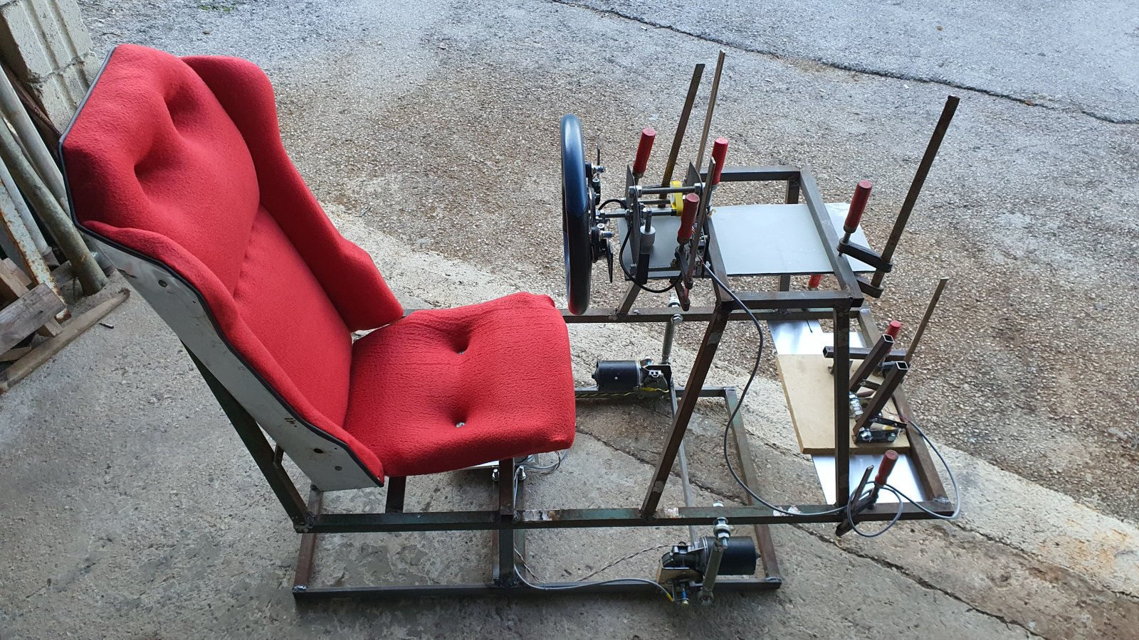

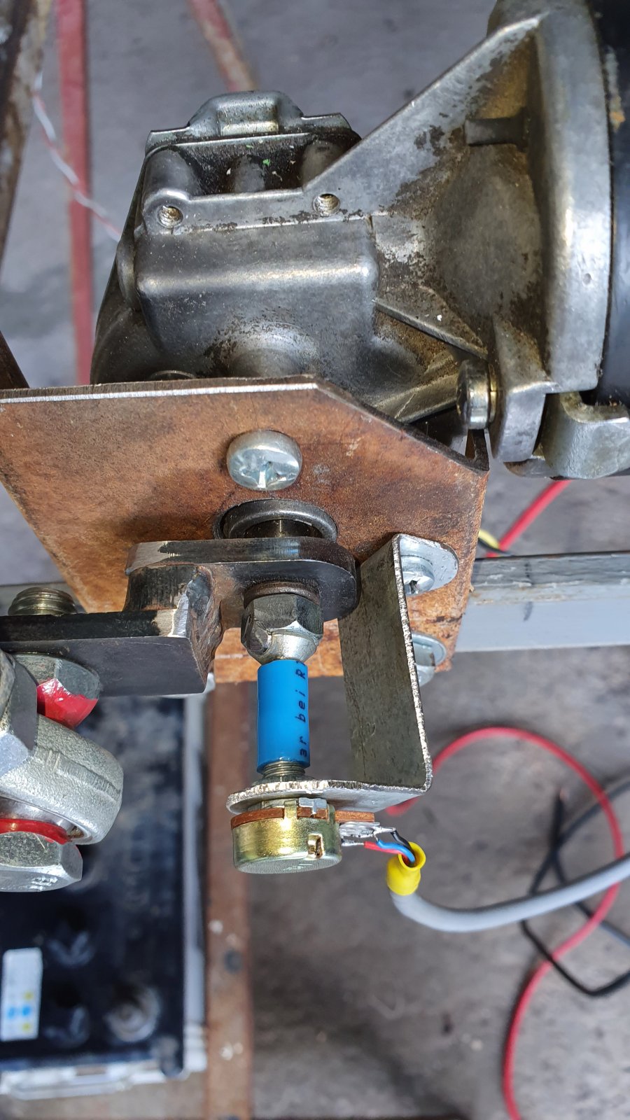

    Today I'll set the parameters of smc3, I felt that one of the motor was a bit slower on reverse.
    But they look fast and powerful without a major load yet.

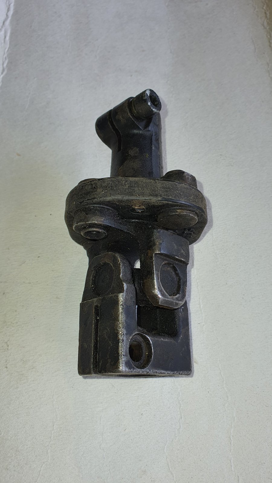

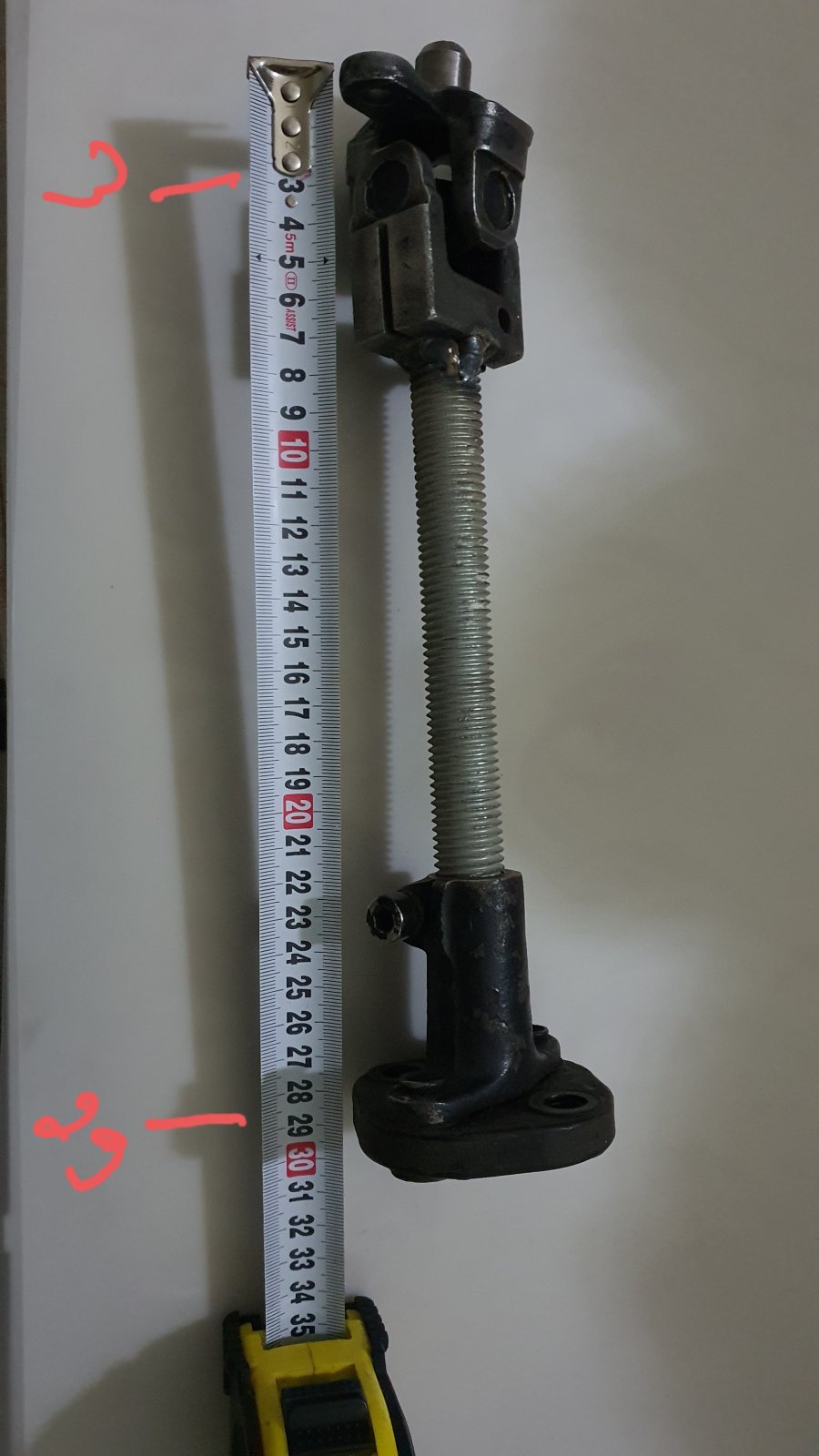

    Reinforced the u joint and motor holders.
    And did more testing and tweaking.

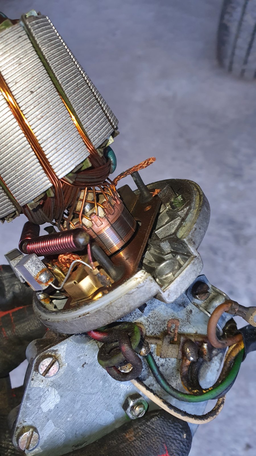

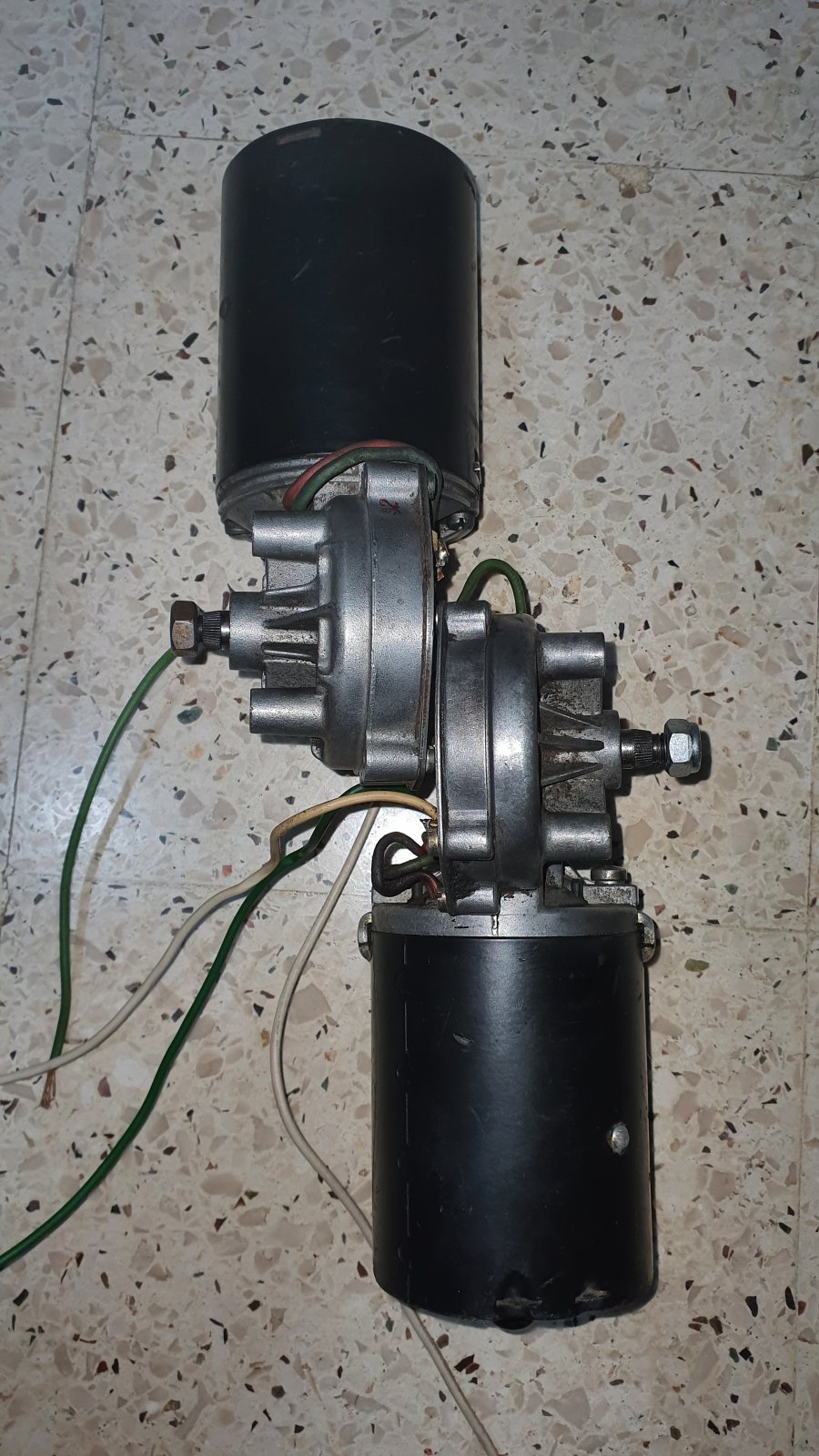

    Using 70/80 mercedes 12v wipers.
    I was skeptical, but I spent more than 2 hours playing LFS without too much heat.
    And I could crank it a bit more.
    Also a 100ah battery that couldn't crank the pickup anymore.

    I will try to use 10amps fuse for each one, if they break, we will know peak current. I'm using 20amps fuses without problems.

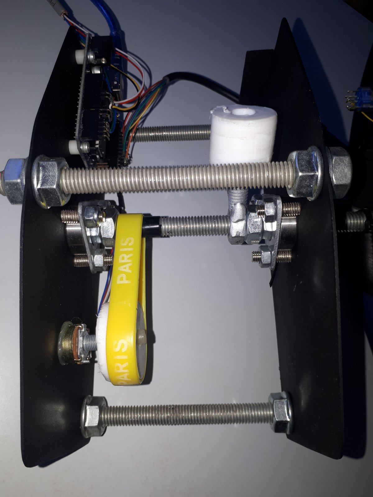

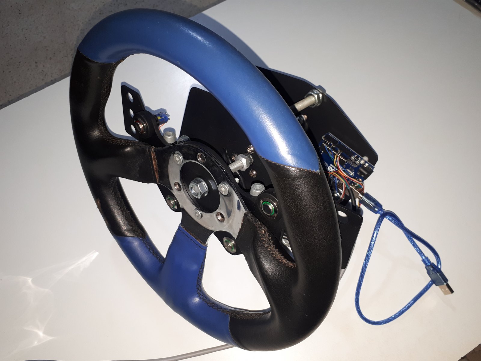

    This is my current steering and pedal setup. It's working good but not enough. So I started gathering resources for a proper diy ffb.

    I would recommend to use leonardo boards for these kits because it's easier and way more versatile.

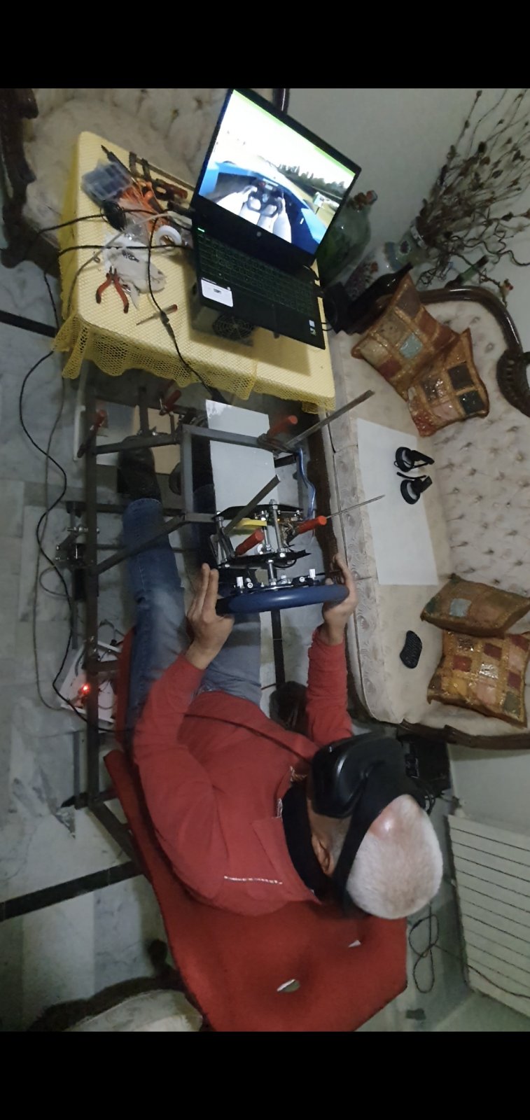

    Today i got a used but immaculate lenovo VR headet and joystick, and managed to get it working with Live For Speed.
    NO WORD COULD DESCRIBE THE EXPERIENCE!
