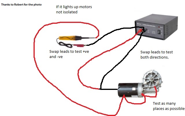

    Hi guys, can anyone recommend a certain wiper motor? Or from a certain manufacturer?
  2. RacingMat
    2,237
    21,020Coins
    Have a look on NIDEC motors in my signature: cheap 35€, good torque, irreversible and already ground isolated!
    Mind that any other wiper has to be ground isolated!
  3. bsft
    12v for sure, large passenger car, earth isolate it , no specific model
    After that , look into big worm gear motors like this http://www.ebay.ca/itm/GEAR-MOTOR-1...ILLCRAB-POT-PULLFEED-150160-rpm-/370915744975
    http://www.motiondynamics.com.au/worm-drive-motor-12v-24v-200w-180-rpm-20nm-torque.html 12v version
    And i suggest the Pololu JRK http://www.pololu.com/product/1393/ , it will run 14v at 30 amps continuous all day with heat sink on the big chip and fan cooling.
    Some of us run the jrks at 40 amps peak, no problem.
  4. bsft
    Irreversible is no good as we reverse the motors and you may end up chewing gearing out for the sake of holding the sim steady when all power is off.

  7. RacingMat
    2,237
    21,020Coins
    Golf wiper motors I tested were too weak... Go for monospace, bus or truck models ;-)

  9. bsft
    If you get something that is not designed to be reversed and you try to reverse it, it will either break or slow significantly on direction change. Bad idea, not recommended by me.
    The idea of irreversible is for aesthetic reasons, people want the sim to stay at a centre point when its off, not have it slump down.
    Without going into to much detail, generally wipers are a bit stiff anyway so they will hold a bit when power is off. irreversible is not recommended.
    And avoid buying something that is 24v and you only running 12v through it. Half the speed, half the torque. Use a 12v motor for 12v, or a 24v motor for 24v. You get the best response that way.

  11. RacingMat
    2,237
    21,020Coins
    Sorry, but "irreversible" doesn't mean "can't be reversed".
    Irreversibility means that under (normal) load and without power supply, the gearmotor won't turn. It's due to angle of gear and some other factors...
    Irreversible gearmotor are meant to go both ways. It does not meant that they are limited to one way.
    And I agree that multiple and frequent reverse stresses are the worst possible treatment for gearmotor... so a really good motor is required for racing sim!
    Nota: for information, wipermotors when mounted on vehicles, are turning in a single way and the alternate movement is given by rods system.

  14. eaorobbie
    20,463Coins
    +1,686 / 23 / -2
    Basically all I can recommend is that you check the internal gearing if possible, most are nylon, after a couple of weeks with a decent racing profile the normally metal worm gear chews out the plastic gear badly. At slow speed this might not be so evident, wipers are a good option to give it a go, but can t recommend using them for sometime , my first ones which had steel internals eventually failed in 60 hrs.
    Beware running a 24v motor (bus/truck) is not a good thing for them, they are designed for 24v not 12v. Plus speeds and torque more than halfs.
    Dont be discouraged in using them , if you take the right electrical precautions and balance you sim properly they will last long enough to play, but I tend to thrash my sim daily for a couple of hours at a time, and I do set my profiles to be quite harsh, if i hit a wall i want it to just about toss me out of the seat. You can always upgrade later, here in Australia the only new type wiper I could find were alot dearer than the motiondynamic units. Not the same in other country thou.
