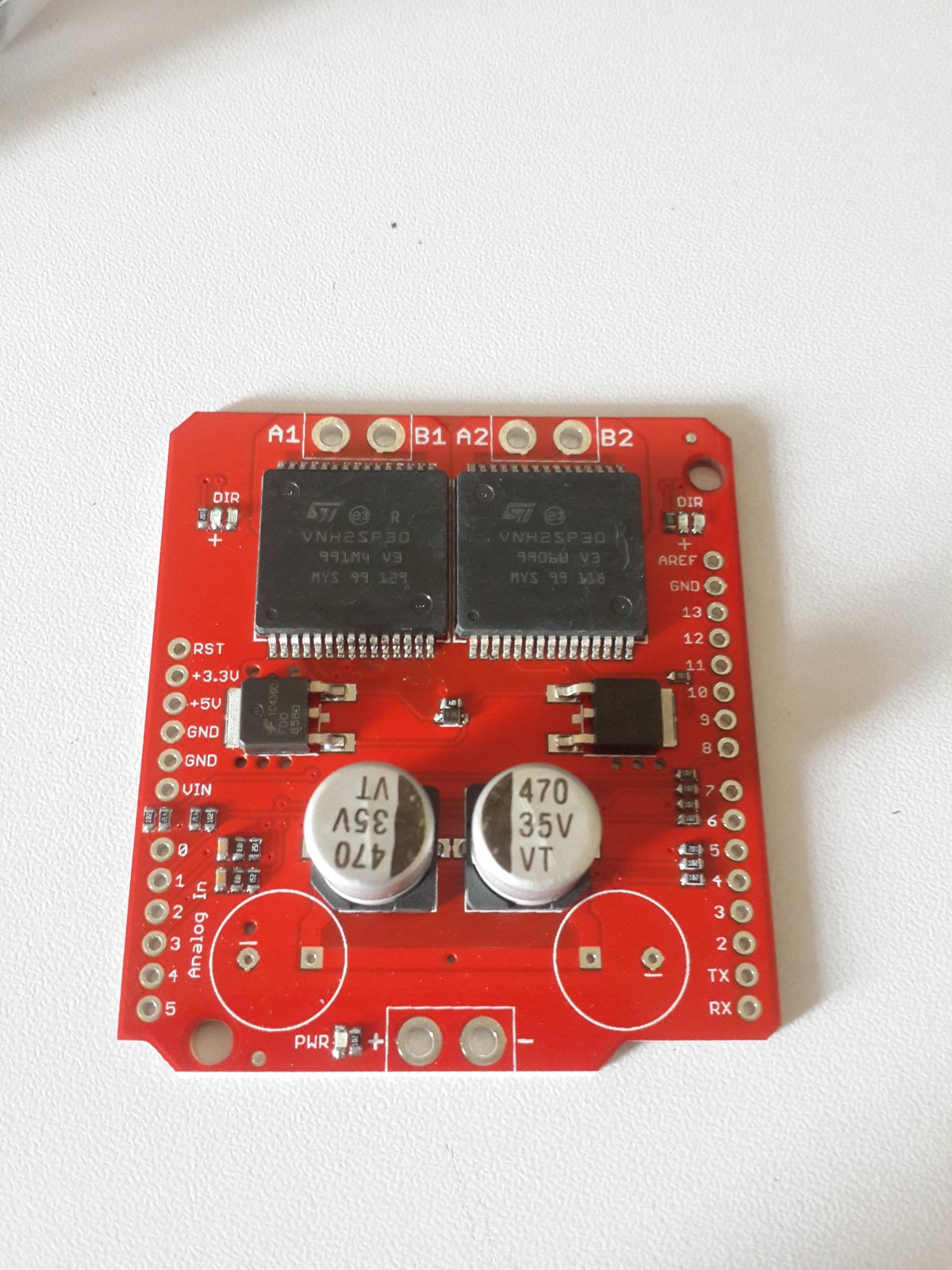

    i have ordered monster motor board 2pcs (1 for backup or for each individual motor)
    Link to the shop : http://www.dx.com/p/monster-moto-shield ... GPOeBt95pg

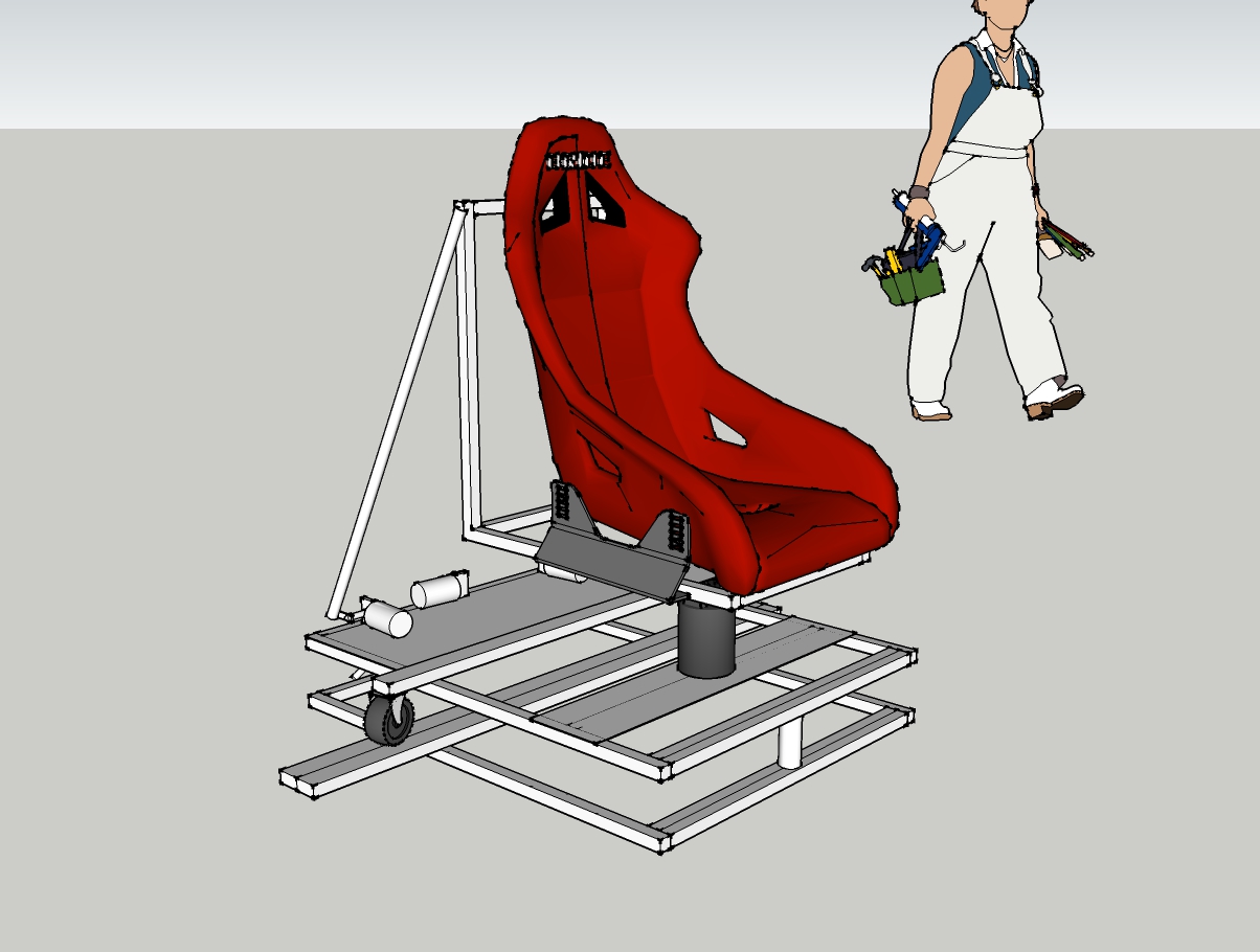

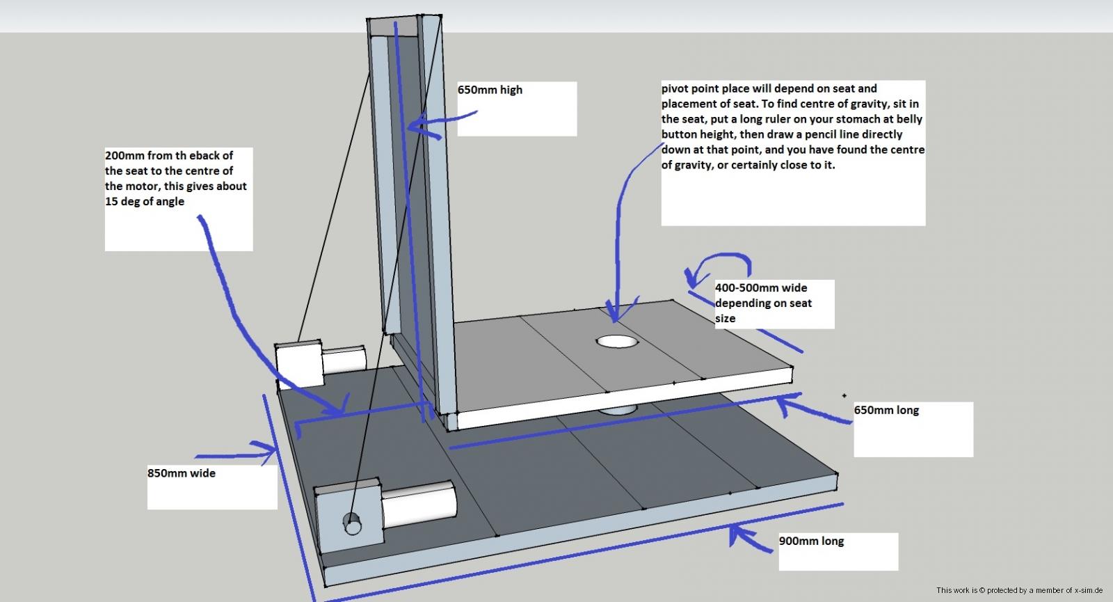

    instead going for F1 seat position..i choose GT seating posing..less headache.. [​IMG] ..

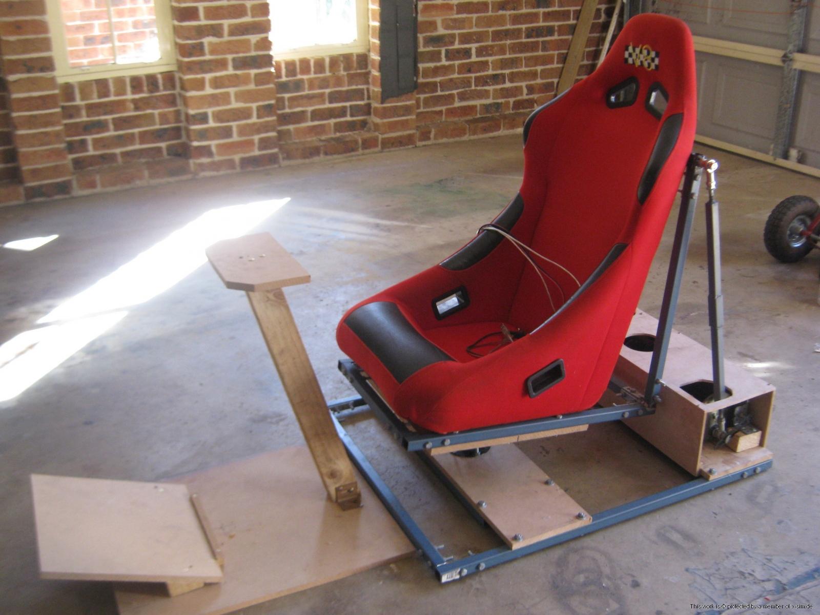

    i will be using the measurement from motiondave (thanks to him!!..i read somewhere in this forum about those measurement) and might be adjusting a little bit
    So this a basic measurement that im going to use
    Photo credit to motiondave
    this is his final build using the measurement (i supposed)
    photo credit to motiondave
    instead of using screws and bracket..i decided to weld all the joint together..i already sent the design to welder shop..so wanting them to quote me price..

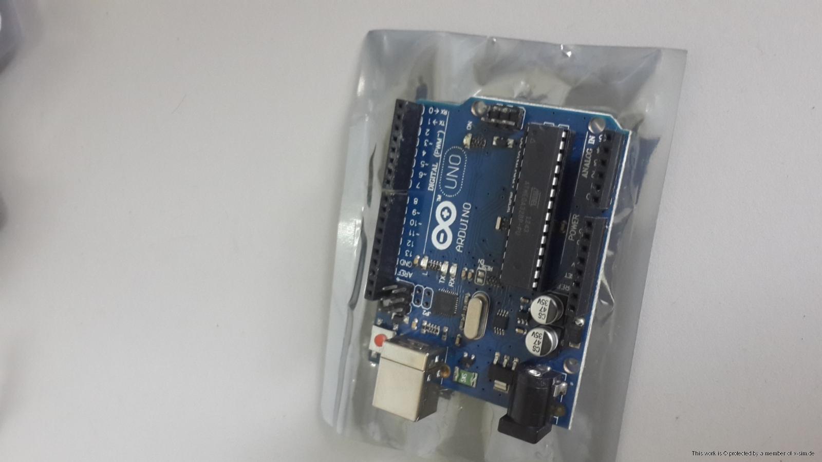

    and owh yes!...my arduino UNO board is arrived!!!
    i got it here : http://www.dx.com/p/uno-r3-atmega16u2-d ... GXvUht97cs
    its a clone arduino Uno..what the heck..look same to me..so im going to use it

    2/1/2017
    Happy new year X-simulator!!!

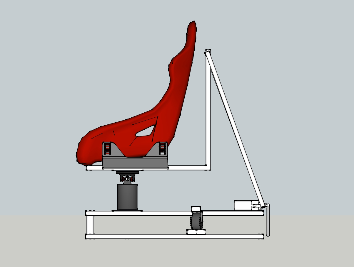

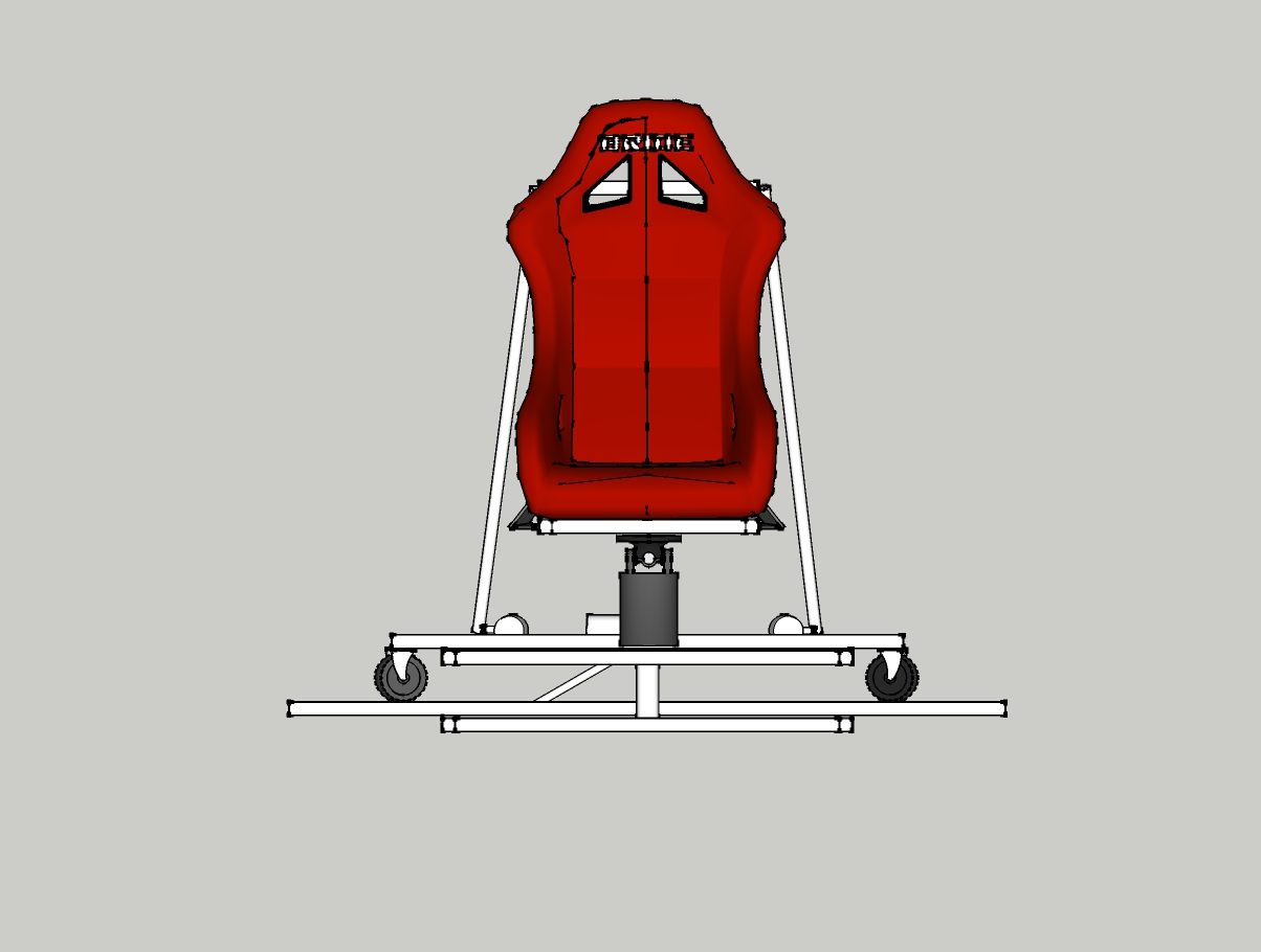

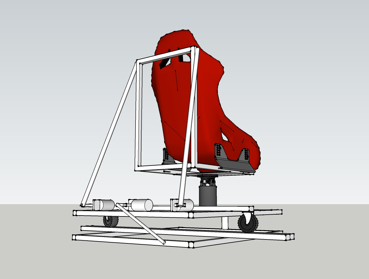

    so today i have complete a design for my project..using google sketch up..take whole day to finish it!
    Please let me know your opinion and idea..

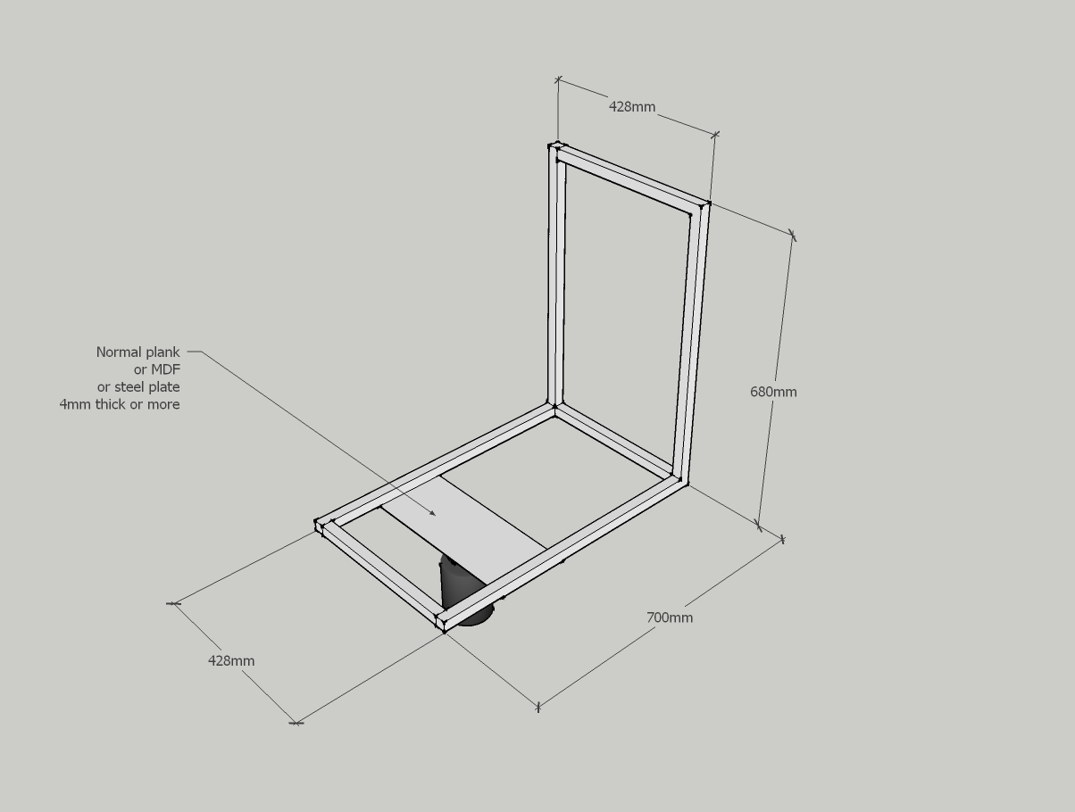

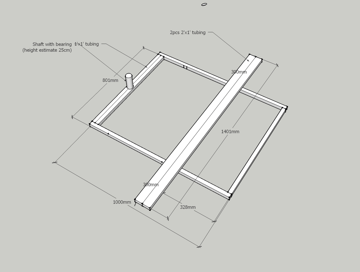

    this is my detailed measurement for traction loss and seat mover

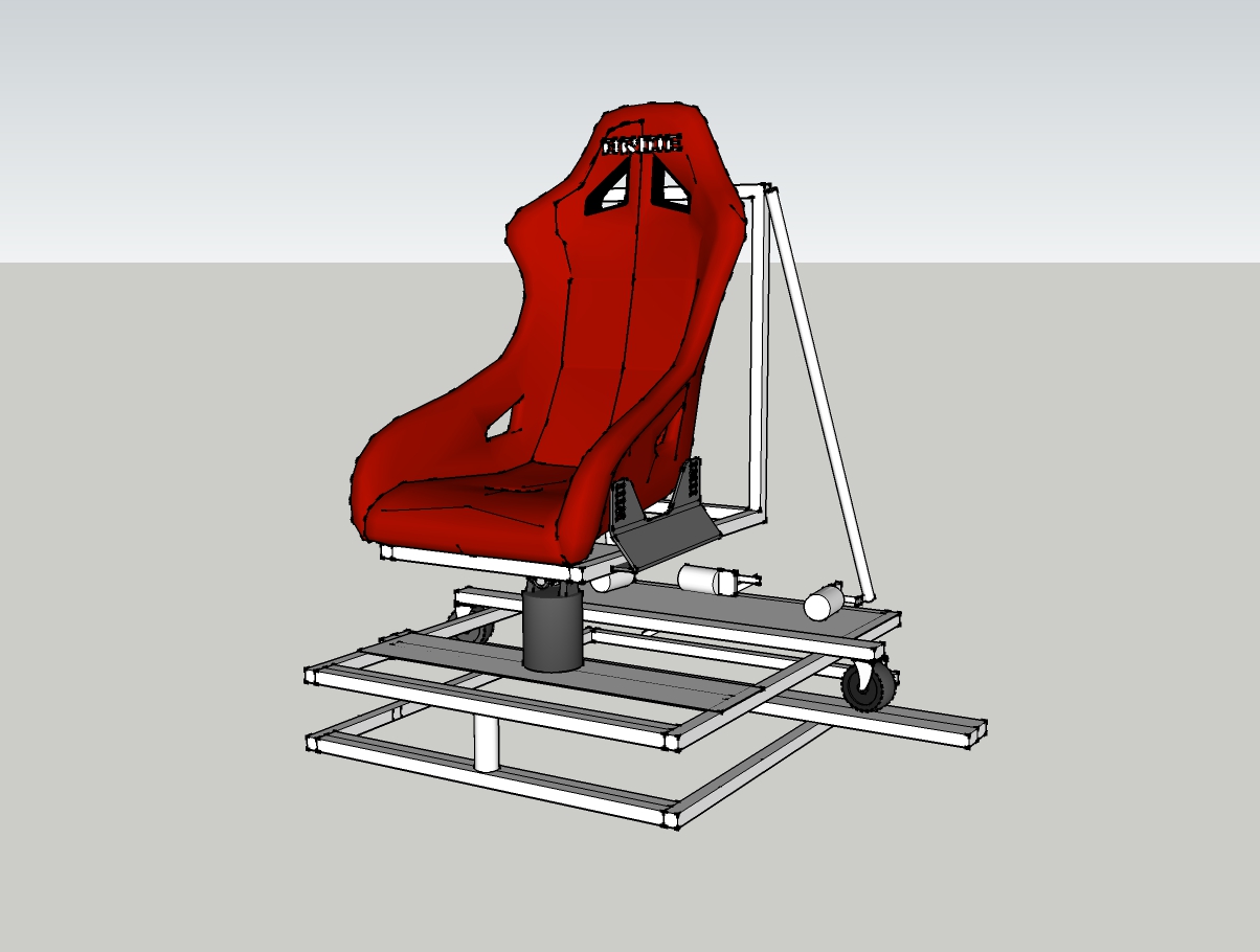

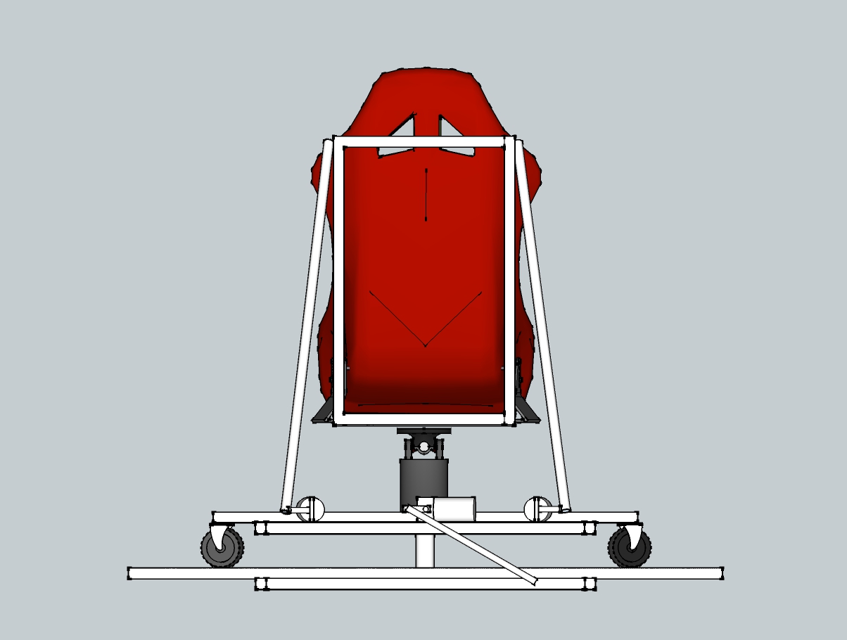

    Final product (if nothing to change)
    back.jpg Front.jpg Overall back.jpg Overall front.jpg overall.jpg Side.jpg Top.jpg
    Im not sure if i want to proceed using square tubing or going for profile aluminium 2020. I dont have exact measurement for front bearing (lazy susan or custom bearing with shaft) and U-joint..
  10. Brett Horton
    Brett Horton Active Member
    Aug 18, 2016
    310
    Program Manager / Pilot
    Tampa FL
    118Coins
    +202 / 2 / -0
    I would decrease the angle of the traction loss motor to the linkage attachment point. Lower the motor a bit. you will lose some potential movement due to linkage geometry.
  11. lilted86
    lilted86 Member
    Dec 30, 2016
    87
    Malaysia
    489Coins
    +20 / 0 / -0
    shall i move the traction motor beneathe the seat mover?..plus my estimation is only 25mm for traction loss front bearing length
  12. Brett Horton
    Aug 18, 2016
    310
    Tampa FL
    118Coins
    +202 / 2 / -0
    Whatever needed to reduce the angle. You always want to setup your initial rods / linkages at 90 degrees if you are trying to accomplish equal movement both directions (we are)
    You could rotate the traction loss motor 90 degrees down and accomplish this quite easily.

    5/1/2017

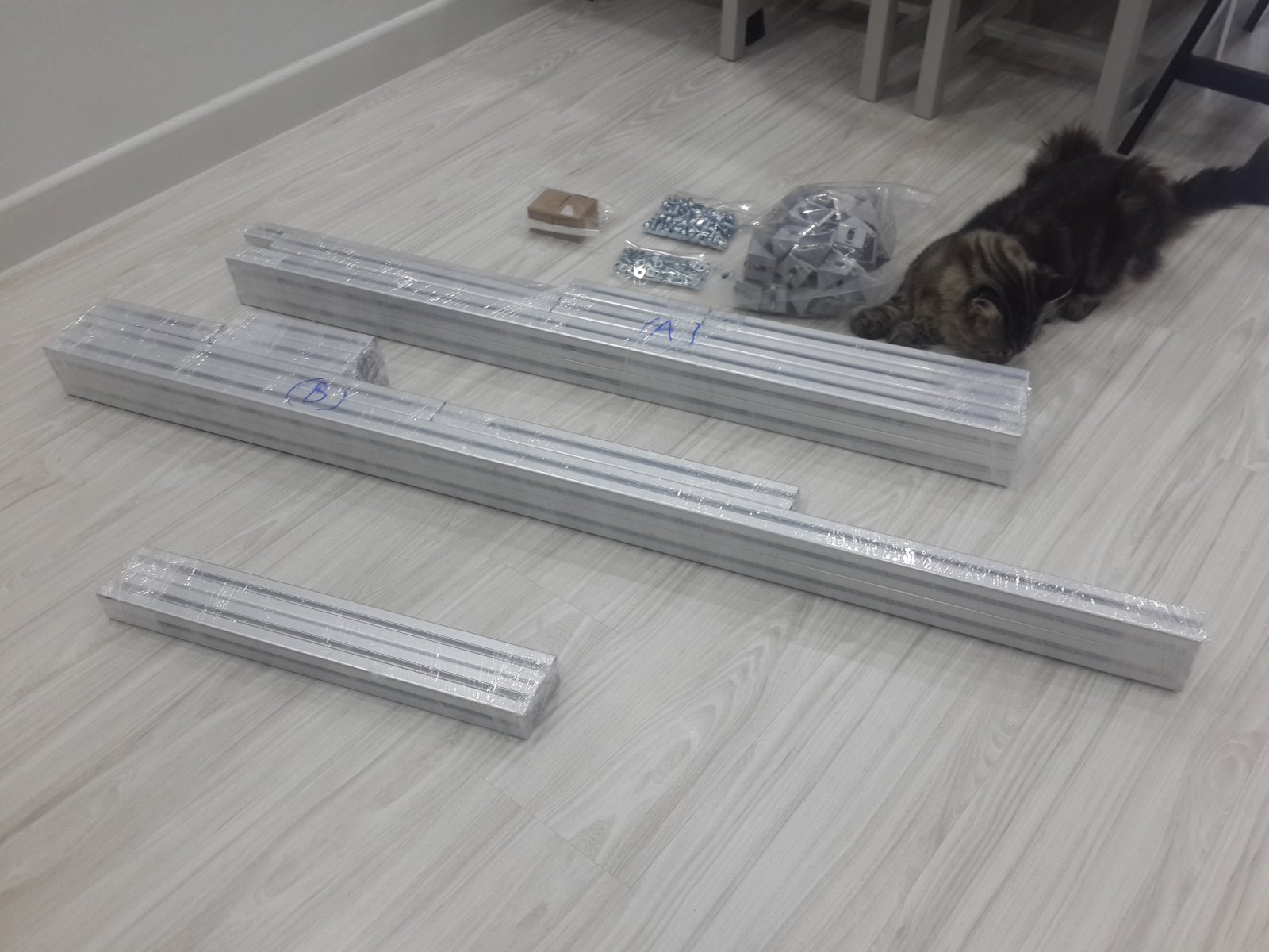

    just a minor update..i have decided to choose aluminium profile extrusion 2020 as the material for this project..yes 2020 is a little bit small.. but im very positive that this tubing is more reliable the steel tubing with welding.
    and for the front traction loss bearing...i have found my used bearing clutch from my old car...its height is around 3cm and 7cm wide...able to withstand so much force as its main function is to push and disengage clutch plate from flywheel..
    so next is to do some cutting and remeasurement..
  15. Nick Moxley
    17,056Coins
    +2,506 / 30 / -2
    Distance from TL pivot isn't exactly ideal. Tho i can tell your going for as small of foot print as possible....some thing's like this will have to be forgiven...Bearing looks a tad overkill, but if you got it for Free, Who cares....just make it work.

    yup i get it for free...and what do you mean by distance from TL..sorry that my english is not my native language..
  17. Nick Moxley
    17,056Coins
    +2,506 / 30 / -2
    Think to yourself.....where does a Real car pivot from in a Traction loss moment ? Hopefully that should help explain what im saying.
  18. lilted86
    lilted86 Member
    Dec 30, 2016
    87
    Malaysia
    489Coins
    +20 / 0 / -0
    aah..okey..i understand..will make some adjustment later..but i get what you mean @Nick Moxley ..thanks

    So today my monster moto controller has arrive..i ordered 2 unit but i only receive 1 piece..going to check with the supplier...
    Meanwhile i will procedd with the seat mover until i receive another unit for traction control.
    Cant wait to complete it!!!
  20. Lorien31
    Lorien31 Member Gold Contributor
    Aug 5, 2015
    32
    IT System Specialist
    140Coins
    +10 / 0 / -0
    You should test those Monster Motos right away, because a lot of the clones are faulty. Not that you have to wait for replacements or not get a refund.
