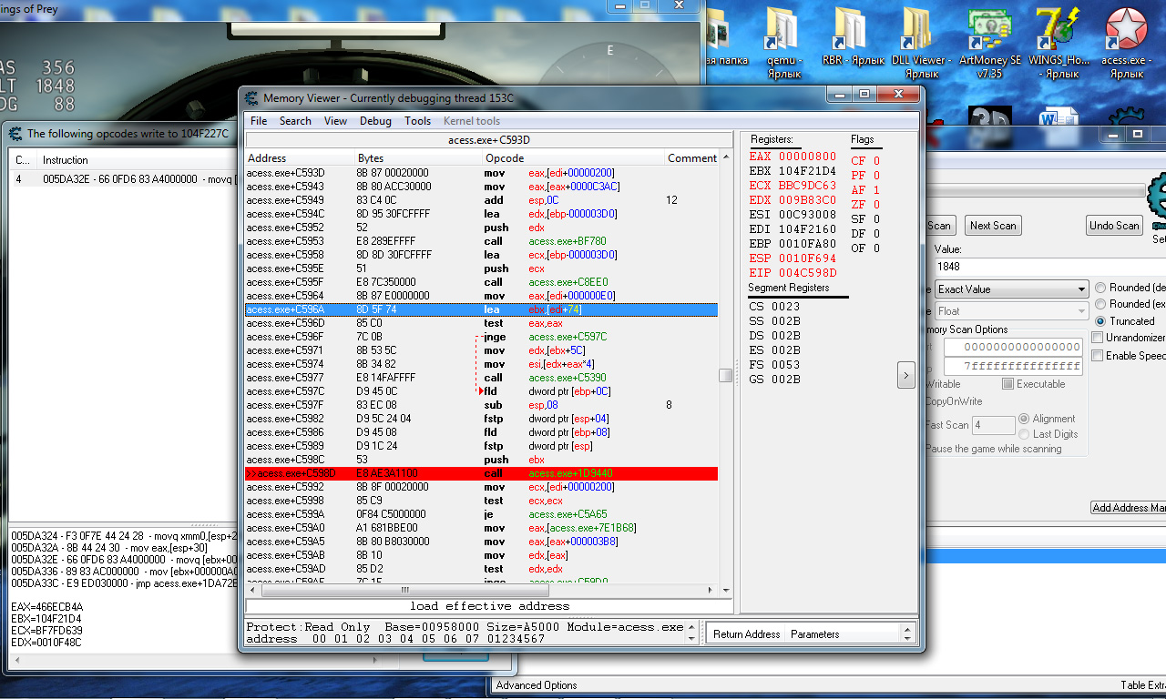

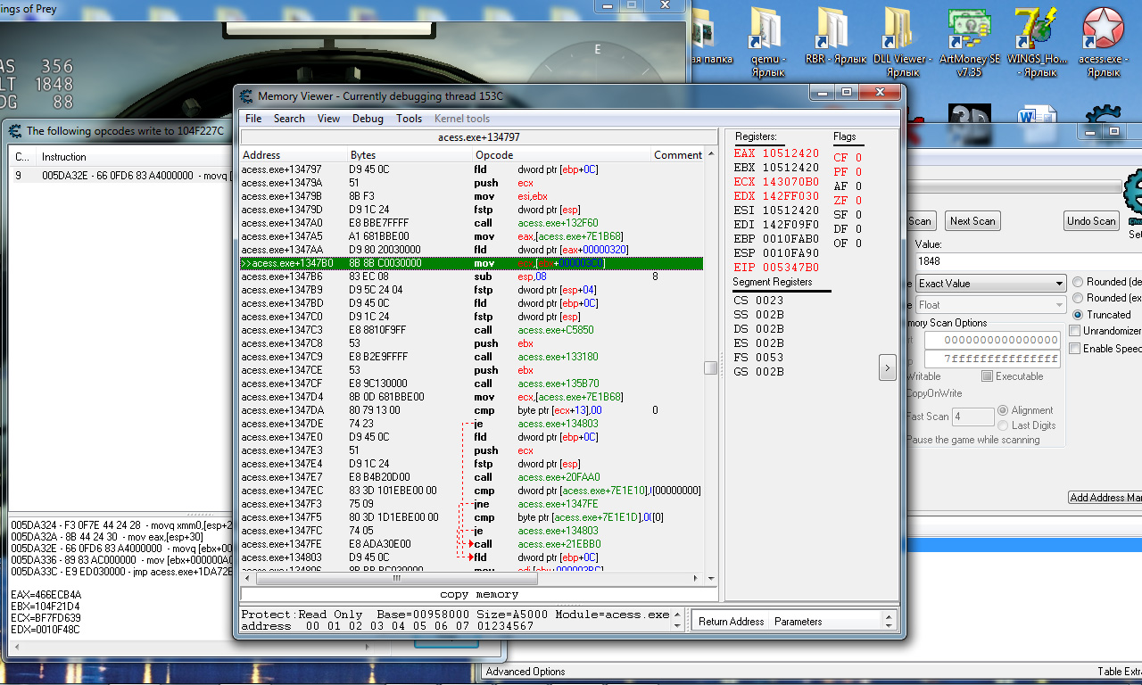

    How to find sim data in the game? “Wings of Prey” search example.
    This is my first attempt of searching data in the game. And I want to share my experience of searching on the example of "Wings of Prey" (v. 1.0.5.1). Step by step.
    I want to warn that the most difficult part is a search for adequate data values in a game memory. I had to do it by trial and error, eliminating a large number of "wrong" data. For example - addresses of many variables changed when the viewpoint changes in the game (depending on whether - whether the camera is in the cockpit or out).
    As you know - in most cases, addresses of parameters in game's memory are not constants. But in any case there is a pointer to the data area. And address of this pointer must be fixed in the memory process. And our task is to find this base address. Let's get started.
    All you need for beginning:
    - Basic knowledge of assembly language for Intel processors. (http://en.wikipedia.org/wiki/Assembly_language#Assembler)
    - Program “CheatEngine” (http://www.cheatengine.org/).
    - And a lot of patience, of course…

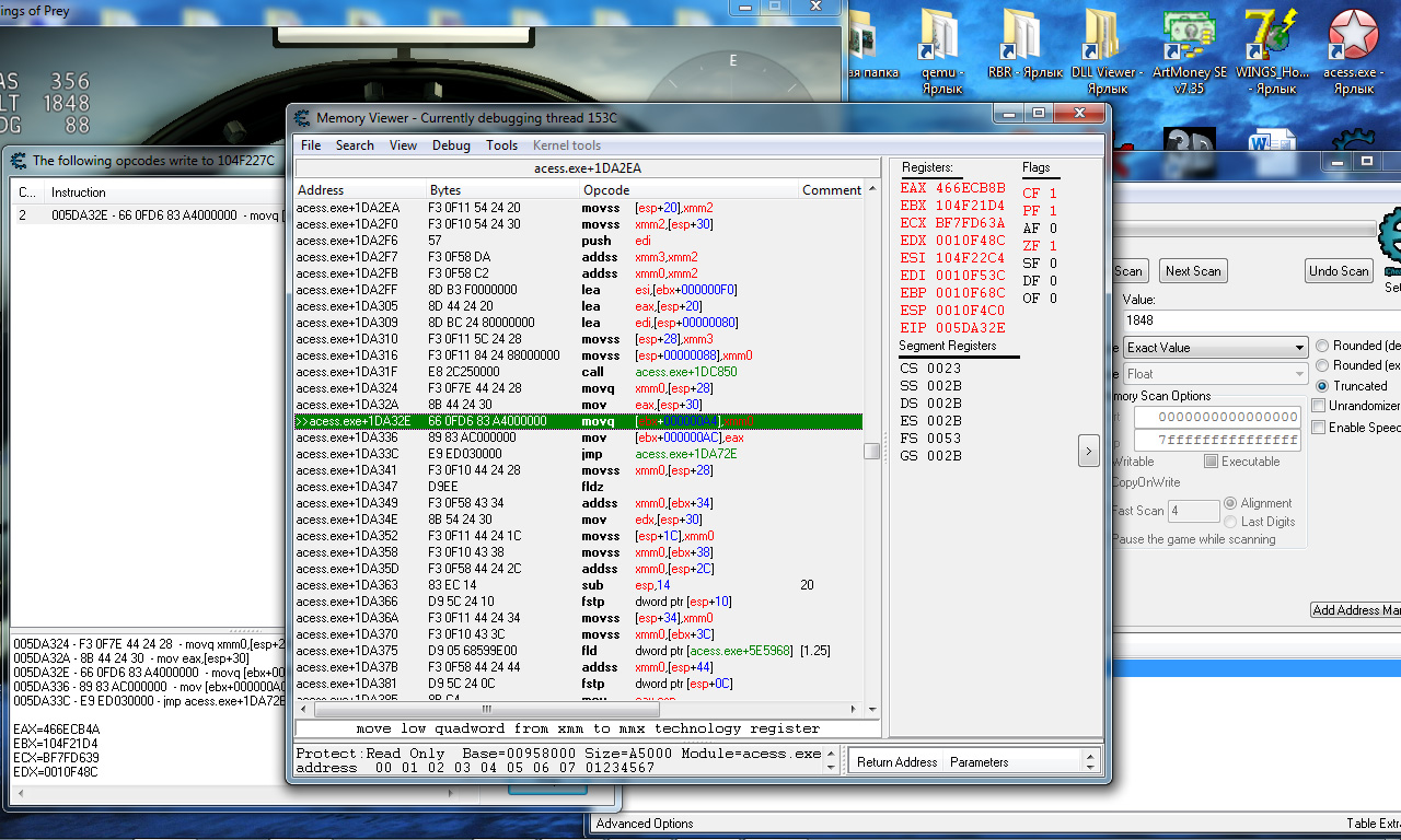

    When the game is running, run CheatEngine and connect it to process "acess.exe" (this is a main file of "Wings of Prey")
    we’ll search the memory address of “altitude”, because we can see its value on the game’s screen. Its value is 1848. With CheatEngine we found a lot of this numbers in the memory. After many unsuccessful attempts, we decided to stay at the address H104F227C. And found code, which write data to this address. It must be only one address, like on following screenshot.
    The next step – open the Memory Viewer window in CheatEngine (press button “Show disassembler”) and toggle breakpoint on opcode, which write data to address H104F227C. As you can see this opcode is
    movq [ebx+000000A4],xmm0
    It mean, that destination address stored in ebx register ( ebx = H104f21D4 ).
    And H104f21D4 +H000000A4 give us our destination address H104F227C
    As you may have guessed, all our next steps will be made to find a place from where this number puts to ebx register. There are a lot of ways to search. The most effective to "Execute until return” (Shift+F8) from current subprogram, and search the place where opcode modified the destination register.

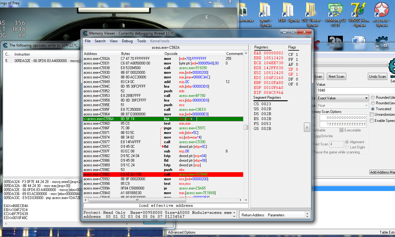

    On the next screenshot you can see, that we found the opcode, where register ebx is modified. Remember that all numbers in HEX format.
    lea ebx,[edi+74]
    It means that next point to search is edi register which contains value H104F2160.
    Step by step… Step by step…
    Yes, next we found the opcode, where register edi is modified.
    mov edi,ecx
    And we see what we are write, because ecx contains number H104F2160.
    Die nächste Bushaltestelle… Ups, sorry fellas, I three month works in Osnabruk and this words imprinted in my memory…
    This is our next stop and opcode, which modified ecx
    mov ecx,[ebx+000003C0]
    In this place ebx contains value H10512420.
    Next steps we will pass without screenshots. And quite more quickly, because destination is near
    acess.exe+13451A - mov ebx,[ebp+08]
    This opcode is very similar to getting data from the stack upon entry to the subroutine. So we just need to know where the data is placed on the stack? Here is this place:
    acess.exe+135776 - push edi
    acess.exe+135777 - call acess.exe+134510
    Next search point – register edi. We can found next opcode
    acess.exe+135538 - mov edi,[ebp+08]
    But when we try to toggle breakpoint on this opcode, program will not stop on this line. I think it means that this register modified only when program started. And that is exactly what we need. Let's try to find a place in memory where the value may be written to the register. For this we again use search by CheatEngine. We should search value H10512420. And we found this address – H00BE1B68. After many rechecking we can say that this is the address where is the pointer to searching data.
    SUMMARY:
    We found main (static) memory address, from which we can read the variable base adress.
    Searching history:
    acess.exe+1DA32E – movq [ebx+000000A4],xmm0 - this opcode write ALTITUDE value to H104F227C
    acess.exe+0C596A – lea ebx,[edi+74] - this opcode write to ebx destination address
    acess.exe+0C586B – mov edi,ecx - this opcode write to ebi
    acess.exe+1347B0 – mov ecx,[ebx+000003C0] -this opcode write to ecx (remember offset H3C0)

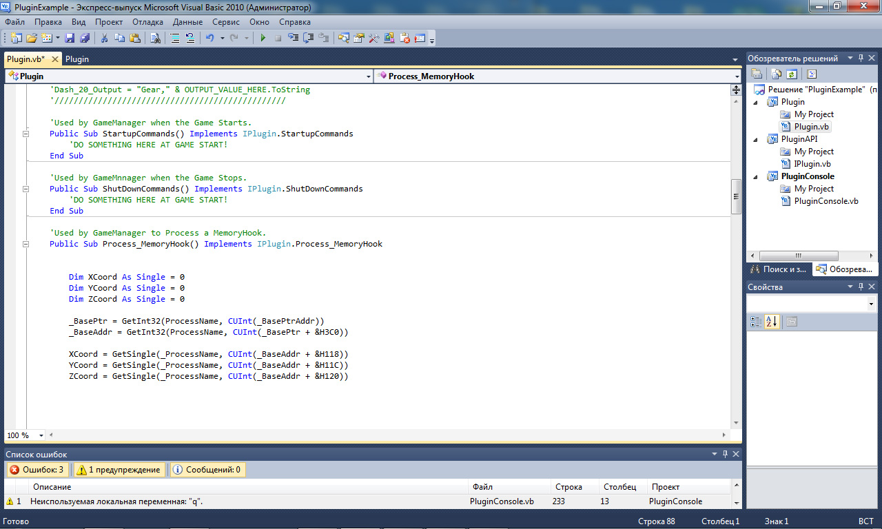

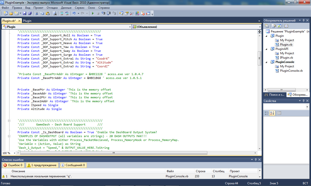

    But how to get access to altitude value in VB application? Step by step ))
    Private Const _BasePtrAddr As UInteger = &HBE1B68 ' acess.exe ver 1.0.5.1
    Private _BasePtr As UInteger 'This is the memory offset
    Private _BaseAddr As UInteger 'This is the memory offset
    ‘First read 4 bytes from our _BasePtrAddr to _BasePtr
    _BasePtr = GetInt32(ProcessName, CUInt(_BasePtrAddr)) 'This read data from H00BE1B68
    ‘Next read 4 bytes from _BasePtr to _BaseAddr (remember offset H3C0 ???)
    _BaseAddr = GetInt32(ProcessName, CUInt(_BasePtr + &H3C0))
    ‘Next read float value from _BaseAddr to Altitude (offset H118 = H0A4 + H074)
    Altitude = GetSingle(_ProcessName, CUInt(_BaseAddr + &H118))
