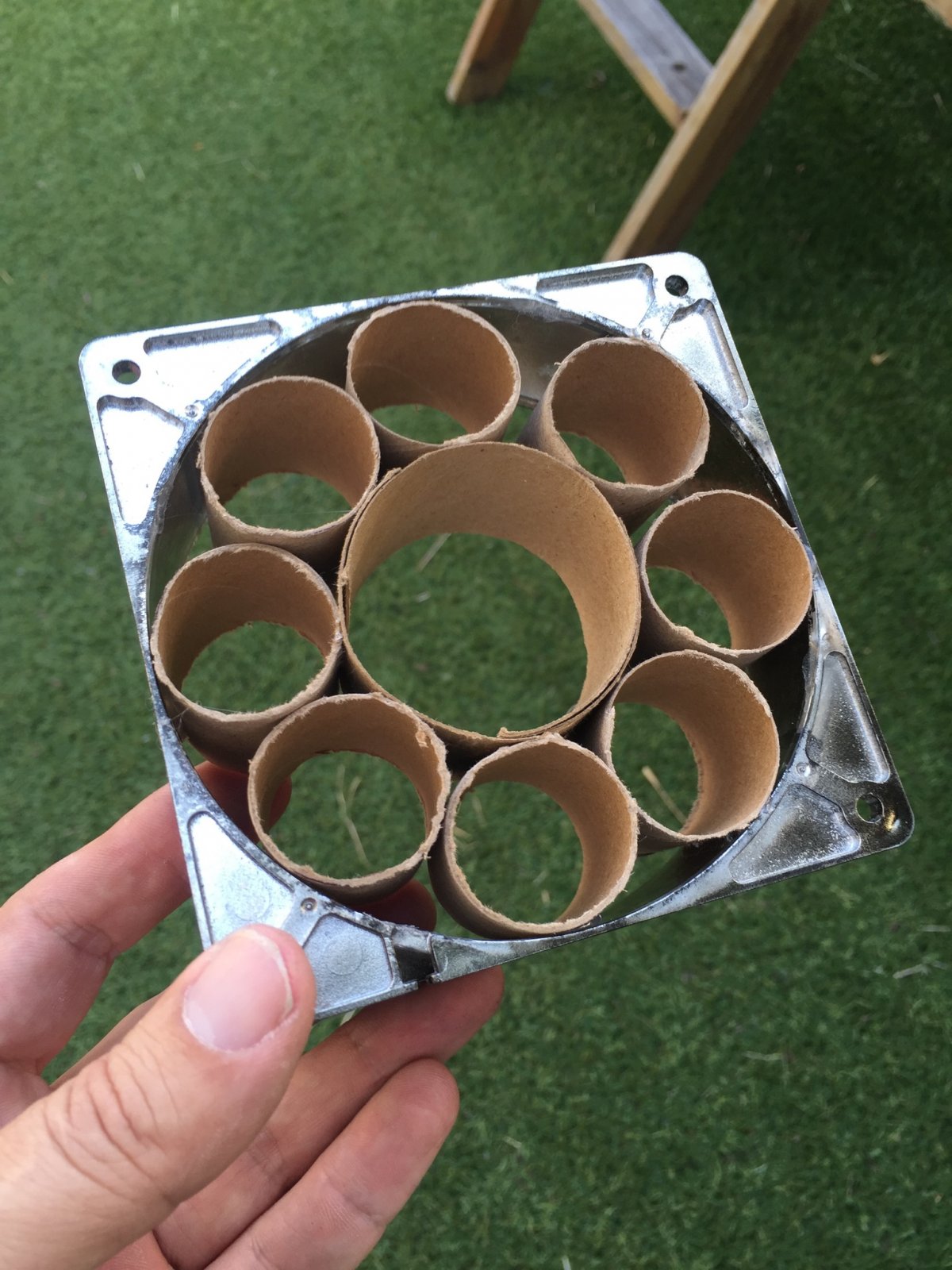

    I did a similar project and wanted to share the flow straighteners that I made. I used the frames from 120mm fans and cardboard tubes. I was shocked at how much better the air flow was. A friend with a 3D printer has offered to help make more professional looking versions but honestly the cardboard prototypes work really well. image.jpeg image.jpg

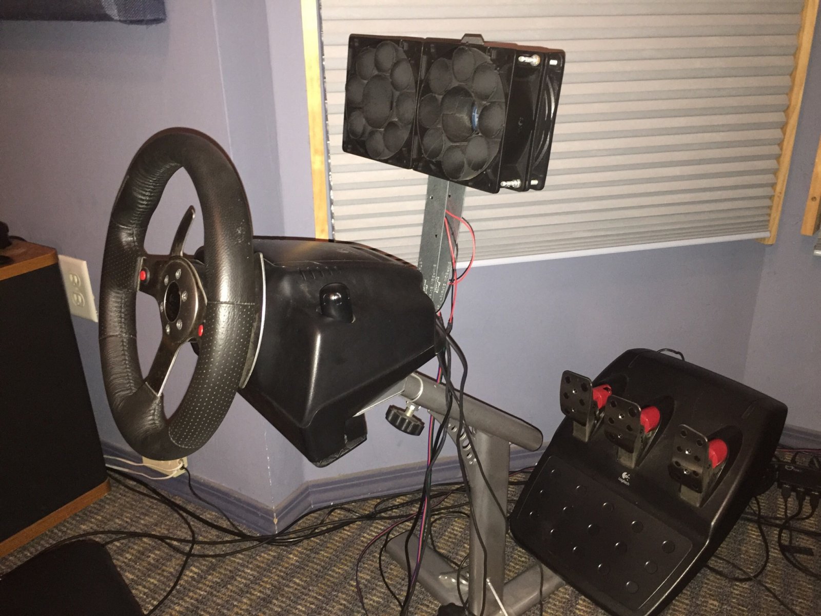

    Mounting
    I bolted the two fans on either side of two steel strips I got from the hardware store. I bent them in such a way that they are flat at the base and slide under the steering wheel mount on my G25. Adjusting the gap between the front and rear strip change how much tension there is between them and although there is certainly still some flex they are pretty sturdy and hold the fans securely.
