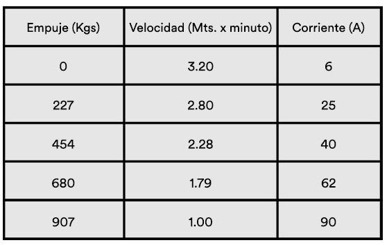

    Thanks, I know, the boat winch motor are usually 300watts and the motors on the planetary winches starts at 750watts, thats why both winches are rated at 2000lbs but the boat winch uses 400:1 and the planetary 153:1 to do the same job. My Doubt is, to go brute force with the 750watts motor, or if the 300watts boat winch motor would do the job fine, as it would be easier to drive.
    Yes, that planetary winches are powerful and it would be perfect if they were a little more silent, changing the grease in the planetary gear doesn't get more silent at all?
    There is a table about amps rating for that winches:

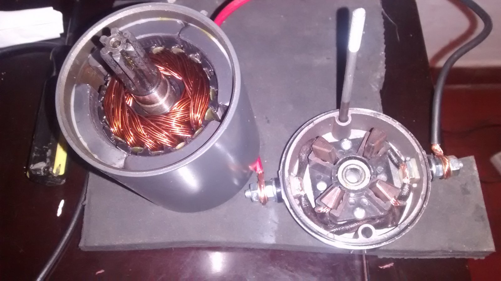

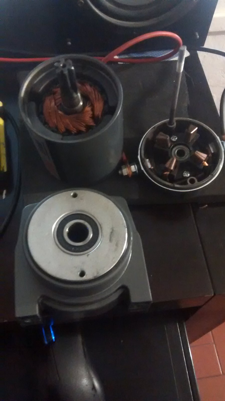

    Well, after waiting almost 10 months, finally the importer got a new batch of winches, and I got 4 for my project, they are the 906lb, 750watts, planetary gear ones.
    My problem is that after disassembling and tested one, it runs at different speed counterclockwise :( Is that normal? I thought that the Chinese ones were all almost the same internally.
    @Pit @Ben V or any other with experience can help?
    Thanks anyway!
  10. Pit
    3,007
    30,516Coins
    +3,098 / 31 / -0
    Almost replied to your PM. Anyway are all winches affected? Or you disassembled and tested only one winch? Probably there is an issue with the motor carbon brushes.

    Just tested one, with the hope that if there is an issue I maybe can switch the rest of them for the 300watts boat winches kind.
