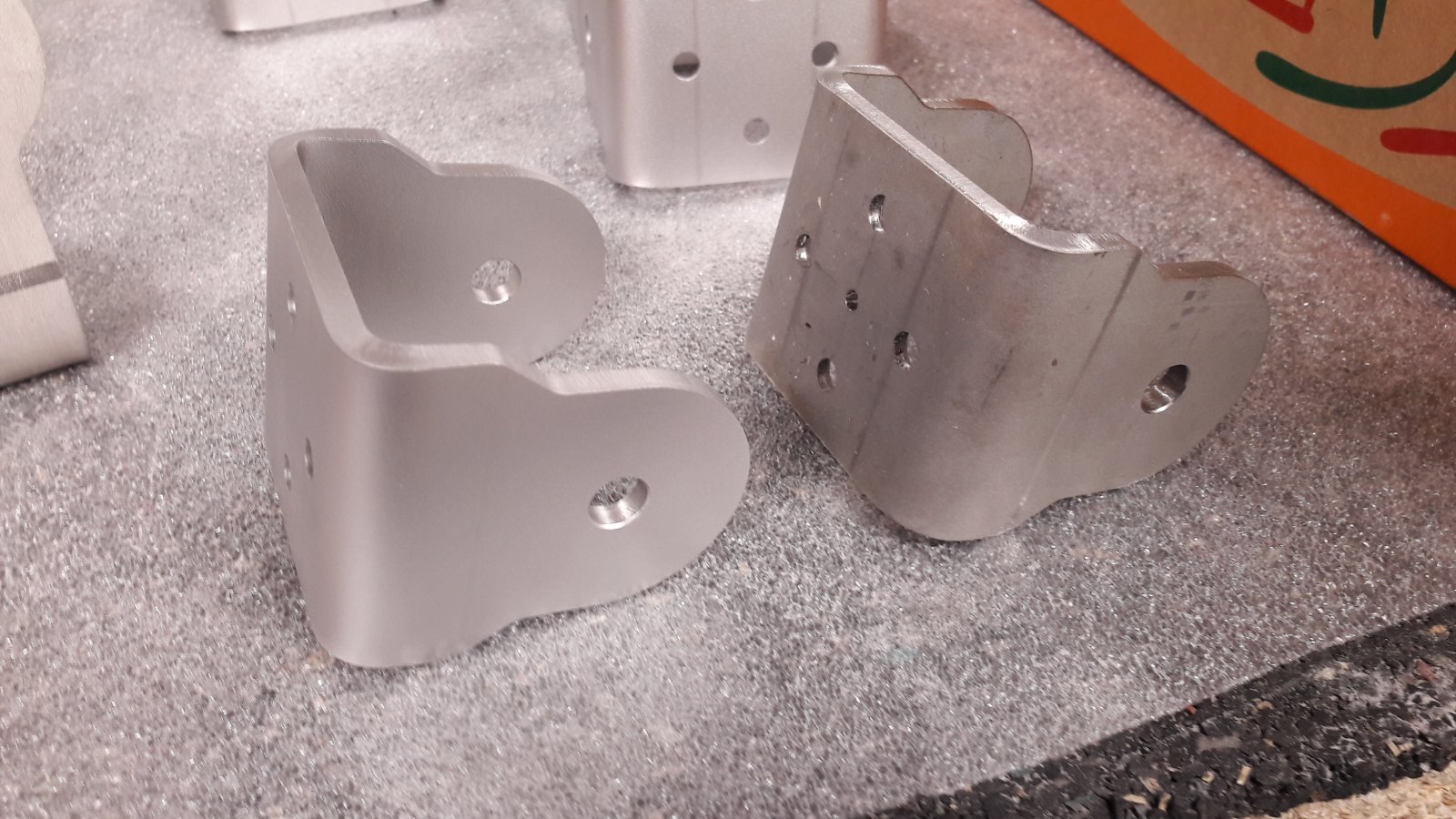

    Hi Wickie.
    Do you have CAD drawings of your universal joints (brackets + POM middle) that you would be willing to share (or sell). I have been through the entire thread and don't seem to any info on them other than where they were made and sandblasted. Thanks either way.
