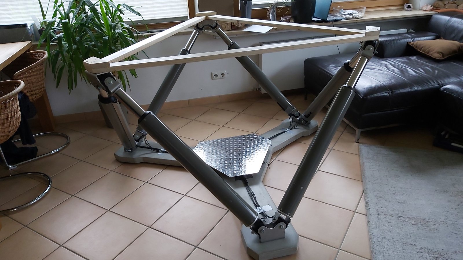

    @PeterW , the rig looks great!
    But I also find the movements to violent, I think you need to tune it down a bit.

    Your rig looks amazing! Did you notice any difference in noise with the yoga mat dampeners?

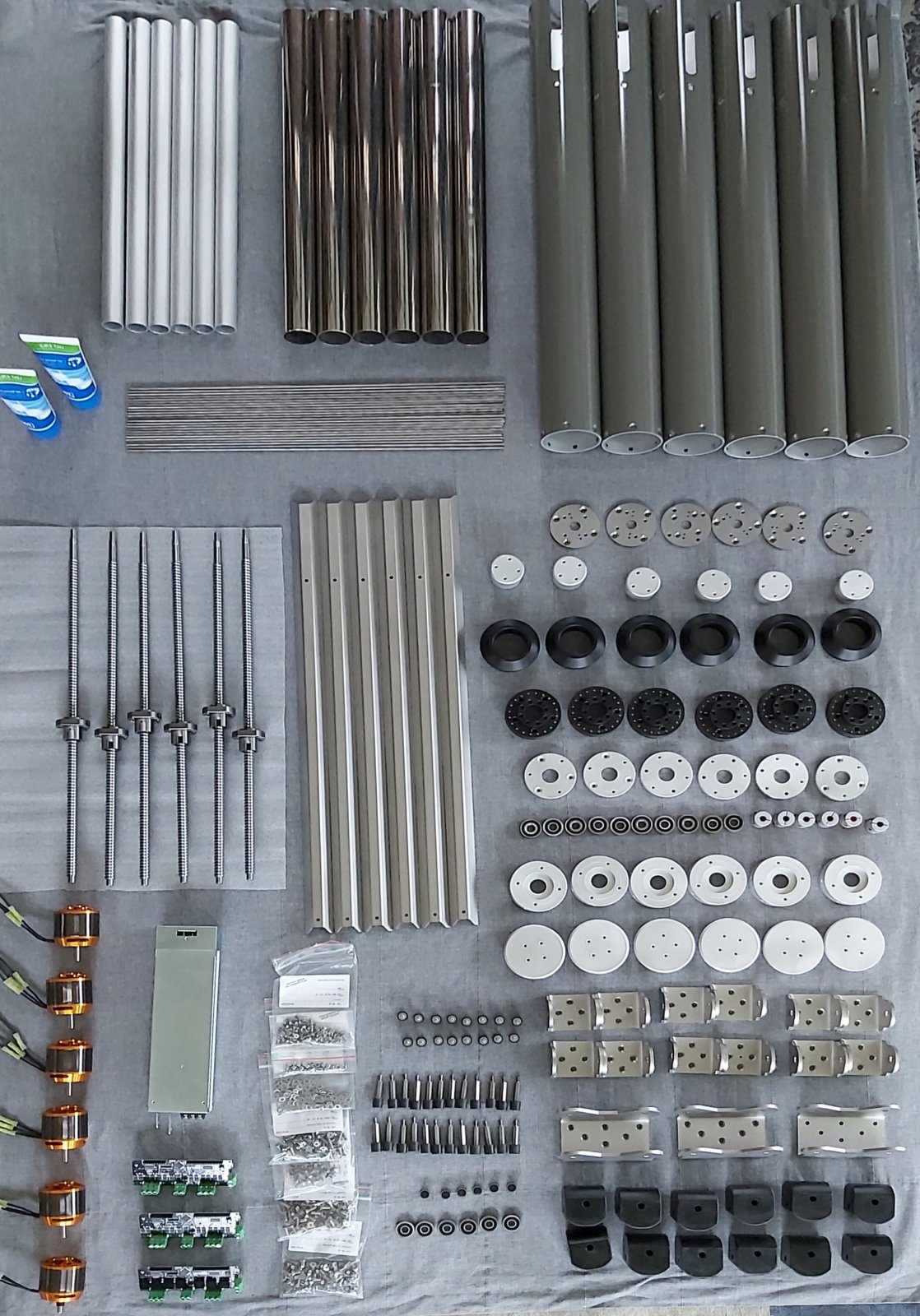

    I need an information about the piston of your linear actuator. Which material did you use for the outside round tube of the piston and which thickness ?
    I would like to use aluminium but it is difficult to have it with the chrome surface.
    I see in bricolage store, that we have also table foot which can be use as a piston :)

    Hi @thefost
    Sorry, but It seems I forgot to give you an answer to you question.
    Yes, the yoga mats do definetly reduce the noise. I would say something about 30% better.
    But not all yoga mats will work as good. In my experience It has to be more rubber than a lightweight foam.

    @PeterW Man i am speechles, you did an amazing job thats a fine craftsmanship, i think you have some hardware construction eperiences.
    i would like to start my project and i am in the data gathering phase and my main issue was determining the required motor as moneywise not all the options are available, but when i saw your thread i can say that 60% i will choose BLDC + Odrive, my other option is a high torque ~12N.m. stepper motor with 1:6 gearing to compensate for the low RPM whilst have a decent torque.
    but i have some enquiries about the Odrive, how you control 3 boards via 1 USB connection is there some how a possibility to connect the boards to each other or you connect them to 3 USB ports
    second i checked Odrive documentation, and wandering if the current command is a one time order, means at the start point of the project i can programme the board to limit the current to motor for safety concerns through out the life span of the sim.
    Thats for now, i would like to say that you inspired me, and appreciate you shared the CAD files but i dont like to copy & paste what you did as you have done all the hard work, and its my turn to do some hard work too, i believe that people like us are born to Innovate, Create and Invent.

    Hi @PeterW
    As you talk about noise, i include as you into the conception of my linear actuator 4 silent bloc between the BLDC motor and the
    Hi @PeterW
    As you talked about noise, i ask me a question :
    I have include as you did, in the conception of my linear actuator, 4 cylinder damper between the motor and the main cylinder part.
    Is there finally an efficient solution to limit vibration of the motor and consequently the noise ?

    Hi Will,
    From the beginning of my project I knew that reducing noise will be an important thing.
    So I followed some different concepts:
    1. Damping the motor vibration
    2. Using more precise ballscrews
    3. Closing the actuator (no open design)
    4. Using a rubber (design;)) mat around the cylinders.
    5. Using strong universal joints to avoid jerky and noisy movements of the rig.
    6. I use a special grease that also reduces noise a little.
    Each application helped a little to reduce the noise. And now I can say in real life, my actuators sound like I want them to sound. You can hear them - of course, but they have a pleasant smooth sound.
    Ah.... somethig more that I can report: one of my actuators still has a cheap chinese ballscrew. And this one is aprox. 30% louder than the other actuators with expensive quality ballscrews......
    Wickie

    Hi @Mzeid
    I love your last sentence....born to Innovate, create and Invent - ....I have no more to add.
    You are wellcome to copy my work and its an honor for me (as long as you dont use it commercially). Its no need to reinvent things only to make them different. Focus on optimising, making it cheaper, printable......
    I am sure you will manage your great project!! But be prepared for a long, expensive and sometimes desperating way (especially with the Odrives ;)).
