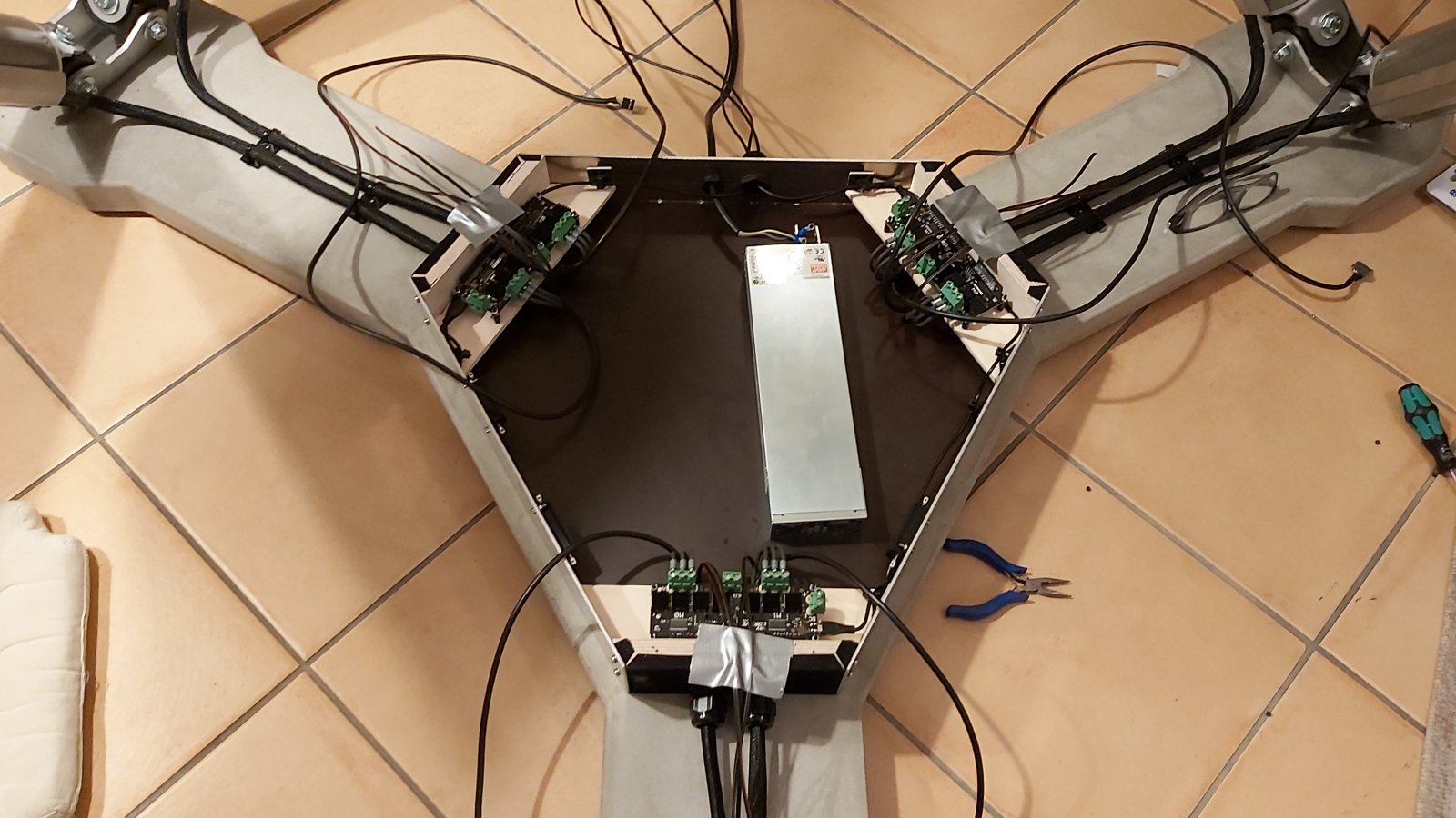

    For me personell, there are lot of reasons for going this way:
    -My motors had cost me only 30,- € per piece from China.
    -The motors are BLDC that have higher power density than common servomotors.
    - My motors fit easily into my 90mm pipe actuator-design.
    - The whole system is very simple (after forgetting the long learning curve with Odrive :)), small and powerful.... Today I went back to my 1,8 kW Meanwell power supply and now as I have a new firmware it seems to be no problem anymore. So my complete system for the whole power train will look like this....
    (Note: here you can see an older picture of my 3 Odrives and the 1,8 kW Meanwell power suply. The short wires from the PSU to the Odrives are not shown in this picture. Thats all!!!! pls. compare this to some other setups)
    - I personally dont prefere to go the easy and known way. I like the adventure to try new things. And the Odrive motor controllers are really new with lot of potential for the future. Although I had lot, lot of setbacks, I still believe in Odrive!
    As a small teaser: Today I made the first LFS rides with my 6dof although lot of things are still not ready....... believe me - the power and precision already blew my mind (although nothing is optimized).
    So for me this all is definitely the right way.
    Unfortunately, I know the Thanos solution too little to be able to make a comparison.
    Wickie

    The picture is an older one, I made some weeks ago - the power resistors are connected now of course ;-)
    Although I made some simple calculations, choosing the Power supply was more a trial and error process. I made my first tests with my Actuator with a extremely small lipo-battery and also with an 12V 4A PSU, that showed me, that the efficiency of the whole system is verry high and the power consumption will not be so high than someone would expect. Based on this experience I bought a 36V , 10A PSU for my prototype and the first load tests (means 360W) . This was perfect for pushing 30 kg at high speed. As I dont expect that all 6 actuators will need the maximum power the same time, I decided to buy a 1800W PSU for all 6 actuators together. This means min. 300W for each. Because of problems with the firmware i thought the power supply was too weak, but with the new firmware i use now, everything works fine with the power supply. For a final opinion it is still too early, but yesterday I let myself be shaken hard for 1 hour and the power supply, the odrives and the motors didn't even get hand-warm. So I am confident but not 100% sure yet. I think in a few weeks I will be sure and if the PSU will be too weak, I go back to the car battery-solution.
    For your final decision regarding the BLDC - way, I would recommend to wait some more weeks until FlyPTś, SilentChills and my 6 DOF is running....

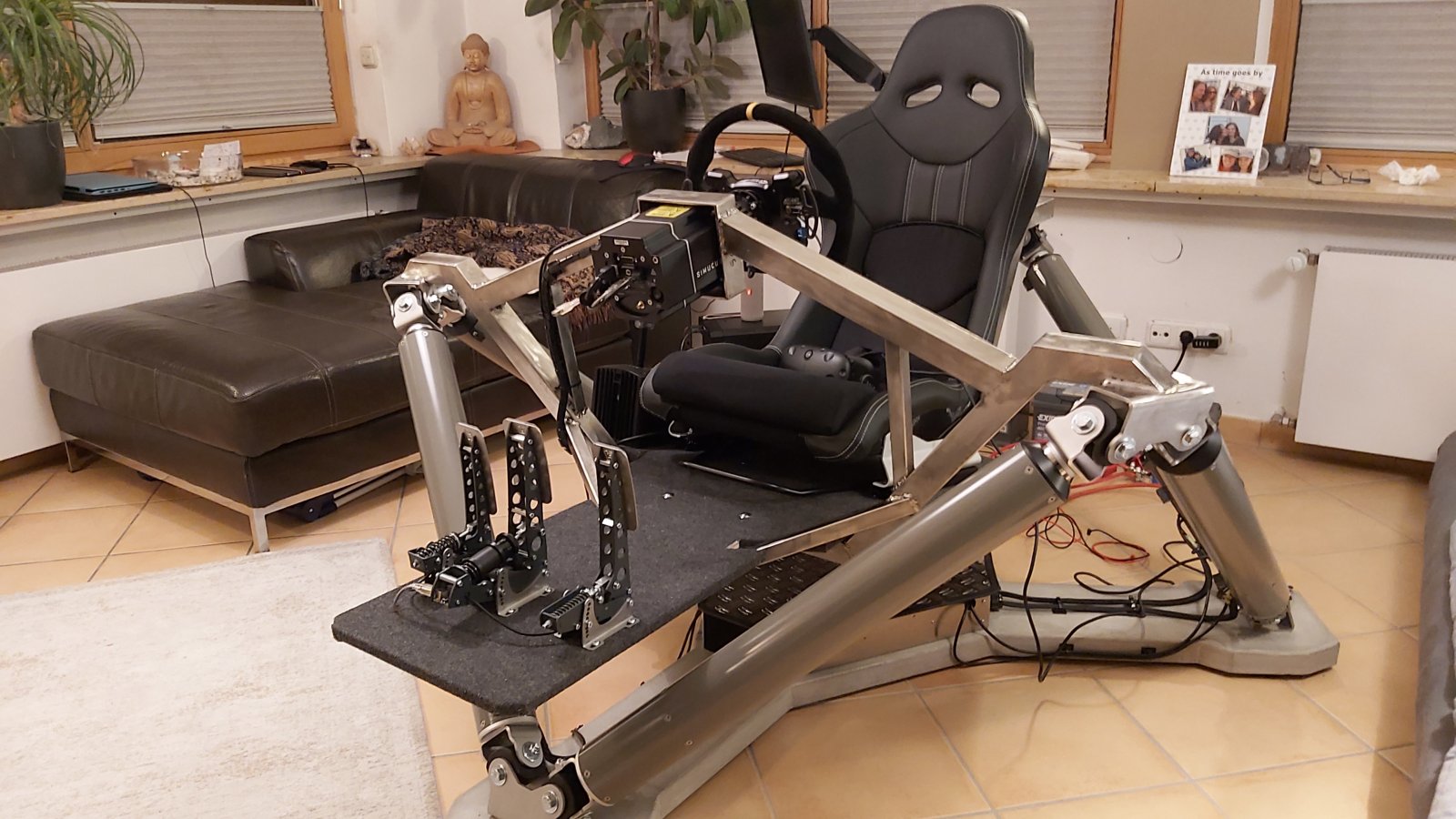

    here is a litle update on my project. The last weeks I didnt have as much time as I wanted to have, so things went on little slow.
    Making the Odrives reliable was a lot of work, but due to help of InsectaTech and SilentChill, now it works really good!
    Today my son and me made the final cable management and the first test drives.....its mindblowing fast, strong and detailed, but we need to understand the mover interface much, much more and need to optimize lot of parameters....feels more like driving a speed boat than driving a car ;)
    I am looking forward to the next mover release that will have some pre settings..
    Wickie

    Today we had a breakthrough in our long sim building journey. The last days my son and me were struggling with an error code in Odrive so that it was not possible to set for maximum actuator speed. Always one actuator was switching off. BUT today we tried a different pre setting for dirt rallye in the in the mover-interface (many thanks to FlyPT !!!!) and now all problems are gone!!!! Everything, the speed, the drive feeling and the precise response is just mindblowing now!! We dont know why, but the the Odrive is stable now. The force feedback from the rig is so strong, that we dont want to increase it. A crash feels sometimes as you would die the next moment. So we are super happy now and finally got the reward for our hard work over one year :D
    Regarding the noise of the actuators I can report that it is no problem at all. When driving with headset and without a crash somebody could even watch TV in the same room ;). But a crash is a crash!
    What I dont understand is, that in videos taken with a mobile phone cam, the noise seems to be horrible - but believe me, in reality its not loud nor annoying.

    The distance of the universal joints on the upper platform is aprox. 134 cm and on the base aprox. 140 cm. This dimensions are highly recommendable!
