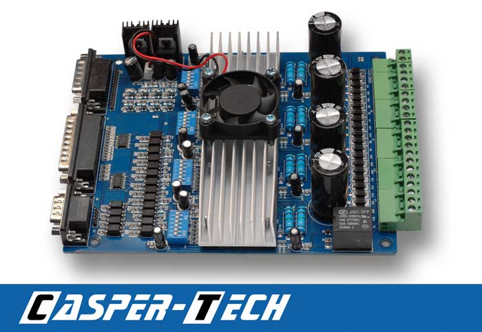

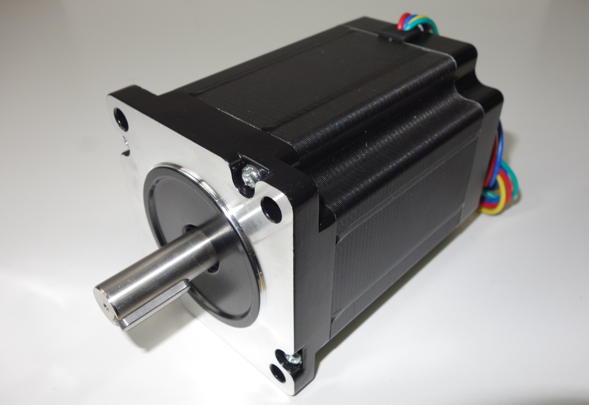

    Have anyone consider using a stepper motor instead of DC 12V motors with potenetiometers [ or whatever other windshield variant ] ?
    In 3D printing this is the best possible solution [ good precission ] but disadventage they haven`t got enough torque [ around 1Nm ]. Lately have found something like this, a 8.4Nm, 6A - so could it be some pretendent to some ultimate solution [ 60$ ] ?
    http://allegro.pl/silnik-krokowy-8-4nm-6a-86hs118-6004a14-cnc-i6714208577.html 0909873646e6a08bf458d6b28f57.jpg
    Will probably need a controller, like this 4 motors 6A Toshiba [ 60$ ] http://allegro.pl/sterownik-silnikow-krokowych-toshiba-4x-tb6560ahq-i6116463308.html d00a6e1a45fe800dce8decbdaadd.jpg
    Have anyone tried ?

    You won't be able to use the shaft as the main drive mechanism for the stepper, you will need to gear it down.
    At this stage there is no way that a stepper motor is going to contend in a dollar for dollar performance contest in terms of driving a motion simulator.

    The one you linked to lists very low rotation speed as a feature along with high torque. The low rotation speed could be an issue in a sim platform. Also, steppers need special driver electronics since the motor commutation is done electronically and you'd need a controller for each motor. They also generally need to be ramped up and down in speed which also slows overall response.
    There probably are appropriate stepper motors and controllers out there but I bet Alexey is right that ones that are suitable will be very expensive especially compared to regular gearmotors.

    A geared stepper will work, they are just slower.
