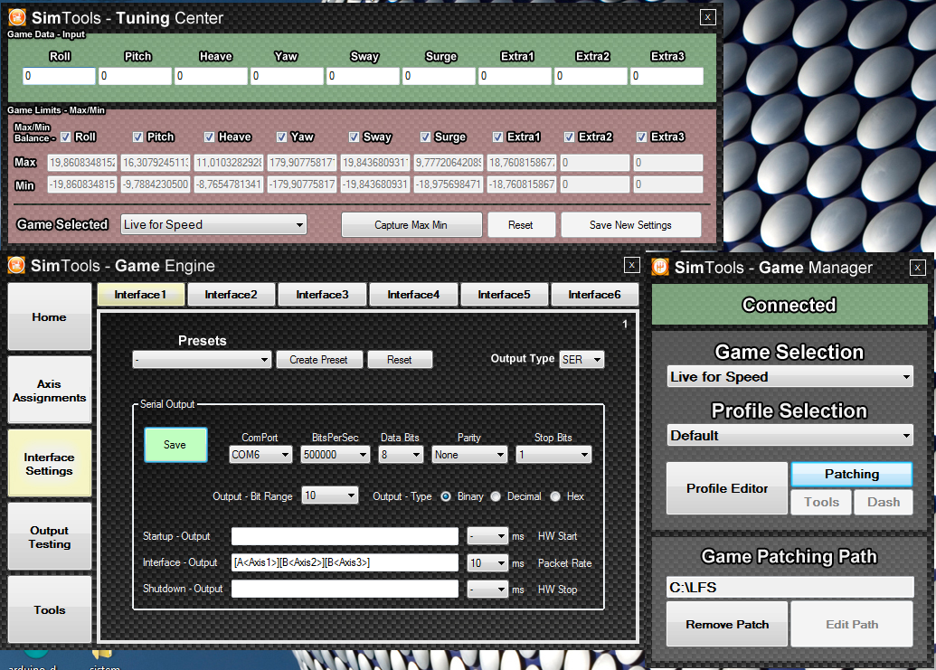

    The interface output settings are wrong please check them again or delete the third axis

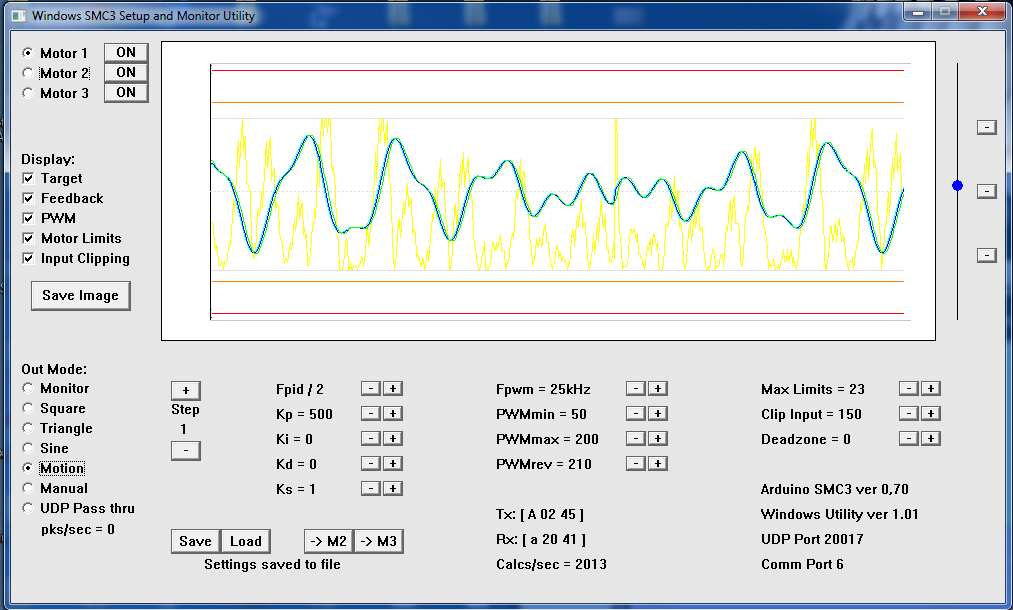

    All is fine probably the PWMmin is too high

    hi all I am very busy at the moment and cannot help further until tomorrow but to your information a few days ago I was running into the same troubles when configurating the game PC respectively the game engine where SimTools game manager was running already a long time ago. Due too lack of time I was not solving this issue.
